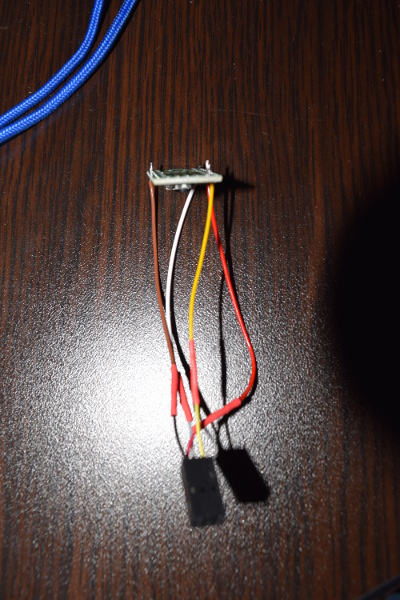

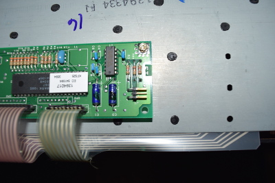

Bought myself a model M terminal keyboard and obviously the path forward is to convert it over to USB.

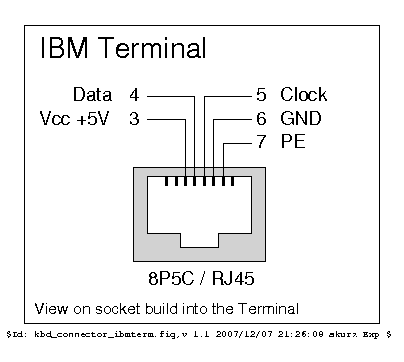

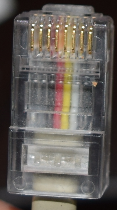

Going from the guide in Geekhack on the bottom diagram I imagined that the RJ45 was plugged into a terminal.
Meaning from left to right I had
VCC- Black (went in VCC port)
Data - Red (PD0)
Clock - Yellow (PD1)
Ground - White (Went into Grnd)
PE - Black (I ignored this completely because it didnt seem connected to anything)
Rather than plug the Rj45 into the teensy through an adapter I wired the teensy straight into board through the adapter.
I programmed the teensy uploading the soarer converter 1.20 beta 4 (Soarer_Controller_v1.20_beta4_atmega32u4.hex).
Plugged it all together and nothing happend.
Am I missing something here? Please dont tell me I wired it up the wrong way round. :oops:
Should also mention HID Listen had nothing show up. Detected the device but button presses did nothing.
