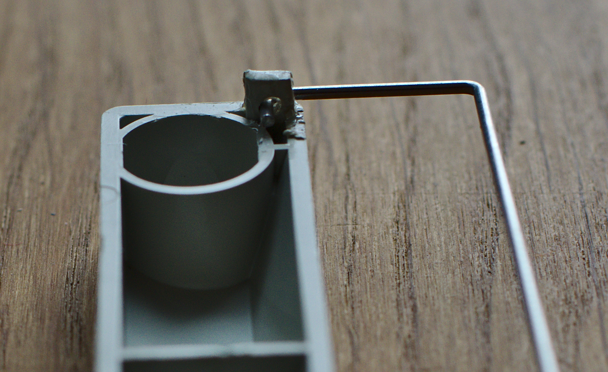

Hello,
one of my 107s have a damaged spacebar.

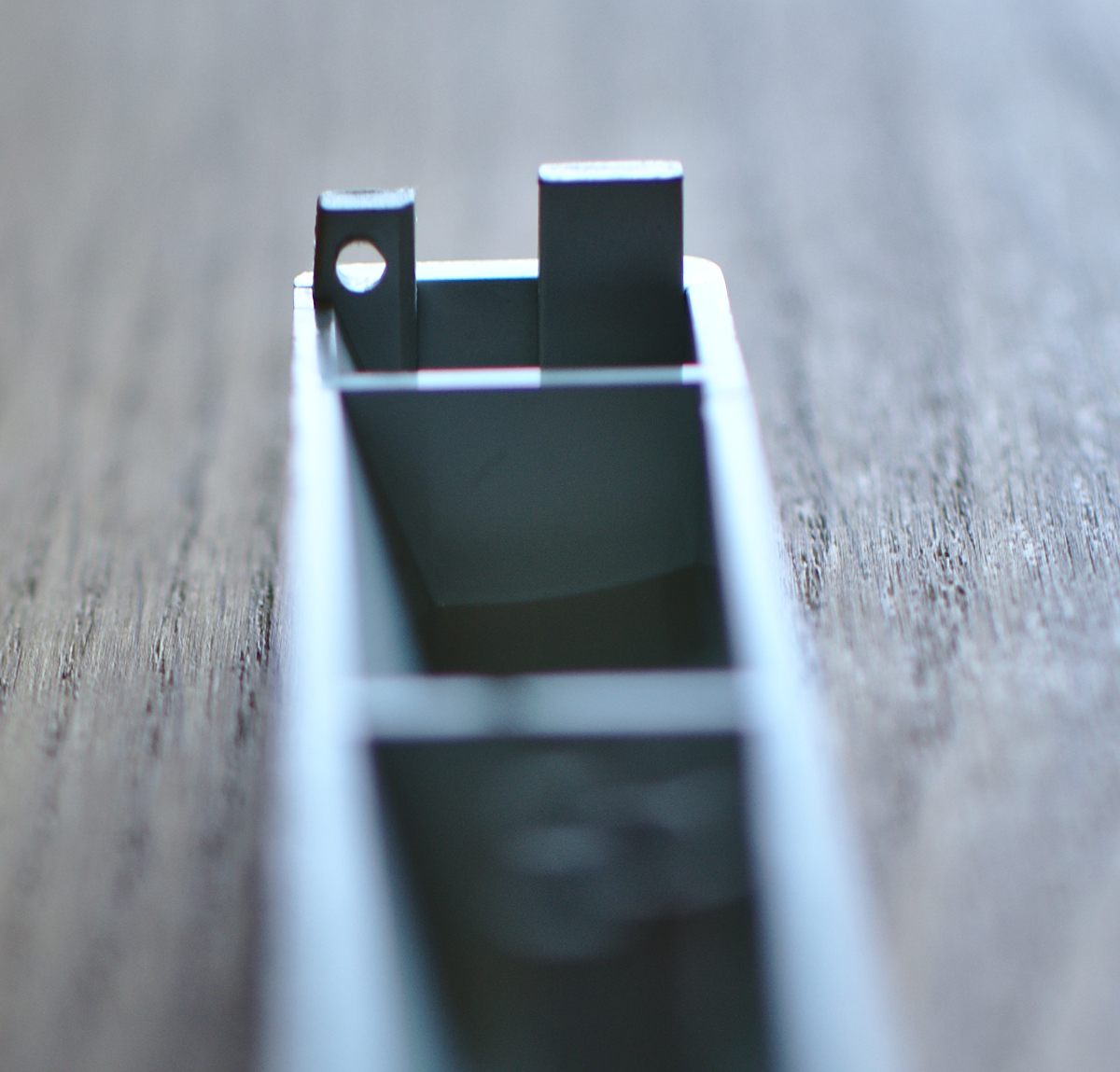

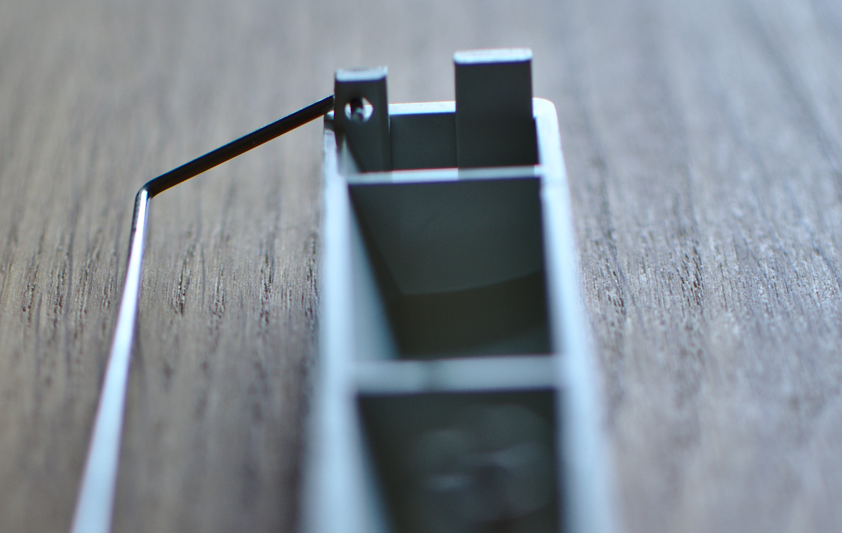

I wanted to use an M bar, but as you may know, the size of the stabilizer is thicker in the M than the one in the F
If used, the F stabilizer will be loose in the M bar:
I read a post in which washer were used to hold the M stabilizer.

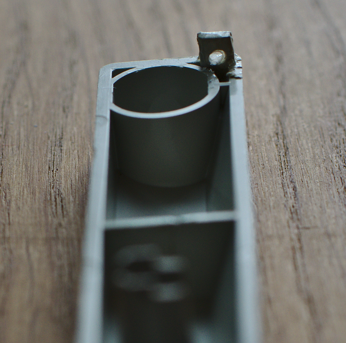

My solution has been a different one.
I fill the hole completely with epoxy. When it was solid, I drilled a hole of the size of the F stabilizer. The result works very nicely.
I should have cleaned the excess of glue with a cutter blade. But to be honest, I did not notice the excess until I zoom into the pictures.
Hopefully this is useful for some others.
Cheers
