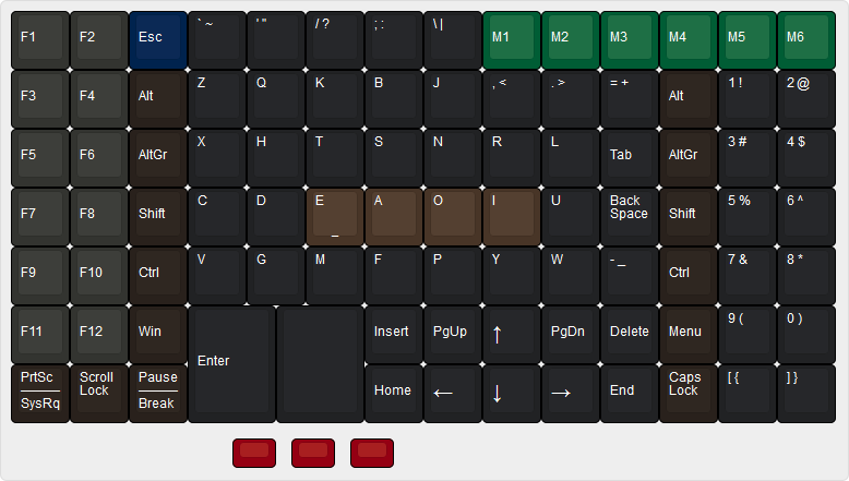

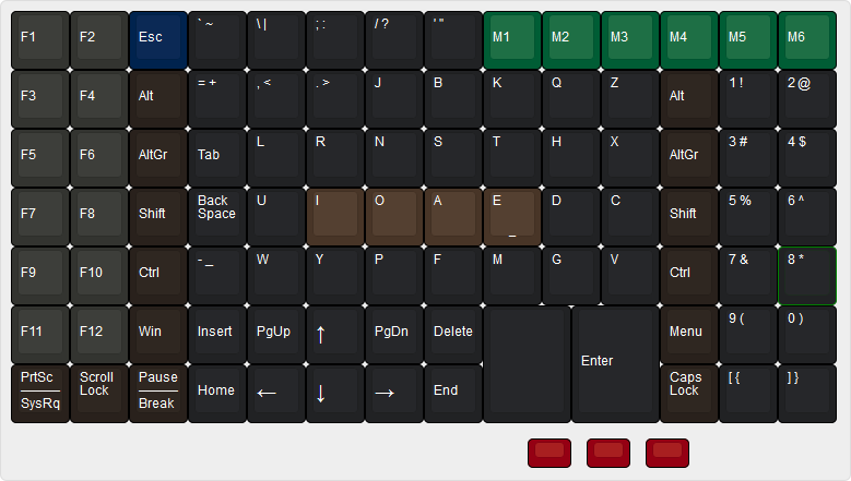

Here is the right-hand layout I've come up with tentatively on my own:
And the corresponding left-hand version:
In both cases, I made a special effort to keep ZXCV together, even if it is on a vertical. The two columns of modifiers ensure that no key is too far to be reached with mods. I also didn't see any particular advantage to mirroring the entire layout for the left hand (I only flipped the alpha area), but it's not exactly a conceptual stretch to do so. I could not make a trackpoint nub render above all keys, so I have left it out, but it would most likely make it into a final design. The buttons will without question, as the targeted user (like one actual person I targeted in the past) has an arm good enough for operating a trackball, just no hand on the end of it.
M1 through M6 are there specifically to become dead keys for accents and other characters, making this inherently multi-language friendly while remaining centered on English. My character's primary language is Japanese, but since I don't speak/write/type it at all, I'm not ever going there. She also considers English a native language, however, and further along in the continuity she will have to tackle both French and Spanish.
