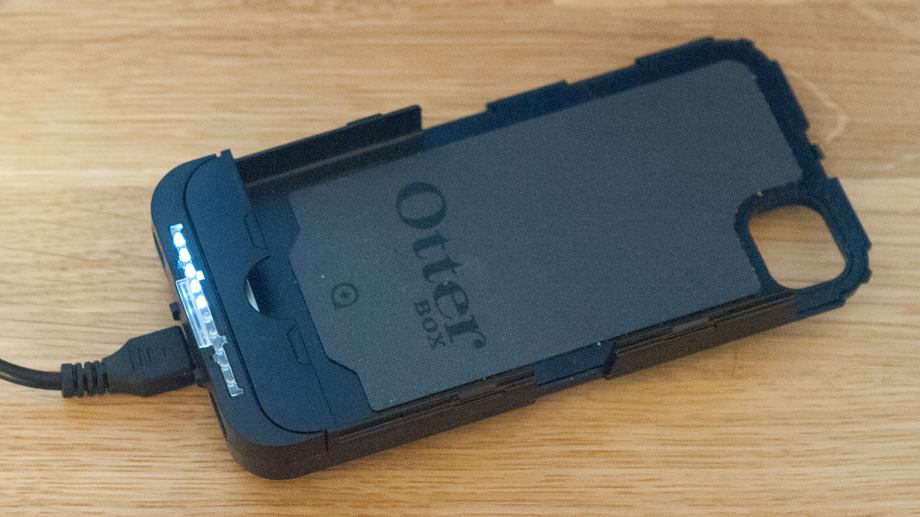

I thought about replacing the foam with this material on the inside of otterbox phone cases.
So spongy
So spongy
Anybody know where I could get this material thicker and larger?

23 Apr 2015, 18:46
Is the material in the otterbox case neoprene?
