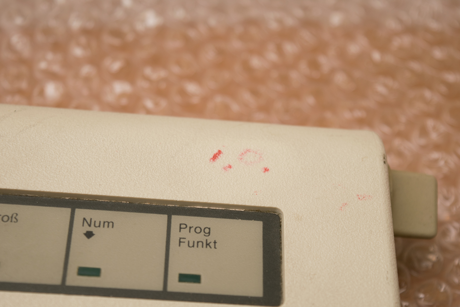

i.O. in red...and I need help from the Germans! What is "Prog Funkt"? Why no "Rollen"?

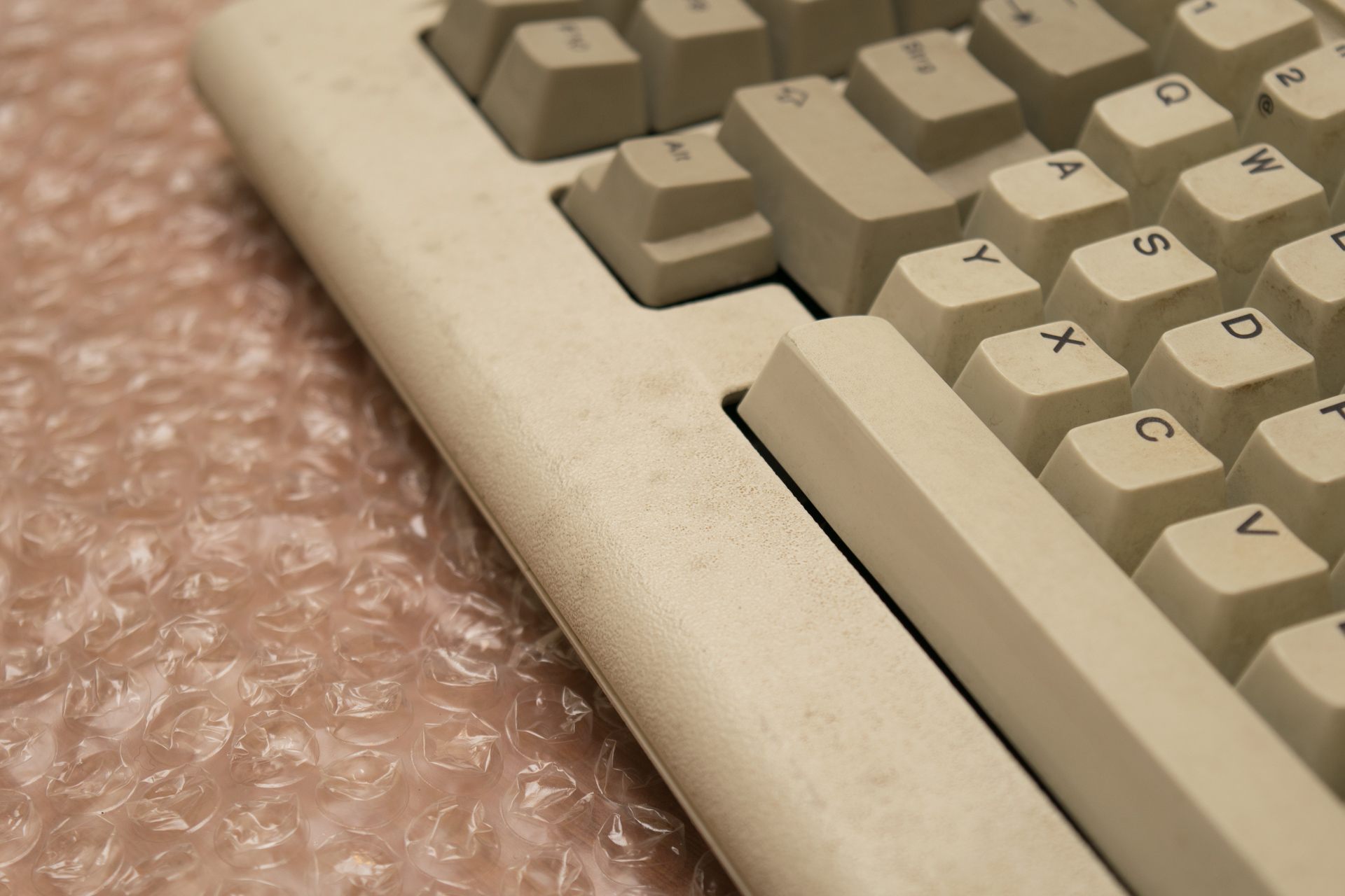

Should make for a decent cleaning challenge!

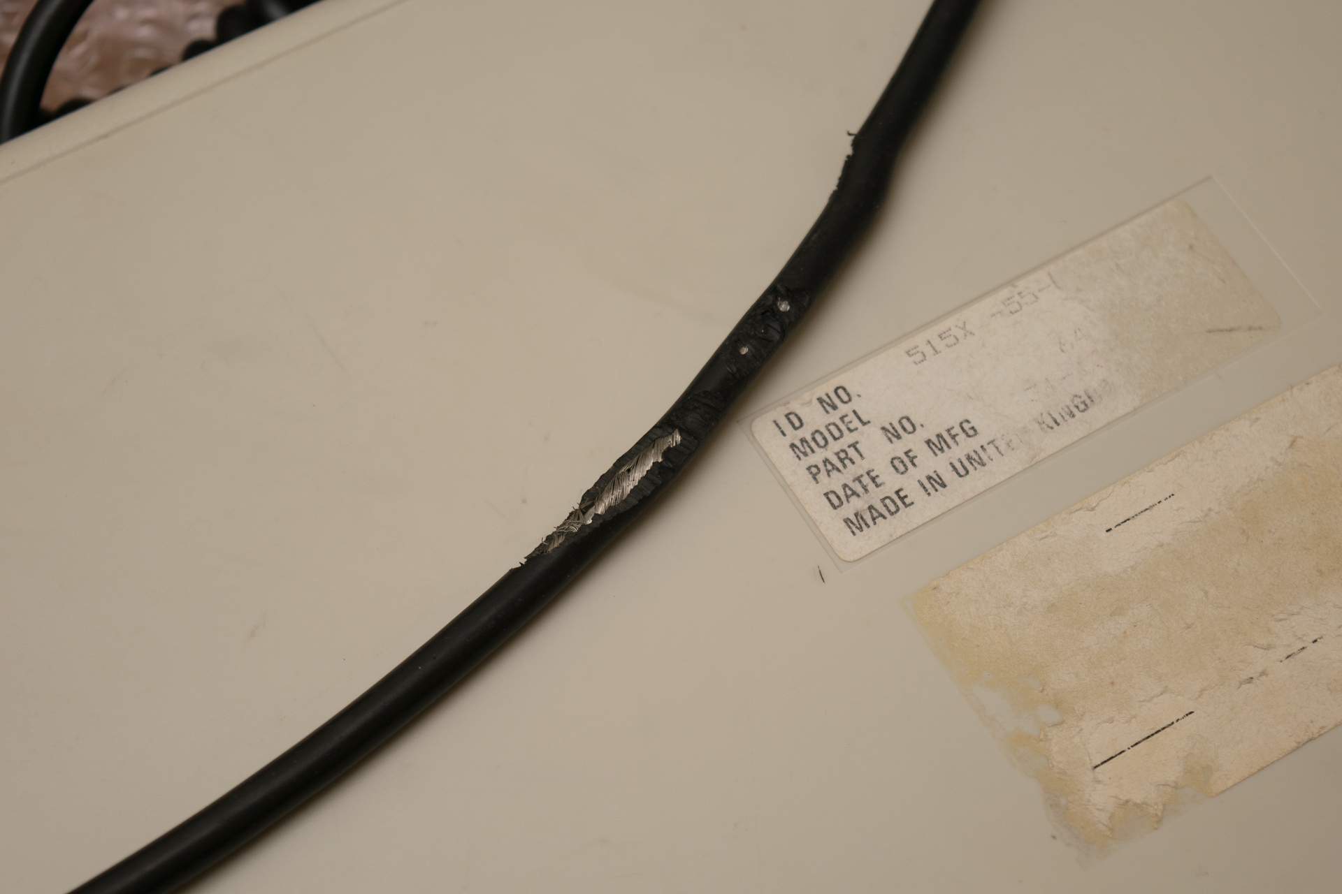

IBM AT-0846.jpg (771.6 KiB) Viewed 4091 times

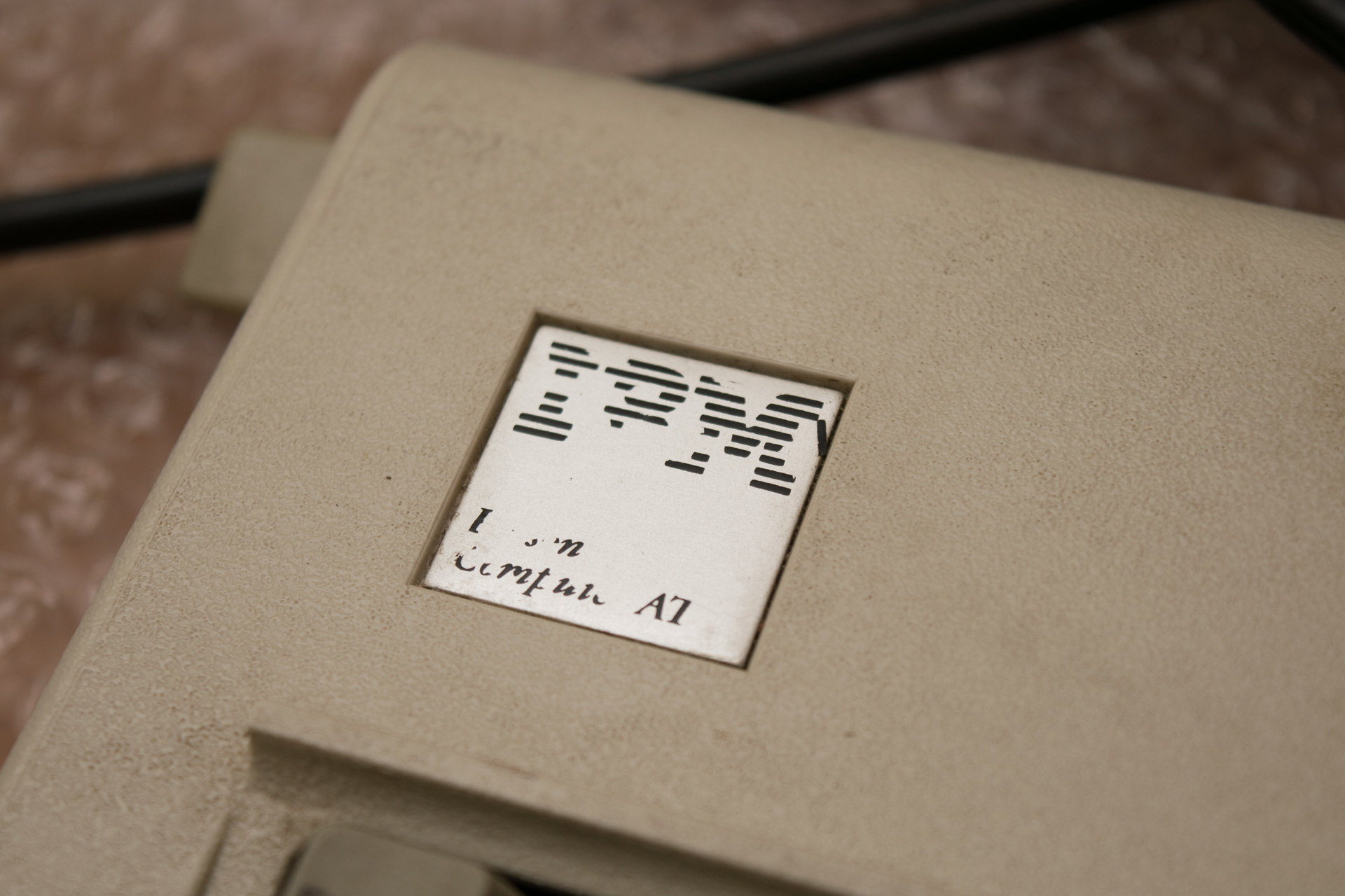

Severe damage on the cable. Just the insulation and the shielding is gone, cable works fine!
Also the label is half gone, and there is residue from another sticker.

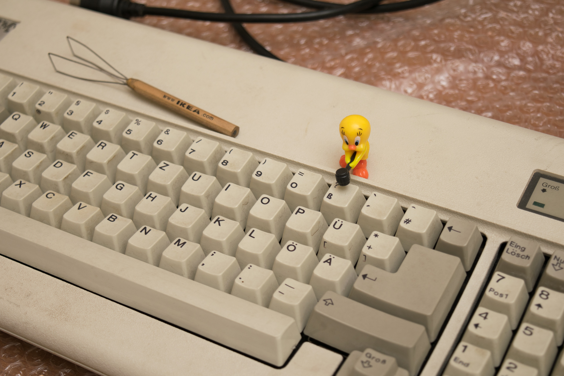

Tweety and I go to work,
IBM AT-0853.jpg (831.32 KiB) Viewed 4091 times

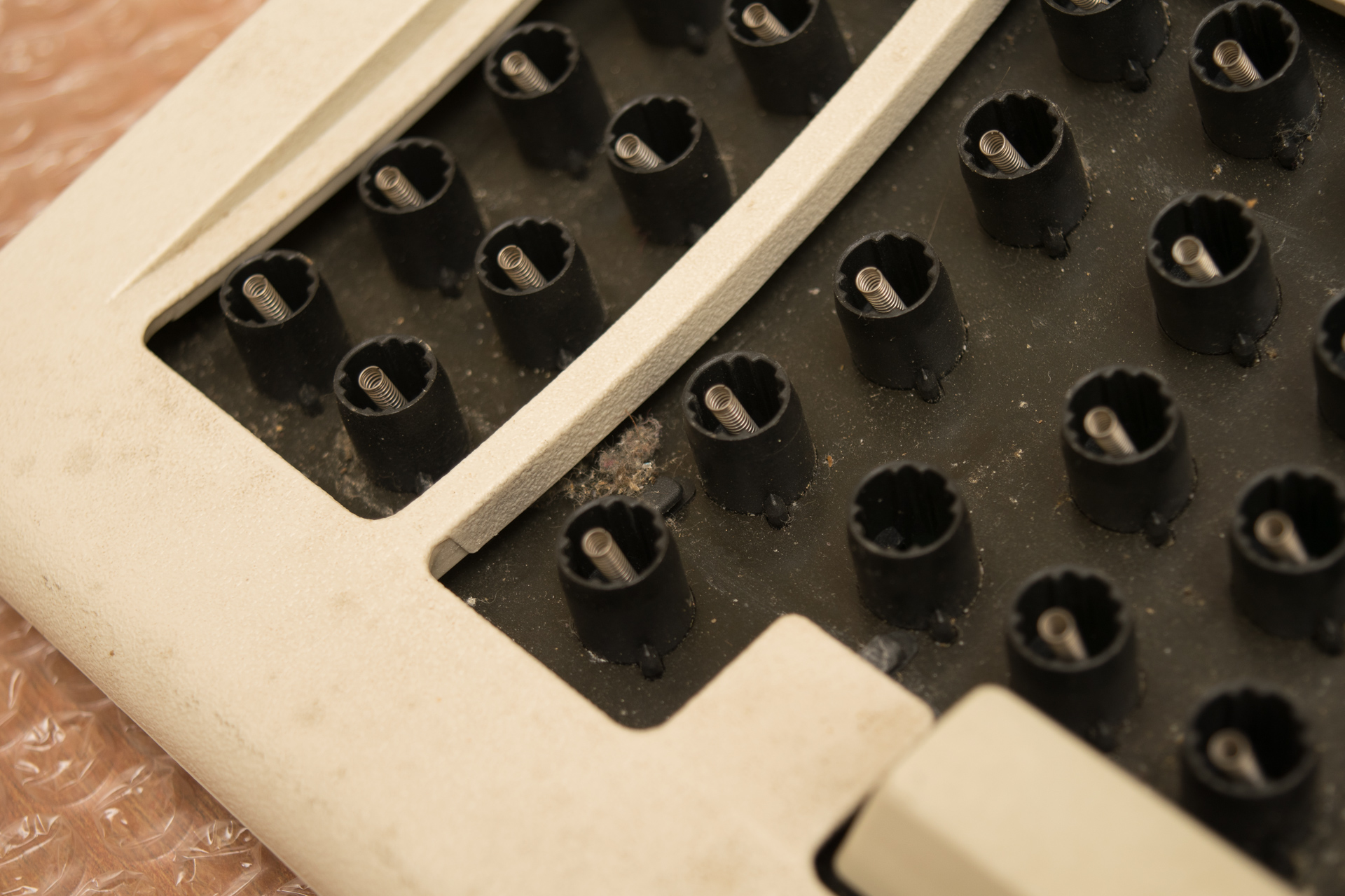

and uncover...the filth!

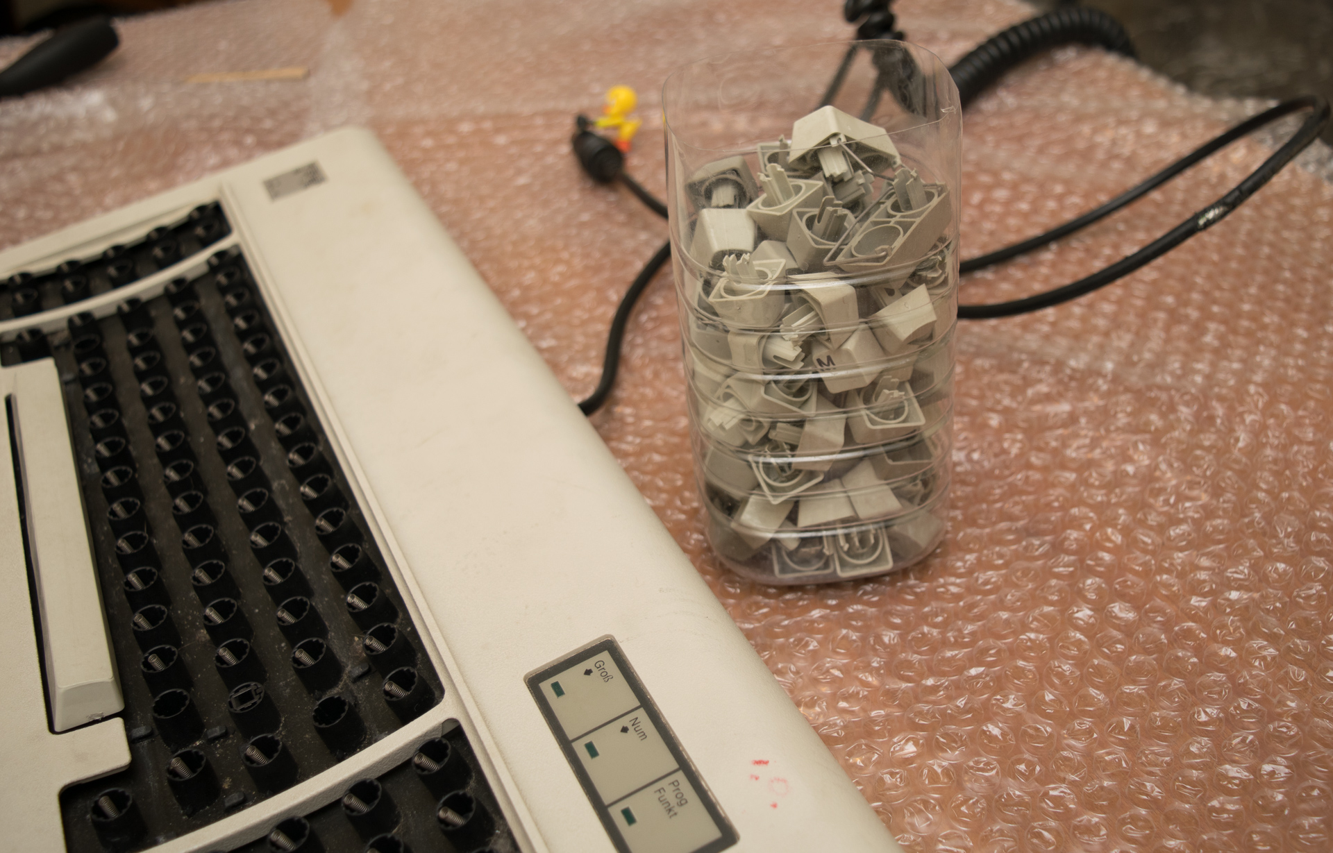

All caps off and ready for an overnight dunk with Corega tablets!

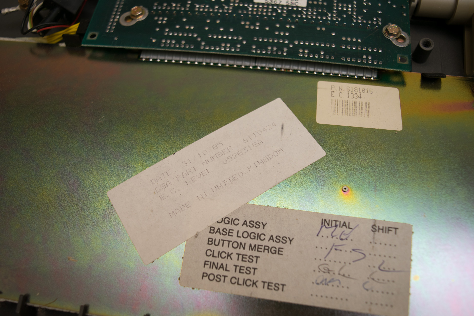

IBM AT-0857.jpg (923.67 KiB) Viewed 4091 times
Inside label, back plate in great condition, and although it's a bit younger than me, it's close to my birthday (26/10)!

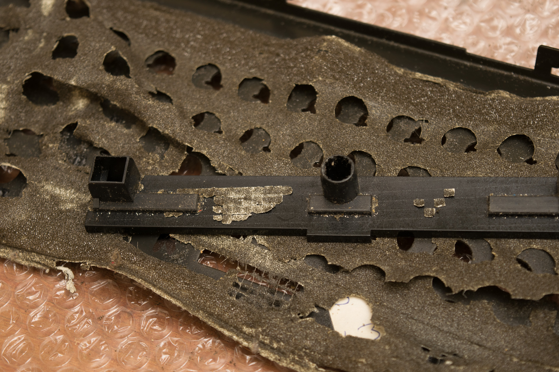

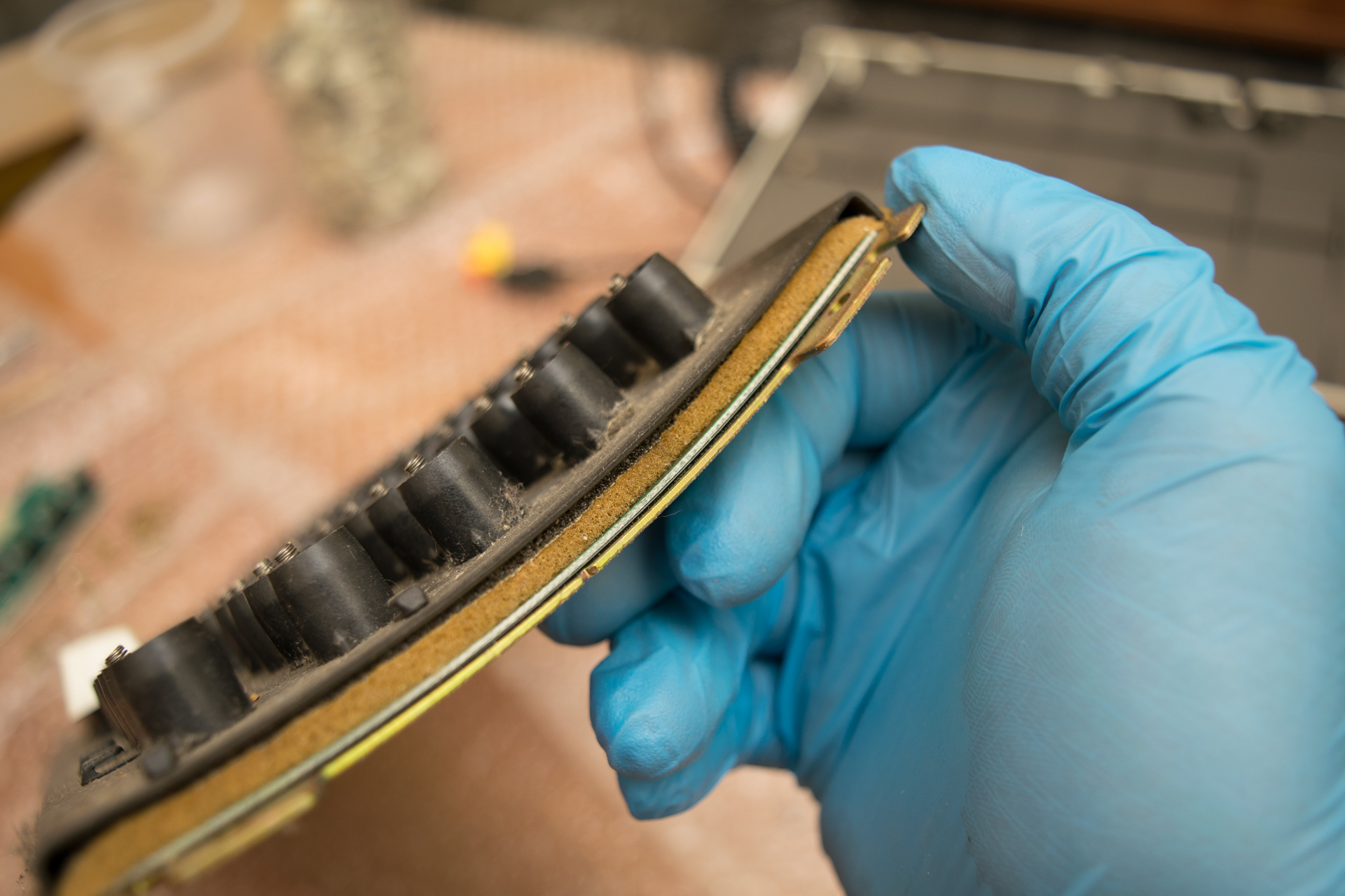

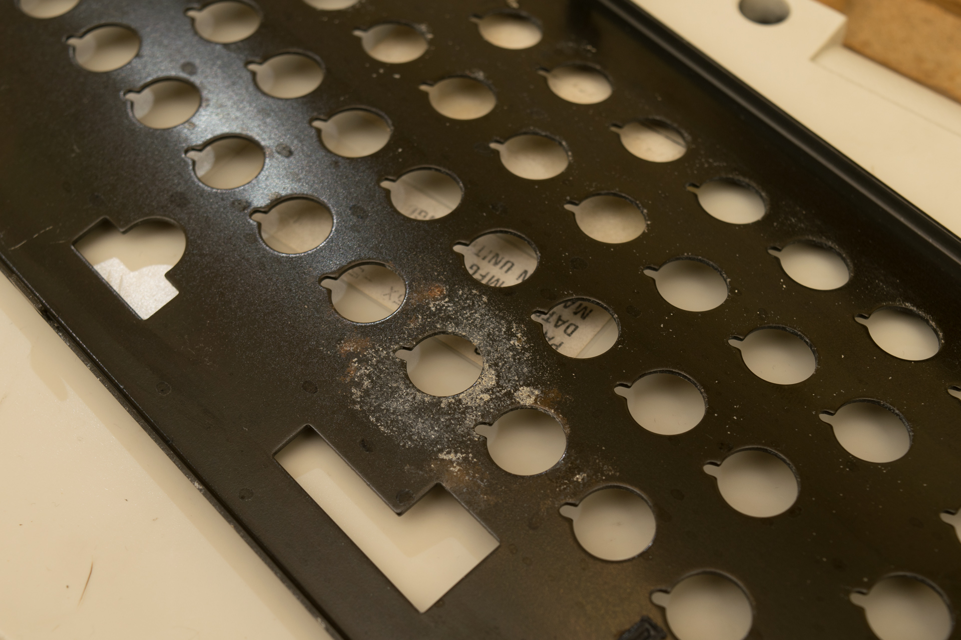

From the side the foam looks good,
But it's not!
IBM AT-0860.jpg (709.2 KiB) Viewed 4091 times
It must have suffered a spill at some point. The foam has disintegrated and the barrel plate has corroded at the same spot.

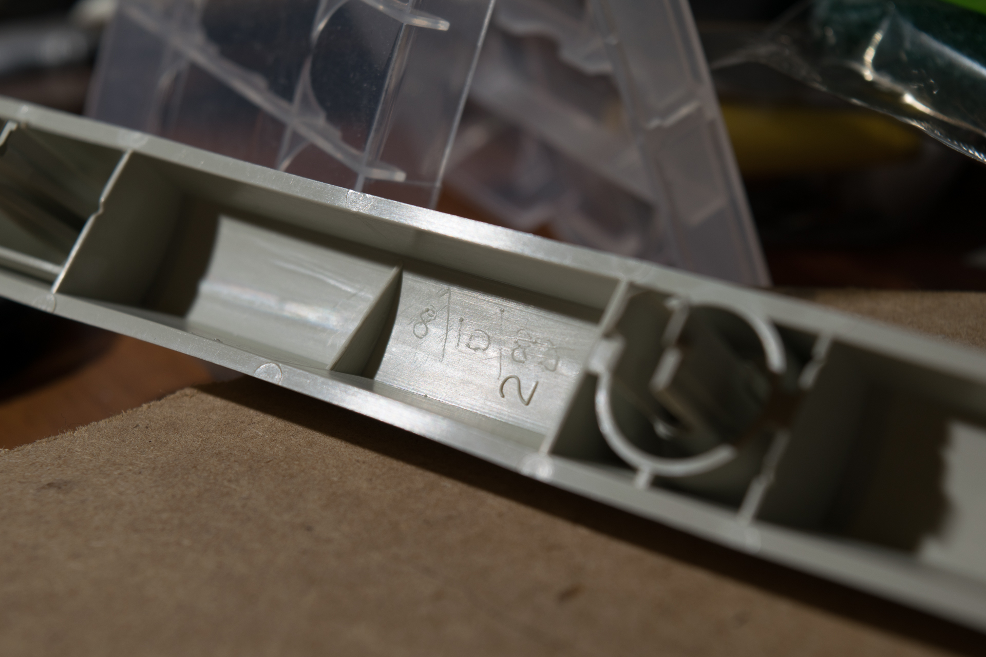

And I tip my hat to IBM's almost masochistic documenting of random stuff.
They hand engraved (more like scratched) the prod. date on the inside of the spacebar mold.
This is raised, so it's a feature of the mold!

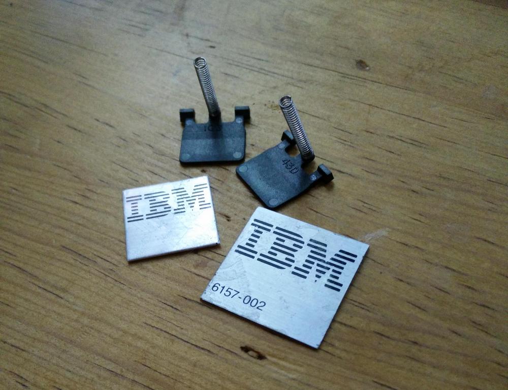

Redmaus
Gotta start somewhere
19 May 2015, 00:35
I got those flippers for you dude. I have them left over from my model F122. I would like 10$ shipping included.
Also looking forward to the rest of your restoration. Especially how you are going to fix that logo ;)

That mark on the spacebar is awesome! Will check on mine as soon as possible.

I guess "Prog Funkt" translates to "Program function", so it's meant as auxiliary LED controlled by a program...
Redmaus
19 May 2015, 00:42
Looks like I can solve your logo and flipper problem! :)

Nice. I like the keycap puller aswell!
chzel
21 May 2015, 13:03
Heh, IKEA is everywhere!
It doesn't work too well though, the wires should be longer! I need to make a couple more!

chzel wrote: Heh, IKEA is everywhere!
You talking about the keypuller? Looks nice though. I am still waiting for a MKC aluminum keypuller to come back on massdrop...
Oh and do you still need the extra flippies? :)
chzel
21 May 2015, 17:12
Yeah, I meant the keypuller's wires, they are a bit too stiff and can take only one cap at a time.
PM incoming regarding the flippers!
