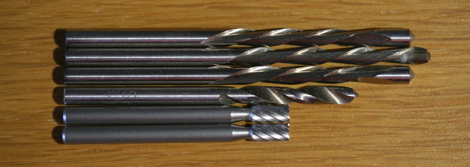

28 May 2015, 14:56
This is a Dremel 3000 I've borrowed. I don't have the documentation, but here's the included bits that look promising:
Dremel Bits.jpg (276.07 KiB) Viewed 7689 times
Anyone know how to ID these? Just the middle one has any markings on it. Ungh…
DanielT
28 May 2015, 15:02
The 2 on the bottom look like the the good ones. I have to check the catalog, they don't like to put markings on the bits :(

Muirium wrote: This is a Dremel 3000 I've borrowed.
If you're looking to get one for yourself after returning that one, you might want to look at "WEN" - I got one myself after seeing that most buyers have been really happy with it, and I am too. Chinese, yes, but nothing about it feels cheap or crap. It's just about a third of the price of the real thing.
28 May 2015, 15:20
Are they good for replacement bits? That matters.
DanielT
28 May 2015, 16:04
For bits I recommend to use only good quality ones like Dremel and Proxxon, Proxxon is cheaper than Dremel but very good. For the machine itself you can get a cheaper one as long it is decent. But from my experience, and I do a lot of work in my free time with power tools and stuff like that, the goo bits and drills and blades are nor expensive for nothing. They last longer and do the job they are supposed to do. With the money you spend on one good bit you can buy a handful of cheap ones and still not do the job.

Muirium wrote: Hey Broadmonkey: How much filing did you have to do for the stab clips? Unbelievably, I've still got to install mine! Steel keeps putting me off.
It actually took me quite some time and head scratching to get the stab holes done right, but it wasn't by much they would have to be filed. Eventually I made some a bit too large, something I corrected by adding a bit of glue to make them stay in place. The real time spender was testing and figuring out where to file and by how much.
I wouldn't recomend you use a Dremel. With that you can't maintain a square hole and it's harder to make it precise. I would just bite it and use a file.
File it down slowly, since it's pretty significant that the stabs are aligned with each other, something that is a fair bit harder than it should be. If the holes are not alligned you can both hear and feel the stabilizer inserts in the key caps scarpe against the stabilizers, this specifically was my biggest pain!
Get a good square file that is the same size as the hole, file it a bit on each pair of stabilizer holes and test with stabs inserted with keycaps and all. Repeat that til it fits.
