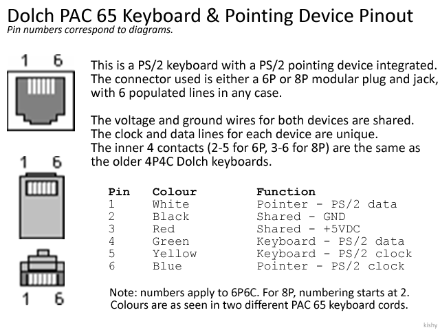

Unlike everything I have read on the Wiki and on other sources this board didn't came with a RJ11 plug (6P6C) but instead it has a RJ10 (4P4C). Before I got the board my plan was to swap the whole original cable with a normal PS/2 one, but after I saw how nice the board is I decided to try something else, as I didn't want to modd the board in any way.

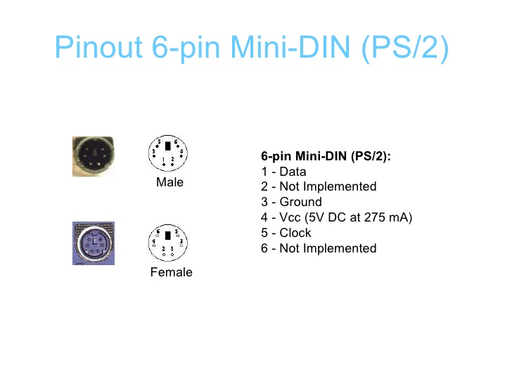

Waiting for the board I made a first adapter using a RJ11 socket from a ADLS filter only to realize when I got the Dolch that the board has RJ10 :lol: Lucky me I had a RJ10 socket in one of my boxes with stuff I keep just in case, so I made quickly an adapter. The Dolch board speaks PS/2 , only the plug is different
I had also an ID Innovations PS/2 to USB active adapter I have bought some time ago from http://techkeys.us that works like a charm :)
I'm not really happy with the adapter I have made, I like a clean look, this one works fine, but it looks too improvised and I just can't be happy with it. I have already ordered the parts for a new improved version. As soon as I have everything I need I will make the new one and I will post photos :)
Just in case someone is interested here are the pin-outs for the Dolch connector, it doesn't make a difference if the plug is RJ11 or RJ10 as pins 1 and 6 are not used.

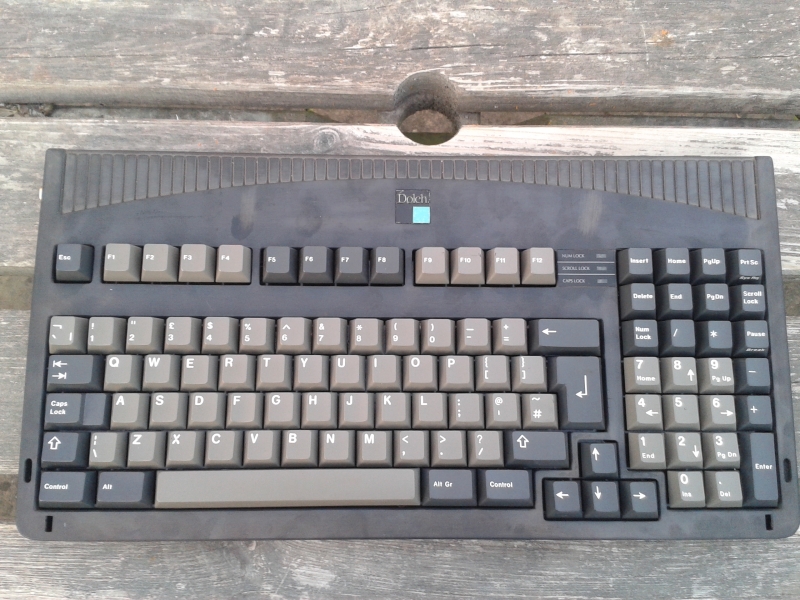

...and here is his older, slightly scruffier, slightly stupider (the arrow keys and nav cluster all send numpad scancodes) PAC60 ISO brother.
This was after a pretty massive clean session, I'm not sure what it was coated in but it was pretty grim...

Oh the poor thing :( I think that the fuzzy padding from inside the bag got loose and got stuck on the poor case :(
At least the caps look in good shape. I think some plastic polish could revive the case, some time ago I have done that on some plastic parts for my car, can't remember the name of the product but it did a nice job, I have to search a little.

This is the first time I like an ISO version more than it's countepart ANSI version.
Apart from the conditions, I think the black ISO Enter looks beatiful in comparison with the grey |\ in the ANSI board, as it breaks the continuity of the black modifiers which sorrounded so well the alphas...
