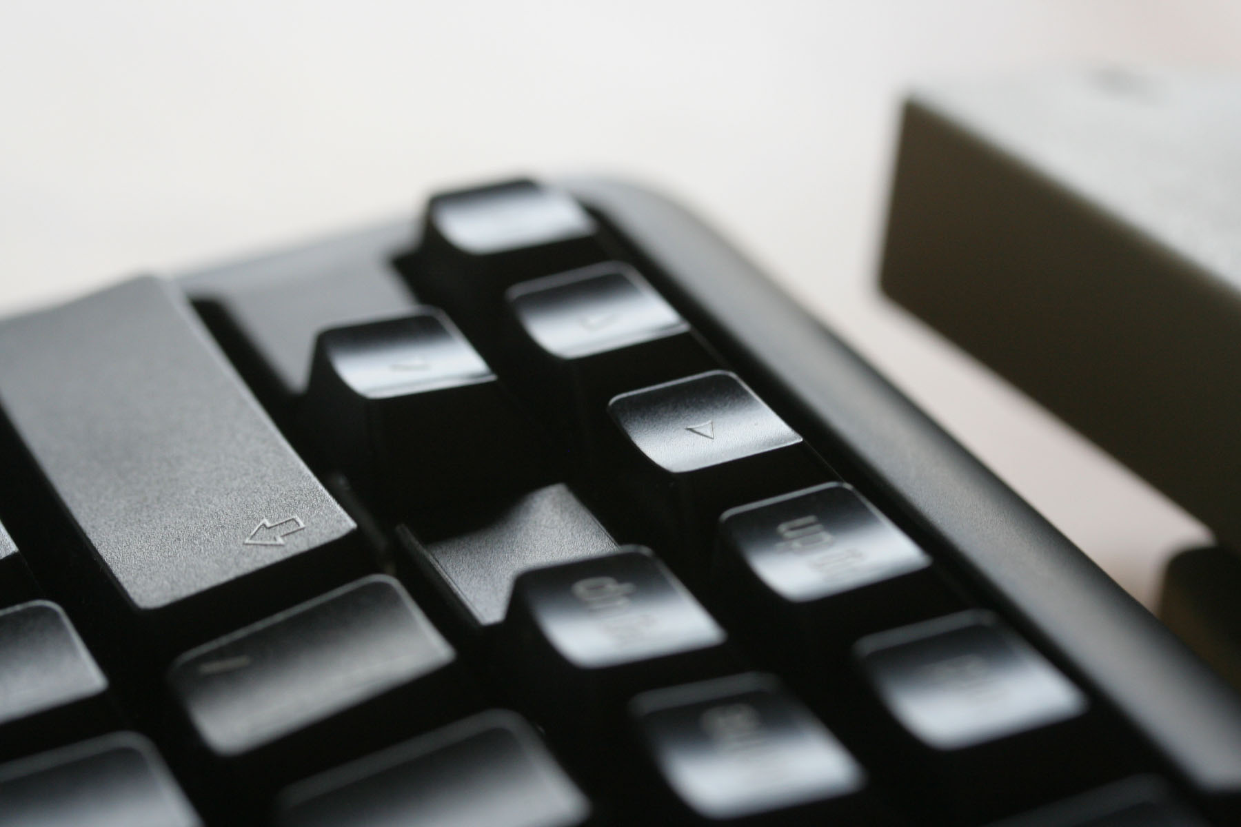

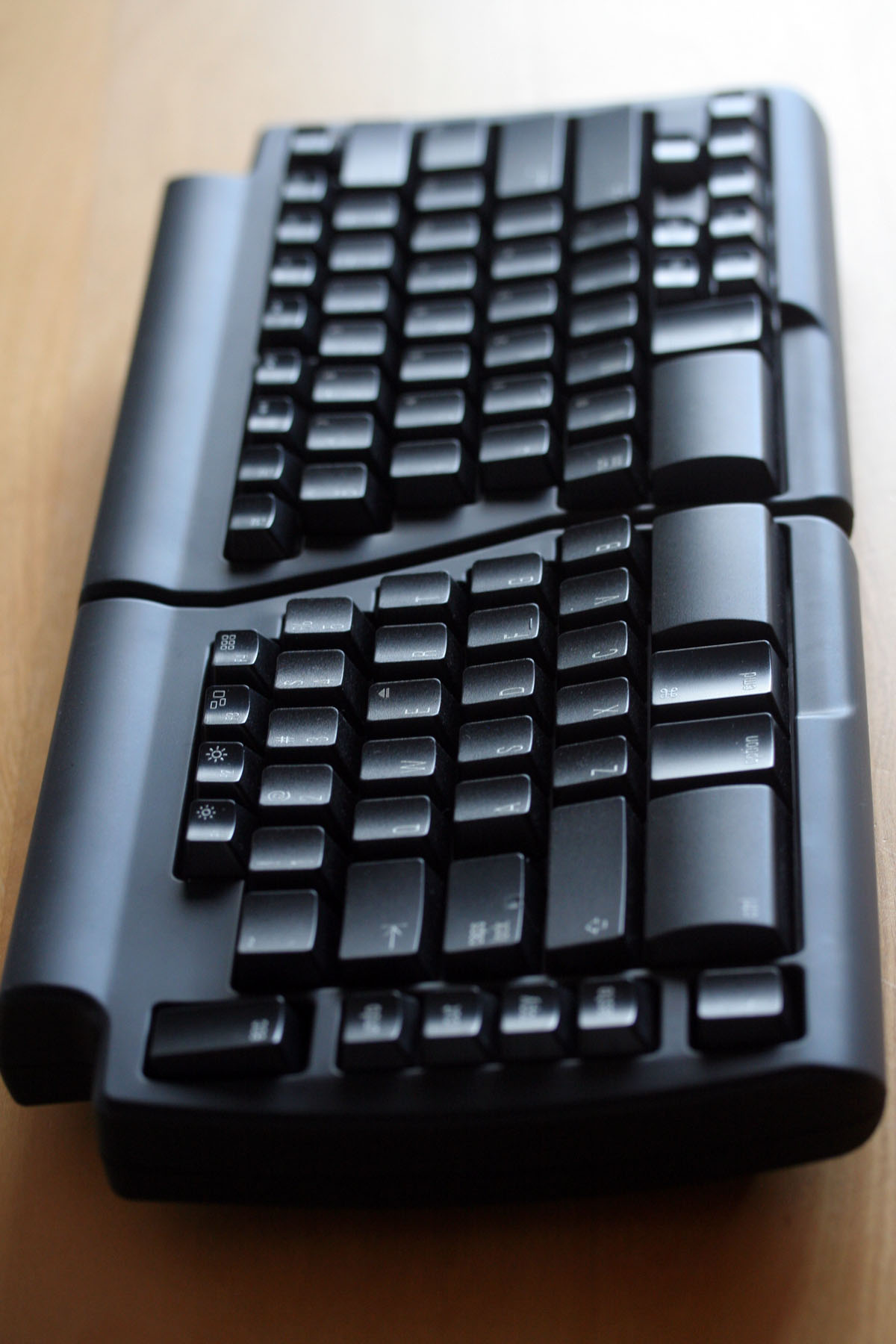

So, say theoretically I was just finishing off a review of the Matias Ergo Pro. In theory! And I didn't know how to describe these caps…
They're the usual white on black "don't touch them it'll wear off!" style, much like CM used on the NovaTouch. I hardly mentioned them in that review because if you're using stock caps on a NovaTouch you, sir, are doing it wrong!
But the Ergo Pro has pretty unusual caps to suit its layout, so they're more important in this review.
And I… uh… don't know if they're ABS or POM. (I assume ABS. They don't feel extra slippy like I heard POM does, if that's accurate.) And I don't know for sure the name for their legend printing technique. The white legends are clearly embossed from the cap surface. That's laser infill, right?
Gimme some terminology, I want it nerdy!
And, uh, forget I didn't already know this stuff when you see the review. Hypothetically…

They're ABS, and per Matias the legends are "UV printed." It's supposed to be more durable than the old pad printing, but only time will tell, I guess.
06 Jun 2015, 01:54
Thanks Techno. A fortuitous first post! I wonder if their laser is the UV part…

Actually, rereading that thread, these caps are supposed to be UV printed PBT.
06 Jun 2015, 02:03
Ah, very good. I see Matias posted a couple of pictures of what he described as PBT spacebars. Was that just the white one? In any case I can't feel a difference between the spacebars on this and the other keys, apart from texture and their convex shape, just like the Control key.
Of course, now I get why Control is convex too. It's a cost saving technique so they could reuse the (identically sized) spacebar a third time!
Edit: UV printed PBT? No mention of material on their product page. I guess I'd better ask them! I'll be impressed if that's the case.

I was talking about this with someone senior at Matias. These caps are ABS, and the legends are entirely lasered. What you see is a hard white foam left over after an ultaviolet laser boils the surface of the plastic. No coating. Apparently long lasting too.
Something I didn't notice, but a friend did, is they look different when in low light. It was really dark here yesterday as the rain started again, and he was adamant the legends weren't pure white. He was right. It's hard to describe but take a look if you get your hands on one. Thats no ink. It really is a microscopic roughness.
