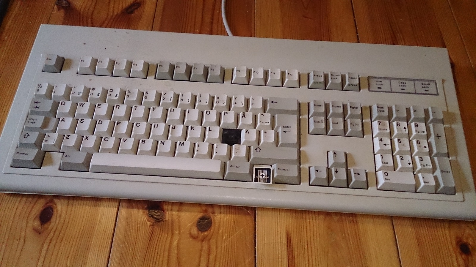

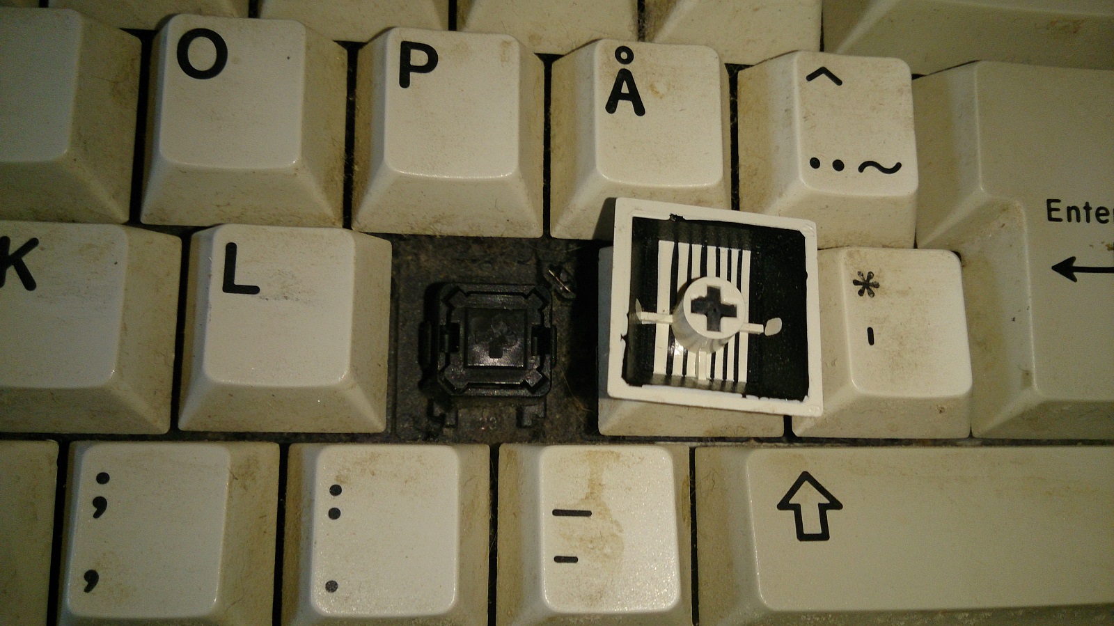

What i instead found was an old cherry g81-1000 with double shots and a serious problem, the ö switch stem is broken and wedged inside the key-cap.
Is this something i can fix without taking the whole keyboard apart? And even then, is it really worth it? From what i heard the g81 line isn't the most well liked of keyboards.

These old black G81 switches are very easy to repair. You can remove the slider with a simple paper clip or a needle inserted beneath the slider (where the square recess is), and then push a new one into place.
Removing the remnants of the switch from the keycap stem is more difficult. You'll probably have to dremel it (this is precision work). Replacing the keycap with a German Ö is of course possible, but do not take it for granted it will have the exact same degree of (or of not) yellowing as your present cap..

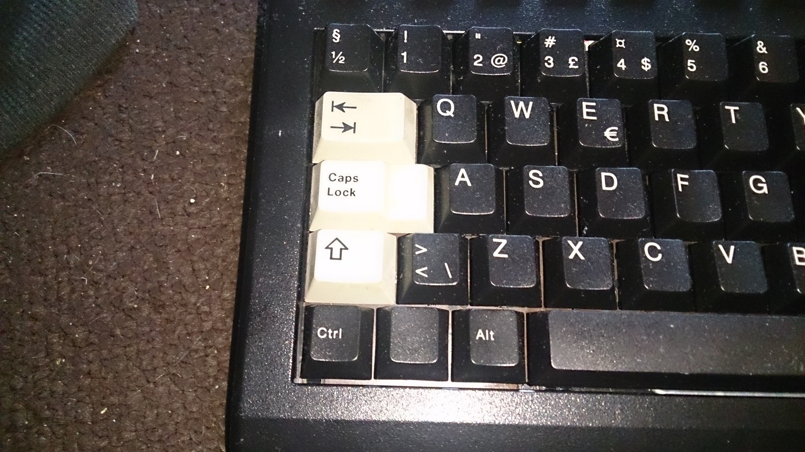

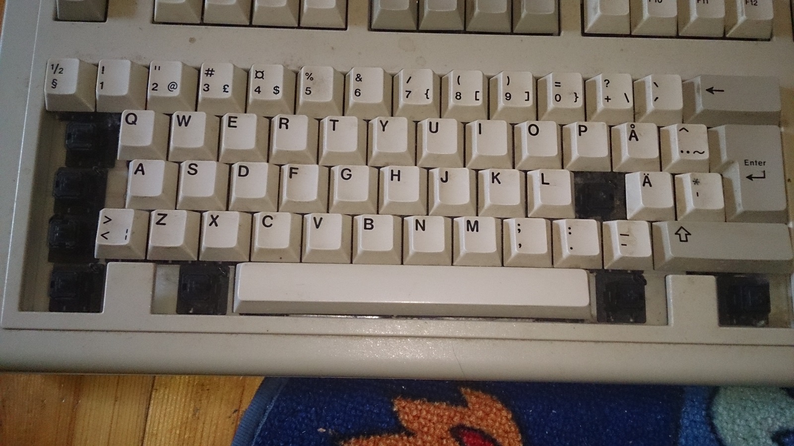

Hm, to be honest, i am actually not really that found of cherry boards in general and im definitely no expert when it comes modding them.
here is the board without the modifiers though and a 1800 i have laying around with some of the 81 switches, seems to fit pretty well.

I've had to deal with broken off stems inside keycap many times. My trick is to use a small eye or hook screw and thread it into the broken stem piece, then pull it out... think of removing it just like you would a cork from a bottle. It works really easy. Just need to make sure not to thread too far so it goes into the keycap, and work it out gently.

I tried that several times, but always failed to at all thread the screw into the (much too hard) broken stem piece. Do you drill a hole first?

No, I just use really nice sharp screws.
