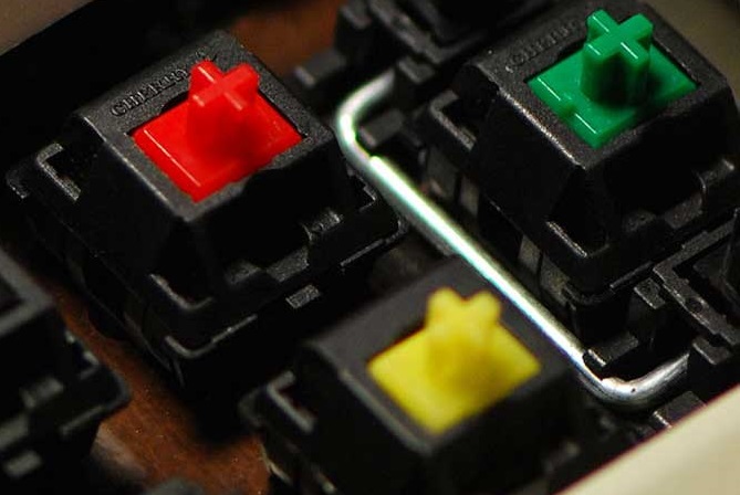

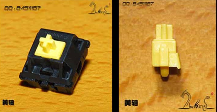

Very nice photos. You are right -- if "Rapoo" is not on these switches I'd think it's Cherry MX. Is it possible to strip "Cherry MX" branding and re-brand as "Rapoo" or they were not branded to begin with and it's easy to brand them?
branded Cherry:
on the same page it shows the yellow that's not branded:
original pics from: http://deskthority.net/photos-f62/yab84 ... t2149.html
Interestingly, in March of this year they were advertising/describing their switches as "Original Factory MX Yellow Switches for Laptops Desktops PC" and also using words like "homemade".
