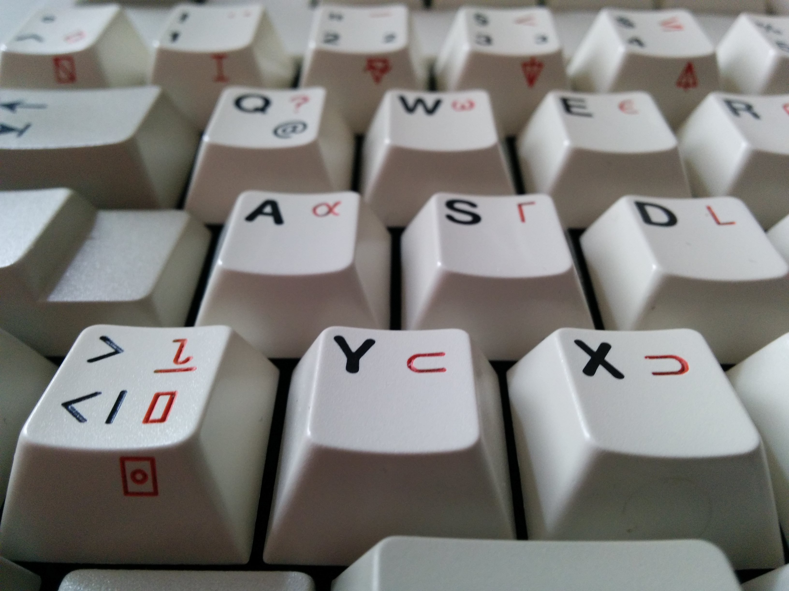

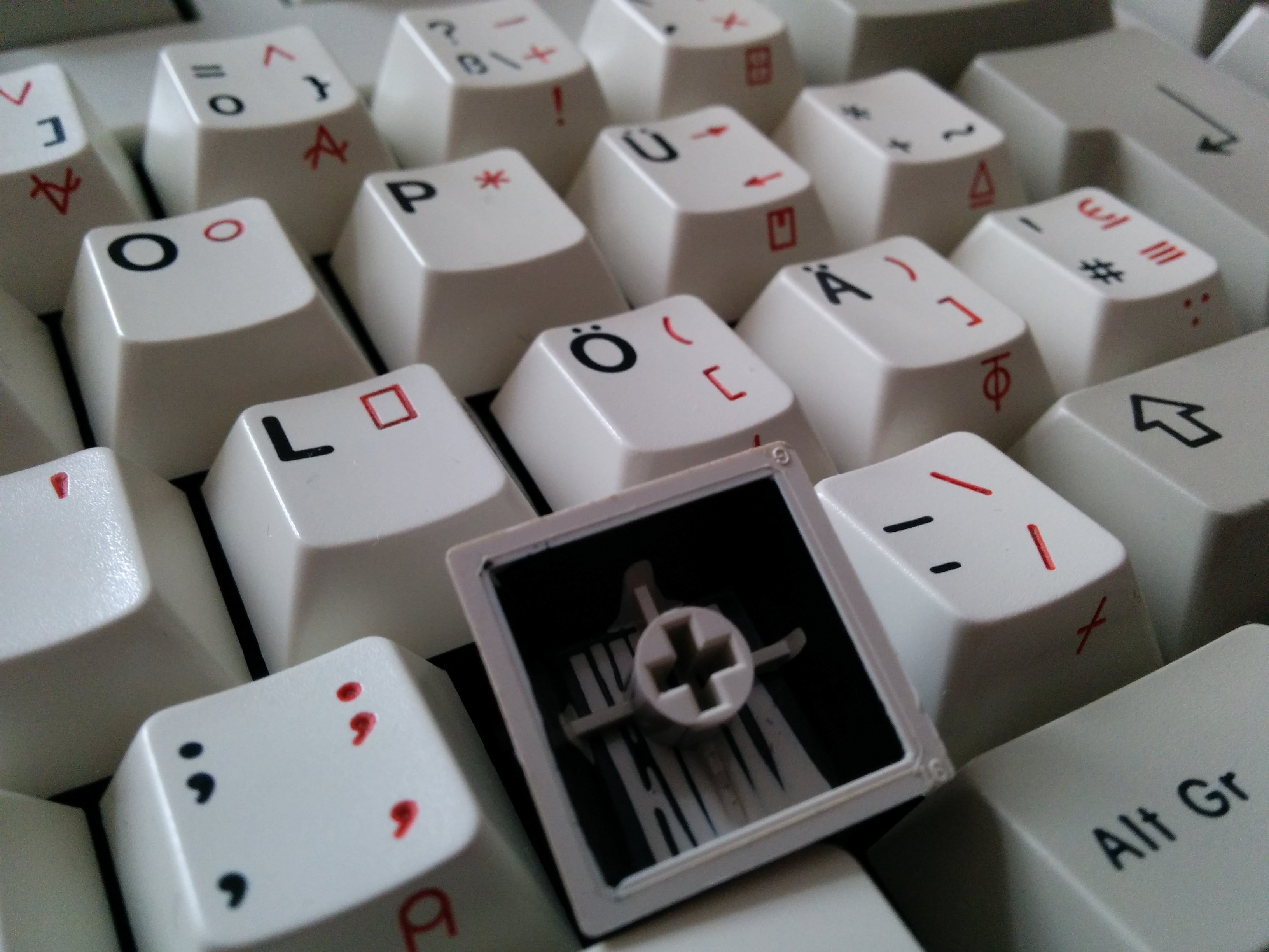

not sure if this is of relevance or if you can even see it on my APL set, I'm not sure how old these are and how they were manufactured though:

The classic infill is the one on seebart's pics, the laser or engraver cuts a "trench" in the cap and paint is added to make it stand out.
