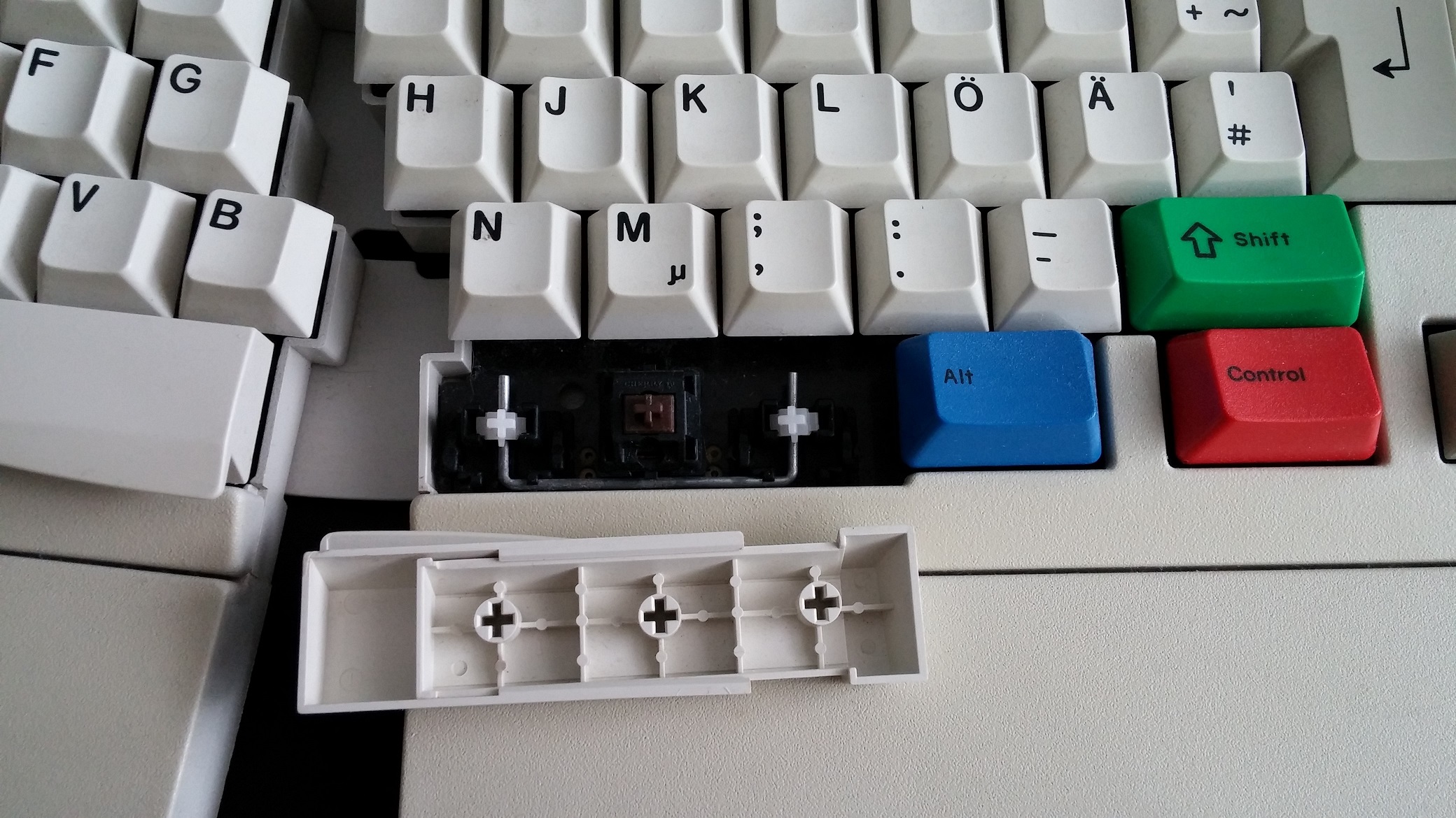

Hey guys I would like to mod my yellowed g80 5000 a little.
I had something like this in mind (this is not my g80 5000, I have just used it for paint/photoshop):
Possible mods:
a) paint the case either RAL 7000 or black (cannot decide)
b) glue some leather on the palm rest, any tips ? (what kind of leather? how to attach? cutting tips?)
c) either bleach the spacebar (dont want that option) or paint it (?) or replace it (what kind of keycaps?) or put some leather on it (?)
How would you do it? My mod experience is based on building an ergodox and painting a poker case.

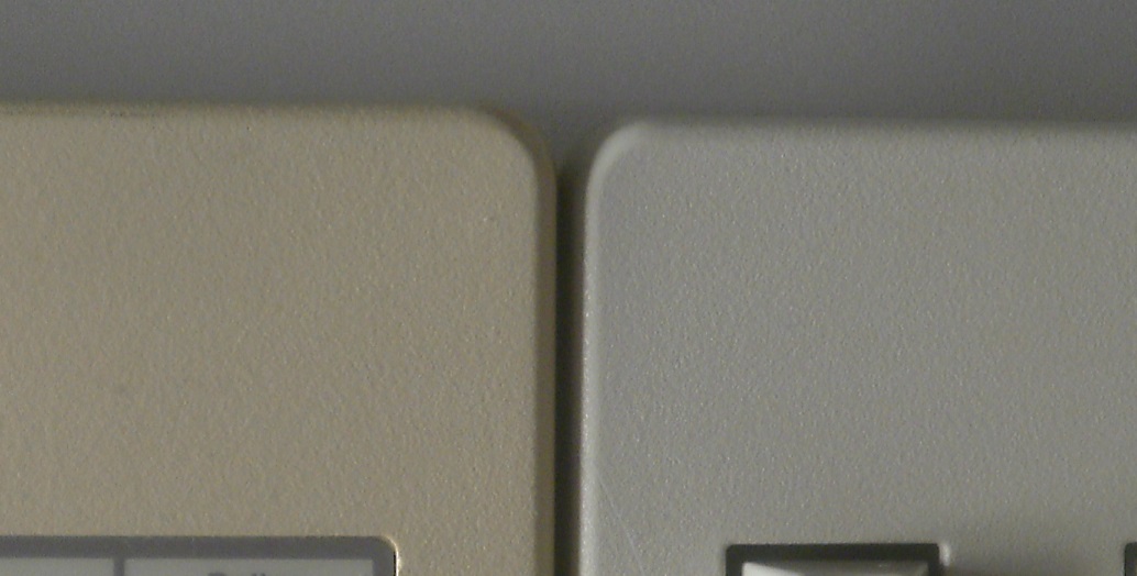

I have been experimenting lately with a very simple, very quick and very cheap retrobrighting method, with excellent results so far, but which unfortunately I have not documented.
As an example, here's a pic of two keyboards which I received from the same person at the same time and with similar yellowing, one of which I retrobrighted last week:
yellowed and retrobrighted side-by-side.jpg (117.7 KiB) Viewed 10024 times

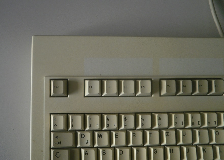

Next thing I intend to do is photographic evidence of the whole process using this badly yellowed case (see the original colour where there had been stickers above the F keys):
yellowed 1000.jpg (125.01 KiB) Viewed 10024 times
So perhaps you should just wait a bit before committing such a blasphemy [© photekq] :mrgreen:

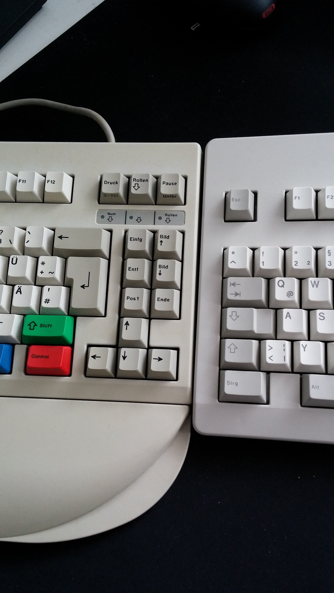

Wondering if there are any keycaps that fit these spacebar stems:
I can't stop to praise these spacebars, their thought-out design and feel.
Here's a pic of the yellowness ( in real life it is even worse):
You can see it better here:
https://dl.dropbox.com/u/24690177/Bilde ... 20_223.jpg
Besides this yellowness this board is a blast, the MX Browns, the five extra F-keys, the ergonomics. One can really see how and what the engineers thought at the designing process.

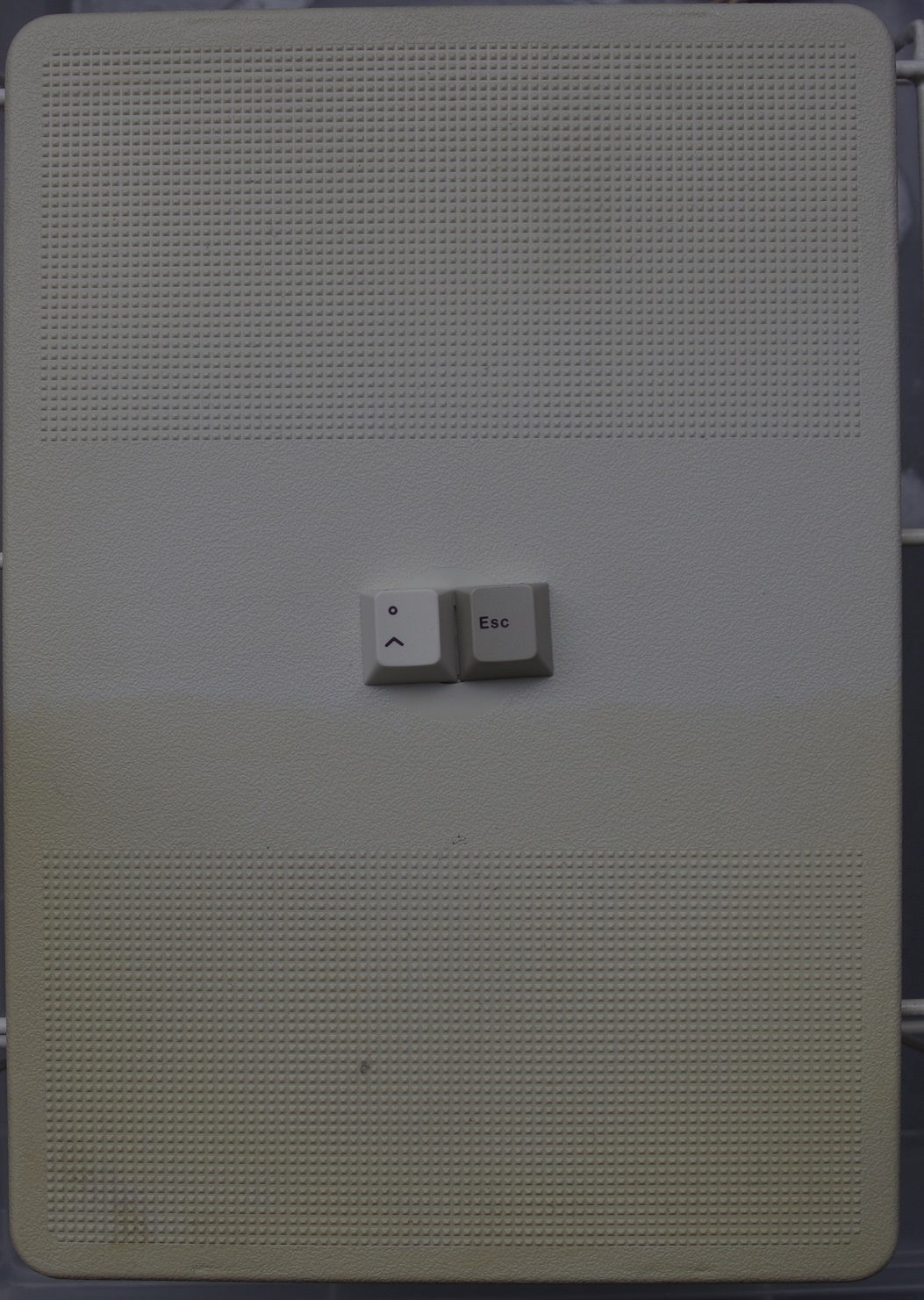

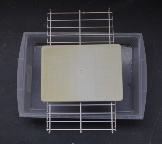

22 Jun 2015, 13:54

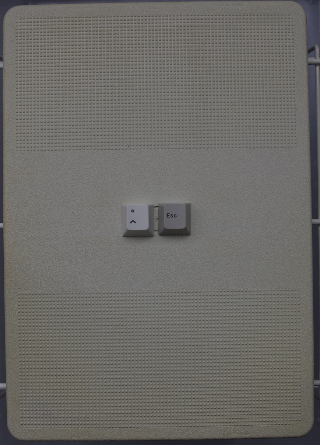

No sunshine today, so I thought I’d give it a short sunless try with the tray of a telephone swivel arm.
It was uniformly yellowed and only the top half was treated while the bottom half was left unchanged.
The two keycaps used as a reference are clean sub-dyed Cherry caps.
1st photo taken at 10:50 today just before starting:
2nd photo taken at 12:57, just after rinsing the plate after 2 hours:
The left edge obviously didn’t quite react as well as the rest,
but I would say after only 2 hours exposition to absolutely sunless daylight that is a nice result :mrgreen:

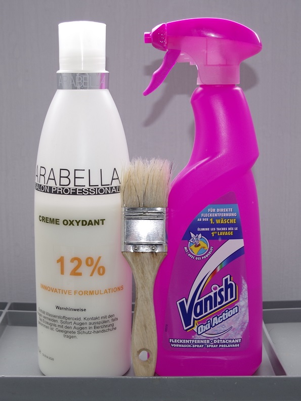

22 Jun 2015, 15:00
Here it is:
12% H2O2 cream for hairdressers (e.g. on eBay for a few euros),<br />Stain remover (Oxi Vanish) as a spray (for a few euros)
Details H2O2 cream
Details H2O2 cream
Details Oxy Vanish
Details Oxy Vanish

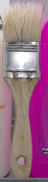

Paint brush (less than 1 euro)

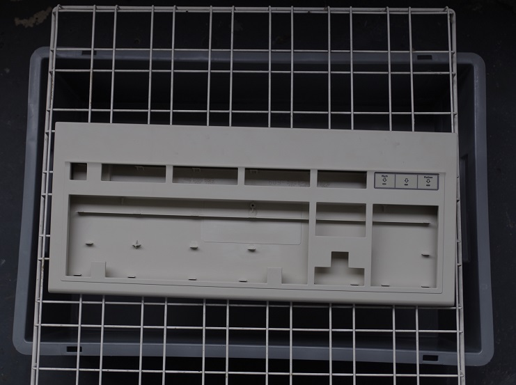

Dripping assembly, big
Dripping assembly, small
Apply H2O2 cream with the brush (not much more than a spoon needed for a keyboard case), then spray Oxi Vanish upon it and brush. Brush again in intervalls of about half an hour, adding a bit H2O2 and Oxi Vanish if needed to prevent drying (which is essential). Use gloves (OK, I don’t, I’m just careful to avoid any splashing and skin contact) and be aware the stuff will inevitably drip.
When exposed to sunlight (which obviously is necessary), a yellowed keyboard case will need not more than a few (let’s say 4) hours to look like new again.
At least that’s my experience (based on half a dozen items), but of course I won’t be liable if you mess it up :mrgreen:
