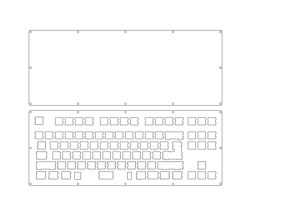

Hey, I am just wondering how many people we could get to buy this. It is a universal TKL plate, that comes with a back, so it makes a JD40 style of a case. There are two options i could use. A local place, called incodema, or Big Blue Saw. Big Blue Saw is cheaper for the single plate, but if there are more orders i could try and talk the price down. For Big Blue Saw, it would be Stainless Steel T-304, and for incodema all they said was Stainless Steel. Leave a comment below if you are sure if you are interested and can commit completely.

The picture sent to me by incodema, gives a better idea of the the switch cutouts :D

Will it not flex in the middle? The Phantom PCB is pretty thick... Shit, I'm down to try it anyway.
if we get good numbers, can we think about doing two different versions of the top? I'd like to see an ansi-150-only top.
jdcarpe
30 Jun 2015, 22:01
Be aware that with universal layout plates like that, you have to use a PCB with support for PCB-mount stabilizers. Because there is no place on the plate for a plate mounted (Cherry or Costar) stabilizer to mount to. It's just a large hole, which allows the PCB-mount stabilizer to pass through.
Joey Quinn
30 Jun 2015, 22:04
It shouldn't flex if it's made out of ss or alu. Also I'd be happy to make more plate files if people want them. I'd say pm me on GH but seeing as that's down I guess a pm on here will work.
jdcarpe
30 Jun 2015, 22:12
And no, it shouldn't flex if made out of stainless, at least.

Aluminium at 1.5mm is flexible enough to cause trouble in a PCB-less TKL.
Stainless is way more stiff, minimal bending.
I have a question though.
This is a universal plate which requires PCB mount stabs yet is designed for the Phantom, but the Phantom has no support for PCB mount stabs...so what's the point? Are there alternatives to the Phantom with PCB stab support?

That would not be possible, because it would have to be a separate buy from Big Blue. The thickness of the stainless will be 0,06 inches, so it shouldnt flex.
EDIT: just saw Joeys comment on this, so maybe! It might just change to an ANSI 150 so Stabs will be possible...

chzel wrote: Aluminium at 1.5mm is flexible enough to cause trouble in a PCB-less TKL.
Ill get back to you on that one actually, one second.
jdcarpe
30 Jun 2015, 22:21
Also, if you want the switches and stabilizers to clip onto the plate, you'll want to use 1.5mm thickness material.

Oh, I goofed my wording up there. i meant to say 0.06 inches. Whoops.

support for plate stabs would be very desirable, i don't have a phantom pcb, and I don't think it is easy to get one, but i would be very interested in handwiring a case like that!
wafflepc
30 Jun 2015, 23:34
lolpes wrote: support for plate stabs would be very desirable, i don't have a phantom pcb, and I don't think it is easy to get one, but i would be very interested in handwiring a case like that!
working on it! This might change to an ANSI 150 GB, or somehow make support for plate stabs! its like 30 dollars for a phantom pcb from mechanical keyboards btw.

Great news everybody!
Joey Quinn, who is awesome is making standard ANSI, and standard ANSI with stab clips!! Also potential price drop if the quality control is good!
