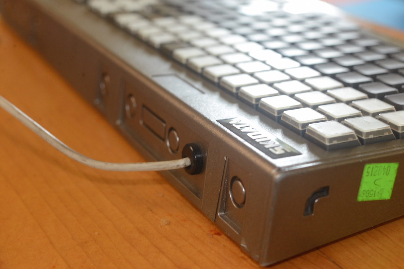

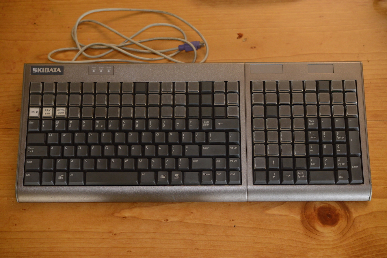

Thanks Touch_It for my first Tipro board! It seems fitting for the command deck of a spaceship. The one I got is an authentic Tipro board, Made in Slovenia, with Skidata branding. It only has a PS2 connection and no additional ports on the back. The alpha keys and the keypad are one solid board styled to look like two modules put together. I'll post photos at a more opportune time.

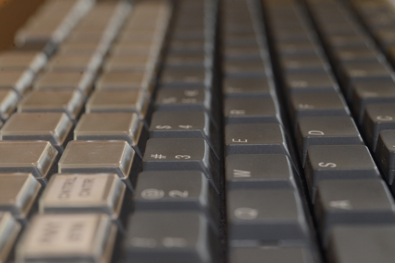

2. A number of relegendable key caps are missing: eleven clear tops and a few others (Tab, Ctrl, Left Arrow, 0/Ins). How might I find replacements?

It only has a PS2 cable! There are no additional connections on the back of the keyboard for anything else. Perhaps if I open it?

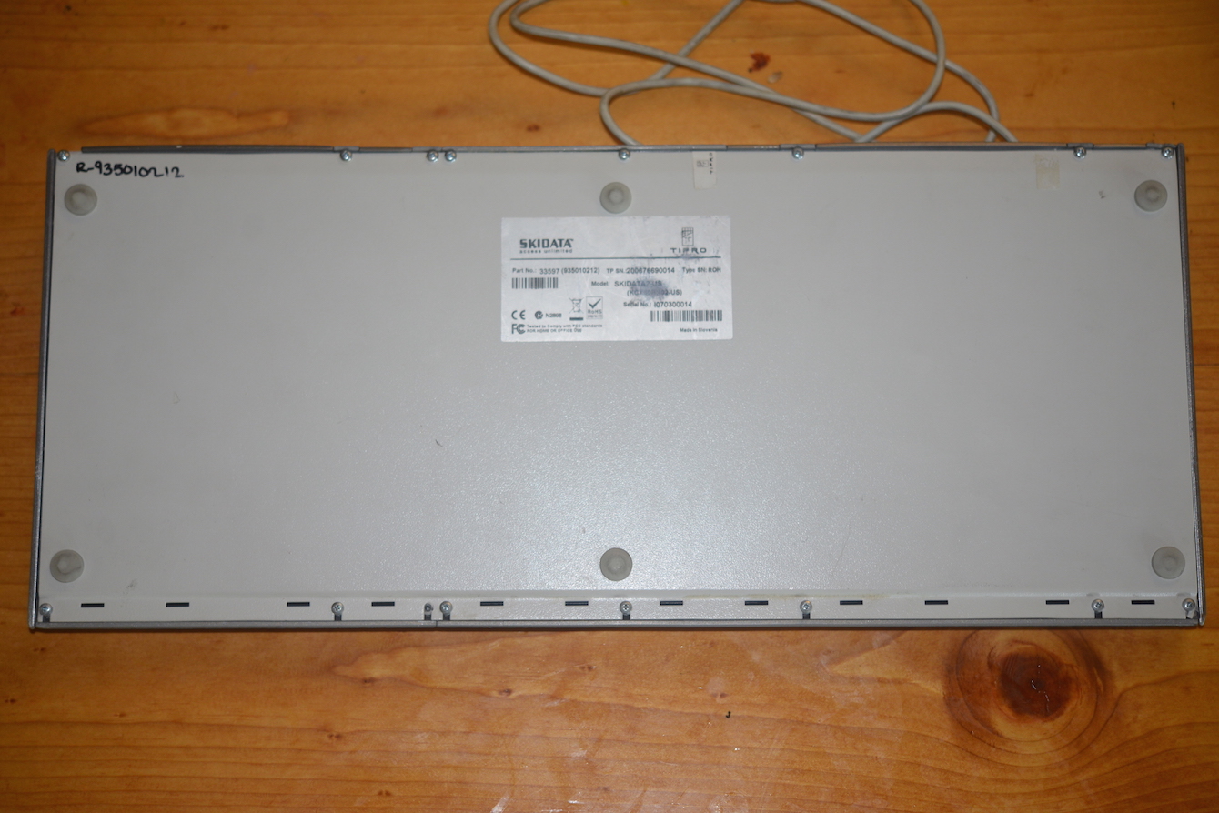

The outer case is not metal. The back plate is metal. The switches are plate mounted. The entire keyboard feels very heavy and solid.

I see, the cable is captive. Most Tipros have a "special" 8-pin connector, which essentially is PS/2 but they have 2 extra pins for serial where the rectangular thingy is on the PS/2 connector.

XMIT wrote: […] The alpha keys and the keypad are one solid board styled to look like two modules put together. […]
They are in fact two modules, but probably with soldered connectors and a common metal plate instead of the usual removable flat connector cable and separate metal plates, plus it will probably have a built-in controller instead of a swappable one. Have a look here and there.

2. A number of relegendable key caps are missing: eleven clear tops and a few others (Tab, Ctrl, Left Arrow, 0/Ins). How might I find replacements? […]
I would say you can bury any hope of finding replacements for the printed tops. It would be a real miracle - I have never seen them in that colour.
As for the clear tops, like for the Cherry relegendables I can send you a few spares :mrgreen:
And I am quite sure I still have a bag with pre-printed colourfoul tops.
Of course you can replace the caps with any Cherry MX compatible keycaps (like I did on my battleship), but note that the Enter cap is 2u instead of 2.25 and the cap left of it silly 1.25u instead of 1u (my board has been modded by CeeSA, including plate modding [!], to correct that).
