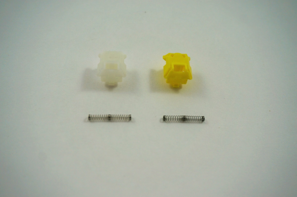

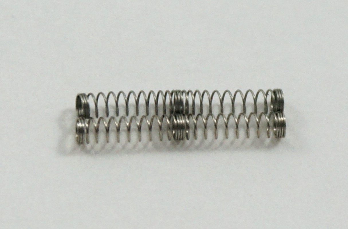

Engicoder
06 Jul 2015, 16:10
I was curious, so I compared a white (one square eye linear) to the yellows from the Kroy. Here are the photos. Sorry, I don't have a proper macro...
Yellow on top, White on bottom
Both use 0.22mm wire (measured with calipers). From the photos, they have the same number of turns, but seem to either have different finishing, or use different materials. If different alloy, could affect spring coefficient. If not, they should have very similar force curves.
06 Jul 2015, 16:25
Ah good comparison thanks.
06 Jul 2015, 21:30
From what I've seen and heard, Hi-Tek changed the force in their switches by using LONGER springs rather than tighter ones or ones made out of a different material. So as they're the same length, it's a decent bet they have or at least are intended to have the same force.
