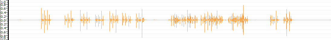

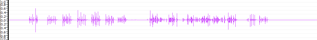

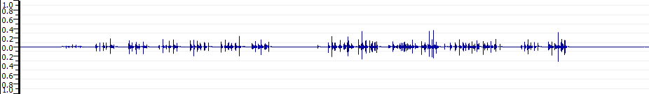

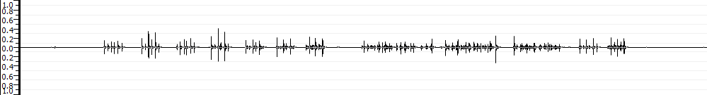

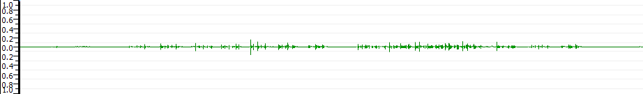

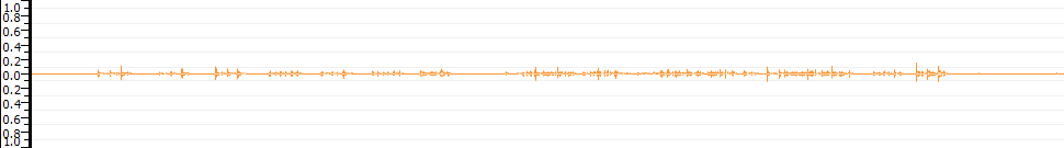

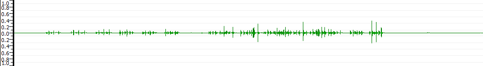

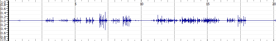

Here are some videos with audio clips and waveforms of some assorted keyboards. The selections include comparisons of a standard HHKB Pro 2 45g with 45g and 55g HHKBs fitted with Silencing Rings.
Recordings were made using a Samson Meteor Mic suspended 17 in (43 cm) above the center of each keyboard using a Røde arm with a Radius II shockmount. Recording software was MS Sound Recorder for Windows 8.1. Waveforms (amplitude vs time) were made from mp3 audio files using Sonic Visualiser 2.4.1 for Windows.
Keystrokes were 3 each of Tab, Backslash (HHKB Delete/Backspace), CapsLock (HHKB Ctrl), Return, Left Shift, Right Shift, and Spacebar, followed by 3 each of "This is this." (without quotation marks), ending with 3 each of Return and Spacebar.
HHKB Pro 2 45g Stock (No silencing rings)
HHKB Pro 2 45g with Silencing Rings
HHKB Pro 2 55g with Silencing Rings
IBM XT
CM Novatouch with Leopold PBT Keycaps
Poker II mx Brown with Imsto PBT Keycaps
Realforce 87UB 55g

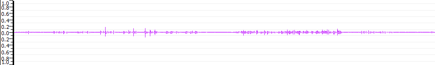

KBP V60 Matias Click
KBP V60 Matias Quiet

Great stuff, nicely done!
The waveforms really show off how effective the damping mechanism is on the Matias Quiet switches, too =o .

Very nicely done. Very impressed with how silent those Matias Quiet switches are. Wasn't expecting that.

Thanks, pyrelink! Yes, the Matias Quiet switches do indeed live up to their name. Although the timbre of the sounds differ between the silenced HHKB and the V60 with Matias Quiet switches, it appears that the amplitudes of the Matias Quiet are on par or perhaps even a bit lower overall than those of the silenced HHKB.

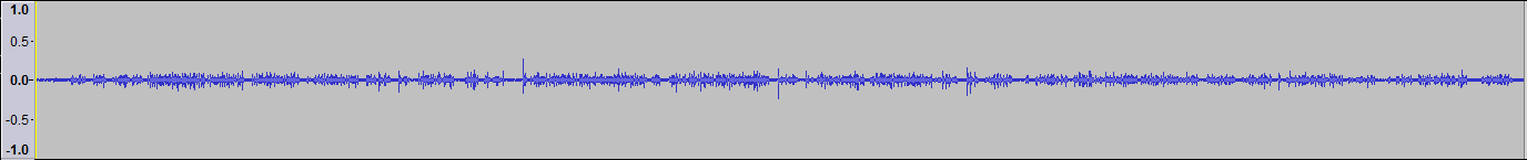

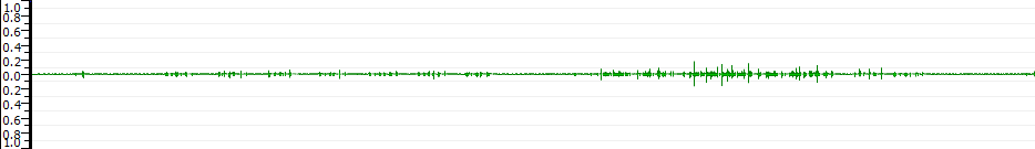

Novatouch with thick PBT caps, 55gram domes and Hyperspheres silencing rings:
waveform NT55-Type S
https://soundcloud.com/mbsoundwolke/typ ... -55g-domes
Sorry for soundcloud, but the youtube online video creator sucks...
If anyone is interested, I could also offer some other caps on the Novatouch, Gateron Blues in an Infinity, a FC660C, or some Model M/SSK goodness.

@Nacho: Thanks for the audio clip! What an amazing sound! It reminds me of bursting bubbles of hot mud from one of those geothermal springs, like Rotorua in New Zealand.
EDIT: Just completed installing 55g domes and my Hyper-Rings in my Novatouch. What a difference! The sound and feel are beautiful.
Keycaps make a big difference as well. Currently, I am using Vortex doubleshot PBT. They are OEM profile, which is high enough to avoid downstroke contact noise on most keys. However, I still needed to put a black O-ring on the center stem of the Enter and Right Shift keycaps.
Overall, the board now has an agreeable deep thock with almost no stabilizer rattle. The spacebar was a nice surprise -- low-frequency thunking sound with no stabilizer noise at all.
