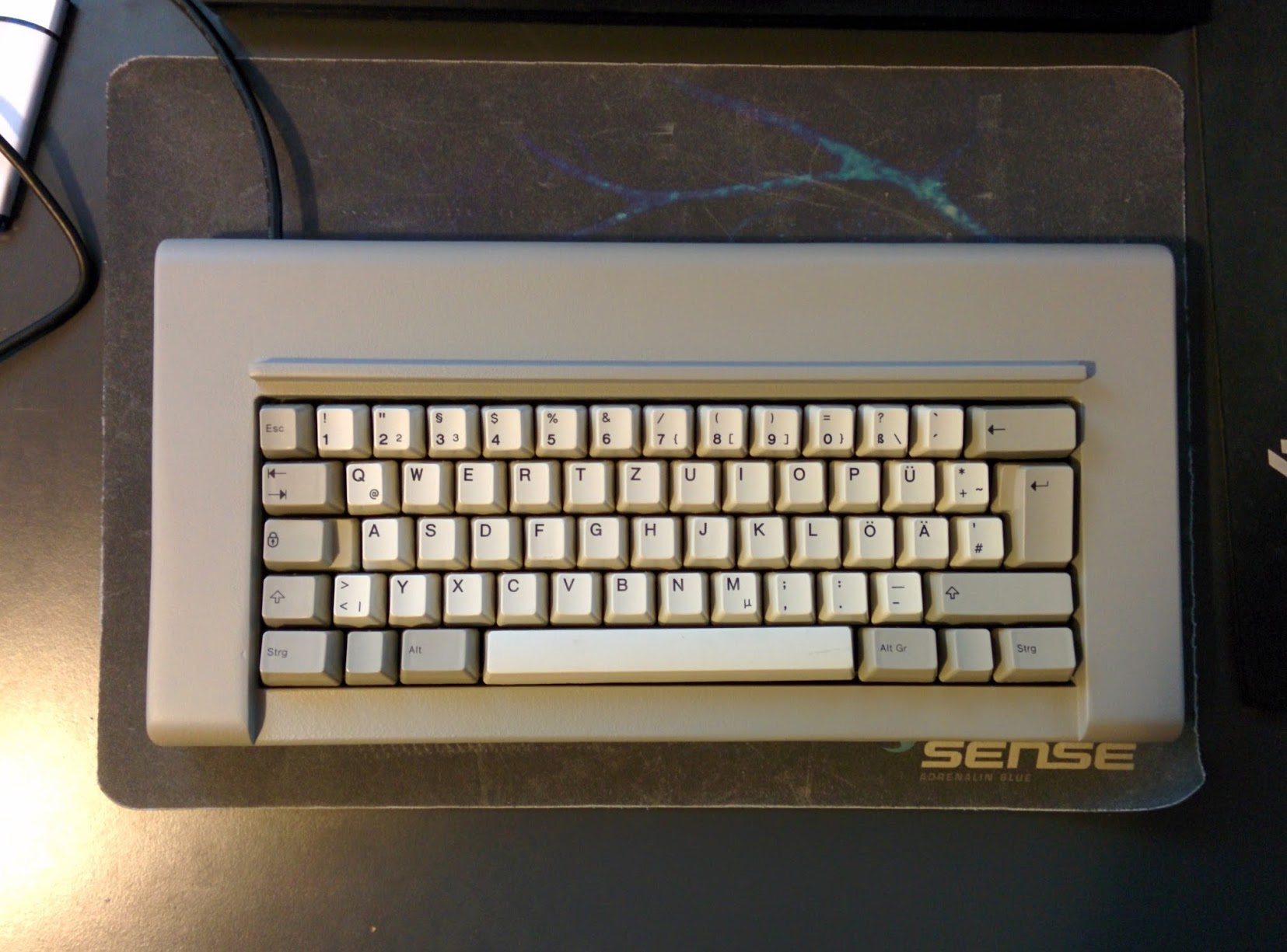

I'm in the process of restoring my F107 keyboard and decided that I would like to have it powder coated. The goal is to match the gray on my Industrial M. Some other folks have recommended RAL 7030 for this application.

I'm stealing one of rindorbrot's photos here to show what a powder coated Kishsaver in RAL 7030 Stone Gray looks like. See: http://deskthority.net/photos-f62/kishs ... ml#p148314 .

It is done! I've posted one photo here:
http://deskthority.net/photos-f62/ibm-4 ... 11432.html
I bought 2 lbs of paint and the front and back of these keyboards used 1.5 lbs of paint. I have enough paint for at least 6 more of these (the painter said "a bunch more", his exact words). The paint expires in a year.
