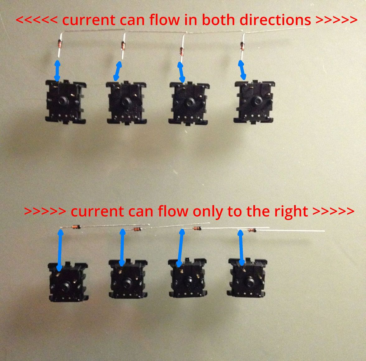

Hi! Usually rows are wired with diodes like the upper part of my photo shows. But will it work when I wire them as shown below, too?
11 Aug 2015, 12:00
Nope. They must be in parallel. Your second picture is electrically equivalent to just one diode.

jacobolus
12 Aug 2015, 02:59
Muirium isn’t quite right here. A bunch of diodes in series with a branch toward each switch is definitely *not* the same as just one diode.
There’s still a problem though, which is that if you have diodes in series, you get a voltage drop across each one.
The way you should think of your keyboard matrix is: you’re making a grid of rows and columns, where each intersection between a row and a column is blocked by a switch. The goal is to make sure that even when multiple switches are pressed, current is only flowing in one direction through each switch itself, so there’s never any confusion about precisely which switches are pressed.
So what you want is to build a bunch of little gadgets each made of a switch plus a diode in series, and then stick one of those gadgets at each row/column intersection.
Each “row” and each “column” you can just think of as being anything that is directly connected by wire to a particular input or output pin. In practice people sometimes solder the legs of the diodes to each other as a way of connecting one side of each of those diodes to the same microcontroller pin, but if you wanted you could have a separate little wire connecting each diode to the appropriate I/O pin.
12 Aug 2015, 17:15
You could get ghost keys with that wiring, but only from the left to the right.
hrvoje
17 Aug 2015, 17:56
Standard diodes have a voltage drop of around 0.6 V. If bunch of them would be wired in series like that, it would soon fall below the threshold where the circuit detects a logical 1...
