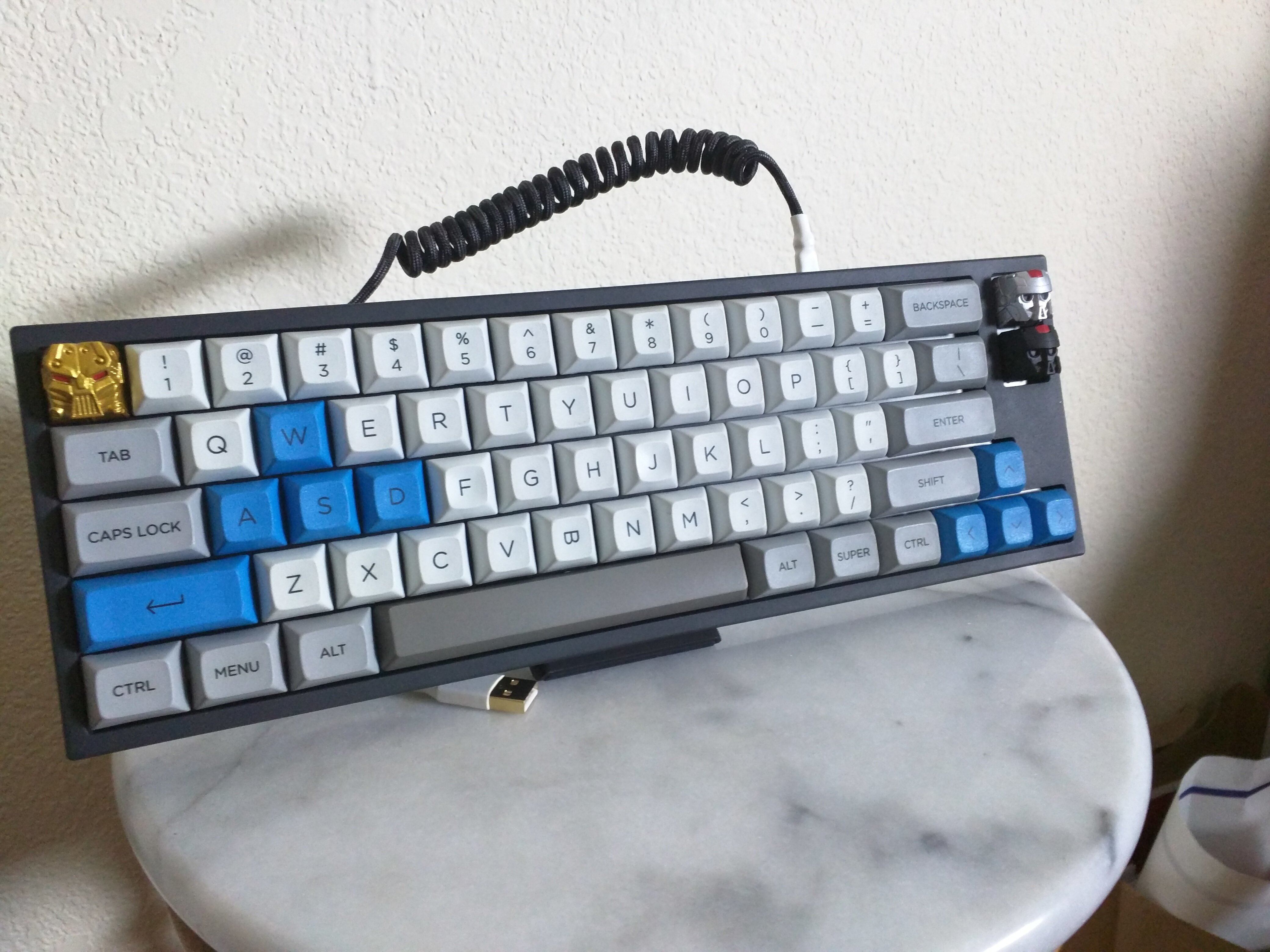

So last night I finished the "Landing Pad" and lube mod originally posted on Geekhack for Novatouch stems by user "Spicebar", found here: https://goo.gl/lMwKT9. Before the mod the stabalizers were just terrible. I was honestly expecting a lot more out of cooler master, especially for such an expensive board. That said, harvesting the stems from a used Novatouch for $140 was certainly a lot cheaper than having them individually 3D printed. While I was pleasantly surprised that the stabalizers fit my Fc660c to a T, the quality of the plastic is still very sub par. I think the biggest issue was the fact that the stabalizer keys shot back up with more force than they were pressed down, causing quite a harsh rattle. After ironing and applying the landing pads and lubing the stabalizers, however, the board now produces probably the most satisfying thunk I have ever experienced. I still think I could benefit from adding 55g domes and springs, but until I'm able to find a Realforce at a decent price, that's going to have to be put on the back burner. I wish I would have taken a " before" sound test, but I am planning on making a video showcasing how these sound. I'm also planning on ordering more landing pads so I'll make a before and after for silencing my HHKB as well. Stay tuned..
