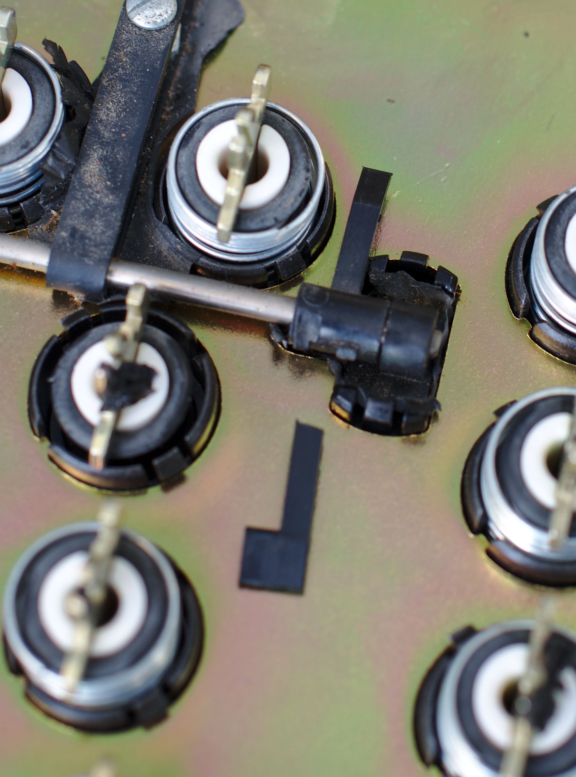

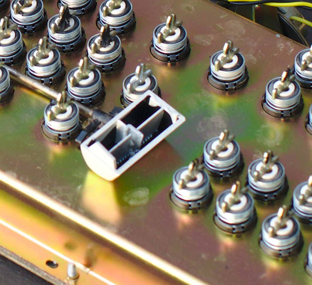

30 Aug 2015, 19:17
Here they are:
[ XMIT ]
30 Aug 2015, 19:25
This is the Lock key that is (correctly) missing a spring. The beam spring mechanism pulls the key down (or rather, pulls the sensor foot to remove force from the key press, designed to emulate a Selectric typewriter moving the interposer bar out of the way on a key press). The Lock key stays down. A foot and a linkage connected by a linkage bar to the two Shift keys is responsible for popping it back up.
So, it's not missing per se, it was never there to begin with. But I agree that it would be nice if that key had a spring.
If you do add one - you will need to remove the linkage mechanism as well.
I'm considering stealing the switch immediately to the right of Backspace on my setup. One less key, but then I get my Lock key back as a usable key.

XMIT wrote: This is the Lock key that is (correctly) missing a spring. The beam spring mechanism pulls the key down (or rather, pulls the sensor foot to remove force from the key press, designed to emulate a Selectric typewriter moving the interposer bar out of the way on a key press). The Lock key stays down. A foot and a linkage connected by a linkage bar to the two Shift keys is responsible for popping it back up.
Yes, it is the lock key.
Let me check this bar... I did not know what is was for. Actually a plastic piece felt. It could be that something broke.
idollar
i$
30 Aug 2015, 19:37
Broken, indeed.
I guess that I will not be able to glue it back together (I will try anyhow)
scottc: I will need your spring :shock:
Interesting! How did you learn this?

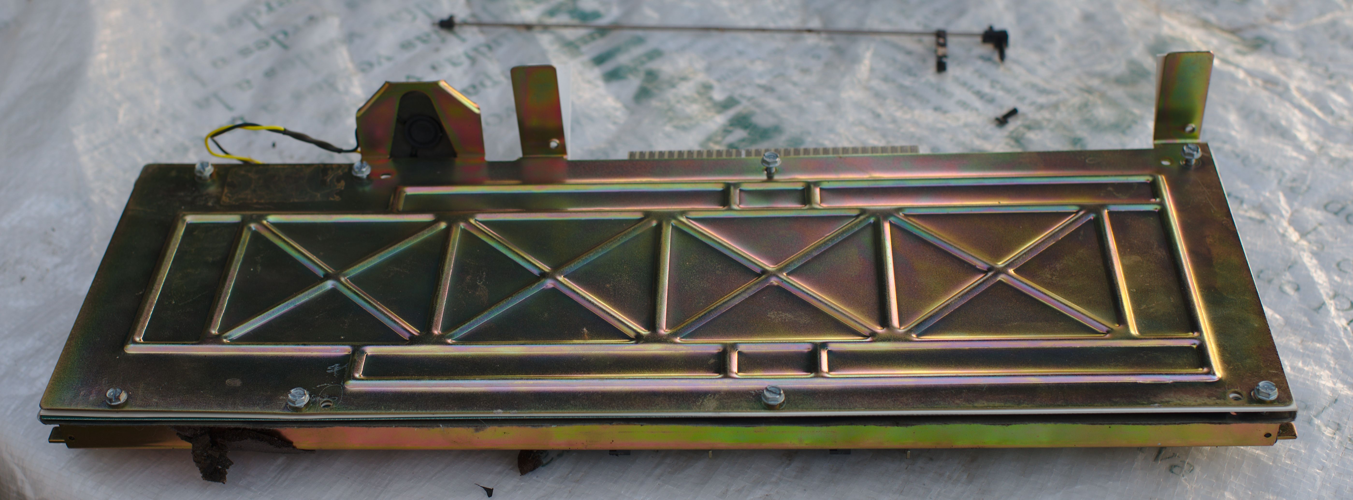

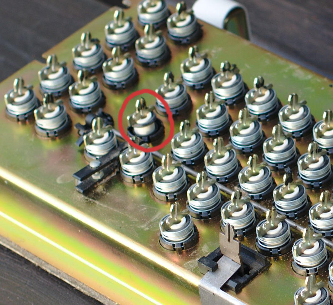

30 Aug 2015, 20:50

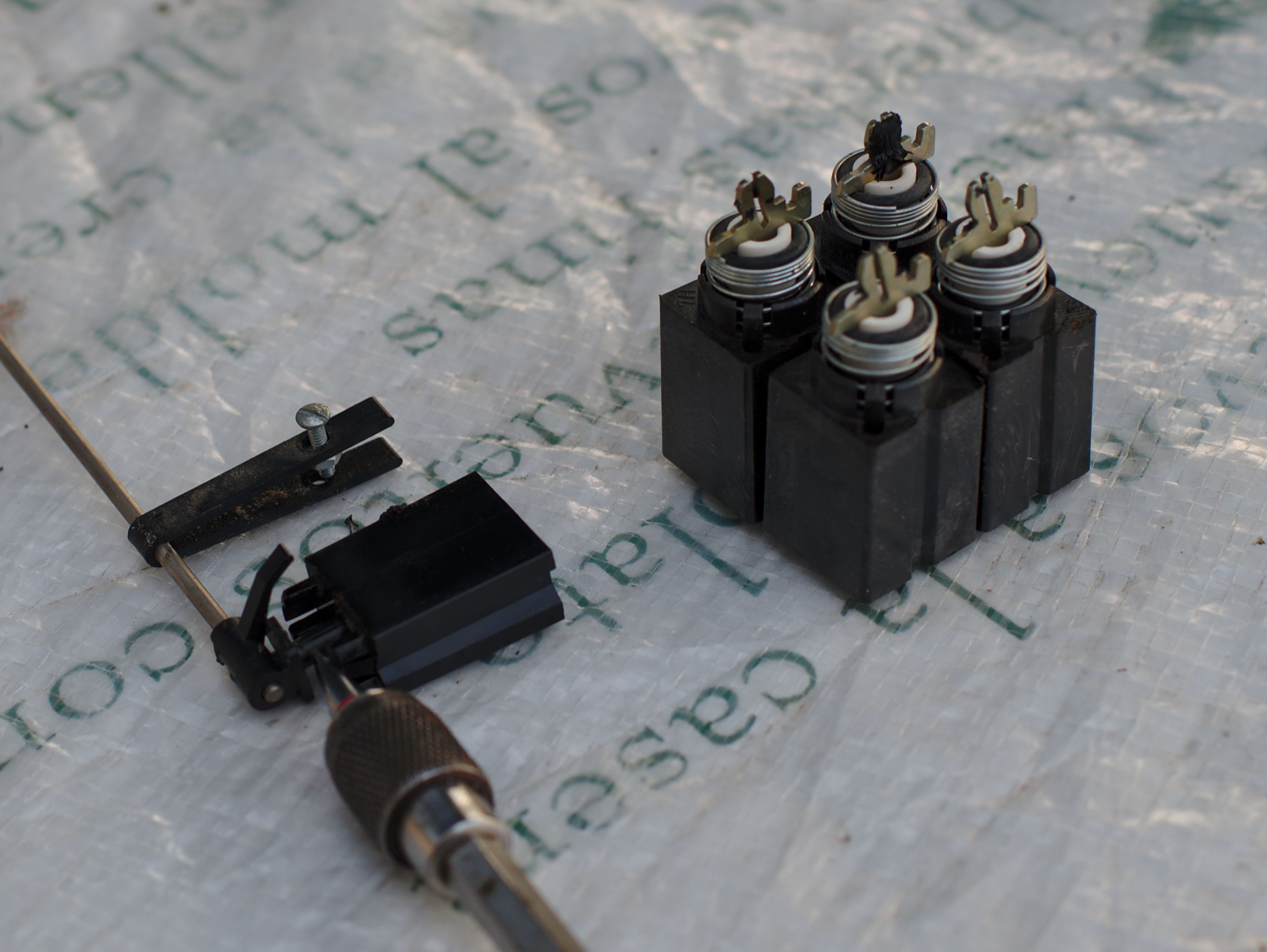

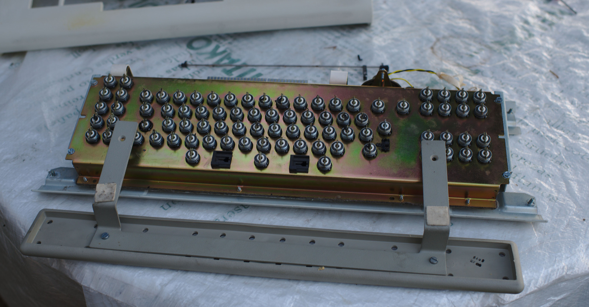

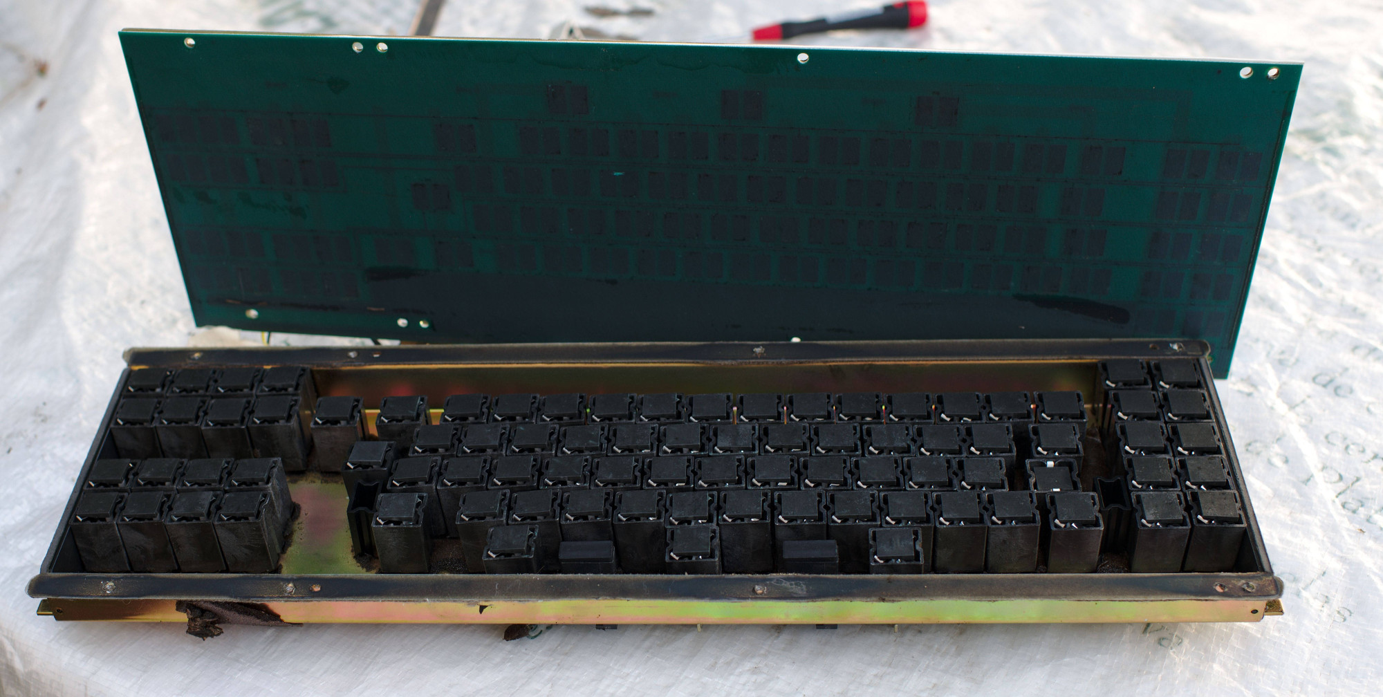

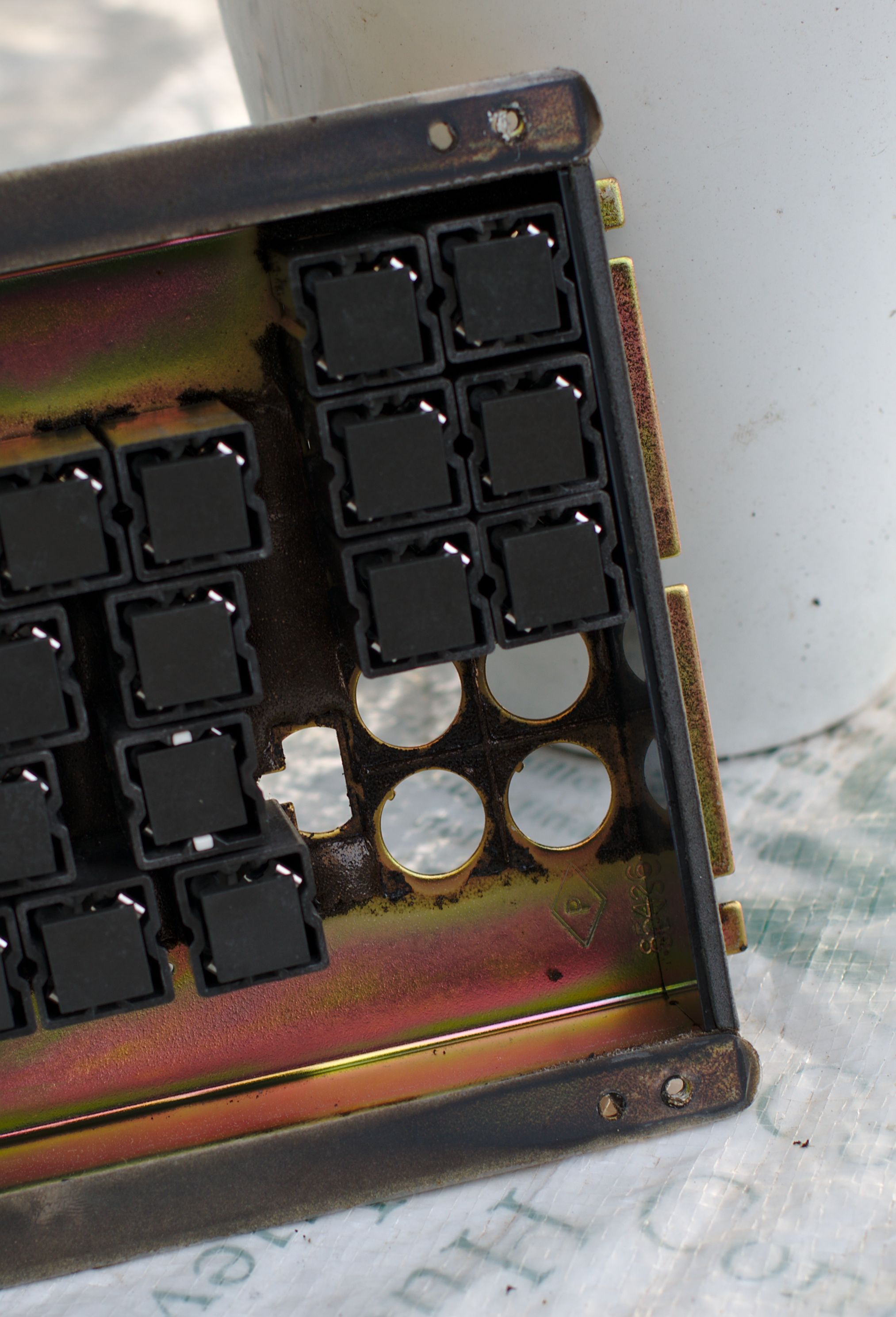

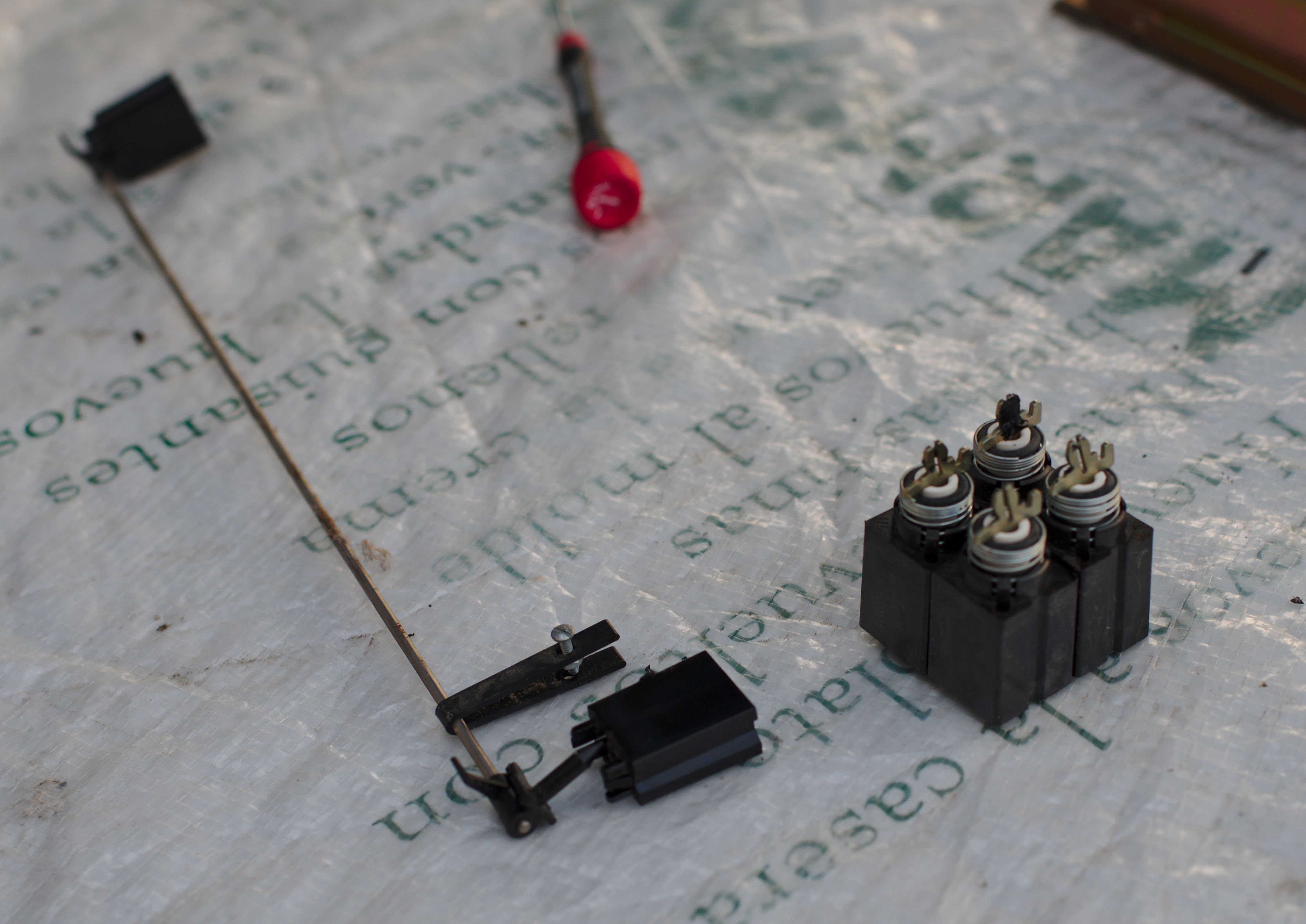

I send some pictures on how to dismantle the bloody bar.
I ended up taking apart the board, including the PCB.
There is a plastic piece underneath that uses the same type of clips that the switches have. There is a kind of an arrow inserted on them. One can push them up:
In the following picture I show you how to push up with the screw driver.

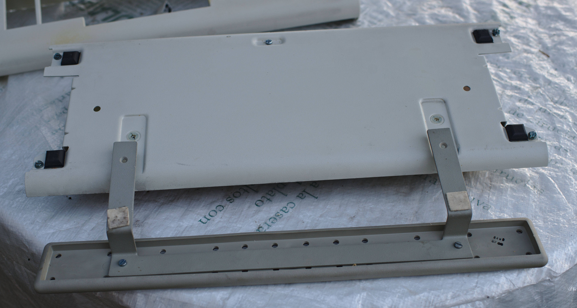

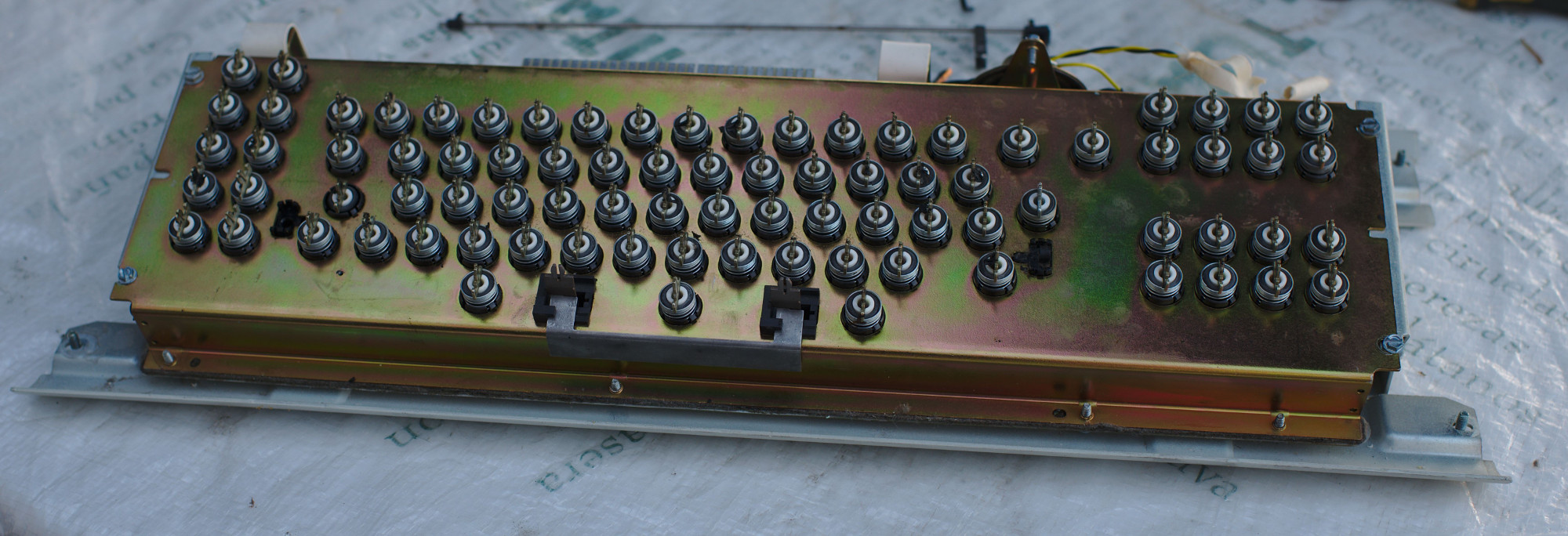

And we all know that this is not an entry of the "lots of pictures" series, but the camera was on the tripod.
As veryone knows that the best way to avoid loosing parts of a keyboard is to store it mounted. In the process of mounting it back, I took some pictures. Note that I left the controller dismantlement.

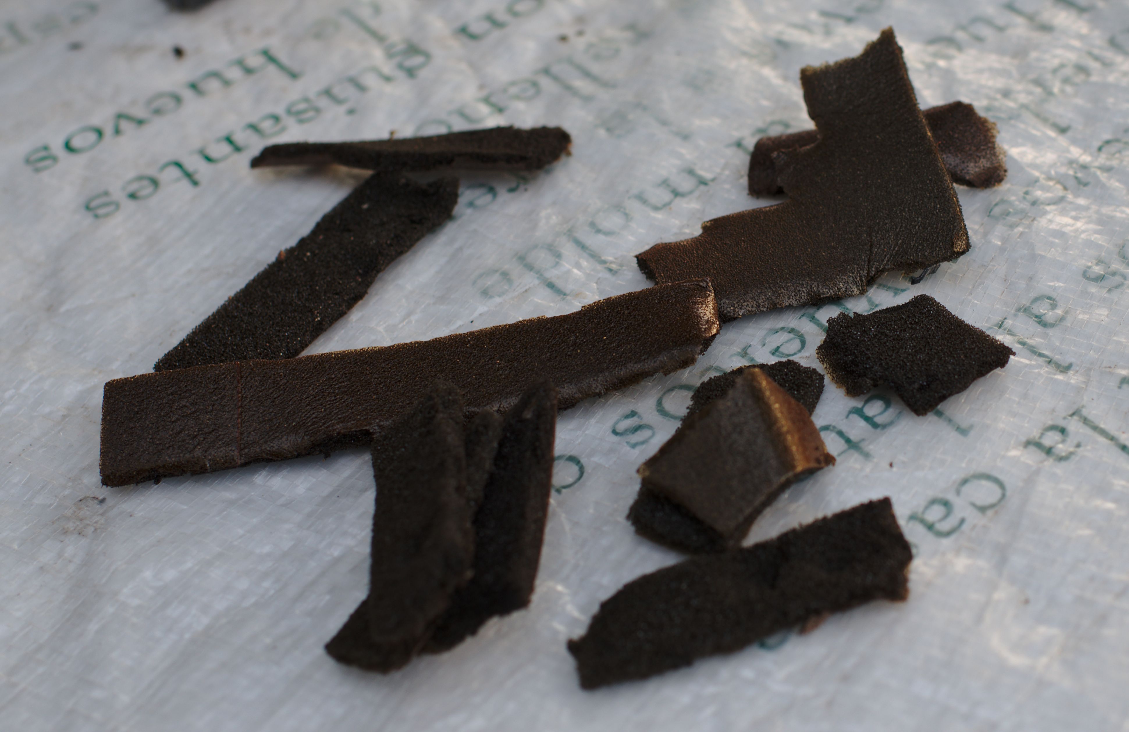

The foam felt apart when I took the bottom. It was very fragile and would stick to everything:

30 Aug 2015, 20:56
This is who the switches that I took out to check the plastic mount under the arrow show above look like:
You can see the place for the plastic mount on the left of the missing switches.

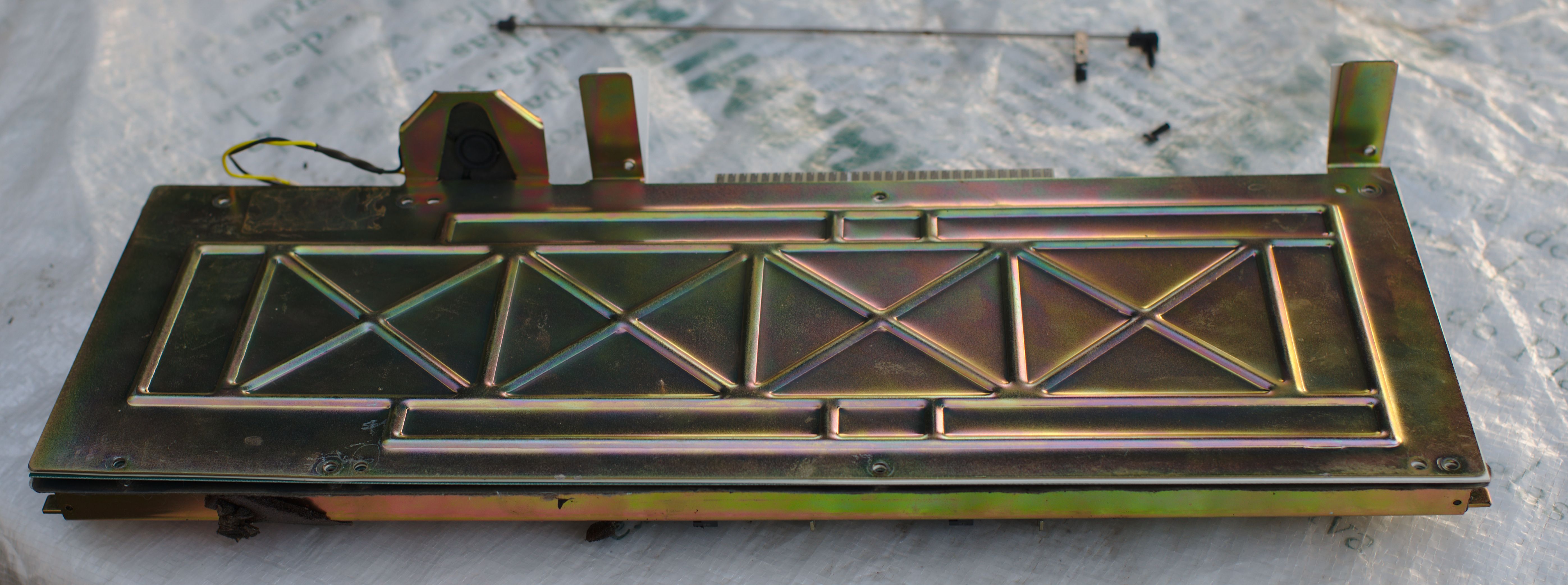

30 Aug 2015, 21:05
The PCB and before mounted back

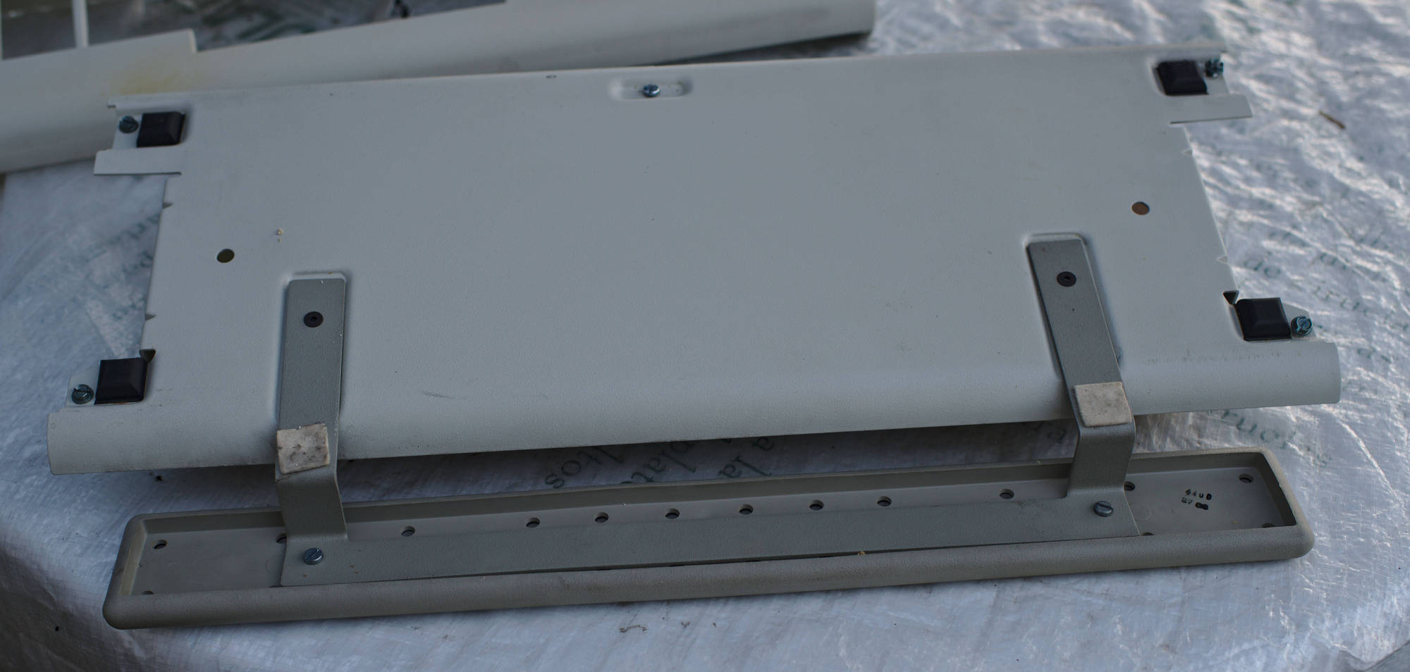

Back plate:
idollar
i$
30 Aug 2015, 21:08
In the case:
idollar
i$
30 Aug 2015, 21:09

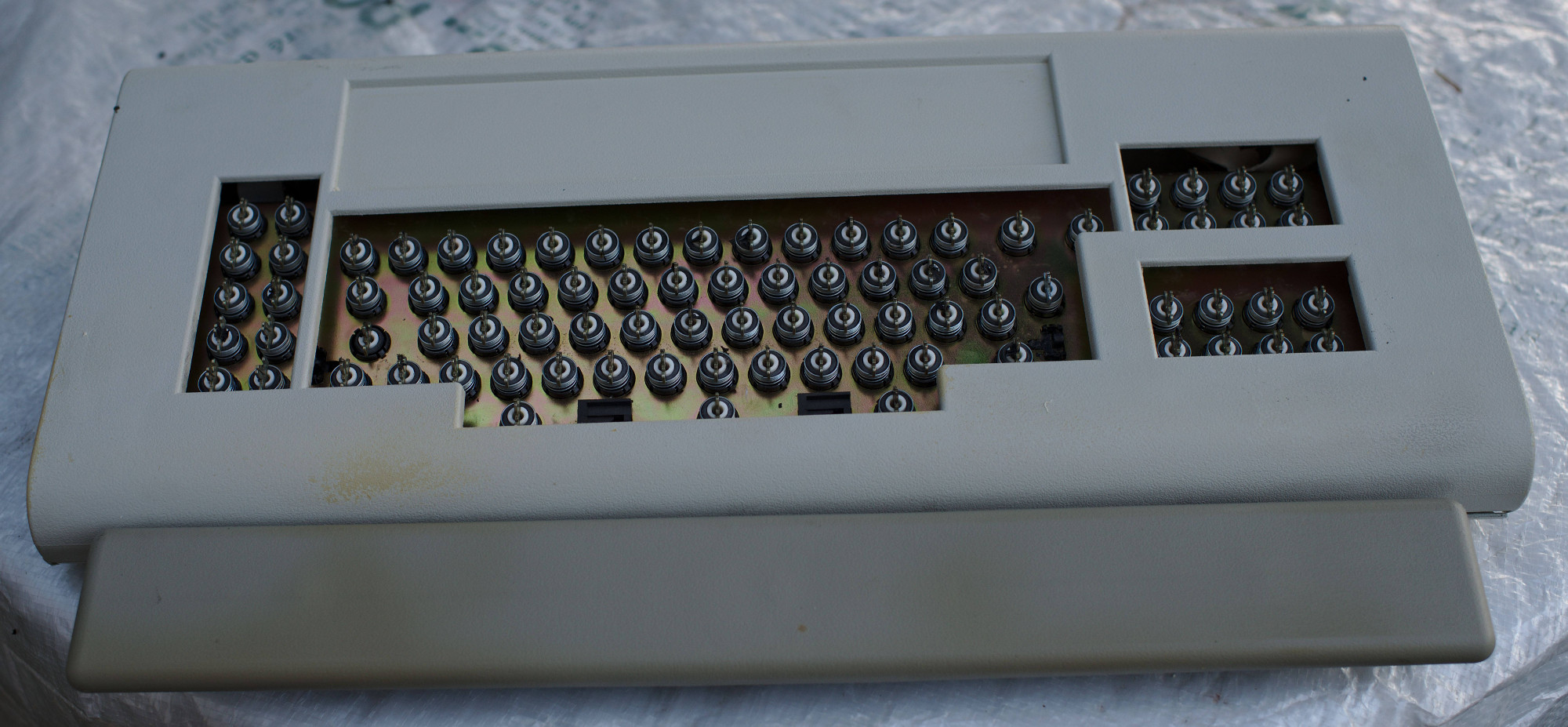

And the palm rest:
idollar
i$
30 Aug 2015, 21:10
The top:
idollar
i$
30 Aug 2015, 21:12

Yeah, it's okay that the foam is so degraded. I would be sure to remove as much of it as you can, and to give all of the individual switches a (gentle!) bath in isopropyl alcohol. Otherwise, between the contamination shield pieces and the foam, you'll end up getting little bits on the PCB that will interfere with sensing and render the keyboard useless until you clean it again. (Ask me how I know.) You can maybe replace that foam with the same sort of foam you might use for a Model F - it serves the same purpose - but you will need to draw your own template.
