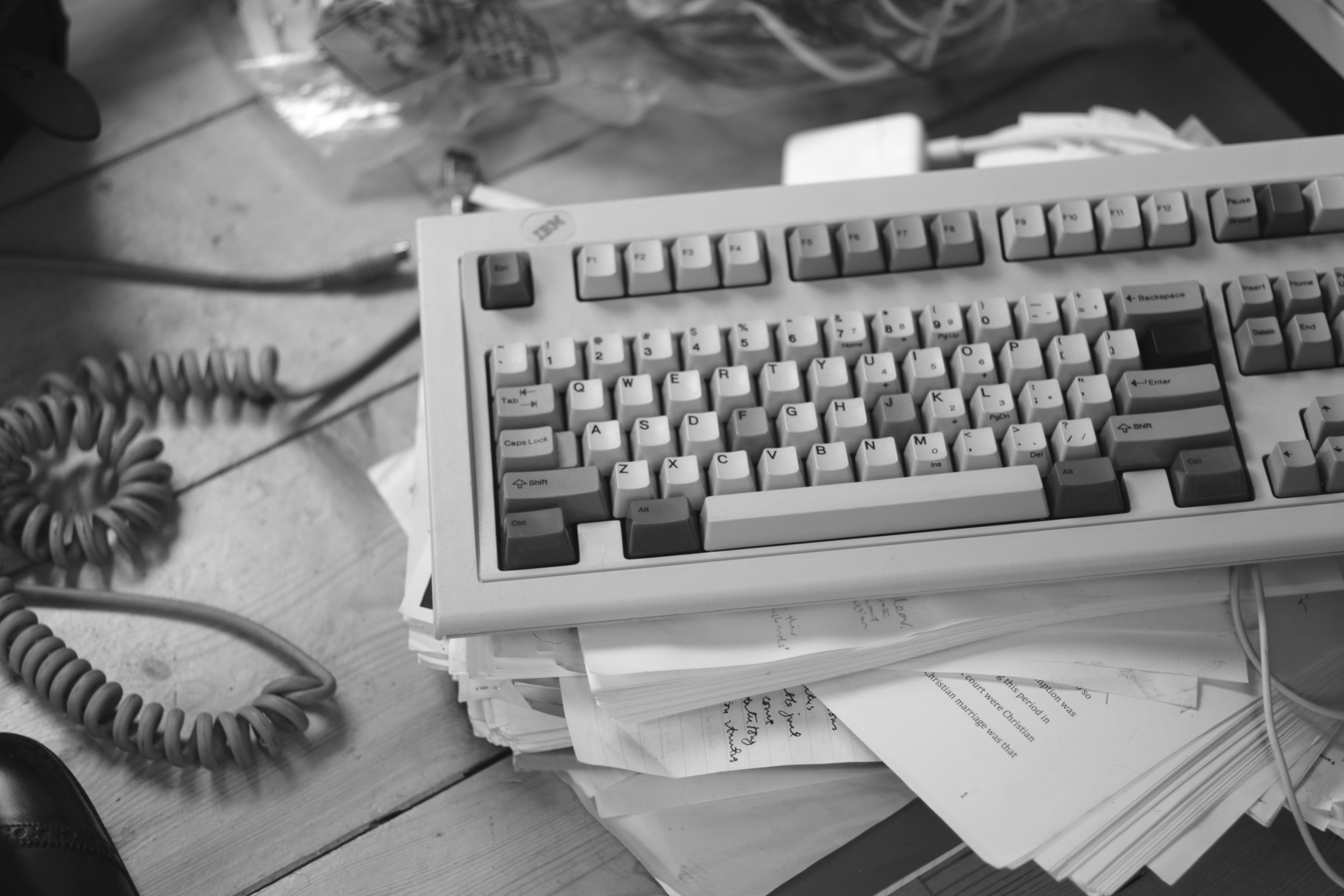

Just bagged a mint ISO layout model M for £20. Utterly delighted. It's a 1990 model with a grey label. A shame it doesn't have a proper birth certificate but a crappy thermal label on the back side.

Does anyone happen to know if on older Model Ms, the ones with single piece caps for example, should the F and J keys be the same, or are they two-piece, perhaps to accommodate the raised bottom edge indicating 'home keys'?

Should be all single piece caps across the board. IBM migrated to two-piece caps for some other reason (surely some way to reduce costs, knowing them) and so you'll find there's nothing special about F and J. Indeed, even late IBMs and Unicomp today use single piece caps for the larger mods like Shift.

Ta Mu, I did find it strange. Additionally, the feeling of the full size beast is rather different to the dinky SSK. It feels more tinny and somehow 'lighter' in touch. Still bloody nice to type on and I'd forgotten how nice the ISO layout can be. There is a distinct rattle from the space bar but it seems to be seated properly. The rivets are perfect, not one single breakage in all these years. Just given the external casing a good old wash under the tap and it has come out like new. I suspect this was a home user board given the condition. The chap who sold it to me knew what it was and said it had belonged to a friend since new and was gathering dust in her attic. He was gifted it and washed all the keys before starting to use it at work. His RSI means he can no longer use it sadly.
If Mu or anyone else knows how to cure the tinny sound, especially from the space bar, I'd be pleased to know. Will make a short video and upload at the weekend. Perhaps this is how my SSK should sound!

The loudness in spacebars is due to the stabilser. You might want to grease the wire where it meets the plastic. I've not tried it, but that's the kind of trick people often use.
