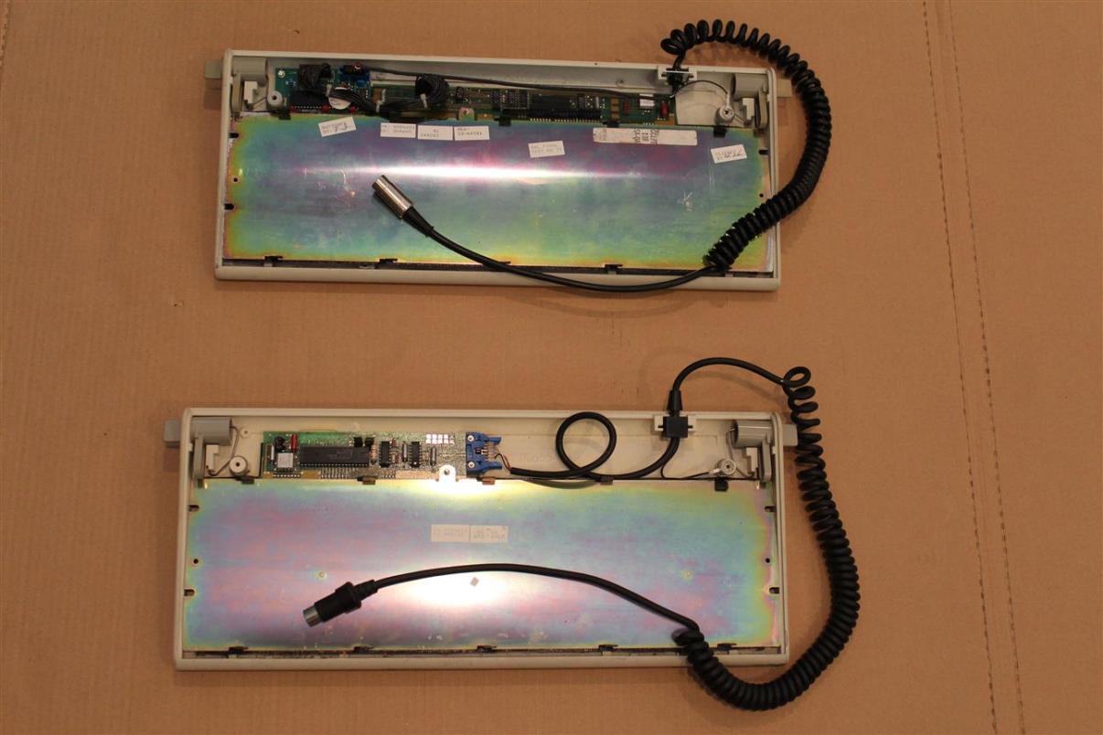

For identification purposes, here is a side by side. Notice the early ones have a metal connector and are quite different internally.
Side By Side (Custom).jpg (90.93 KiB) Viewed 1325 times
