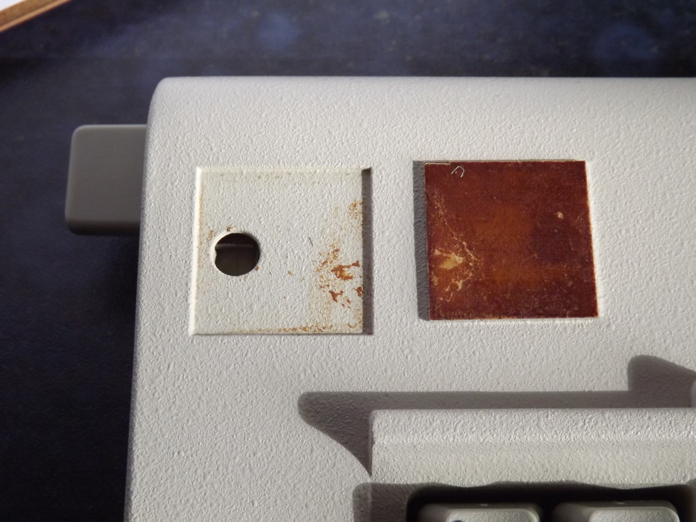

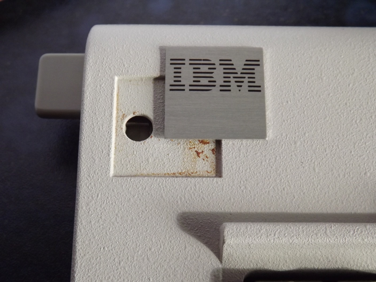

May I request some advice please, about appropriate types of glue? The IBM badge popped out of the Bigfoot. I'm grateful that it remained stuck fast until it reached me, it would have been much missed.
Options I considered are:
  • Cyanoacrylate -- superglue, loctite etc. which sometimes leaves a misty white bloom on some surfaces, and reveals fingerprints, due to the vapour it emits while setting. I don't want to mar the appearance of the badge;
  • Epoxy -- this feels too permanent. Might not really be a problem, I doubt that I want to remove the badge;
  • Silicone sealant or some other decorator's filler. Less permanent, but might not be sufficient to hold the badge secure.
  • Double-sided sticky tape. Not really appropriate in my experience, some brands of tape I have used have not aged at all well, becoming brittle or turning into goo. The sponge tape variety will make the badge protrude from the recess, and make it vulnerable to scratches.
Are there other options? Has anyone experience with the above, or can suggest an alternative?
How should I try to remove the old brittle brown glue residue on the badge and case?

i would go with contact adhesive, easy to remove if you get it in the wrong place as it only sticks to itself
the old glue ? I would get some wet and dry sandpaper http://www.screwfix.com/p/titan-wet-dry ... f-10/32368
but a very fine one

26 Sep 2015, 16:00
It does look a bit like impact adhesive
26 Sep 2015, 16:26
I recommend naptha (old-fashioned cigarette lighter fluid) for removing old adhesive. But be careful and work quickly - it can damage paint. And thoroughly remove the residue ASAP afterwards.

There is a 3M product specifically for gluing metal emblems onto various surfaces:
http://www.amazon.com/3M-08061-Plastic- ... B0002MID28
The solvent in the glue will dissolve paint, so be careful about getting excess glue on painted surfaces.
