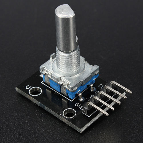

I was looking at something like this: (just what I found when I searched eBay for rotary encoder earlier)
Would that work? If not, what sort of thing should I be looking at?

I'm sorry I can't tell anything about that encoder from just that image. I would need more info.
Plasmodium
10 Oct 2015, 18:07
Findecanor wrote: I'm sorry I can't tell anything about that encoder from just that image. I would need more info.
Fair enough - this is the listing: http://www.ebay.co.uk/itm/1Pc-KY-040-Ro ... 5d4b76706c
There are plenty of similar-looking ones on ebay, this one just caught my eye because of the PCB mount.

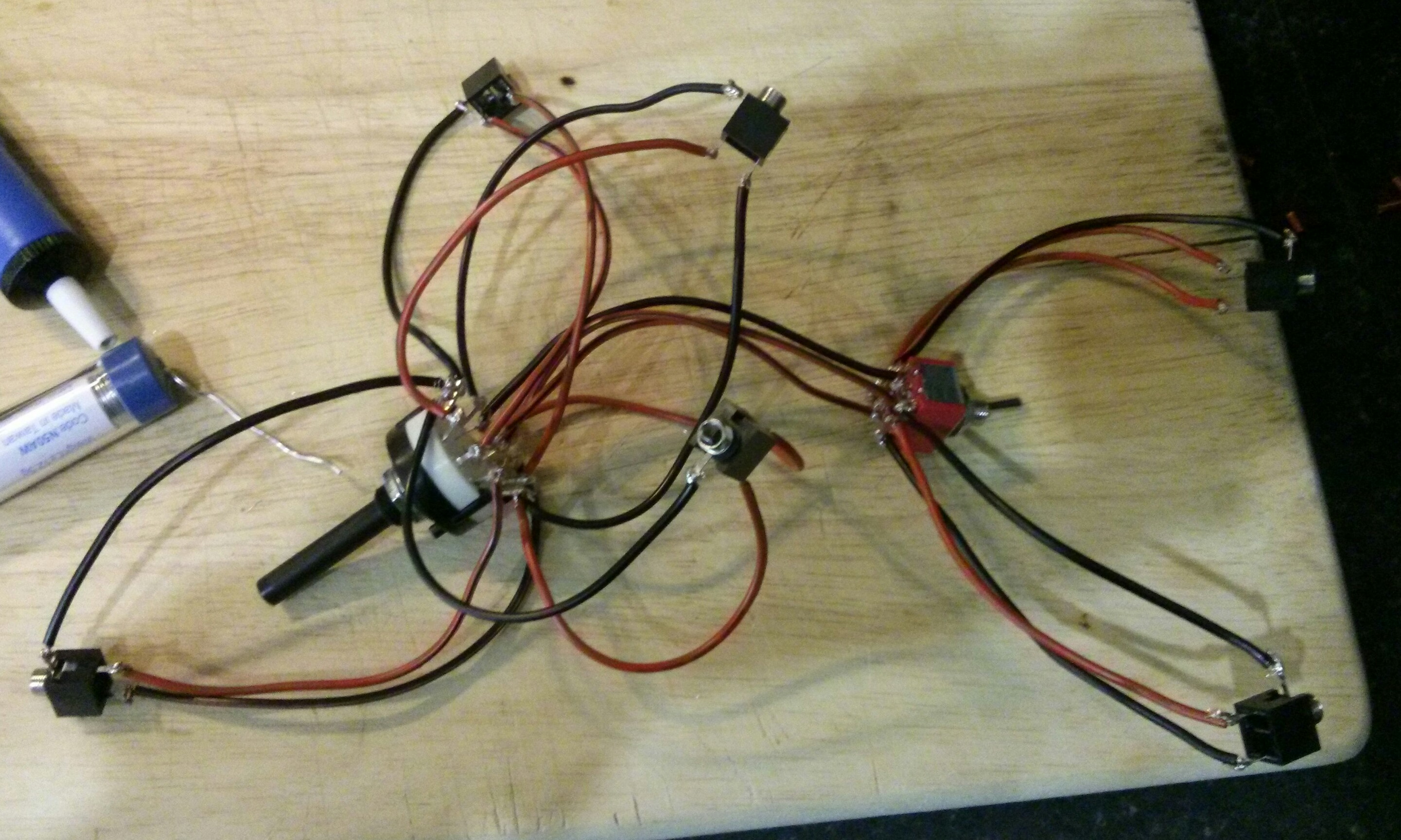

Right. I got the easy half of this done last week - the easy half being the audio in/out switch. It was subject to a wee bit of feature creep, as it now can not only select one of two outputs, but also one of four inputs. So, I could play music at my desk without having to turn my PC on or unplug and replug the cable into my iPod. Or, for example, when I move next year I might need to put my Wii on my desk instead of in my shared lounge. I will be able to switch between audio sources easily.
Here's a crappy photo: the rotary switch does the four inputs and the toggle switch does the two outputs.
The harder bit comes this afternoon. I've got a cup of tea made and a soldering iron warming up, so I'll be trying out the rotary encoder with the Teensy. I won't be putting the media keys in until I have the box I'm going to put it in (I have a few ideas about that) because you need to push MX switches in from the front of the plate, meaning you have to solder them up after they're mounted. But you all knew that...

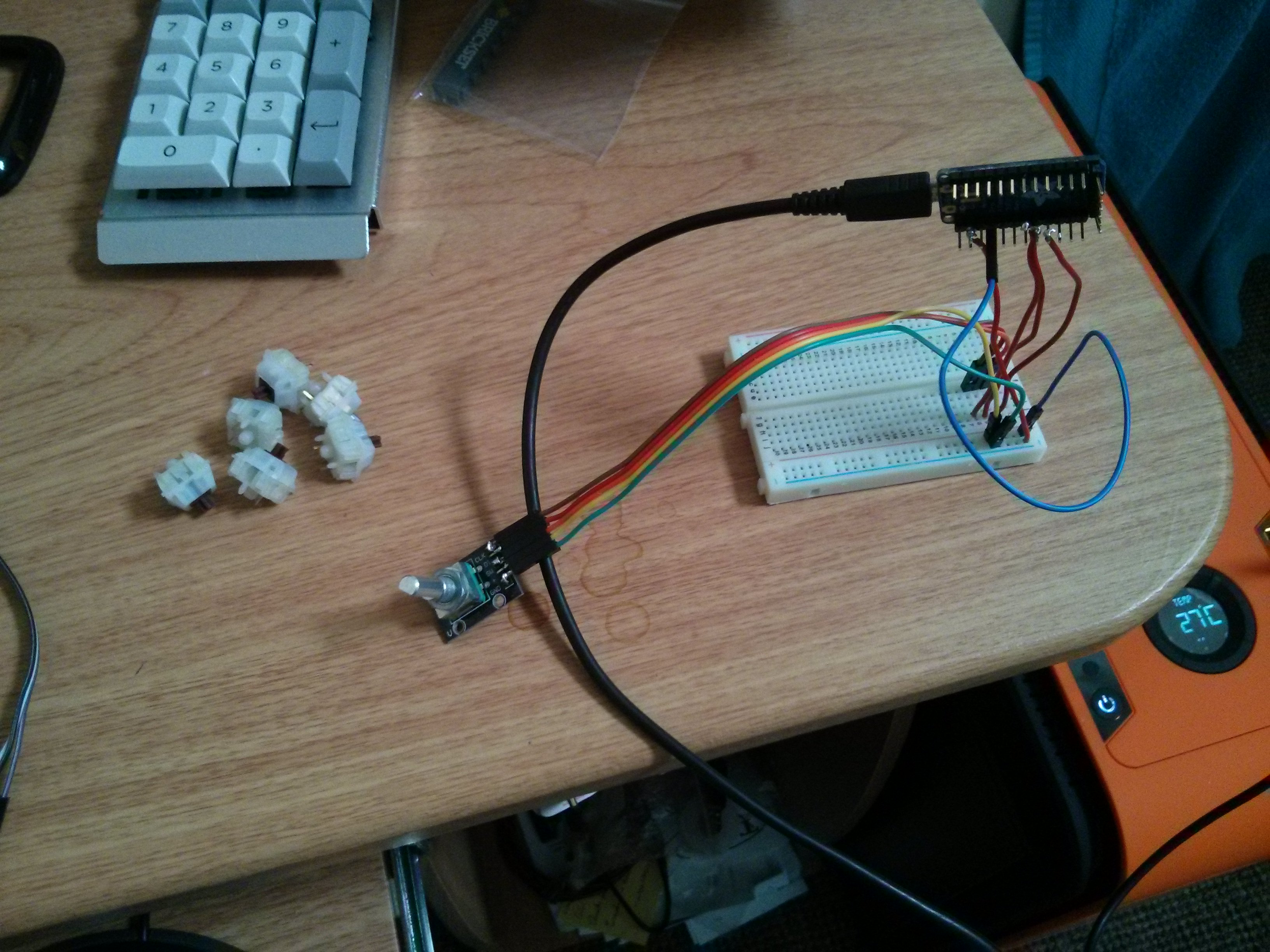

Plasmodium
26 Jun 2016, 16:53
Well. After a wee bit of googling, trial and error, fiddling, ordering bits and bobs off eBay, we have a working volume knob. Using the code from the tutorial linked to above, but a different circuit design, due to my encoder having debouncing circuits built in. Works well enough - next step: integrate those six Gaterons you can see there! Any suggestions for features? I want to use 6, but can only think of four functions as of yet: play/pause, skip track forward/back, and lock screen.

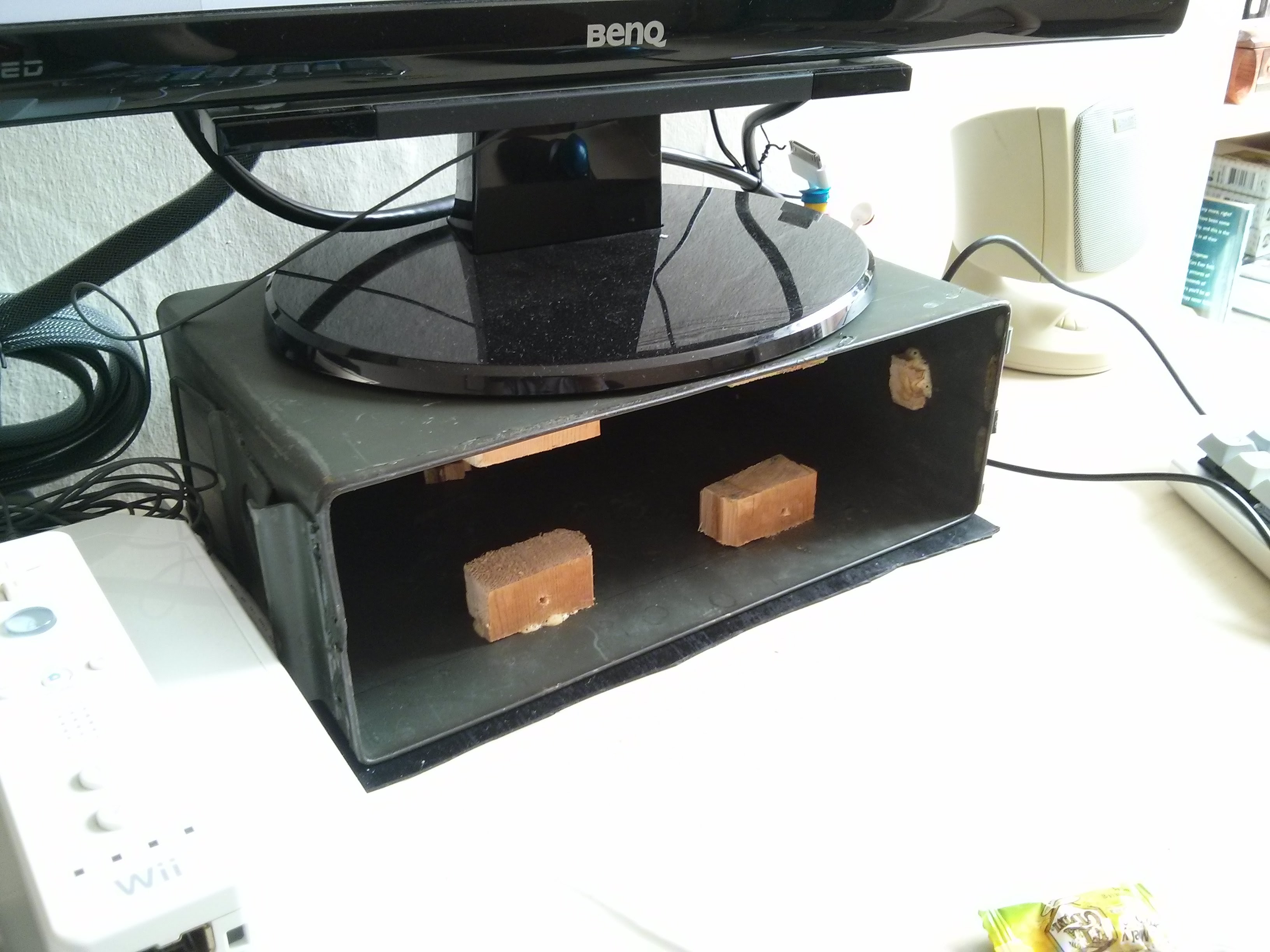

Right. This project is 95% complete now! Hooray! It's now drifted a little away from its keyboard roots, but it's still an input device, and it still has some MX clone switches in it, so I thought I'd post a sort of buildlog (thanks @Phenix for reminding me!).
All that's left to do now is:
1) drill one more hole in faceplate for USB cable to exit
2) screw faceplate into main box
3) Make some nice sleeved jack to jack cables for the audio switching part!
As you can see above, my original plan was to have an audio output switcher so I could switch between headphones and speakers with the flip of a switch. I planned to include a USB volume knob and some media controls just for the heck of it. I eventually decided to add an input switcher, so I could plug my PC, iPod, phone, tablet, Wii, etc in and switch between which was outputting sound through my speakers with the twist of a dial (though my dial only has 4 positions - I'm thinking PC, Wii and two spare aux-in's depending on what portable device(s) I might have on me).

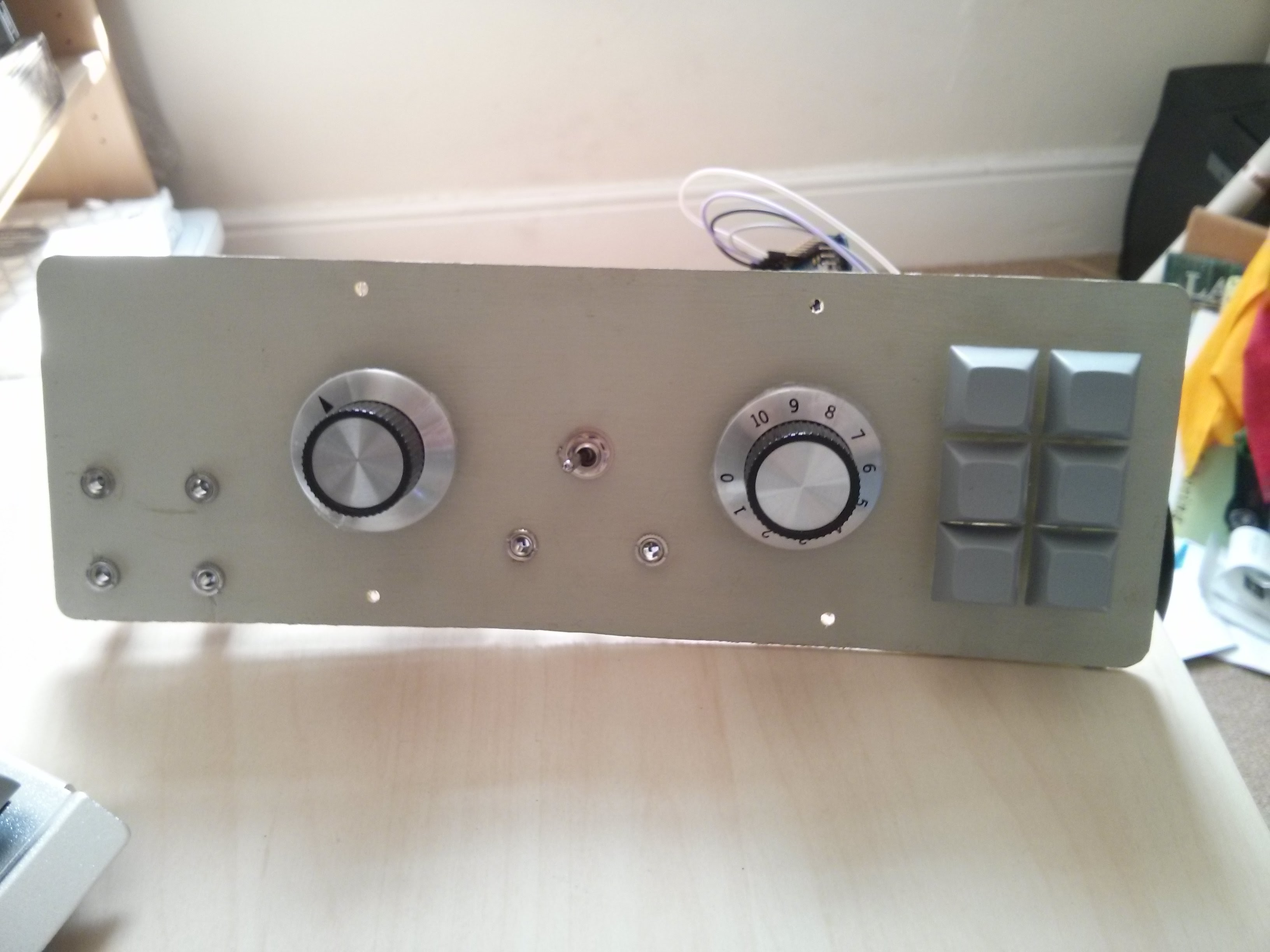

So. Here's the front of the faceplate:
The four jacks at the left are the inputs, the dial next to them is a rotary switch with 4 positions. The wires then run to the switch in the middle, which selects between either of the jacks below (outputs).
The right dial is volume, and is connected to a rotary encoder which in turn is connected to an Arduino Pro Trinket, as are 4 of the switches to the right (I only wired up 4 because I couldn't think of uses for the other two and I'd run out of those little jumper cables. But I can always wire them up as and when I get ideas for them!). The switches (top left to bottom right) do the following:
1) Lock - this sends the Windows 'lock screen' key combo (Win+L). I set up a custom keyboard shortcut in Linux so it also works on my dualboot setup.
2) Play/pause media
3) Skip to previous track
4) Skip forwards

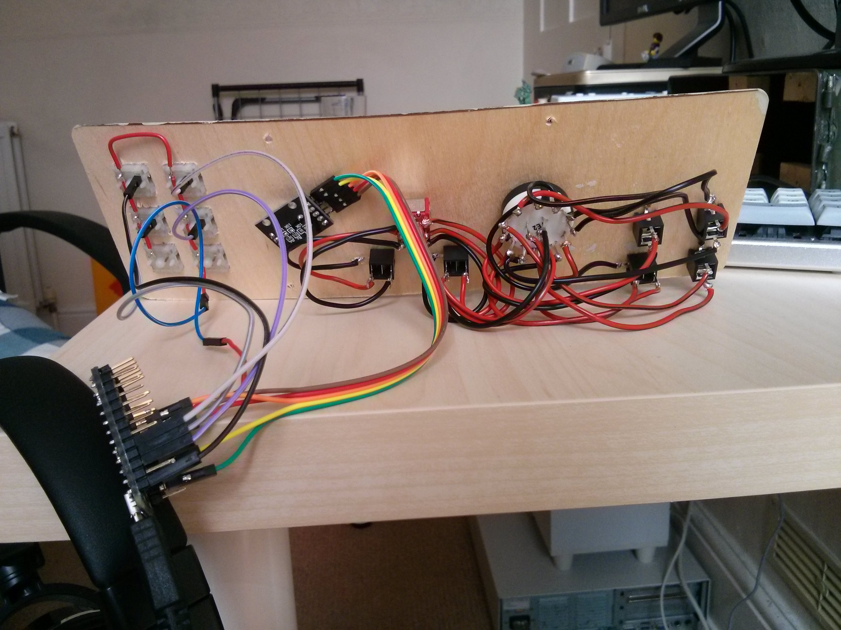

That's it on the hardware side really. Here's a picture of the wiring, though, spaghetti-ish though it may be:
The faceplate is made of 1.5mm plywood stuff (laser cut-able, though I just used a hand drill) and the box...wait for it...is an old military surplus ammo crate. It's the perfect size to use as a monitor stand! I did consider repainting it so it didn't look so 'military', but I quite like the vintage look it has with the big dials and toggle switch etc.
The blocks of wood are glued in with Gorilla Glue (my brother swears by the stuff, but we'll see how that holds up) and the faceplate will screw directly into them. It's slightly recessed (by about 30mm) so the lid can still be attached if I want. (The box is actually waterproof, which is kind of cool. Not that I need that feature, but still kind of cool).
I'll post pictures once the thing is finally assembled and I have my nice matching cables.
