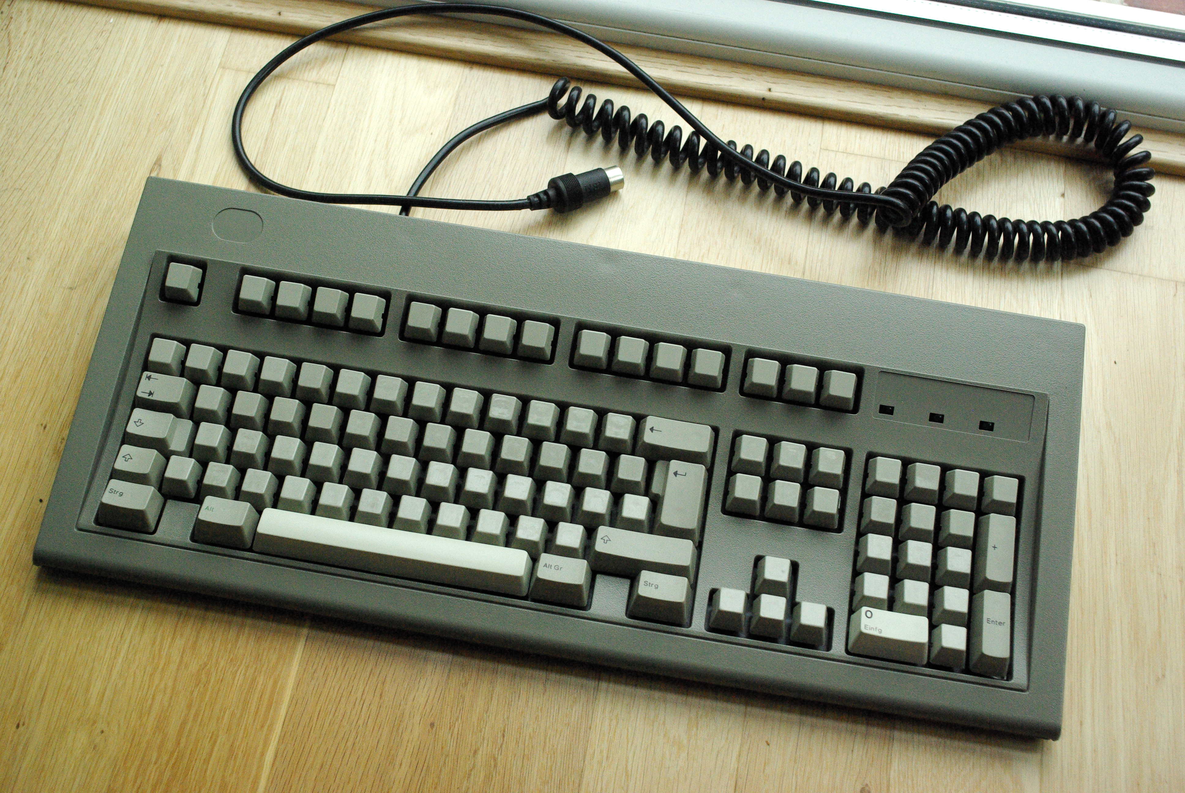

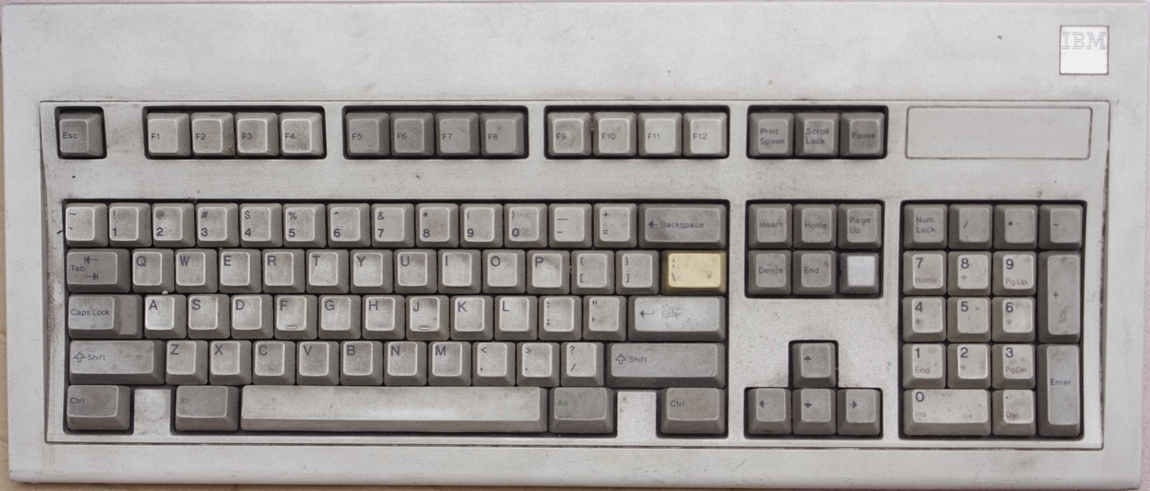

[issue]My model m 1390120 has a yellowed ABS keycap(not original)
terrycherry
14 Oct 2015, 12:44

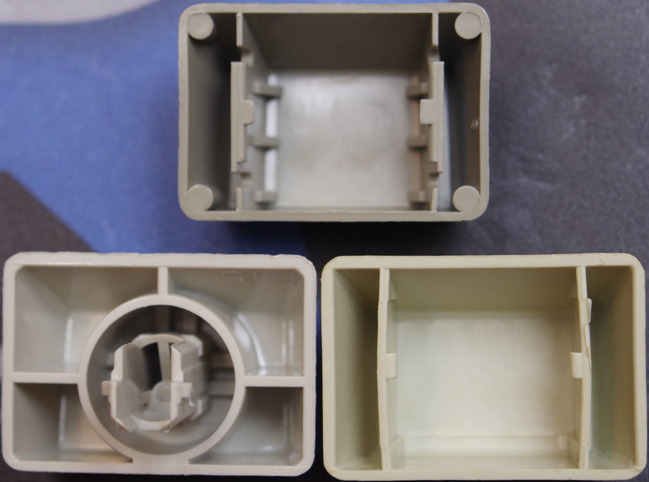

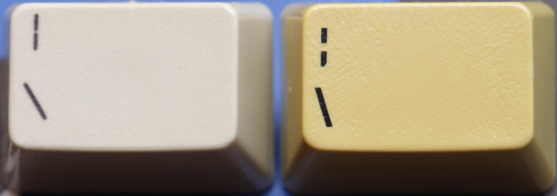

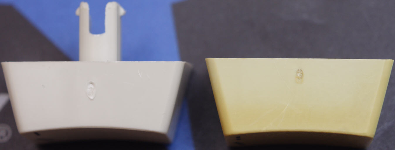

As I see the front and back of this "\" keycap, the design is differ other keycap and it's the two-piece keycap.
I confirmed that keycap wasn't the original one and it was replaced by the seller.
Did anybody know which model m the keycap came from? As I know model m keycaps are PBT.

14 Oct 2015, 12:56
Interesting. I've never seen this before. It looks pad-printed too.
14 Oct 2015, 13:43
It smells of a 3rd party cap to me. the clips to hold it to the slider are off and the injection point on the back of the cap are in different locations.

14 Oct 2015, 14:29
Yeah terrycherry that's just a lousy replacement cap and your left shift probably just has a problem with the spring. But this 1390120 is well worth a fixup, the Model M. That's why andrew is drooling over it.

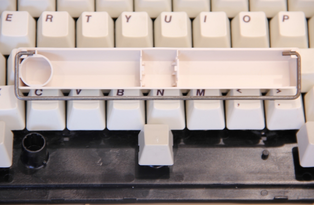

clickykeyboards
14 Oct 2015, 15:00
The yellowed key cap might have come from something like an IBM model M clone, such as an AT&T buckling spring keyboard or perhaps an Ambra model M.
See link for AT&T buckling spring keyboard from 1989
http://www.clickykeyboards.com/index.cf ... /id/565017
For example, the keycaps on the AT&T keyboard are interchangeable with the IBM model M and they have the same familiar 2-piece key cap design (even the AT&T space bar has a 2-piece key design). AT&T's font is different than the IBM standard one. I have a couple of the AT&T buckling spring keyboards that have the yellowed plastic key problem.
Should be easy to find a | \ replacement key to restore your model M keyboard to original IBM condition.

I have seen the keycap symbol with AT&T buckling spring and Ambra model M. They're not same to my yellowed keycap.
Although this could be came from the Chinese IBM clone.

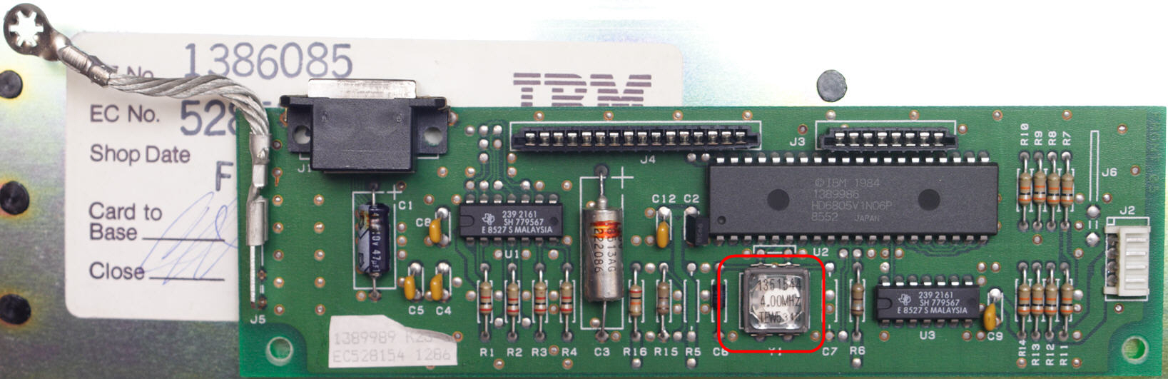

15 Oct 2015, 15:01

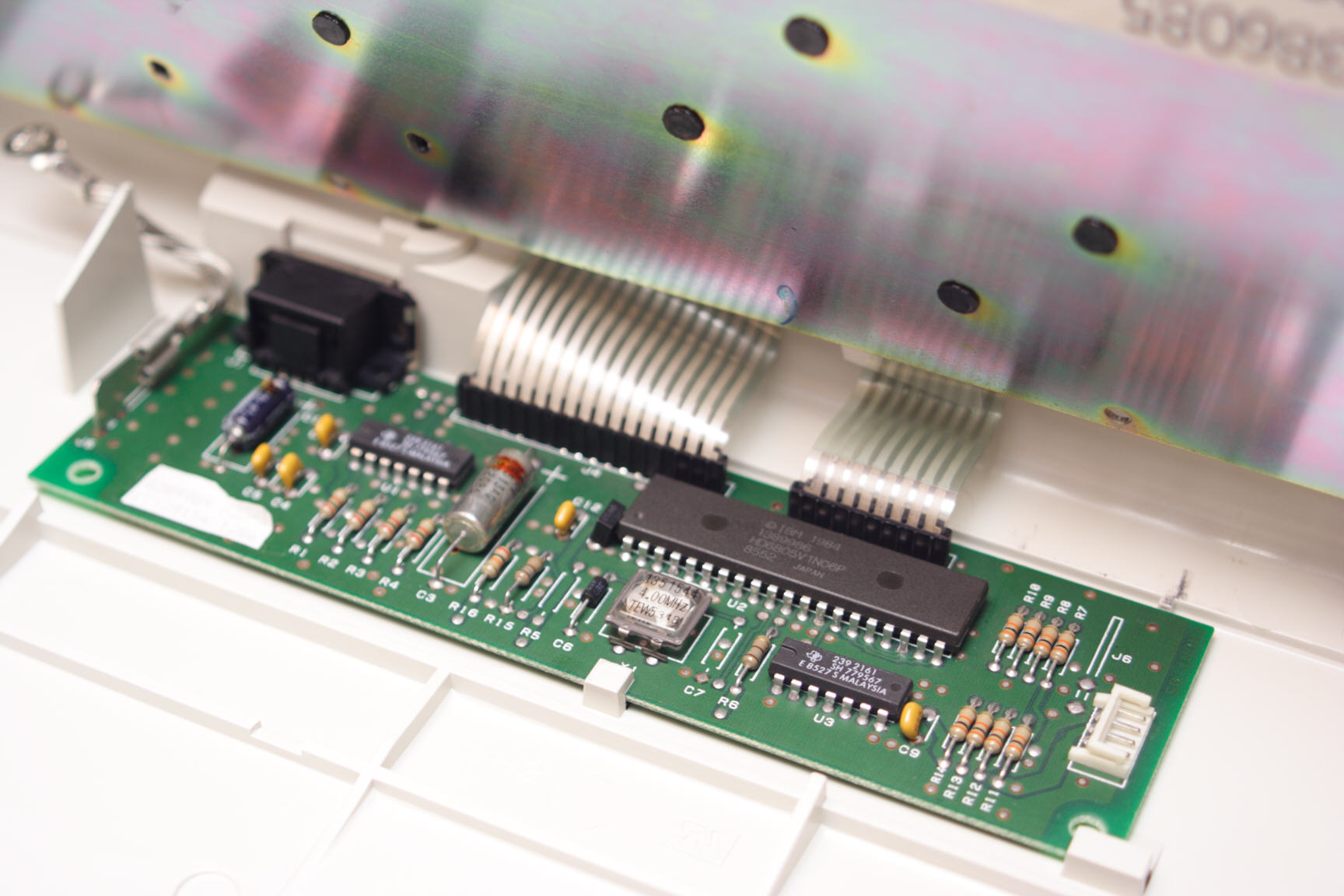

I saw the early 1986year model M 1390120 PCB(with barcode label) is different the normal 1390120 has.(Sandy did not know it.)
http://sandy55.fc2web.com/keyboard/mode ... ml#5640991
My keyboard was made from 1986.03.25(has barcode label) same as clickykeyboard's 1390120 1986.02.17 made(with barcode label) PCB.
My point is: what's that 1351544 electronic? I never seen this on PCB even on others keyboard!

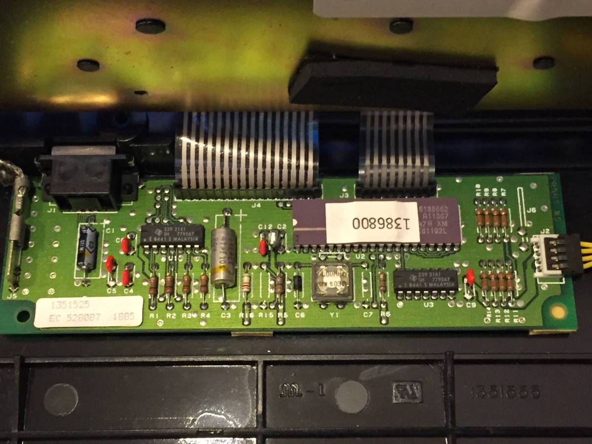

clickykeyboards
15 Oct 2015, 15:13
@terrycherry, I've seen only a dozen or so early model M controllers like that with the 4.00Mhz crystal from early 1986 (1390120 and 1390131) and also this very early 1985 model M
http://www.clickeykeyboards.com/model-m ... years-old/
1351525 model M controller board from 18th week of 1985

15 Oct 2015, 16:06
MANDOLIN CRYSTAL IDENTIFIED

15 Oct 2015, 20:44
Oooo a ceramic IC, no IBM style cans tho. Has any one ever seen them in a model M ? IBM love them , there early systems that where discrete logic where all IBM cans and they looked so cool.
I wish all ICs where ceramic, would help with passive cooling no end, i would pay a premium to have all the support ICs on my motherboard be ceramic and all the nasty electrolytic caps replaced with tantalum caps.
I miss the days when CPUs where ceramic too. We pay shit loads for the top end xeons and i7s you would think they could put them in a decent package and not that die on PCB shit.
