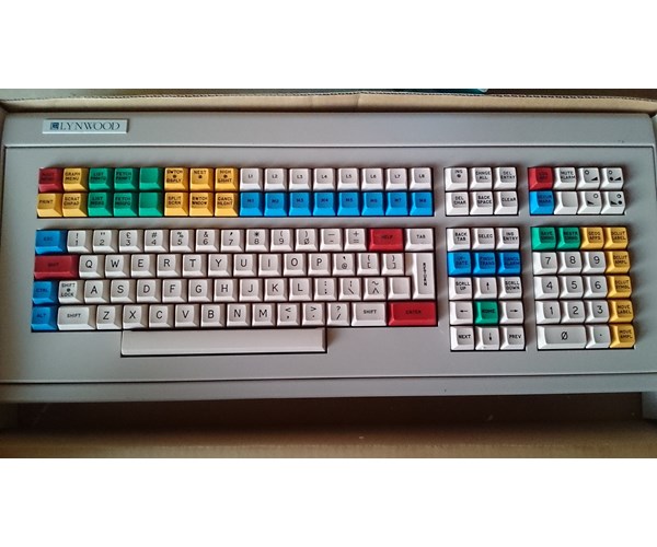

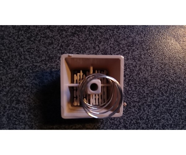

I found this keyboard on a local market site and it looks pretty cool. Anyone have some infomation about it?
Added some pictures.

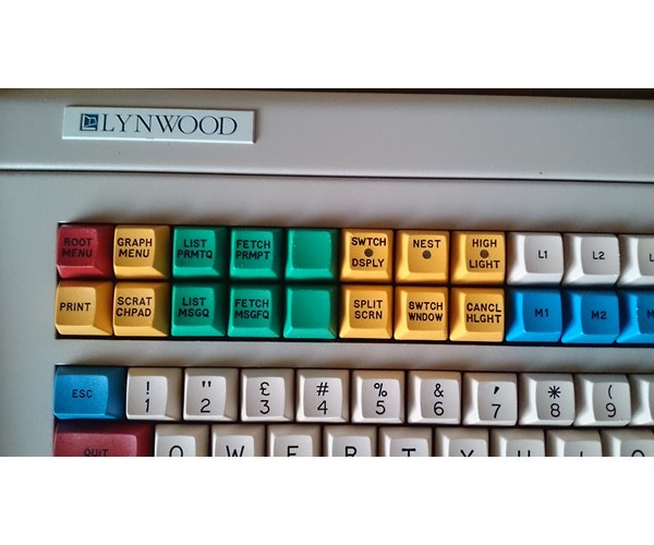

I can't zoom in enough to read the legends so I'm not exactly sure what type of work it was used for but it looks like foam and foil or maybe dome with slider. Very nice keyboard, looks cool!

Here is a zoomed picture.

It's the linear of Mitsumi hybrid switch which I could see your Mitsumi mount and the external spring!
It's rare to see the linear one.

Sorry for digging up an old post, but I bought this board earlier this week. I assume the deal fell through before, because the board (clearly the same one) has been up for sale on the danish site DBA since sometime last fall, with nobody picking it up until now. I paid a bit more than the price Kristoffer quoted, around €40 / $44, which I think is fair for a rare and interesting board, even with less-than-desirable switches.
The Lynwood keyboard is heavy (weighs 4.8 kgs or a bit over 10 lbs) so there was no way the seller was going to ship it anywhere. It's an all metal frame, ostensibly due to TEMPEST shielding (it's spy proof!), and it looks every bit as fabulous as its picture. I'll post better pics for the wiki when I get home.

Thanks there for the high quality. Could you shot inside the case about the switch?
I hope to know what the difference about linear and clicky.

@terrycherry: The Telerate uses unbranded Key Tronic mount linear switches. I have posted more pics here: http://imgur.com/a/0zNmM

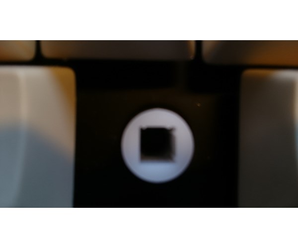

@Daniel Beardsmore: Interesting! In light of that I had to get this out and have a look inside - and you are spot on!
Full teardown gallery
Of course, I already suspected it would be foam & foil, so I don't know why I was surprised to find capacitive pads. Capacitive or not, it's still F&F, meaning not terribly desirable in most people's eyes.

Ah, two plates. I was wondering why it seemed not to have discrete modules, but indeed it does, as one would expect it to.

The main keyboard manufacturer in Britain is Devlin, who are still around, and who bought out Alphameric. The best-known Devlin keyboard is the Cherry ML–based Datalux Spacesaver: Devlin were the OEM for the internals.
Capacitance works well with an air gap, but foam and foil seems to be calibrated such that the foil disc physically touches the PCB at the point of actuation (why, I don't know; maybe something to do with limiting interference). The issue this causes is that you'd have to fully depress a key to make it register, so the overtravel is provided using a foam pad. That is, at the point that the foil reaches the PCB, you can press the key further if you wish (or not) and the foam pad is compressed as a result.
