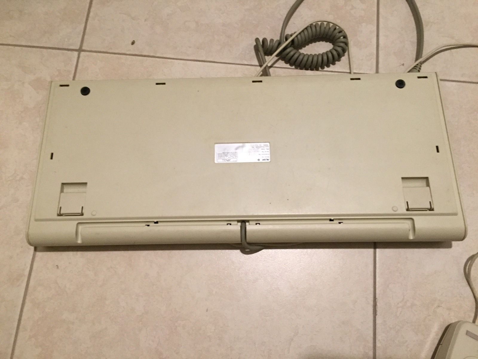

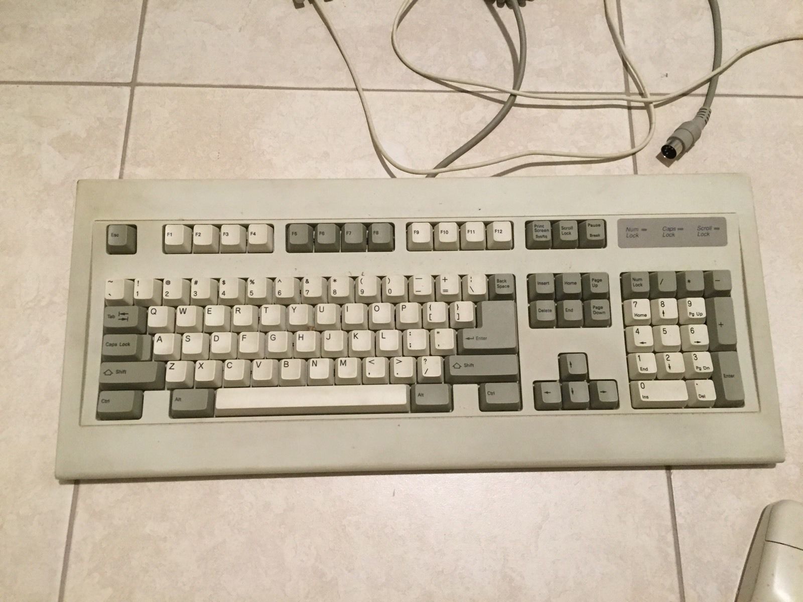

I'm returning after a long hiatus.
The keyboard was actually produced in 1994 -- one of the latest consumer models I've seen with a native DIN connector. It is somewhat unique in that its backplate is plastic (and integrated into the top half of the case). In addition, the stabilizer mounts are injection molded with the rest of the plate.
Usually plastic mounted switches feel worse than they do in metal. This is a rare case where the reverse is true. While there is a more "cushy" and "plasticine" feel, the balkiness typical in Acer switches is reduced by the plastic plate.
I forgot to mention that the keyboard is practically a Model M clone... The aesthetics are hilariously similar.

Yes, it is a 6311. No suffix -- it's the FCC # JVP6311. Perhaps the first model in the lineup? I posted photos on the wiki.
http://deskthority.net/wiki/Acer_6310_series
