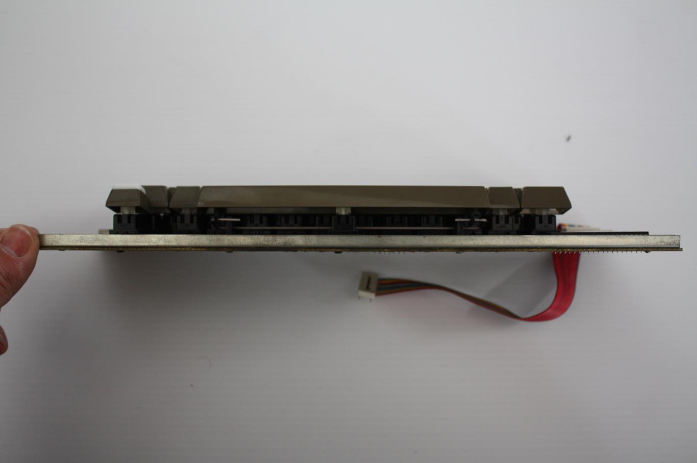

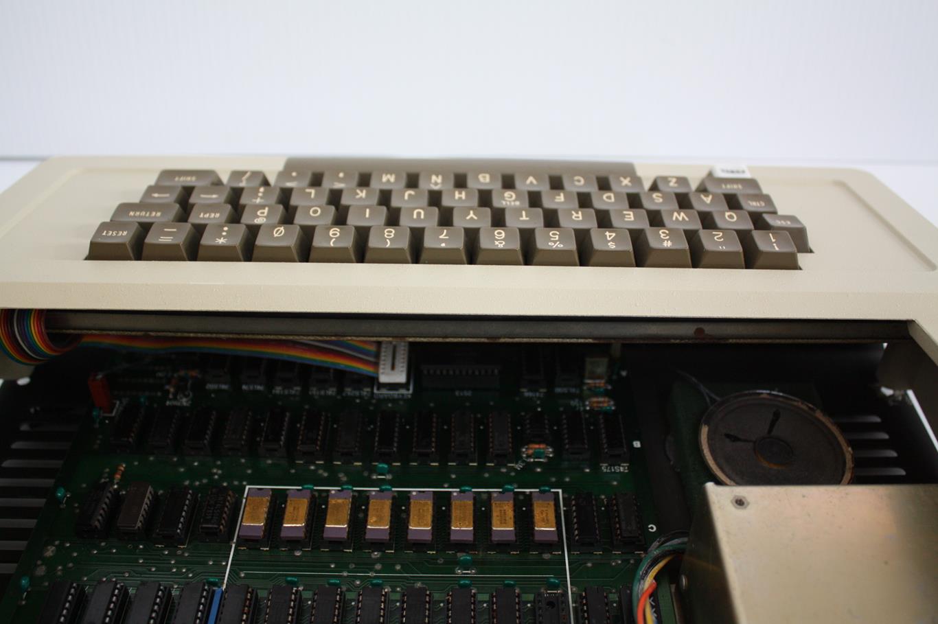

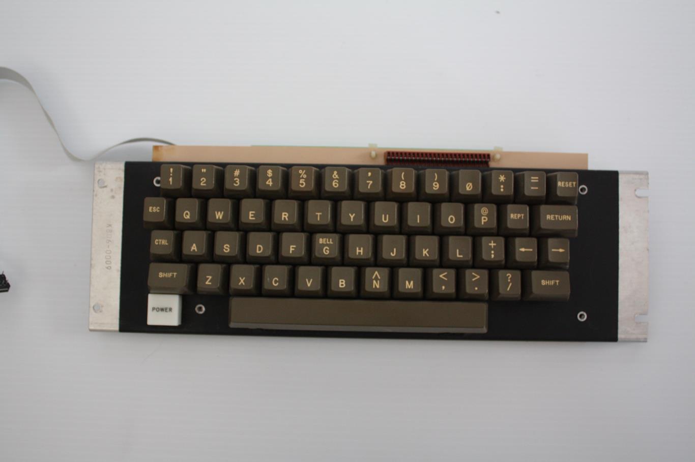

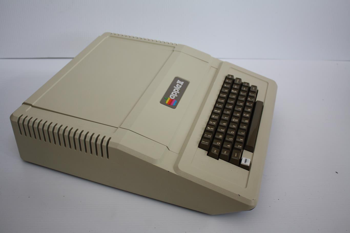

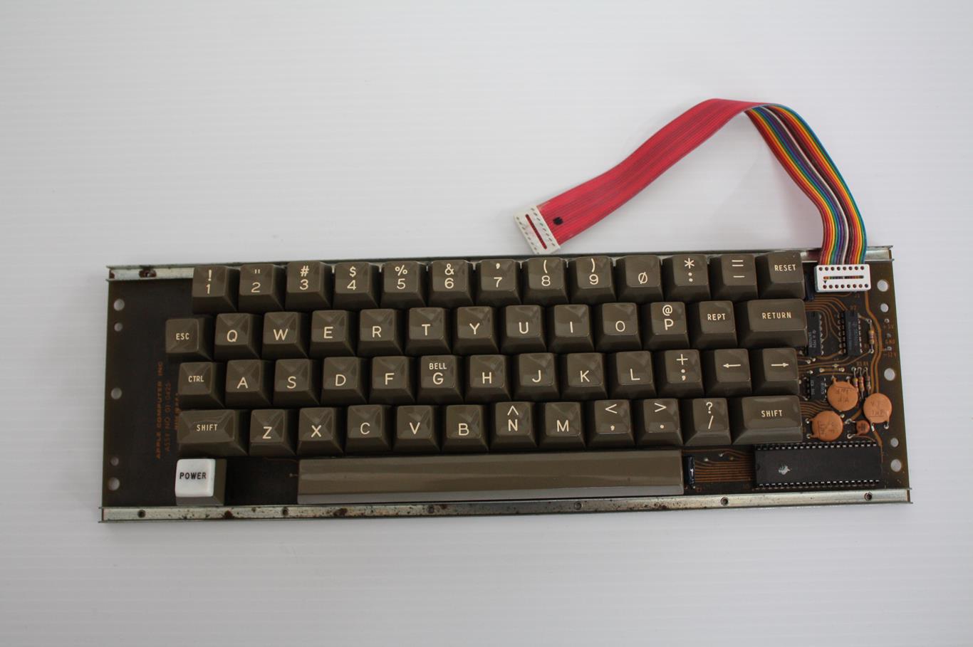

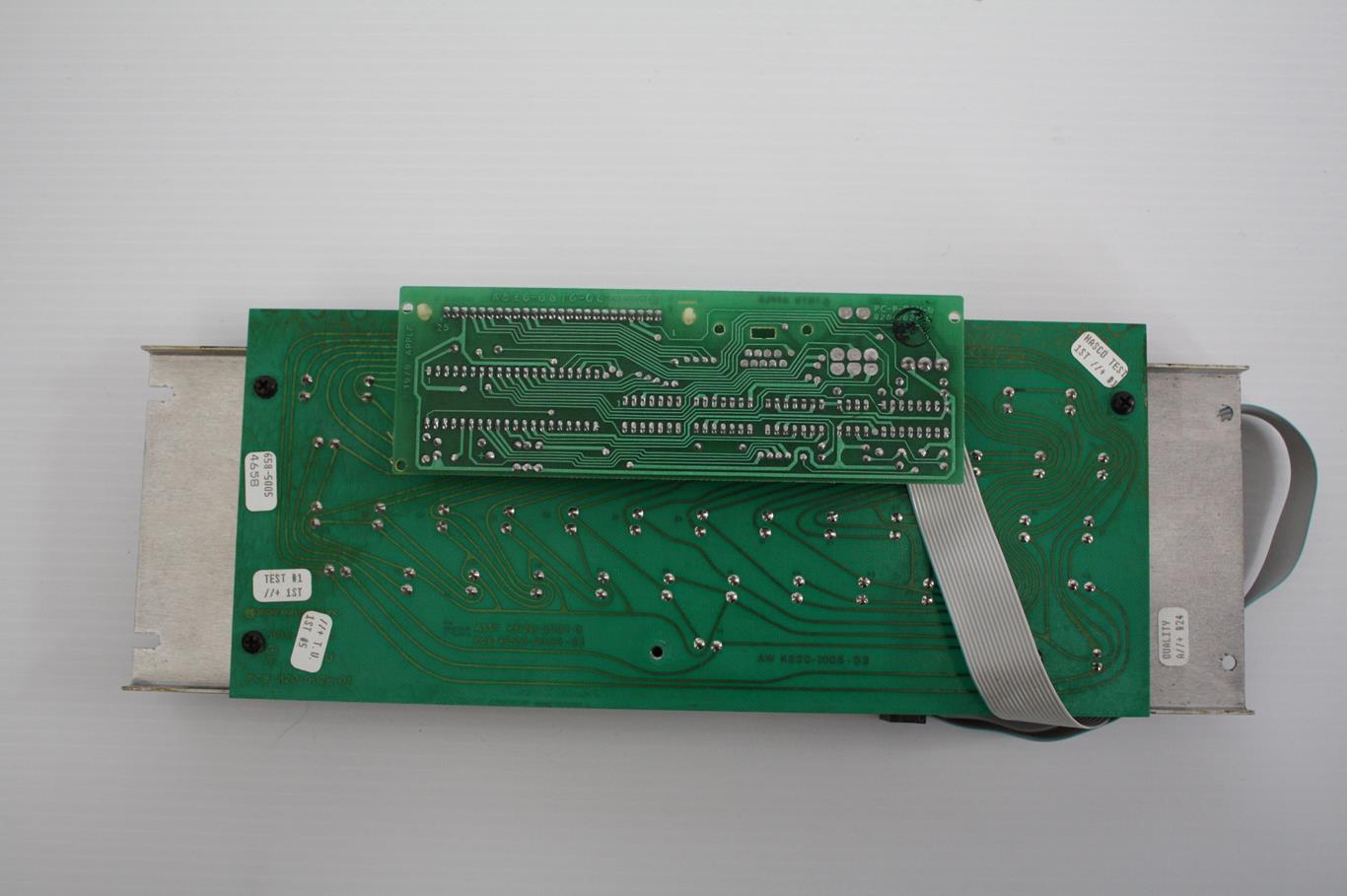

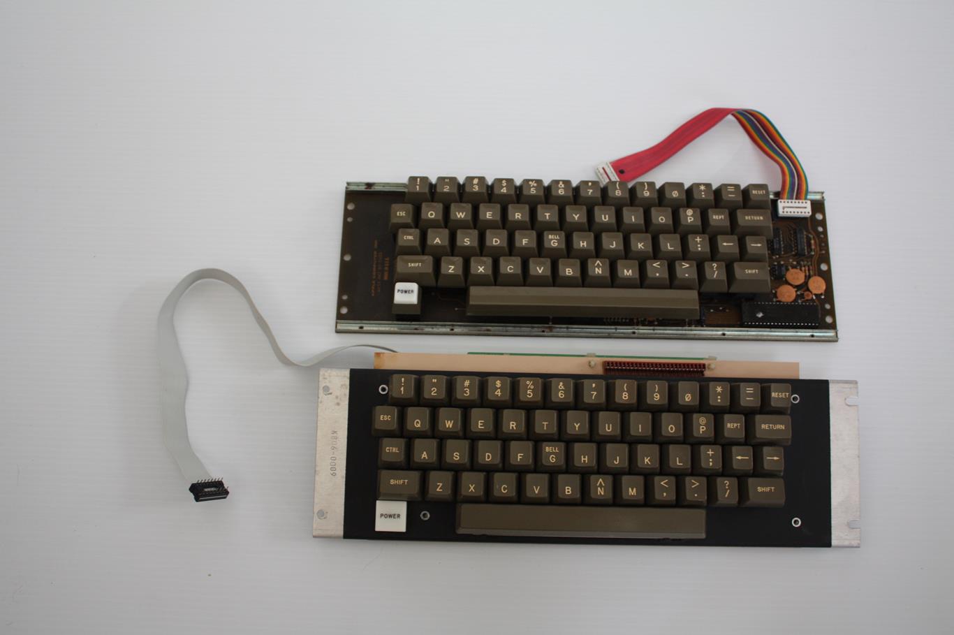

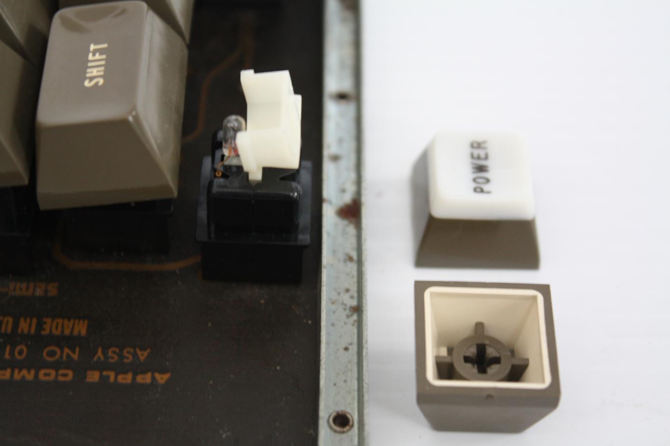

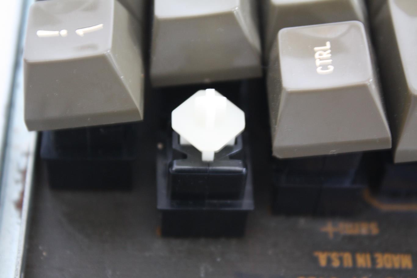

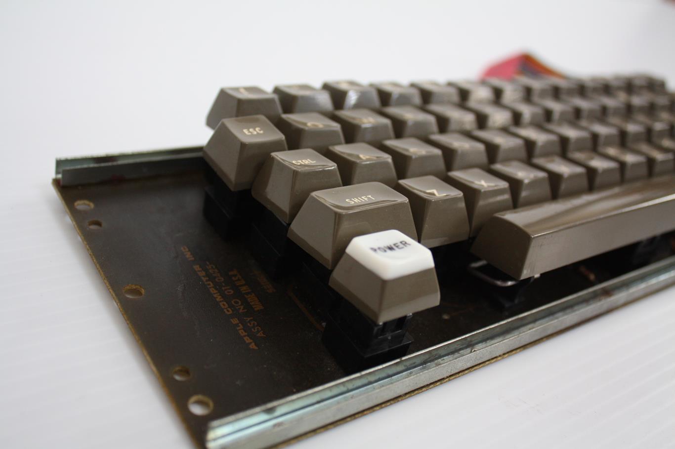

The following pictures depict the keyboard used in an Apple II and later Apple II Plus computers. They are interchangeable and some of the later ones are in Apple IIs but the key to most collectors knowing from first glance that you are looking t an early Apple II is by looking at the power light. Earlier ones look like a key cap that you can press (you can't) while later keyboards changed internally and flattened out the power light cap so it doesn't look like a key anymore.
Here are some pics:
Apple II  - complete with keyboard
Apple II - complete with keyboard.JPG (70.19 KiB) Viewed 4983 times
Apple II  - Early keyboard in place
Apple II - Early keyboard in place.JPG (109.49 KiB) Viewed 4983 times
Apple II  - Early keyboard top
Apple II - Early keyboard top.JPG (100.92 KiB) Viewed 4983 times

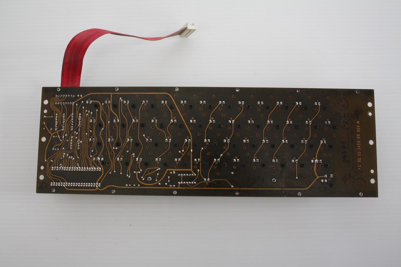

Apple II  - Early keyboard bottom
Apple II - Early keyboard bottom.JPG (101.23 KiB) Viewed 4983 times

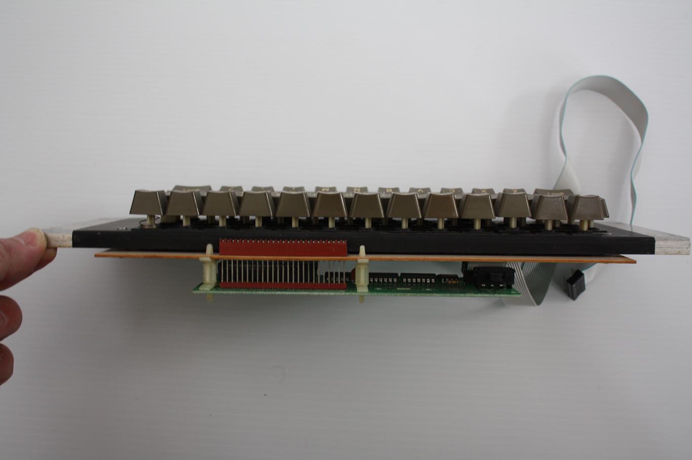

Apple II  - Early keyboard side
Apple II - Early keyboard side.JPG (58.81 KiB) Viewed 4983 times
Apple II  - Early keyboard profile
Apple II - Early keyboard profile.JPG (89.74 KiB) Viewed 4983 times

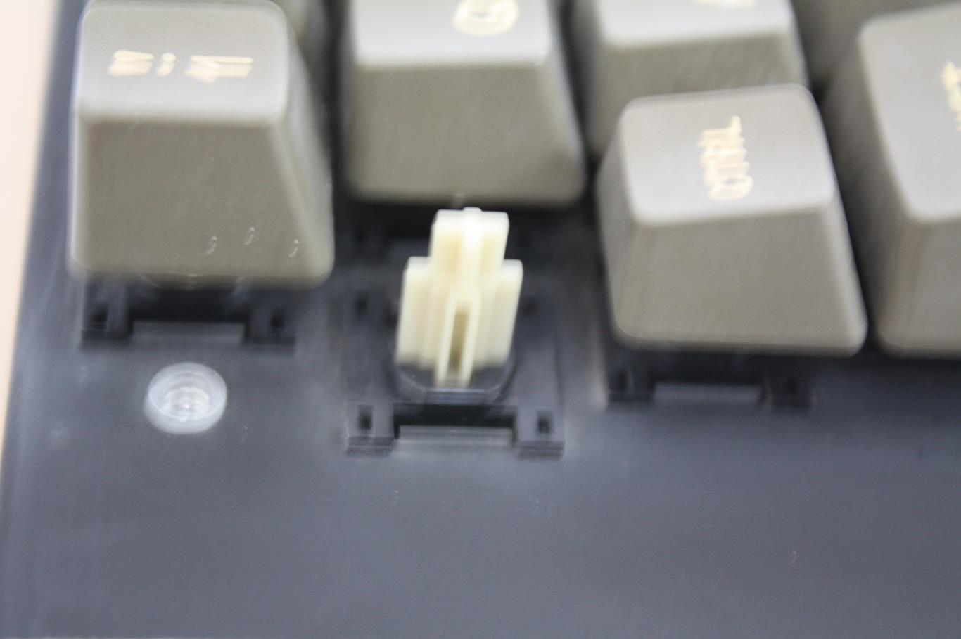

Apple II  - Early keyboard key switch
Apple II - Early keyboard key switch.JPG (74.19 KiB) Viewed 4983 times
Apple II  - Early power light and key cap
Apple II - Early power light and key cap.JPG (75.11 KiB) Viewed 4983 times
Apple II  - Early and later keyboards
Apple II - Early and later keyboards.JPG (92.13 KiB) Viewed 4983 times
Apple II  - Later keyboard top
Apple II - Later keyboard top.JPG (72.98 KiB) Viewed 4983 times
Apple II  - Later keyboard bottom
Apple II - Later keyboard bottom.JPG (108.14 KiB) Viewed 4983 times

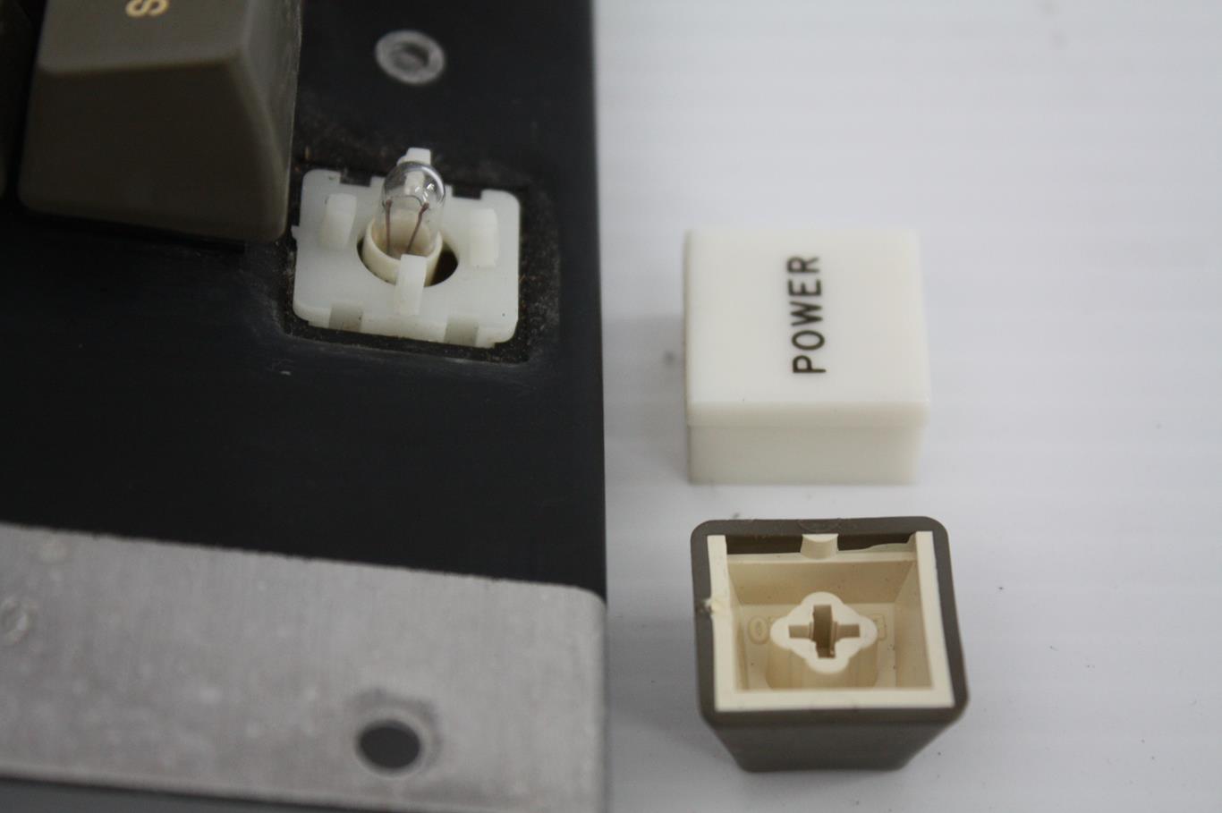

Apple II  - Later keyboard power light and key cap
Apple II - Later keyboard power light and key cap.JPG (65.5 KiB) Viewed 4983 times

I can't see about the Apple II early keyboard very clearly. What is name of the switch?
And I don't know the Apple II Plus having Alps SKCC Tall Cream. Is it also has the latching lock?
If I guessed right, it could be the oldest Alps SKCC switch which made from 1979.(The Apple II plus keyboard)

Have a look at this page for more information: http://www.willegal.net/appleii/early-a2-keyboards.htm. These key switches were made by Datanetics. As for the latching caps lock, there is no Caps Lock key because everything was in upper case only, originally :)

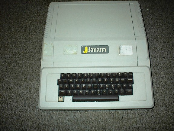

I take a look my unknown keyboard again. I did some research and compared to snuci's Apple II.
I strongly say my keyboard is the clone of Apple II(copy from apple II).

Perhaps my keyboard is the Banana clone of Apple II.(copycat too but don't know where it from and what is the switch)
Hope someone can give me more details if you knew it.
Apple II clone Banana.jpg (92.03 KiB) Viewed 4801 times
