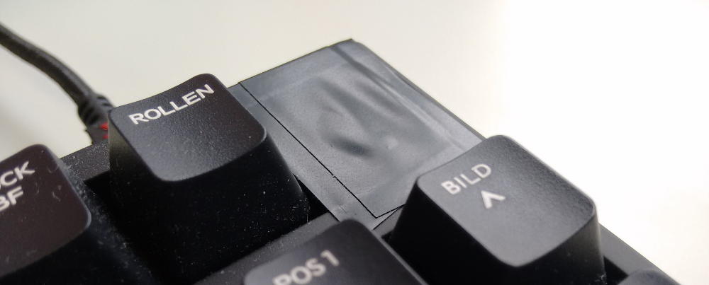

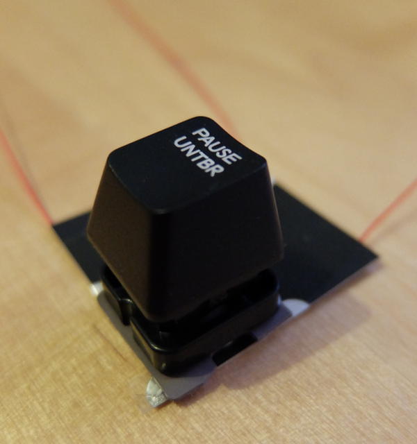

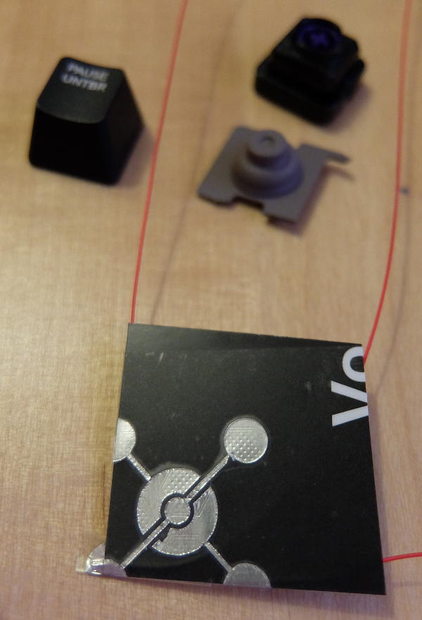

Thou shalt blow your kitchen foil to tiny bits, ending up like this:
The sacred Novatouch parts can be seen scattered all over the place.
Measuring with a multimeter, the capacitance between the two half-moon-ish electrodes increases from essentially 0 to about 2pF when the key bottoms out.

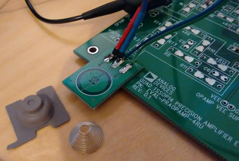

After several months of going around in circles, it turned out that the fine test boards supplied by friendly Topre expert workshop-f7/designing-a-custom-topre-board-t11734.html made all the difference in this development.
The board now finally allows me to start debugging: it is solid, it can be kept in place, and it can be contacted with proper wires and proper solder joints. I now have my hands free and can start looking for the source of that horrible 50Hz interference (which the board didn't help with, unfortunately).
All I know so far is that the 50Hz is probably due to the haphazard wiring (inherent in a test circuit of this kind), but the circuit works in principle and the 50Hz is probably going to go away once I make a proper PCB with careful grounding.

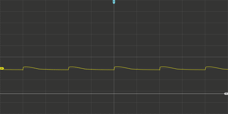

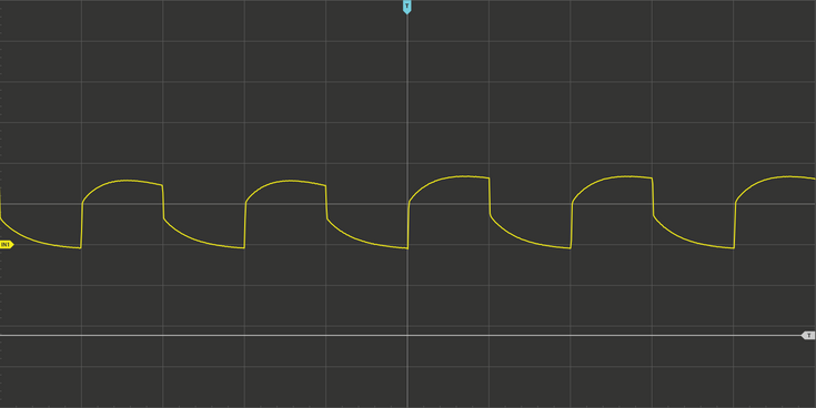

So here are the first results. This is the output voltage of the amplifier when the key bottoms out:
The scale here is 500µs/div (pulse frequency is 1kHz), and 1V/div. This is with an excitation amplitude of just 1V, a standard CMOS circuit will produce at least twice as much, so the signal will also scale up accordingly. The fact that the shapes of the pulses differ slightly is that 50Hz interference that still needs to be dealt with.

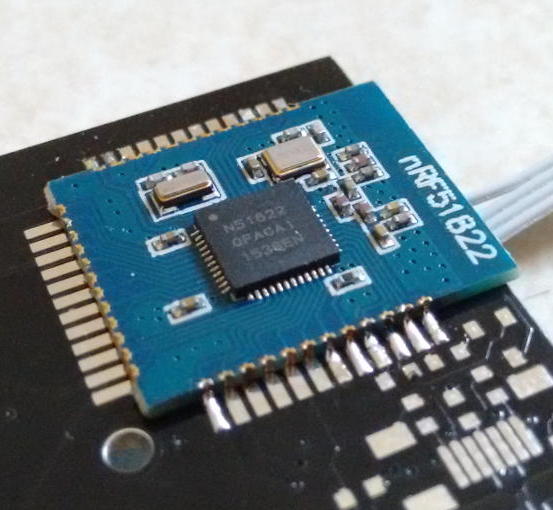

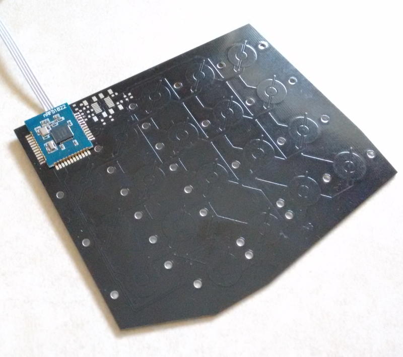

I promised to myself that I wouldn't post to this thread until I have some more results. So I managed to keep my promise, since brand-new PCBs arrived today from China, and I couldn't but start soldering straight away. Just the controller module for now, which appears fine on the SWD debugger link connected through traces on the PCB, so that's a sign that the PCB isn't all rubbish:
As it happens, this is the first PCB I ever sent off for manufacturing without printing the layout on paper first and test-placing the components, so every part I can solder without problems makes me happy.

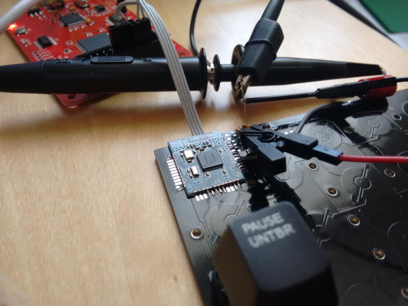

20 Jul 2016, 16:14

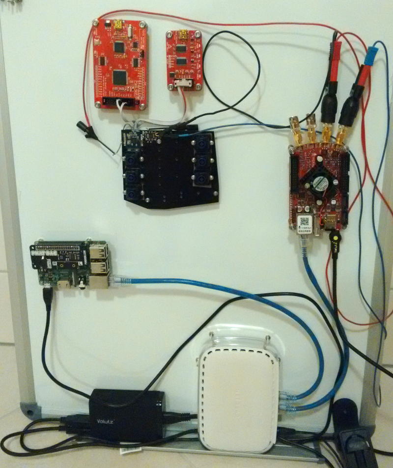

Let's see some pictures!
First of all, the set-up is quite a mess, as always:
As you can see, I'm testing with a single key only, just to see whether it works at all.

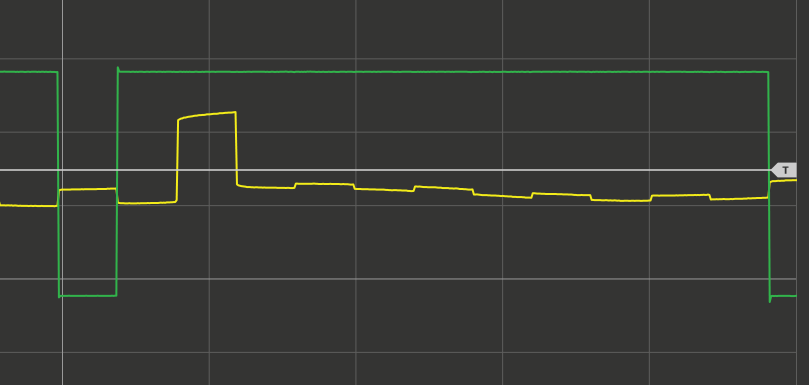

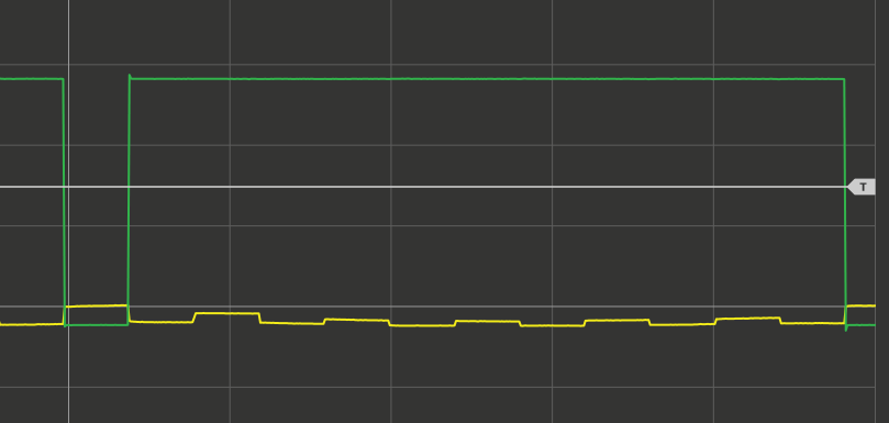

Now the first results, for a single row. Key present but not pressed:

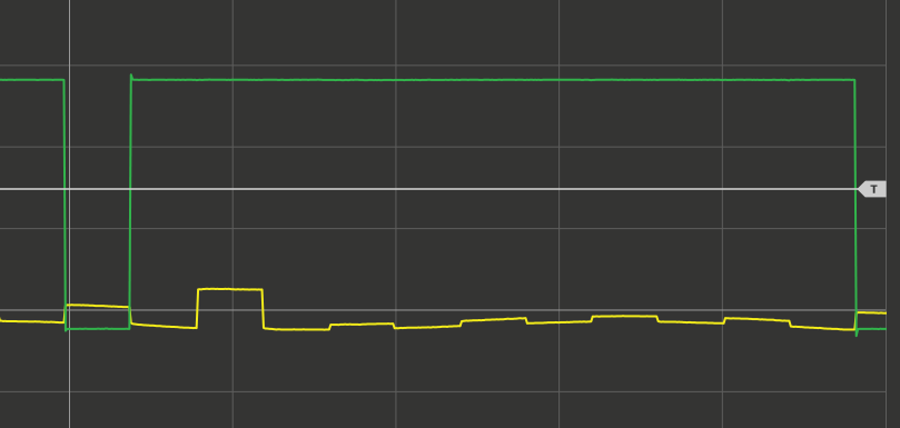

Key partially pressed, around actuation point, you can clearly see some 50Hz as well there:
Key fully pressed -- you can see the overall signal level rise somewhat, that's because the sense capacitor is too small, I'll have to try a larger one next time:
All graphs are at 1V/div and 5ms/div. The green plot is the reference excitation output from the controller (an extra column with fixed capacitors instead of Topre electrodes) and allows me to trigger the scope on a scan frame. Timing is (sort of) arbitrary at the moment, I just used the timers already in the SDK example my code is based on.
The yellow plot is the output of one of the row amplifiers, which is also connected directly to an ADC input of the controller, with the goal of measuring the key states using that ADC, so this signal is what the ADC will eventually sample. By principle, there is an unpredictable offset of the entire curve (which we'll have to live with), but the plateaus before and after each rising edge are very nice and flat, so there is plenty of time for the ADC to sample them. The idea is, therefore, to read the column signals before and after each excitation pulse (which is a falling edge of the row drive signal, resulting in a sharp rise in ADC input signal) and compute the difference.
I can already hear Sir Novatouch scream "Run away, run away!!!". What a coward after all, I never would have expected to run into such resistance once I needed another bunch of his guts. Luckily enough, he stepped onto a coconut while sneaking away, which gave away his position and allow me to arrest him. He will be publically separated into his bits, that's the punishment he deserves.
ħ
