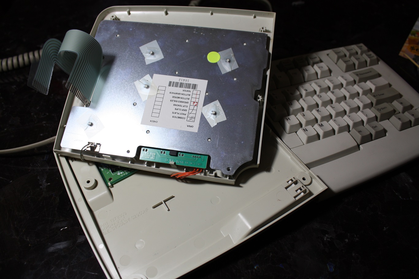

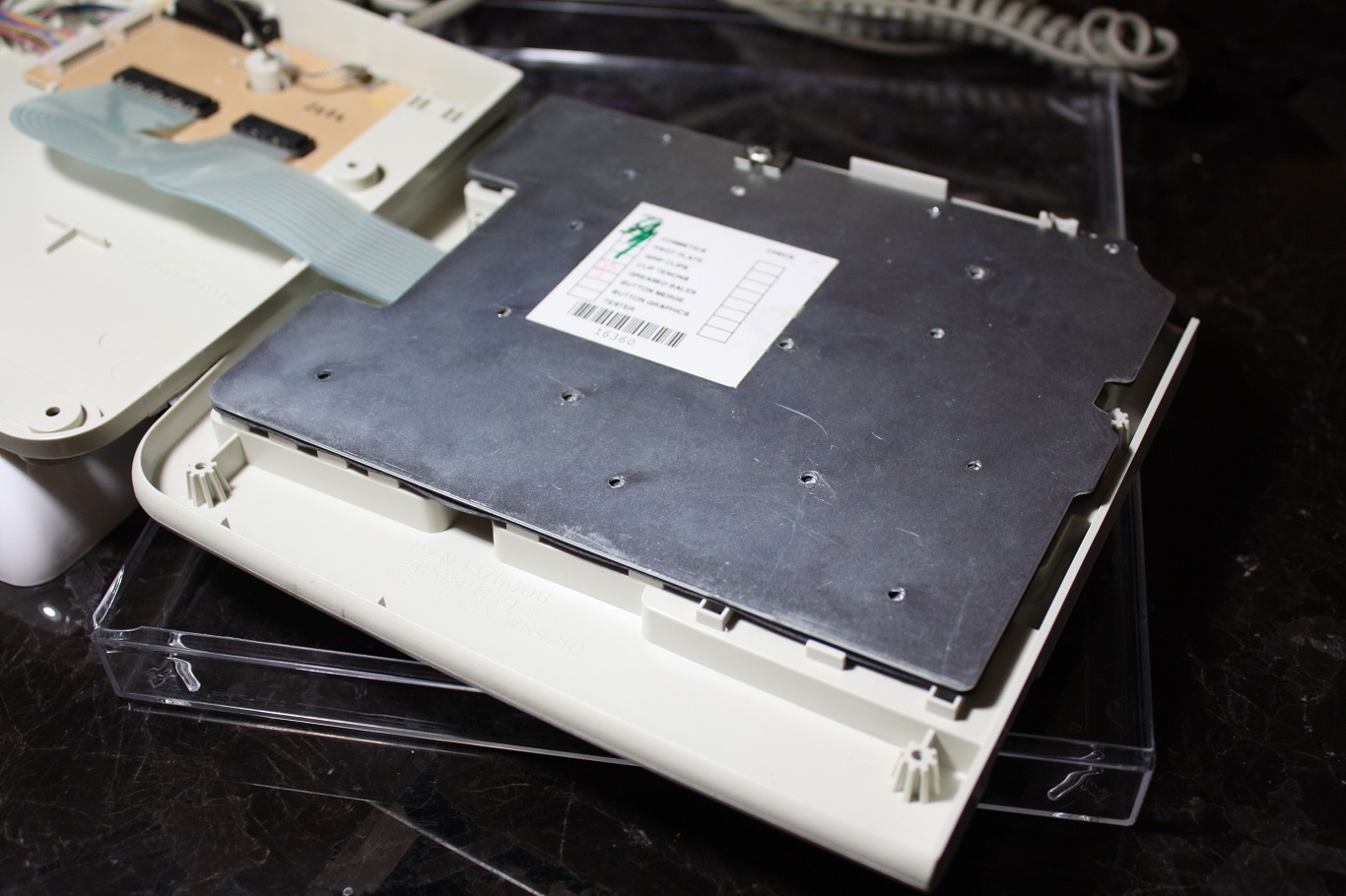

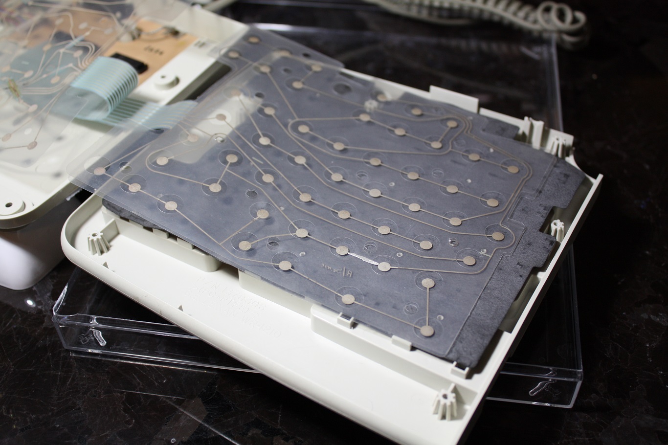

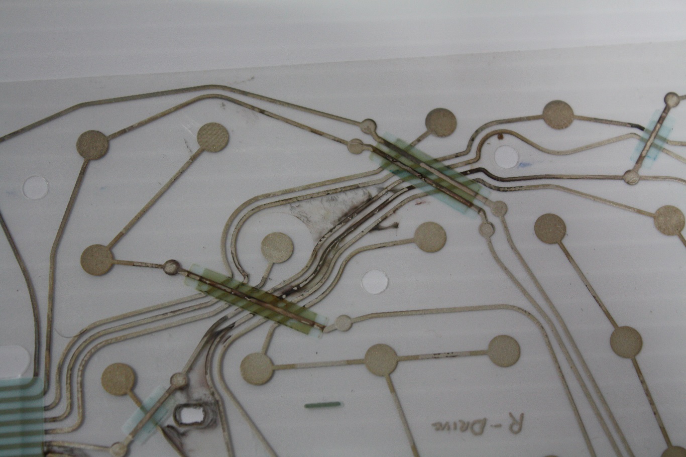

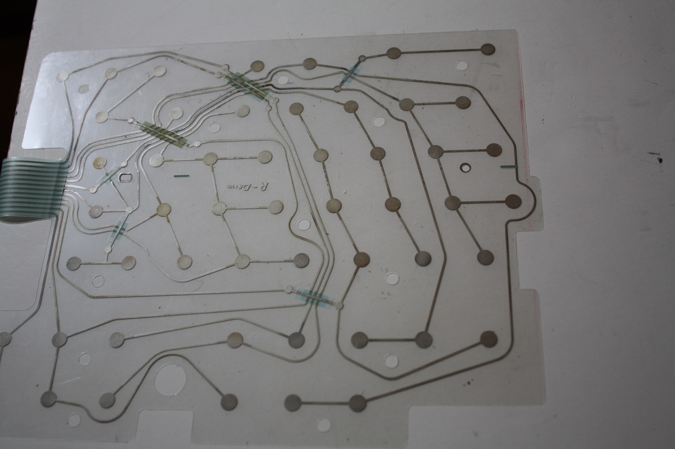

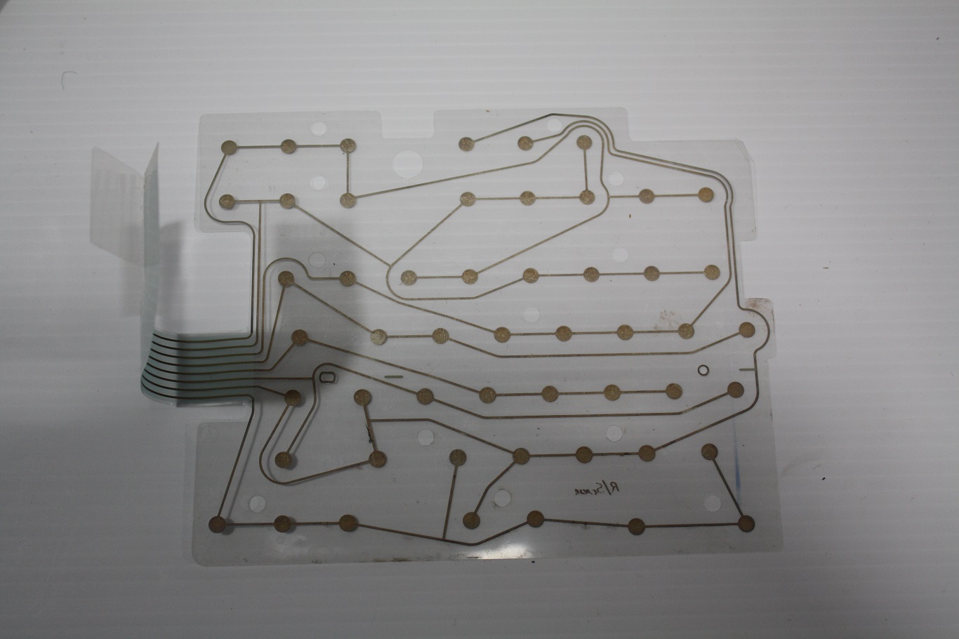

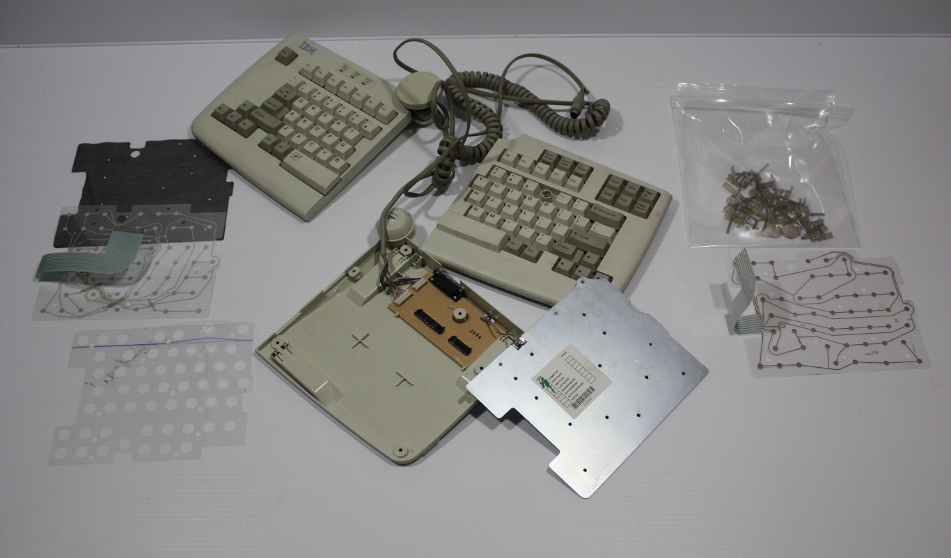

Part of my vintage computer hobby is to save computers and make them fully functional again. I am the one who spent (what I believe to be) a crazy sum on the IBM M15 keyboard recently. This is my first keyboard restoration so I want to make sure I am doing the right thing and I am hoping you guys/gals can let me know what is good and bad.

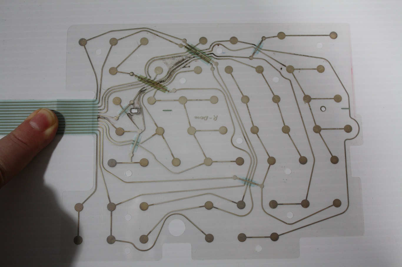

This M15 had a spill that corroded some of the traces on the plastic sheets that make up the buckling spring mechanism. I can clean them up but I have two questions.

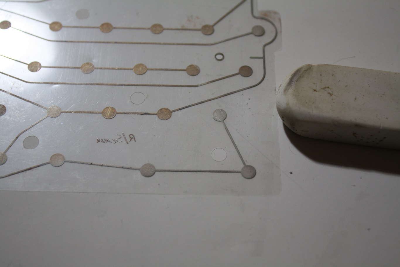

1. Can I use an ohm meter to check continuity or can I use something else other than the naked eye?
2. Can I use an eraser to clean the contacts? I use an eraser to clean traces on circuit boards as it picks up unseen corrosion and debris so I am hoping it will work for the traces on the plastic sheets.
If cleaning with an eraser is okay, does anyone see any issues using the eraser in the problem area? There are a couple of "bridges" that I have to be careful of but I can be gentle.

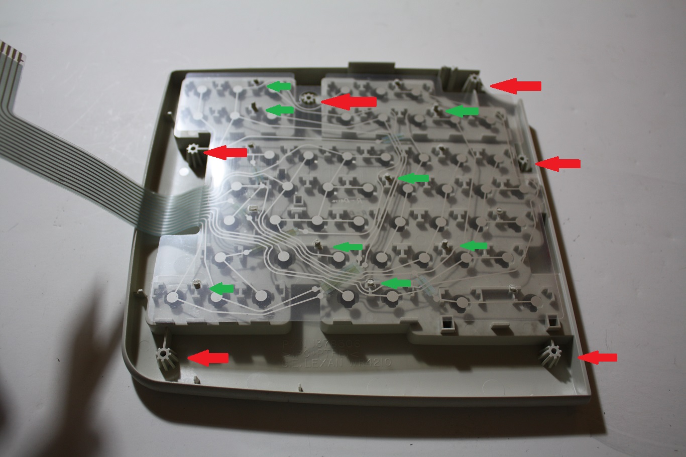

I'll also have to figure out how to "bolt" the parts together. Someone previously tried to tape it together and it took me the better part of 45 minutes to remove the tape gently.
For those who may have fixed keyboards before, how bad does this look? I think it's fixable personally.
I haven't counted the springs yet but I will need at least one key. Hopefully some kind soul will have spares. Someone mentioned M2 parts should work?
Here are some pics:
IBM M15 - all parts
IBM M15 - all parts
IBM M15 - all parts.jpg (235.15 KiB) Viewed 12981 times
IBM M15 - top layer (or what I call the top layer)
IBM M15 - top layer.jpg (218.5 KiB) Viewed 12981 times

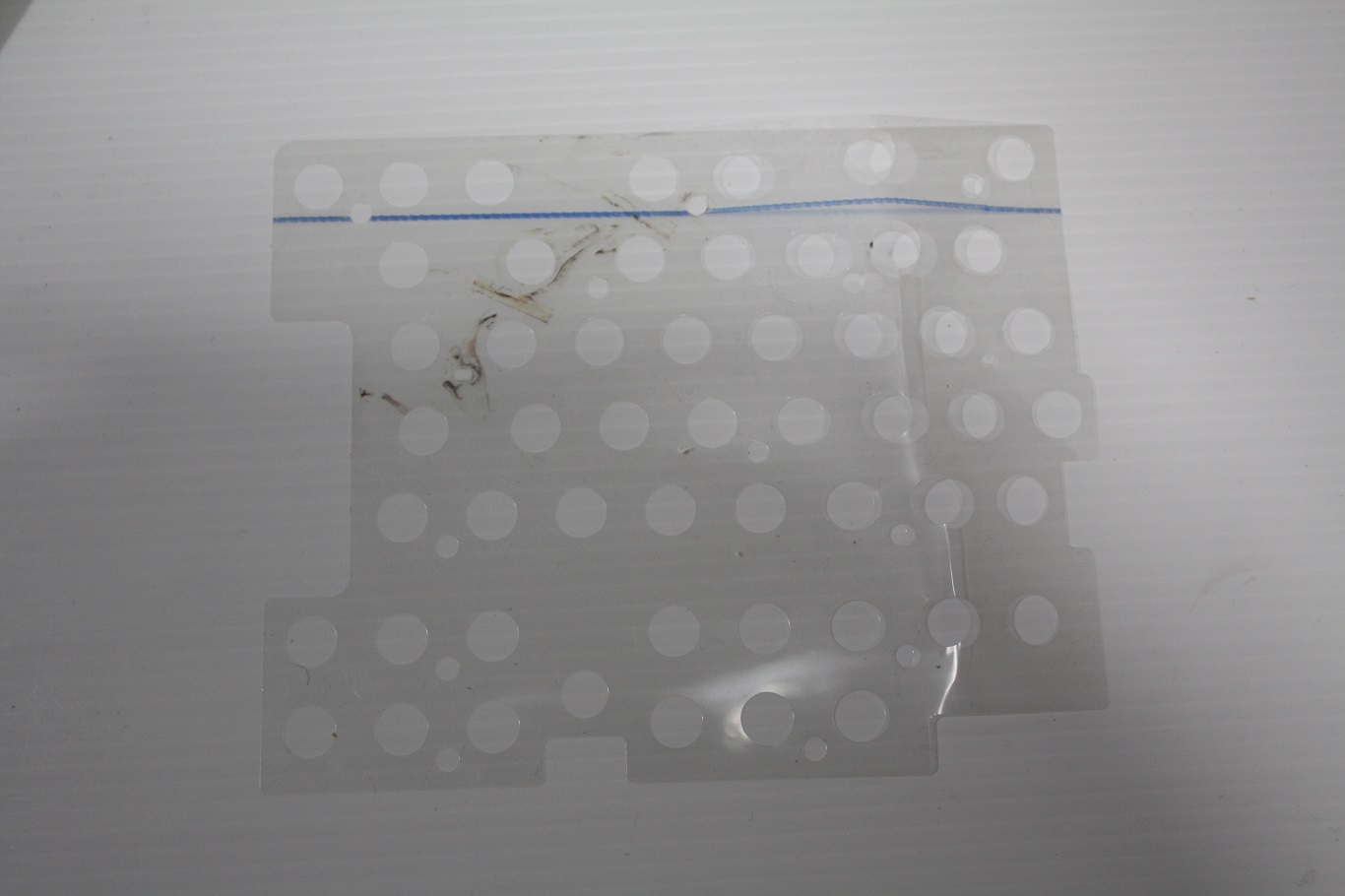

IBM M15 - middle layer (spacer, I guess is a better term).  This has some debris that was transferred from the bottom layer.  I'm not liking the fold.
IBM M15 - middle layer.jpg (179.59 KiB) Viewed 12981 times

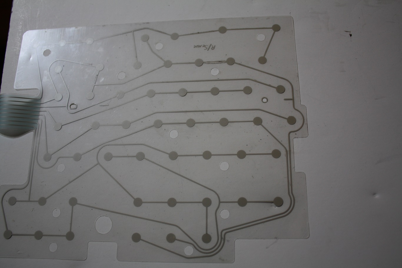

IBM M15 - bottom layer (problem area)
IBM M15 - bottom layer.jpg (261.31 KiB) Viewed 12981 times
IBM M15 - problem area close up
IBM M15 - problem area.jpg (309.36 KiB) Viewed 12981 times
IBM M15 - three contacts nearest eraser gently cleaned.
IBM M15 - clean with eraser.jpg (200.18 KiB) Viewed 12981 times
Any help is much appreciated.
Yes. An ohm meter will work well here.
Yes.
If you do need to make repairs I recommend silver paste.

So far, I did check for continuity (I though it was capactive for some reason) and yes, they are conductive. Once I knew that, I knew i could clean them with the eraser. Come out quite well actually. I found one broken trace and it wasn't even on the side that looked bad.
I wouldn't mind you keeping the parts one aside for now and if I need it, I'll let you know. I really appreciate that but let's hope I don't need it and someone else can have a project. My cable is frayed but that shouldn't be a big deal, I hope. The previous owner said the other side worked fine.

Here are more pics:
IBM M15 - top layer cleaned
IBM M15 - top layer cleaned.jpg (217.81 KiB) Viewed 12942 times

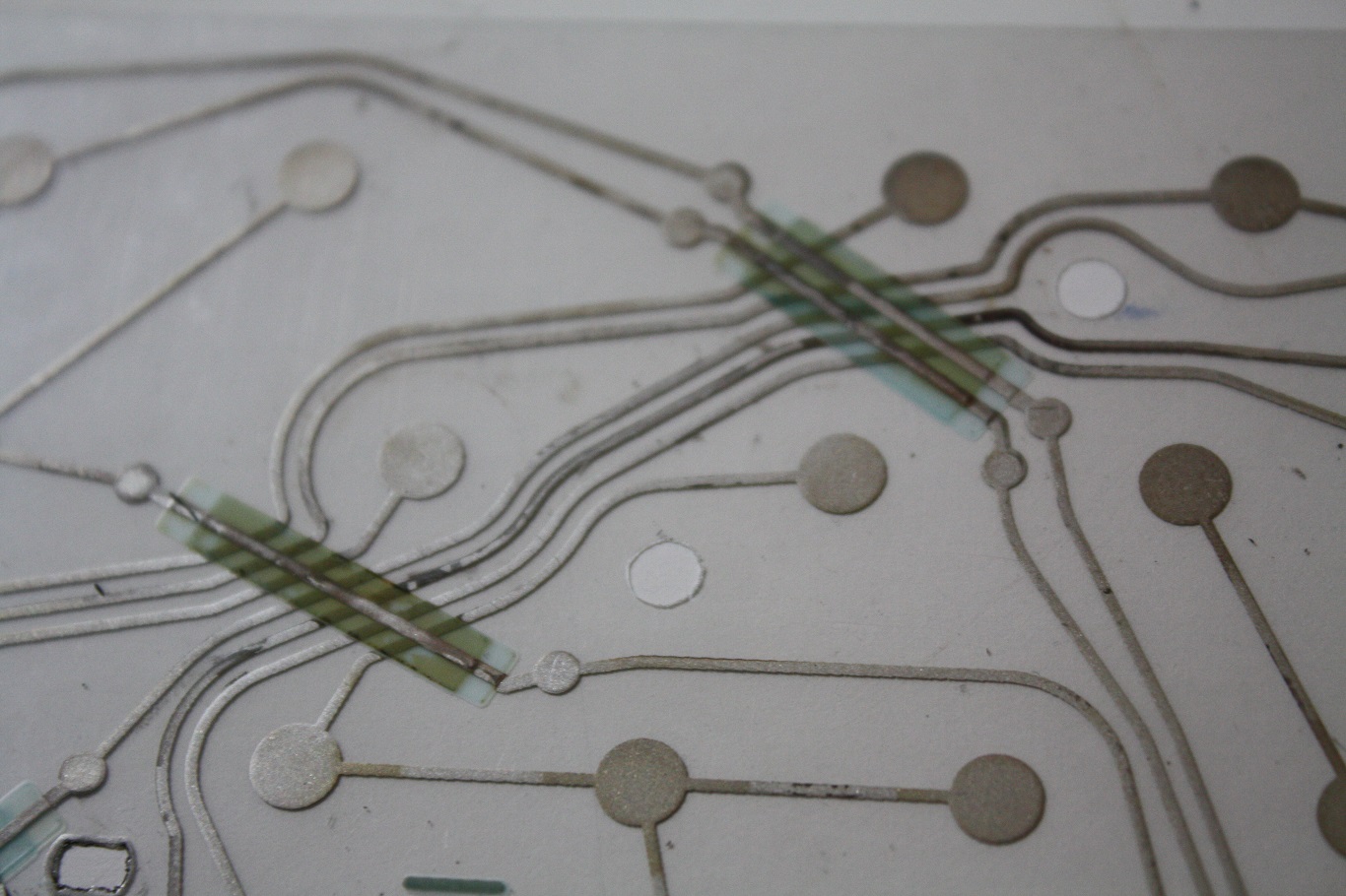

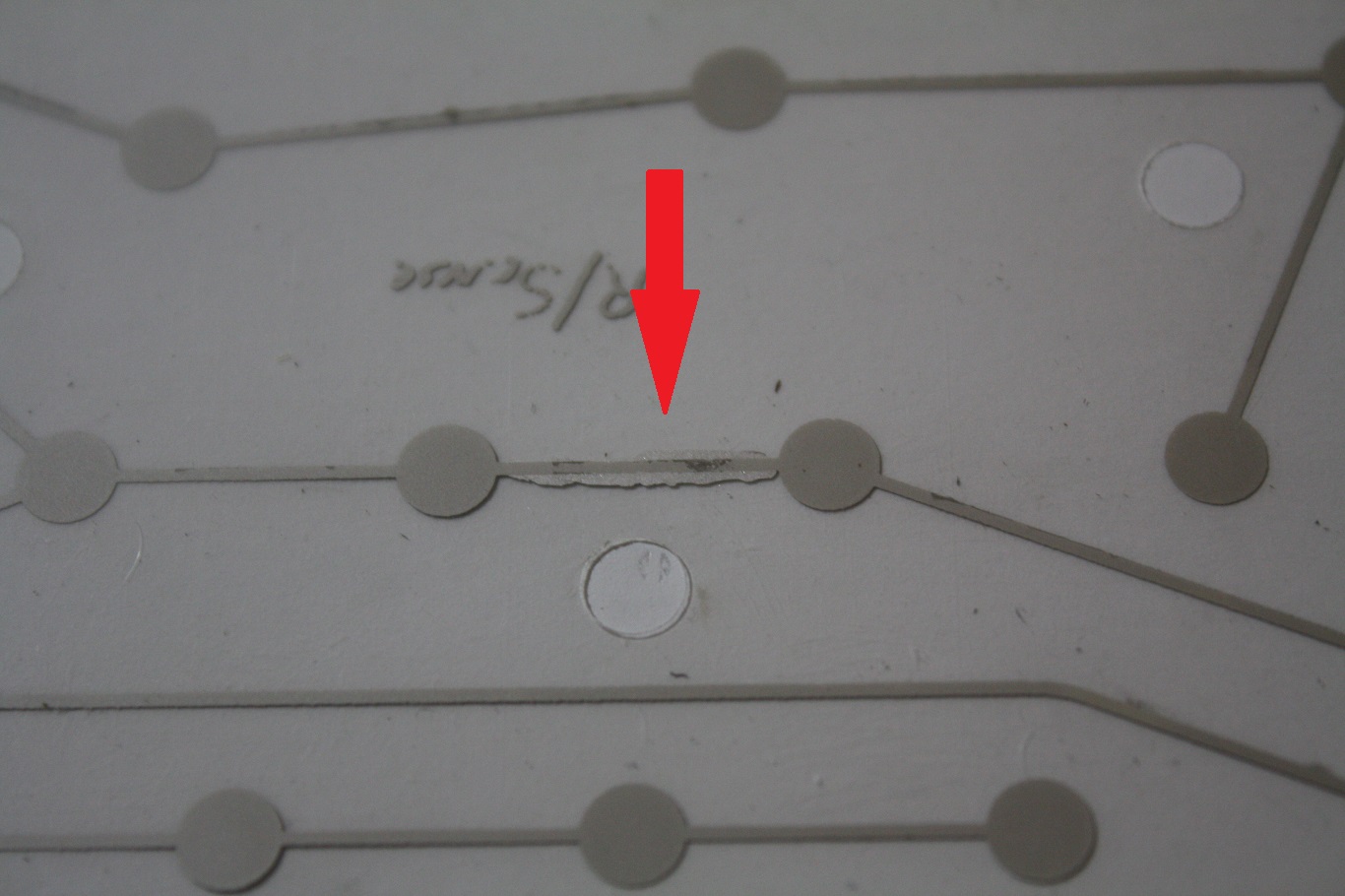

IBM M15 - top layer repair (you could not see the issue with the naked eye).
IBM M15 - top layer repair.jpg (230.22 KiB) Viewed 12942 times
IBM M15 - bottom layer cleaned
IBM M15 - bottom layer cleaned.jpg (259.19 KiB) Viewed 12942 times
IBM M15 -botom layer bridges are actually okay.  There is some blue opaque tape that makes them look worse but they aren't actually that dirty.
IBM M15 - bottom layer bridges okay.jpg (312.27 KiB) Viewed 12942 times

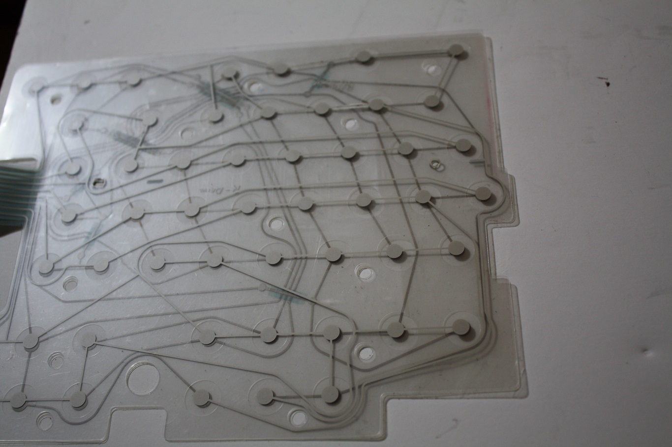

IBM M15 - all layers together.
IBM M15 -layers together.jpg (242.79 KiB) Viewed 12942 times

Yep, these are definitely conductive. I think you'll find it straightforward to see where gaps might be in the membrane traces using a multimeter or ohmmeter. The resistance should be no more than a couple of ohms. If nothing else look for outliers to give you a hint as to where damage might be.
Most Model Ms are held together with rivets or eventually bolts. I wonder if you would need to bolt mod this one.

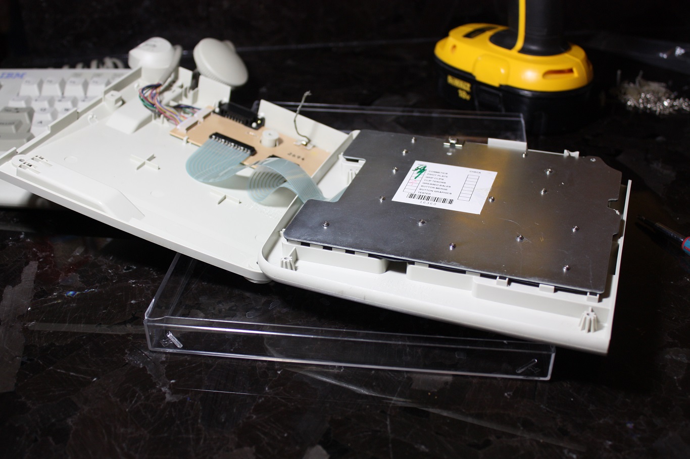

XMIT wrote: Most Model Ms are held together with rivets or eventually bolts. I wonder if you would need to bolt mod this one.

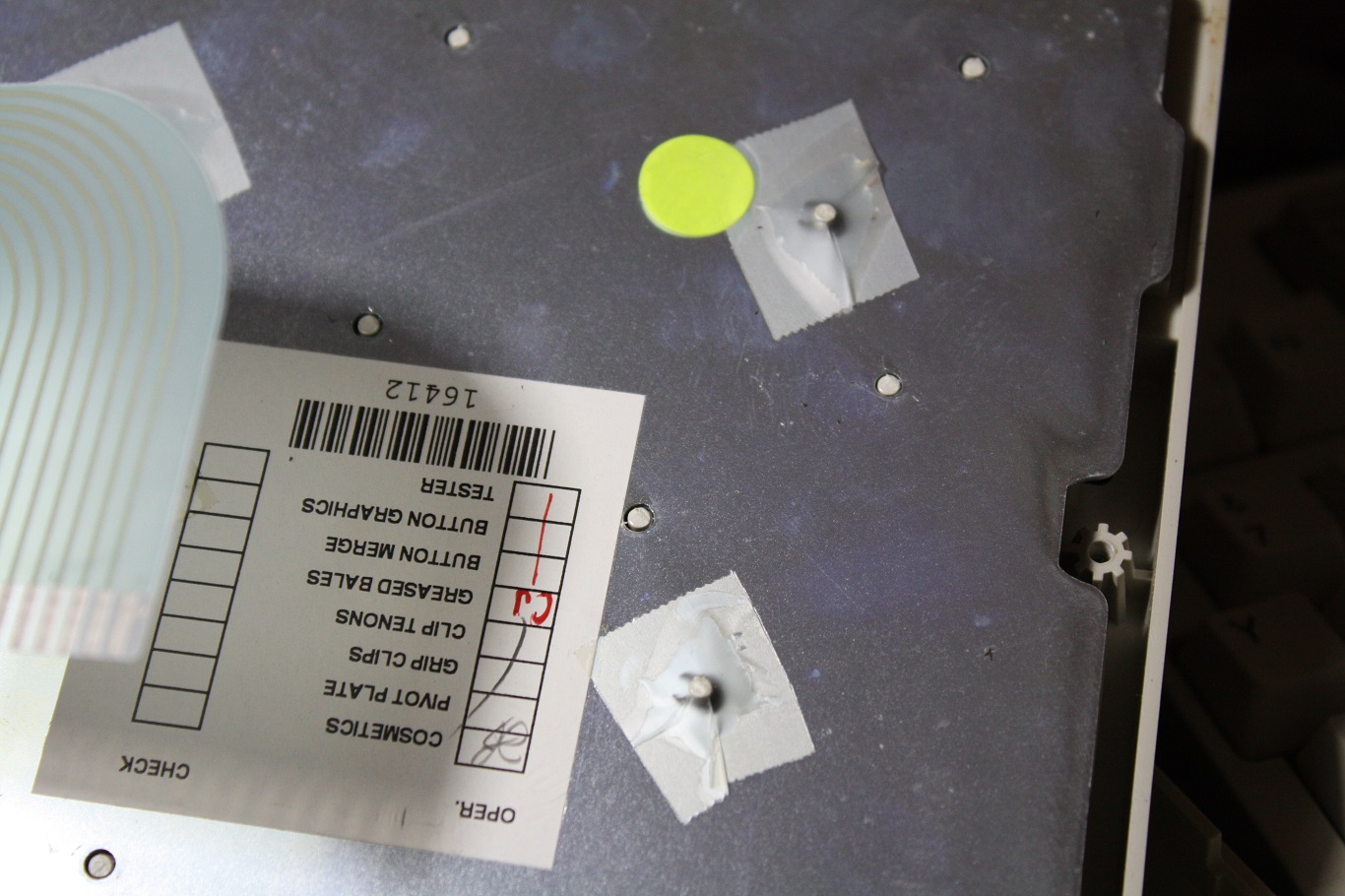

That was my initial thought as well but I have five screws and there are six screw holes in total. There are several more holes around the plastic layers as well as the metal plate but there are "posts" that stick up that help line up the layers and metal plate. I think just the screws are required. I'll have to open up the other side tomorrow and check it.
Here's a pic of the posts with green arrows and the screw holes with red arrows. I don't think I got all the posts but you get the idea.
IBM M15 - fitment of screws/posts
IBM M15 fitment.jpg (247.77 KiB) Viewed 12891 times

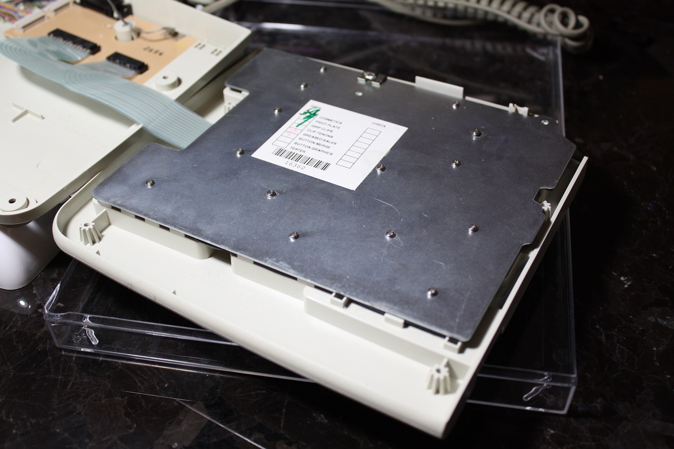

I just checked the DT Wiki for the M15 to see if it needed pics. I think there's an error. The article states "As with the M2, there is no metal backplate under the membrane, accounting for its flat profile and relatively light weight.". As shown in my first pic, clearly there is and the metal back plate is flat. That is considered a metal back plate, isn't it?
[ XMIT ]
17 Dec 2015, 13:22
Yes, that's definitely a metal backing plate (defined as a plate that goes between the membranes and the rear case). Great catch - now please go fix it! :lol:

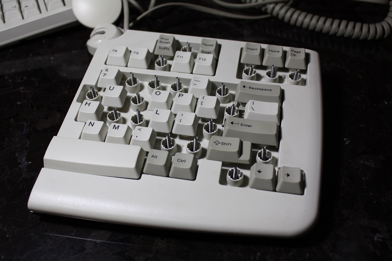

I checked the Enter key that has two channels for buckling springs. I installed two springs when it should have only put in one. The right most spring is "Enter". The left most is "\" even though there is already a "\" key that works. Anyway, if I remove the extra buckling spring, I'm good.

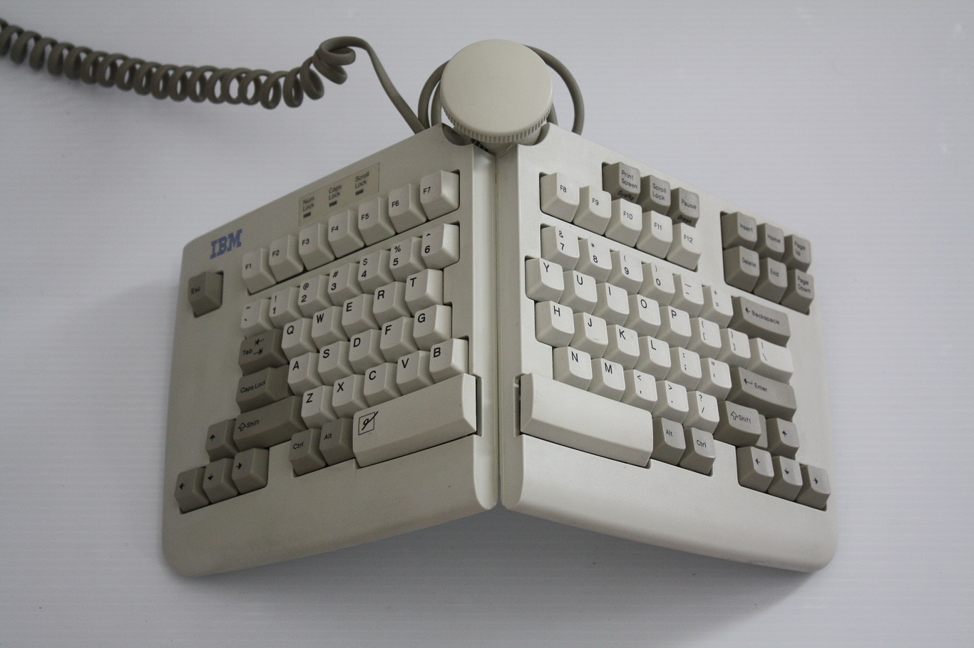

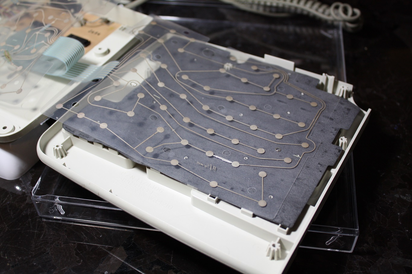

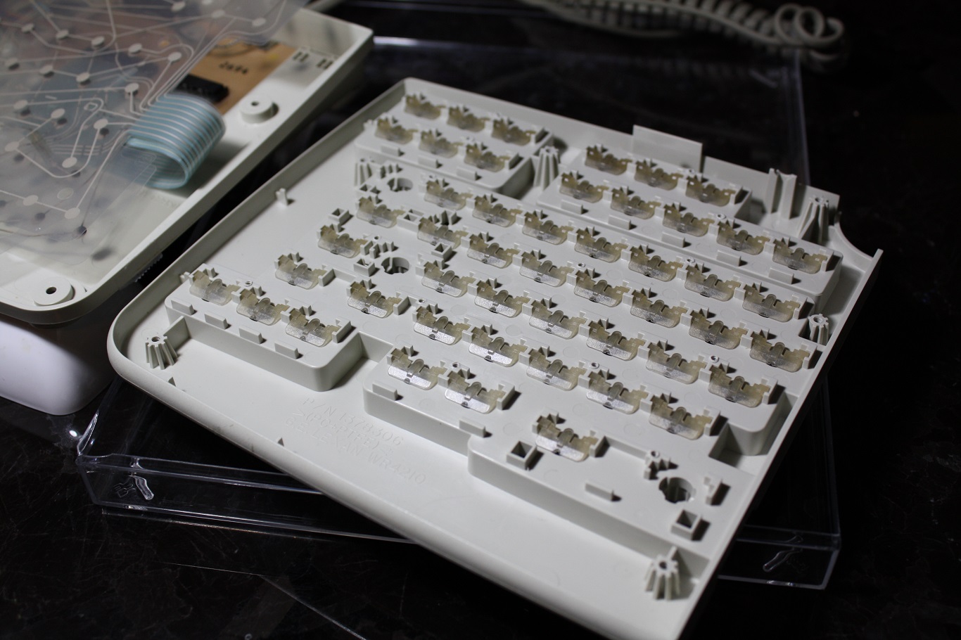

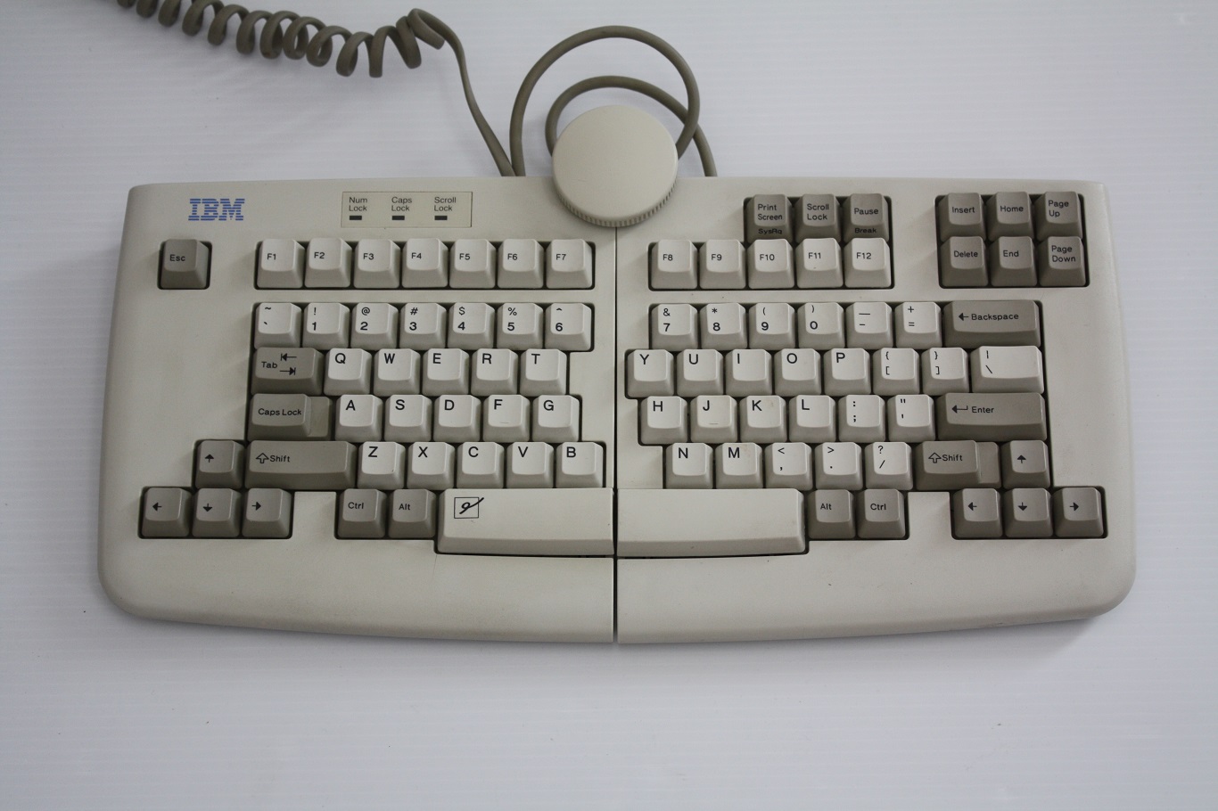

Here's an update on my M15 repair. I'm happy to say that it is completely restored with a screw mod on one side. I had assumed that the screws needed to be added to all posts but after opening the good side for pictures, it actually uses clips on a small number of posts.
One note of thanks. I have to thank @clickykeyboards at http://clickykeyboards.com for searching and finding the exact match parts for me. If you need IBM Model M parts, he's the guy.
Pics will help explain:
IBM M15 - Right side frame with buckling springs in place
IBM M15 - 1 Right side buckling springs in place.JPG (284.37 KiB) Viewed 12456 times

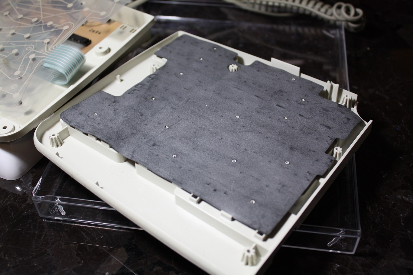

IBM M15 - Right side rubber layer over springs
IBM M15 - 2 Right side rubber layer over springs.JPG (309.94 KiB) Viewed 12456 times
IBM M15 - Right side first membrane layer
IBM M15 - 3 Right side first membrane layer.JPG (304.3 KiB) Viewed 12456 times
IBM M15 - Right side second spacer membrane layer
IBM M15 - 4 Right side second spacer membrane layer.JPG (294.52 KiB) Viewed 12456 times
IBM M15 - Right side metal plate
IBM M15 - 5 Right side metal plate.JPG (283.12 KiB) Viewed 12456 times
IBM M15 - Right side screws added
IBM M15 - 6 Right side screws added.JPG (284.68 KiB) Viewed 12456 times
IBM M15 - Right side top and bottom ready for closure
IBM M15 - 7 Right side top and bottom ready for closure.JPG (266.85 KiB) Viewed 12456 times
IBM M15 - Right side adding key caps
IBM M15 - 8 Right side adding key caps.JPG (232.84 KiB) Viewed 12456 times
IBM M15 - 9 Left side.JPG (275.21 KiB) Viewed 12456 times
IBM M15 - Left side close up showing clips
IBM M15 - 10 Left side close up showing clips.JPG (312.89 KiB) Viewed 12456 times

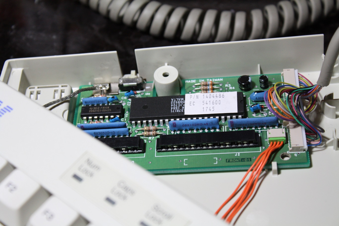

IBM M15 - Left side keyboard controller
IBM M15 - 11 Left side keyboard controller.JPG (295.22 KiB) Viewed 12456 times

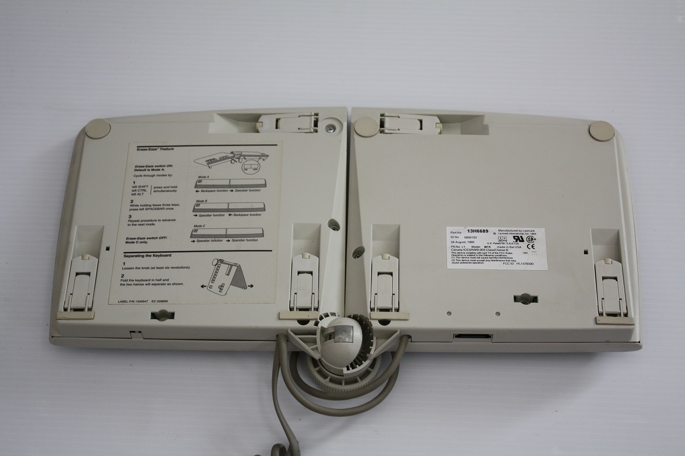

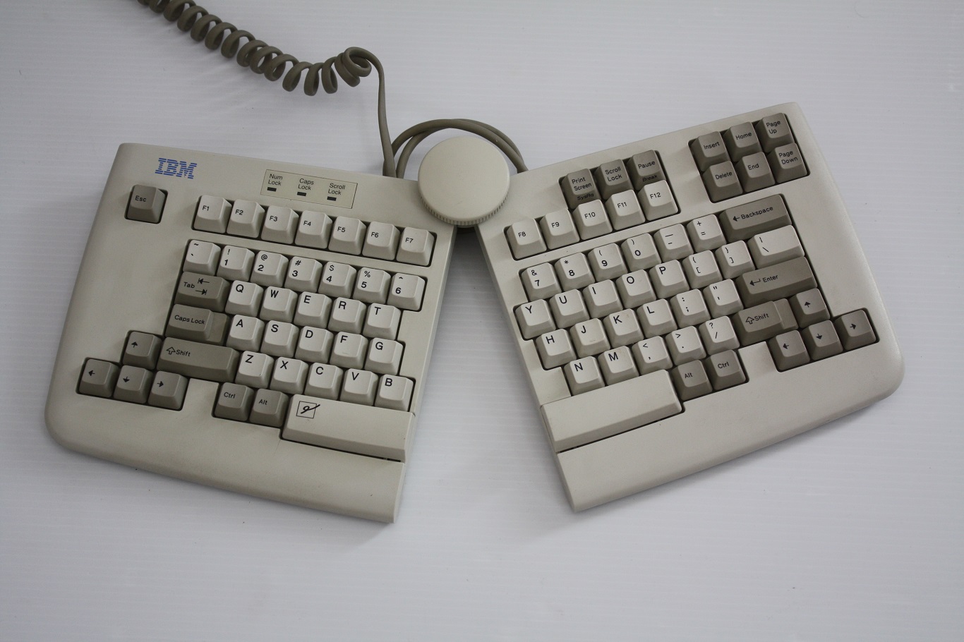

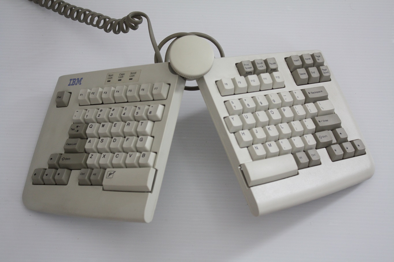

Final pics with it all cleaned up. I am missing one foot on the bottom but hope to find it and the matching numeric keypad some day to complete the set.
IBM M15 - keyboard top
IBM M15 - keyboard top.JPG (248.45 KiB) Viewed 12446 times
IBM M15 - keyboard bottom
IBM M15 - keyboard bottom.JPG (234.61 KiB) Viewed 12446 times
IBM M15 - keyboard split
IBM M15 - keyboard split.JPG (259.75 KiB) Viewed 12446 times
IBM M15 - tented
IBM M15 - tented
IBM M15 - tented.JPG (264.33 KiB) Viewed 12446 times
IBM M15 - tented and split
IBM M15 - tented and split.JPG (242.79 KiB) Viewed 12446 times
08 Feb 2016, 20:14
Great work snuci! How does it feel? Will you do the same screw mod to the other side for more uniformity?
snuci
Vintage computer guy
08 Feb 2016, 20:19
scottc wrote: Great work snuci! How does it feel? Will you do the same screw mod to the other side for more uniformity?
Thank you. I contemplated it but there is absolutely nothing wrong with that side and as a preservationist, I will leave it as is so that I know what it was like originally. Technically, it is "uneven" in it's repair construction but if I could have found the original clips, I would have preferred to restore it that way to keep it original. There's no hope I would have found those clips.
