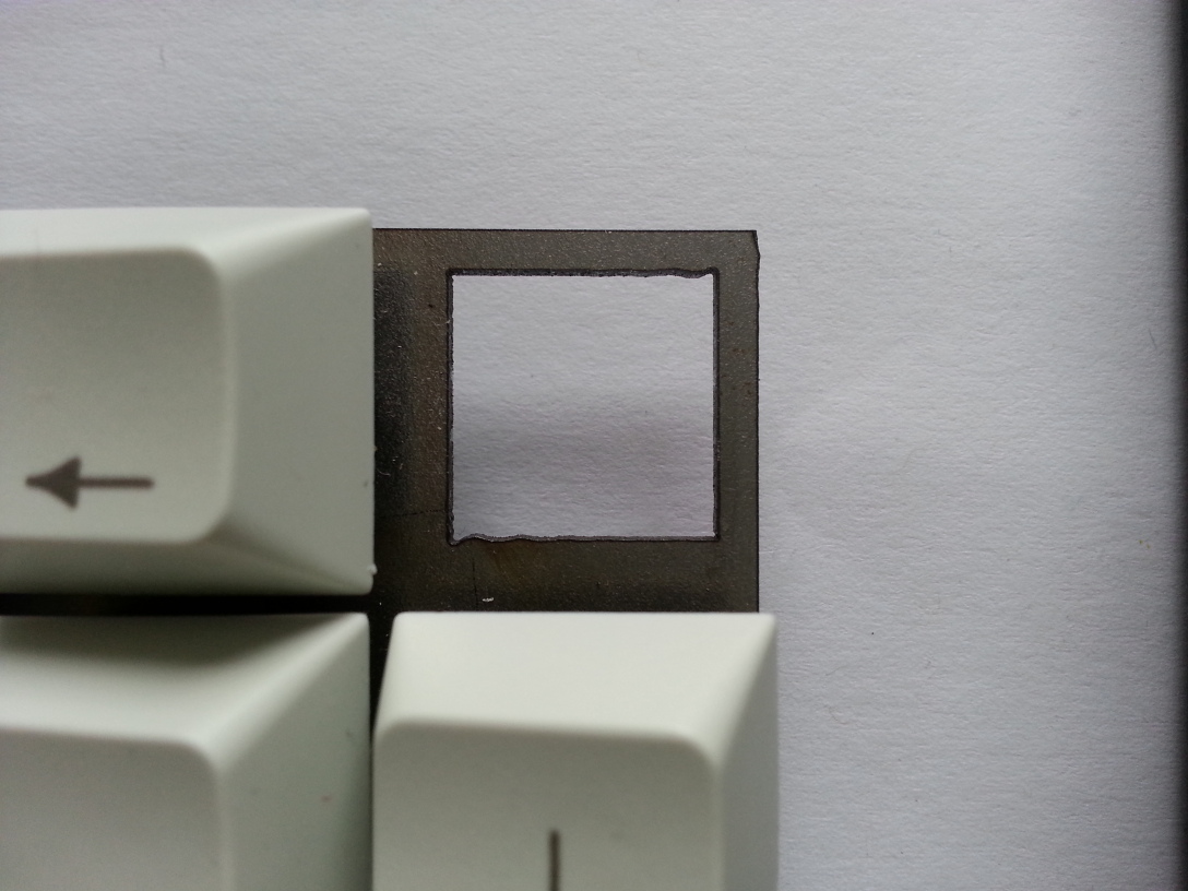

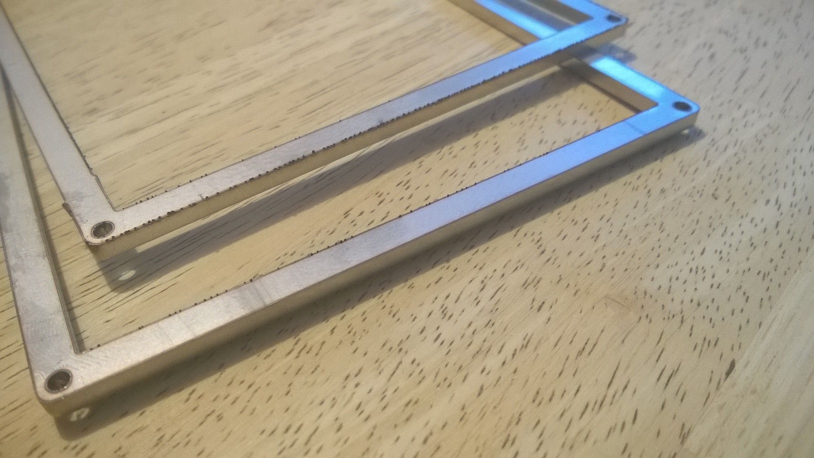

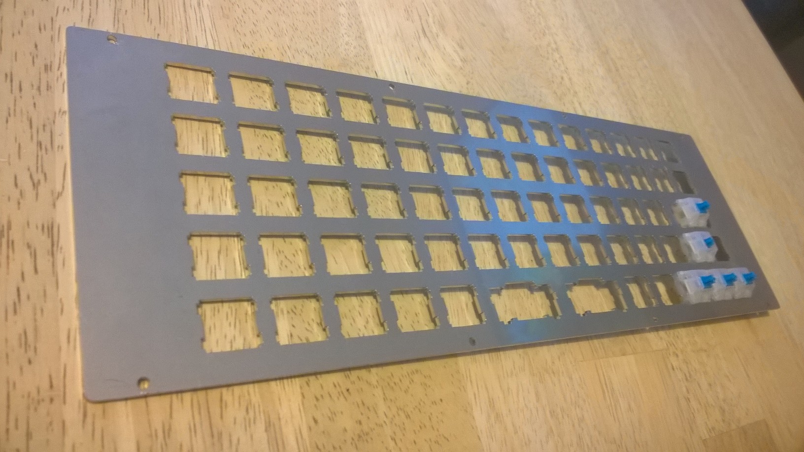

I received a couple of laser cut plates yesterday, the designs for which were from SwillKB plate designer. Ignoring my obvious design issues can anyone comment on the quality of the laser cutting. Having not seen any before I'm unsure as to what finish to expect!
The cost for 2 x 65% size plates in 1.5mm, 2 x bases in 1.5mm, 2 x 3mm sides and 1 x 6mm side was £93.00 delivered

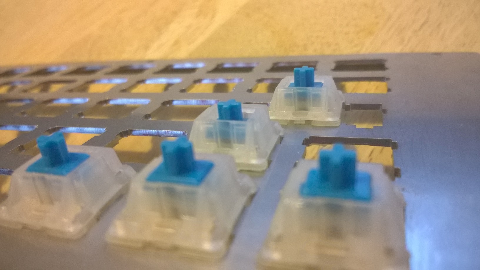

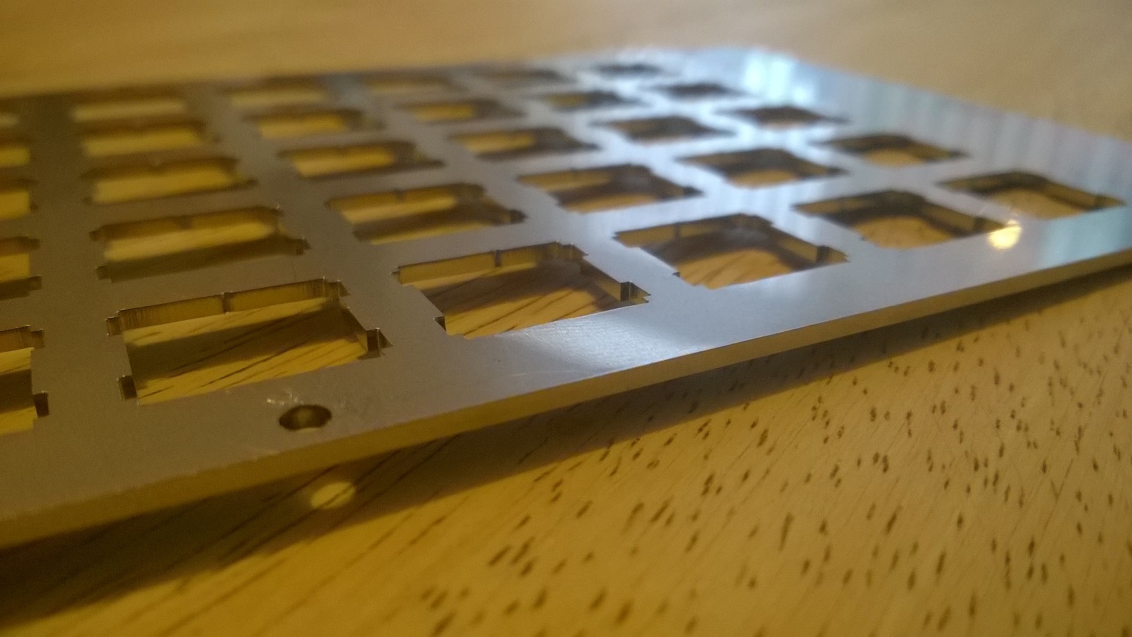

My main concern is as a result of my Gateron blue's fitting extremely tightly in the openings, so tight in fact that a keypress registers but the switch fails to return to resting position (Last pic). I've remedied a couple by filing the opening and the catch mechanism on the switch but obviously I shouldn't have to do this.

How big are the switch openings?
I just got a plate made from jdcarpe's .dxf file which came up with a few bumps here and there, just as you, nothing dramatic though. Although the switch openings on the drawing are 13.97 x 13.97 mm, they were cut just a tad larger (maybe 14.1 x 14.1, I do not have a caliper precise enough to check more accurately) but switches snap in perfectly and do not move once installed.

If looks like there could be some burr left in the switch hole. If there is, then you may want to file those down. Otherwise those will chip the switches if you insert and remove them again.

Hi Matt, yeah I've just ordered a set of calipers from Amazon so will measure tomorrow when they arrive. I did alter the "kerf" and entered the figure as provided by the company that did the laser cutting. Perhaps me rushing and not fully understanding that setting has resulted in openings that are too narrow. I just wanted something quick so I could play whilst I have some free time over Xmas. Less haste more speed as my Nan used to say!
In terms of the plate itself I noticed a lot of rough edges and burrs although that may be normal with laser cutting?

Laser produces slag/spatter on the underside of the cut, because it melts the metal to remove it.
Those burrs are most of the time loosely stuck there, so a metal brush should get them easily.
For reference have a look here and here. This a from a GB I run this summer.
The TKLs are the default dxfs for the Phantom, but the 60% was made with swill's tool with no kerf adjustment.
The cuts in your seem a bit "crude" but that could be the photo quality fooling me. In your second pic, the lines you see in the middle of the switch opening seem to be the entry point for the laser, and could be avoided with a small modification to the laser path (not a setting you can make, you should talk about that with the shop).

so...after measuring the switch openings it seems my inserting a "kerf" figure has resulted in openings that are 0.4mm too small. Serves me right for being inpatient and not asking questions, nor fully understanding how it may affect the finished product.
Moral of the story as my dad always said, measure twice, cut once... and if in doubt, Ask!
:evil: My punishment for being a ****, several hours spent filing the plate openings to the correct size :evil:
