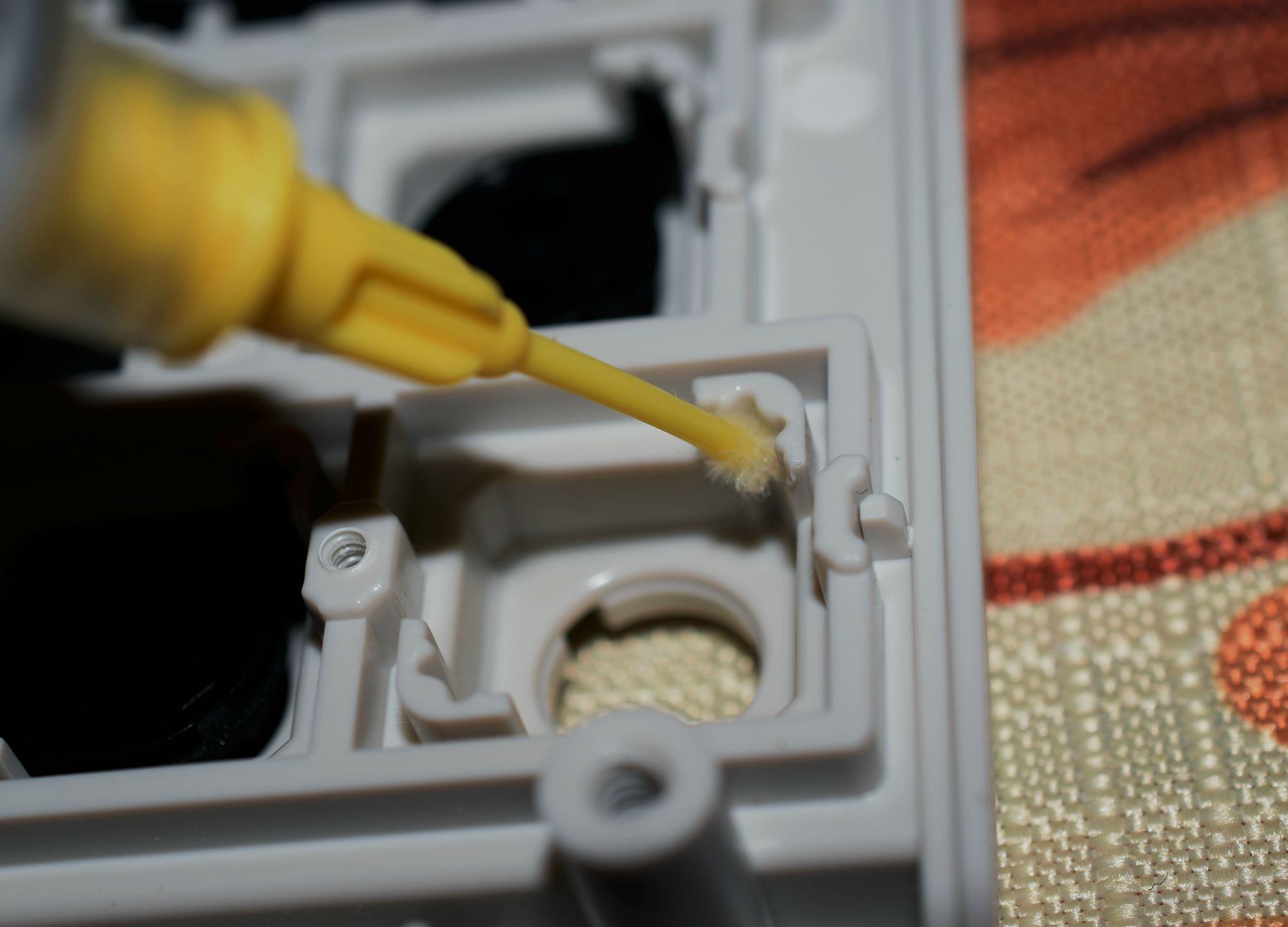

My current method is to install Silencing Rings in all the switches and then to lubricate the stabilizers and switches using SuperLube 51010 Oil. The oil is applied with a small paintbrush on friction points such as articulations of stabilzer wires and the slider rails of switches. I've reproduced an image showing a similar procedure on the switch slider rails of a HHKB Pro 2 keyboard:
https://i.imgur.com/DQyf2Sa.jpg

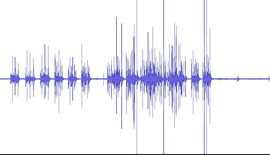

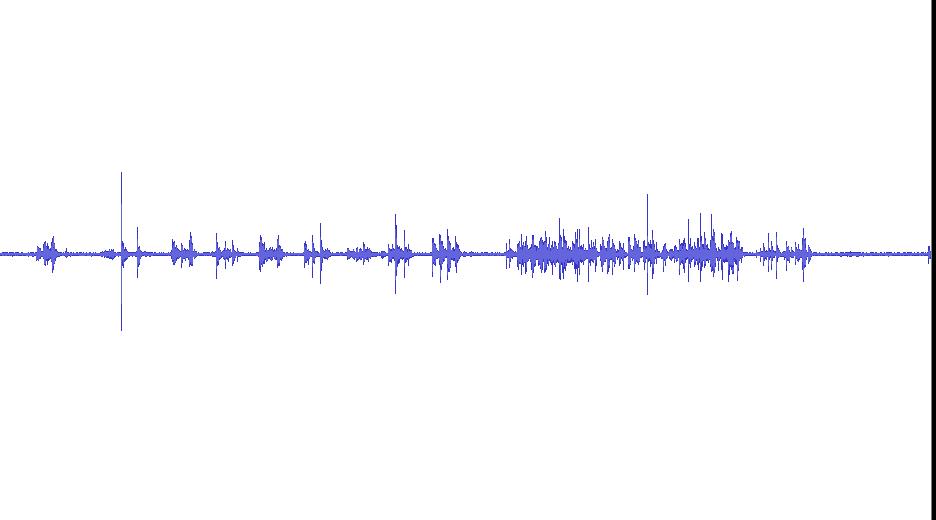

This method produced the best silencing I have experienced to date, as demonstrated in the following video/audio clips and audio waveforms. Keystrokes were 3 each of Tab, Backslash (HHKB Delete/Backspace), CapsLock/Ctrl, Return/Enter, Left Shift, Right Shift, and Spacebar, followed by 3 each of "This is this." (without quotation marks), ending with 3 each of Return/Enter and Spacebar.
RF87UB55
Before Silencing:
After Silencing:

Hypersphere wrote: My current method is to install Silencing Rings in all the switches and then to lubricate the stabilizers and switches using SuperLube 51010 Oil.
Is there a risk that, over time, the oil will drip down onto the PCB?
Hypersphere
26 Dec 2015, 16:18
I suppose so; however, I have seen posts elsewhere regarding using synthetic oils to lube Topre swtiches and I do not recall seeing any posts indicating problems resulting from the oil seeping past the domes and reaching the PCB. In any event, oil should be applied sparingly.

Why shouldn't one lube the plungers too? So sliders and plungers? Are there any downsides to this?
Hypersphere
10 Aug 2016, 05:27
I recommend lubing only the rectangular slider rails, not the cylindrical slider (aka plunger) itself or the cylindrical housing. I was also given similar advice by EK.com. I also recommend synthetic oil for the slider rails. Grease could be used to lube the stabilizers.
face
10 Aug 2016, 08:59
Alright, thank you!
