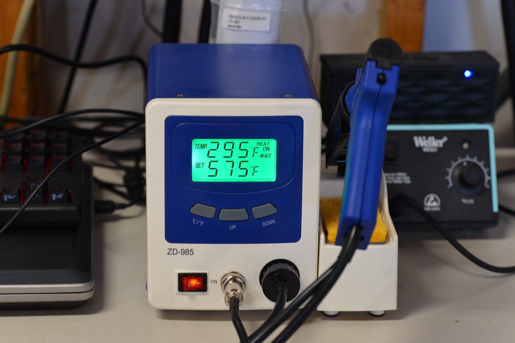

It's a ZD-985 desoldering station! Cheap, readily available, works okay for now.
http://www.memotronics.com/vacuum-desol ... l-lcd-new/

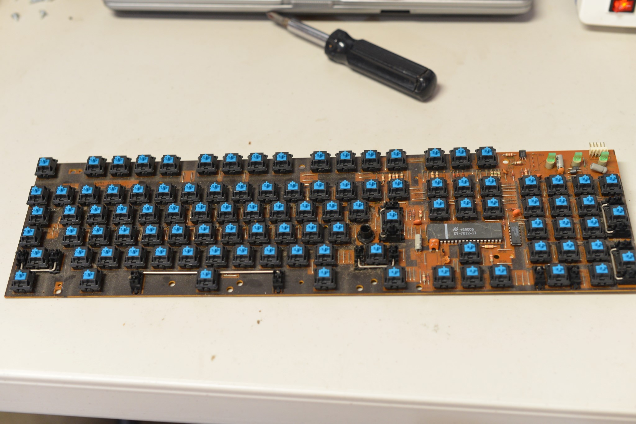

I just used it to pull some PCB mounted vintage Cherry MX Blue switches from "f26c":
http://coronthica.com/by-uuid/f26c369b- ... 73a7cbab1/
I went from this...

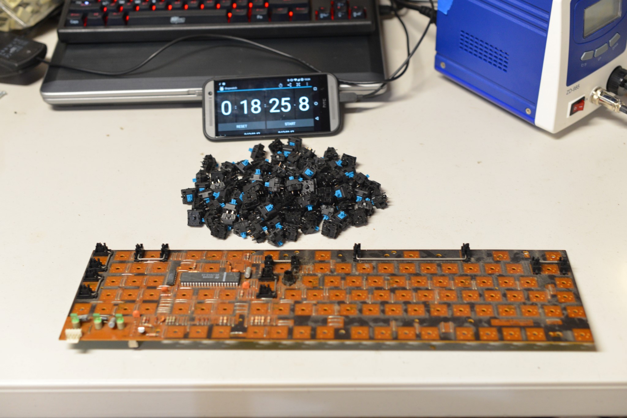

...to this, in well under 20 minutes!
We'll see how well it holds up over the long term. I do have a replacement parts kit for it (in a plastic baggie taped to the back of the station if you look closely in the photo).
More information here:
EEVblog #542 - ZD985 Desoldering Station
https://www.youtube.com/watch?v=Ft50m8UU5WQ

Experience builds on experience. I was practicing on some controllers and other random through hole parts yesterday and did the MX Blues in 18 or so minutes. Actual desoldering took 12 minutes, unmounting took 6. I'd like to disassemble these and run them through the ultrasonic cleaner to see if I can improve them at all.
I've desoldered Alps boards before though the hard way with a solder sucker. The issue is that the little plastic retainer wings break really easily on old brittle key switch housings. No, my real goal was to work on a ANSI and TKL conversions for Space Invader keyboards: the former with a 3D printed key cap, the latter with yet to be determined work!
