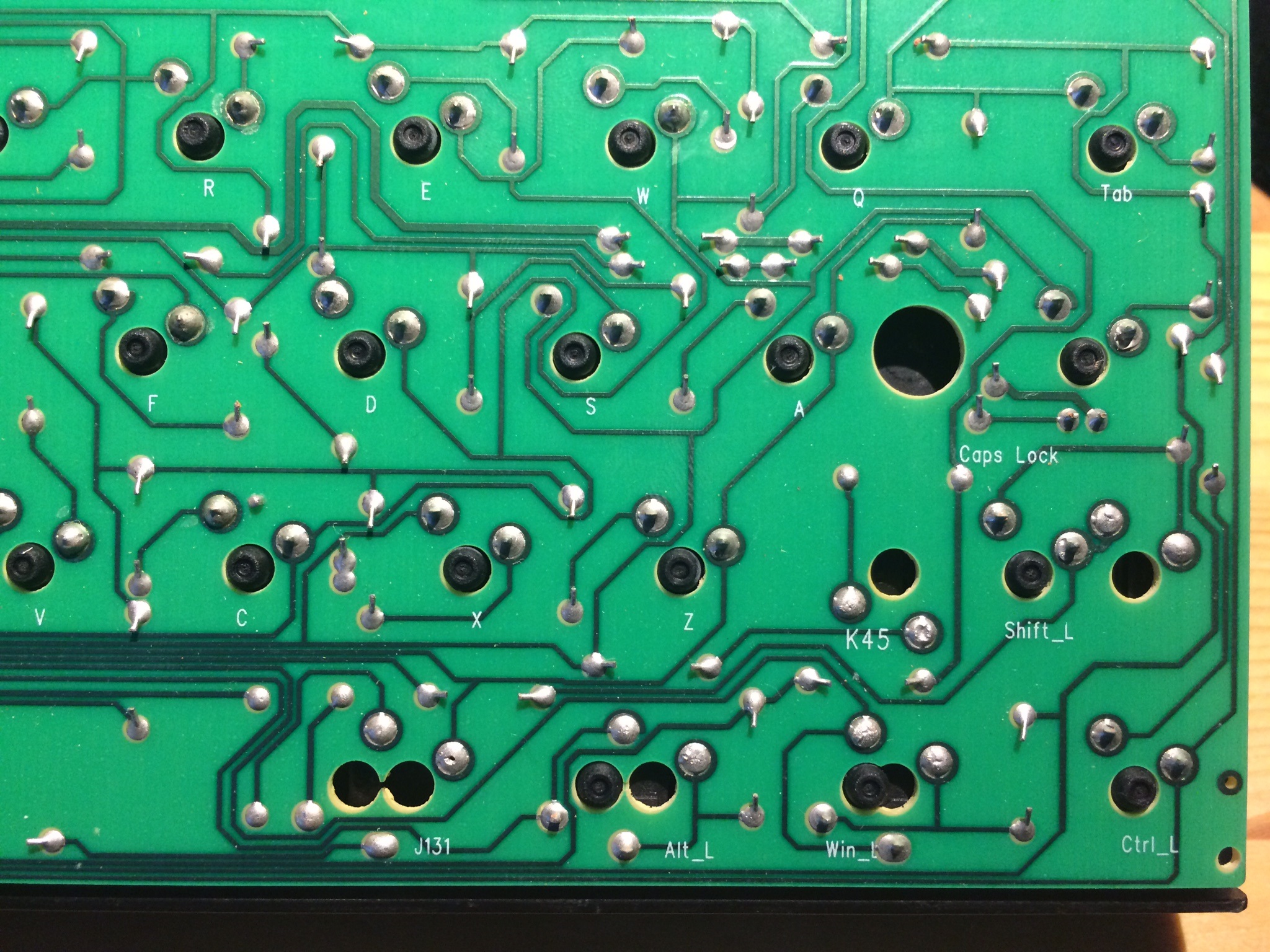

The broken key is labeled Alt_L in the bottom row on the attached image.

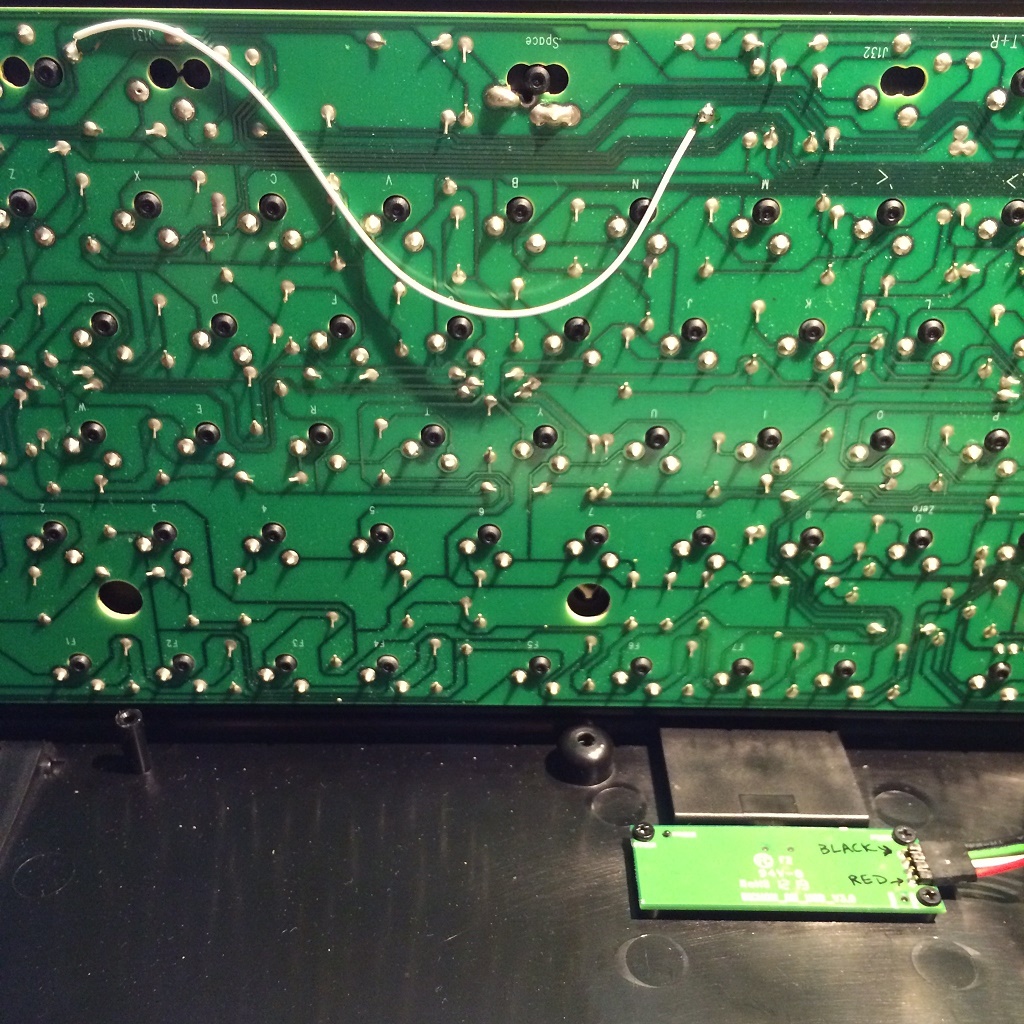

The PCB trace for column C going from the l-alt key to the r-alt key had problems. Fixed it by using a wire to bypass it. :D
L-Alt was the last key on that column because of which no other keys were affected by this issue.
