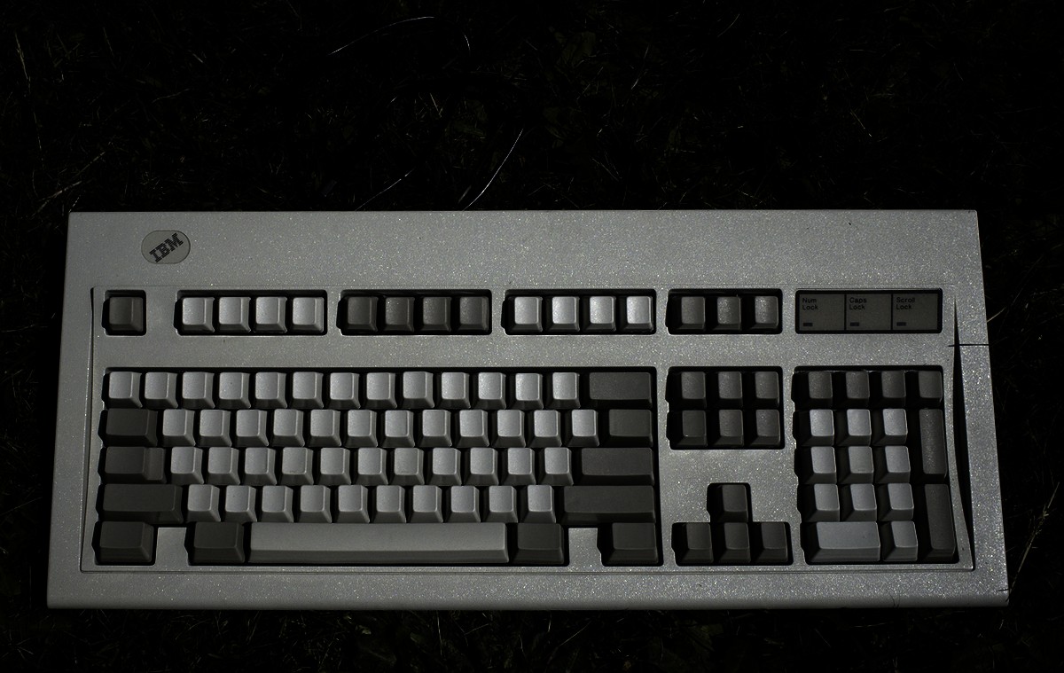

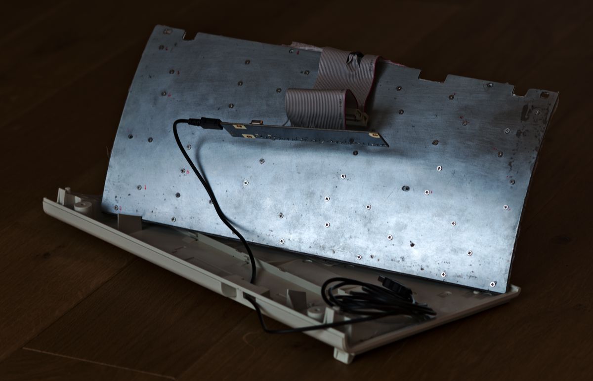

Let me introduce you to the 0001FSSK, the first SSK F-transformed, using the PCB version 0.51 + patches.

PCB Version v1.0 - no patches - No extra keys
The first of the v1.0 Group Buy
As a bonus track, the FSSK 0001 and FSSK 0003 side by side ... nude.

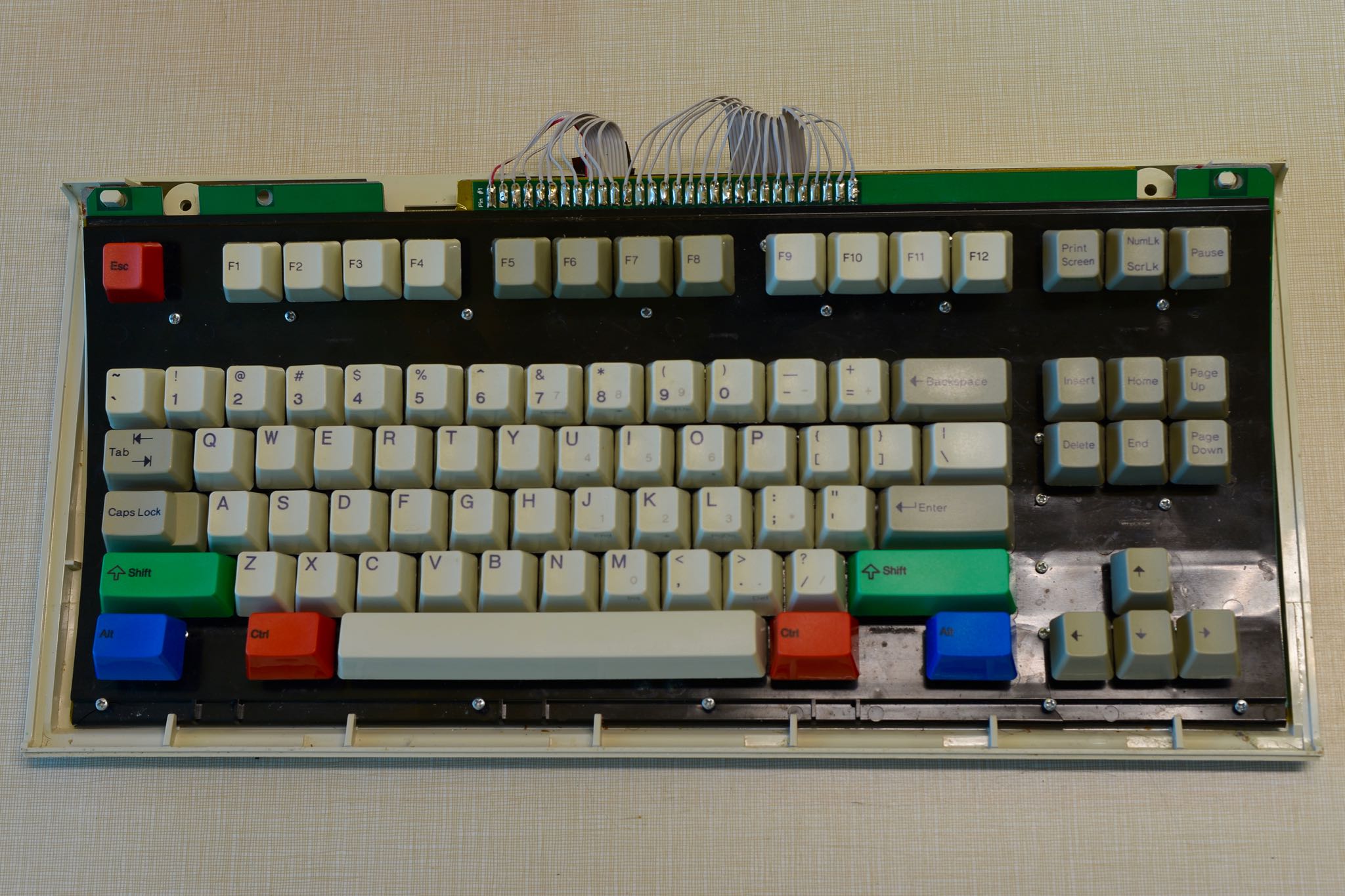

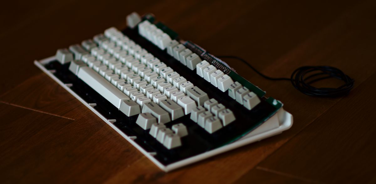

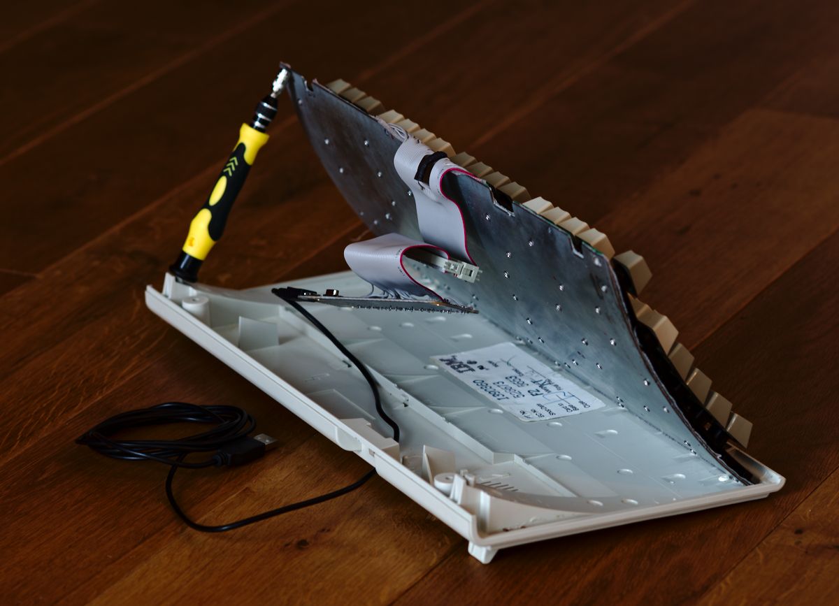

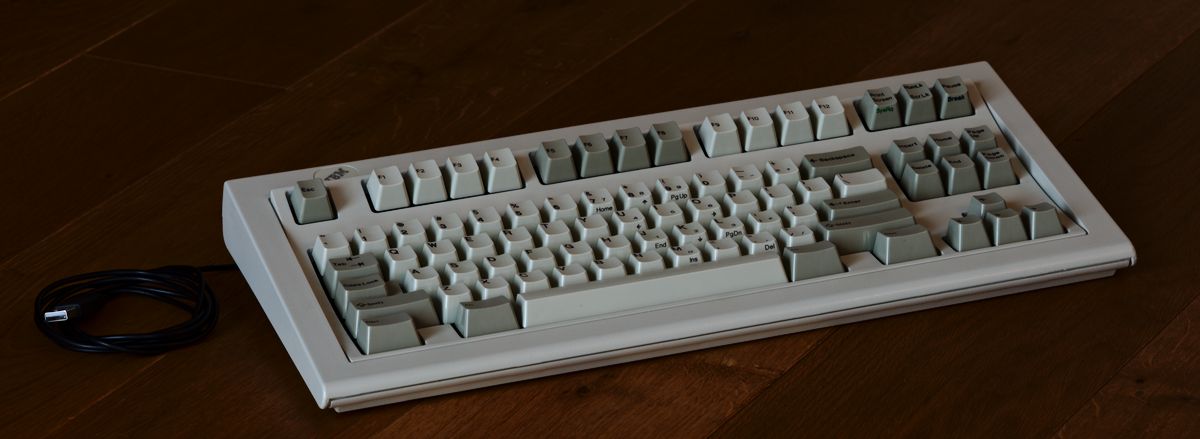

Photos as promised.

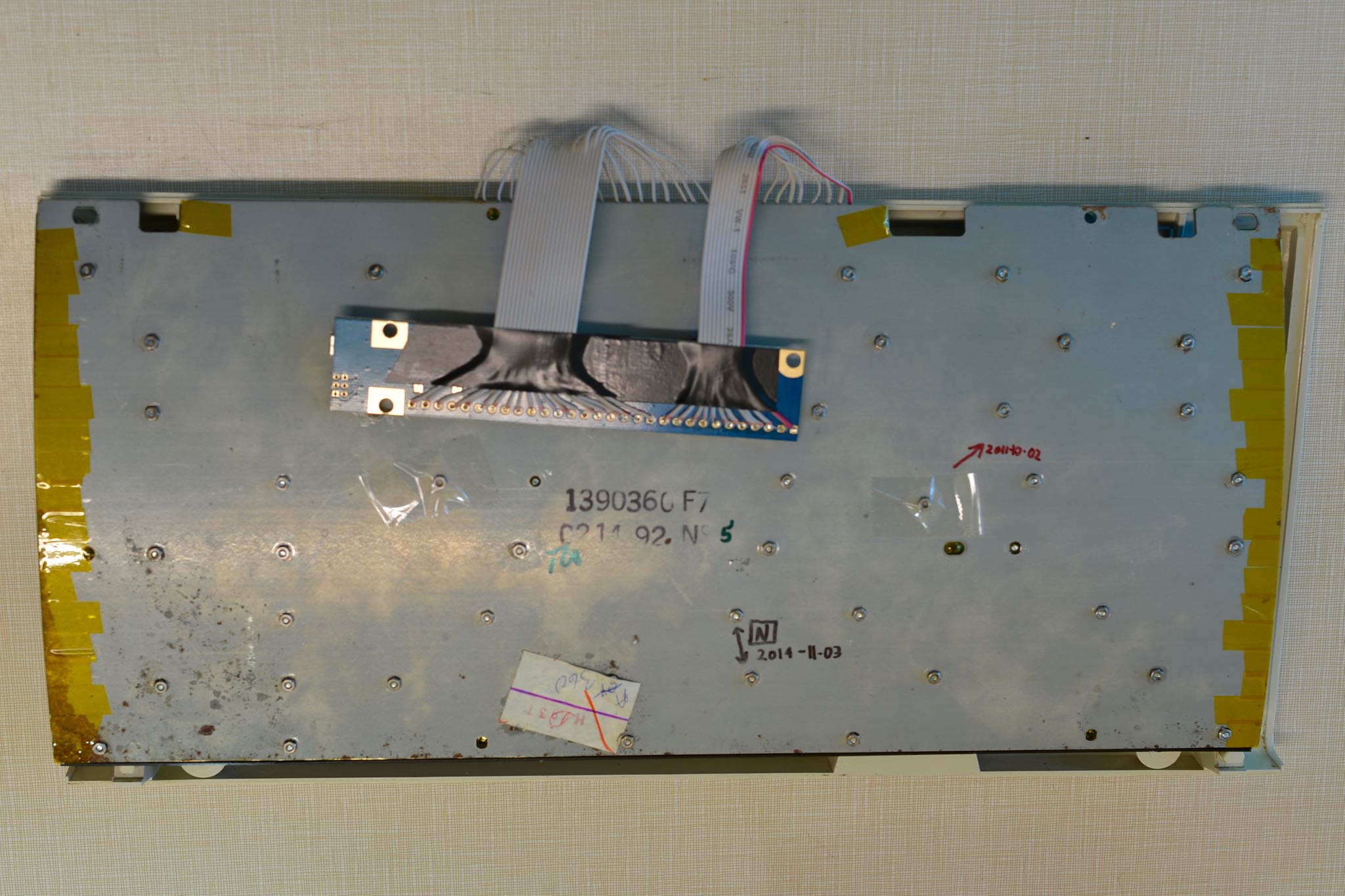

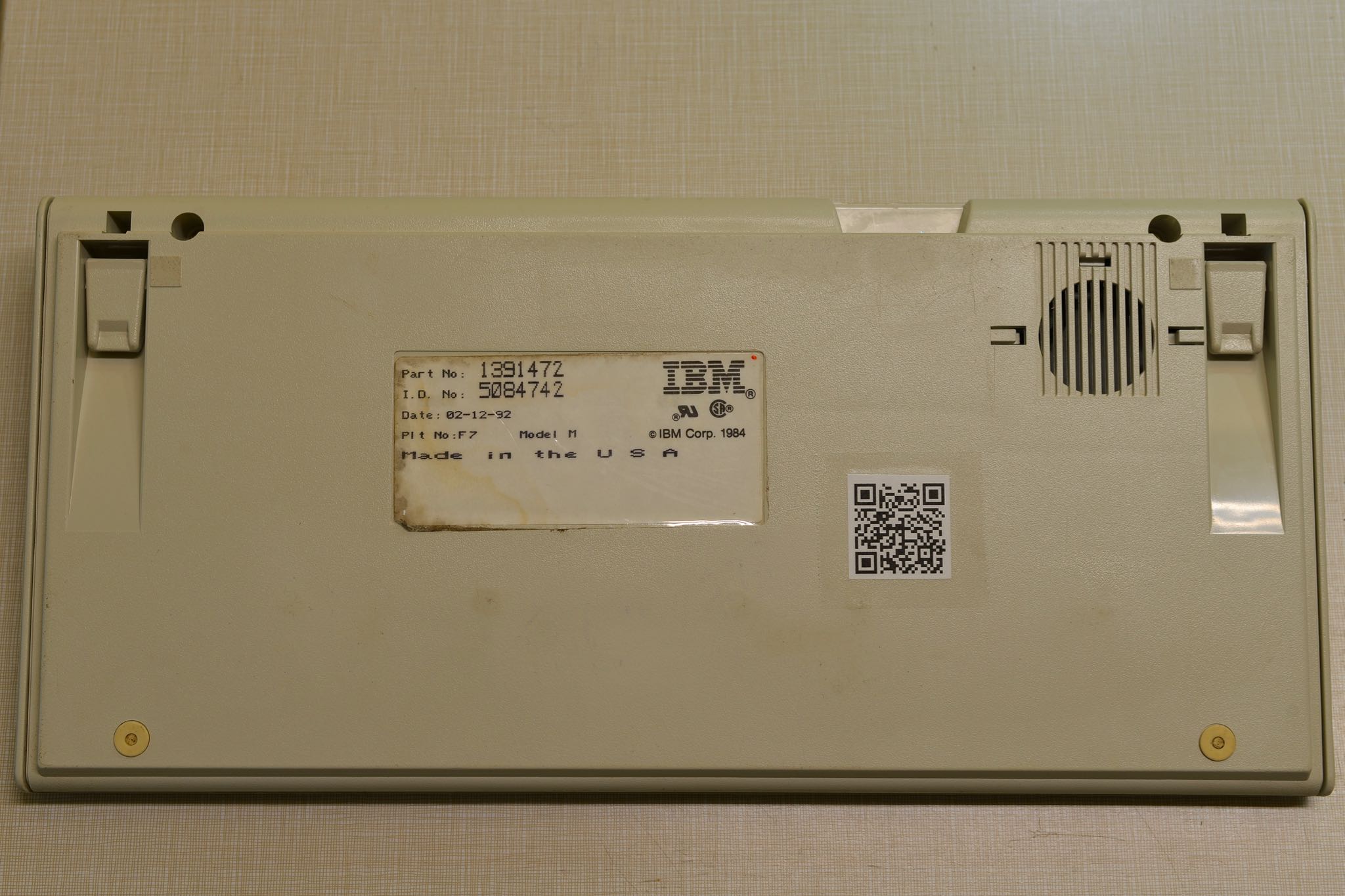

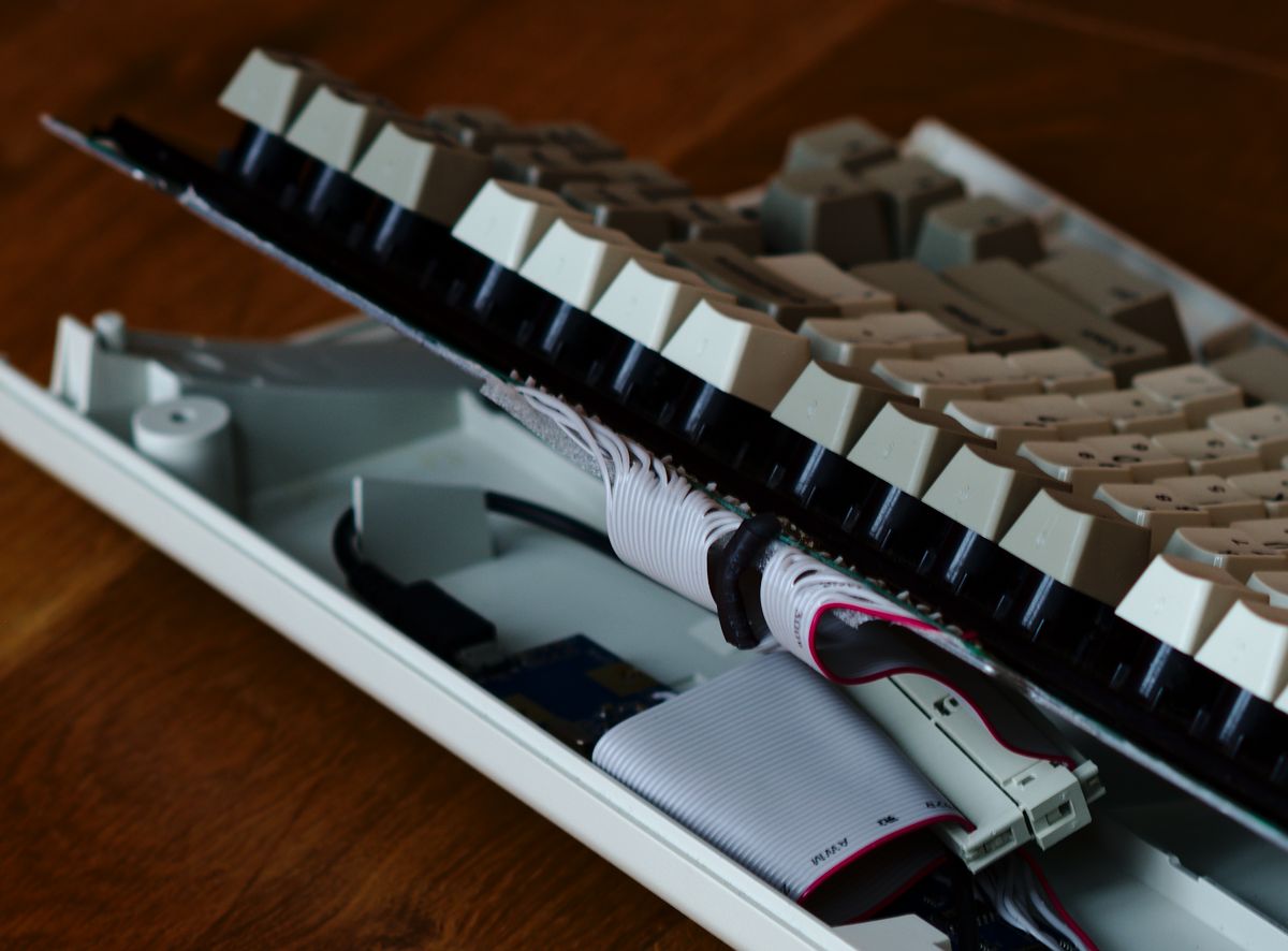

If you look closely you will see three things:
1. I used Kapton tape to isolate the PCB from the plate.
2. I surface-mount soldered the ribbon cable to the PCB (because it wasn't clear that the plate was supposed to be cut - and in the end it didn't need to be).
3. I used two separate runs of ribbon cable for rows and columns.
I'll talk about all of this and more in the full FSSK build log that I'm working on.

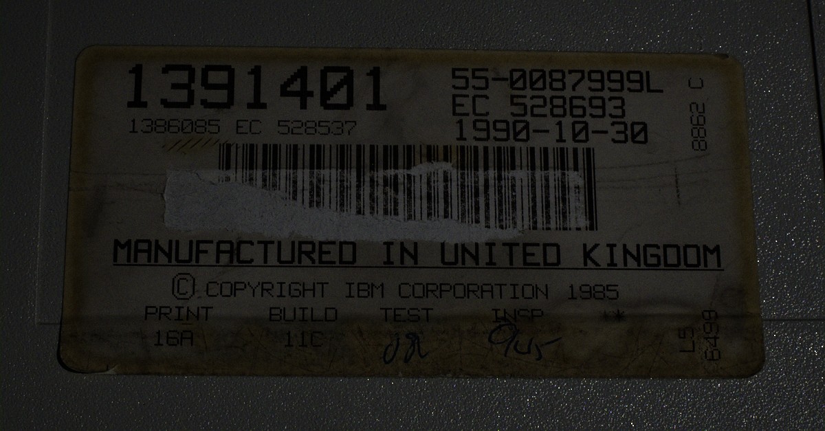

Donor 1391472/5084742, 02-12-92. I'll print a new label for the FSSK.

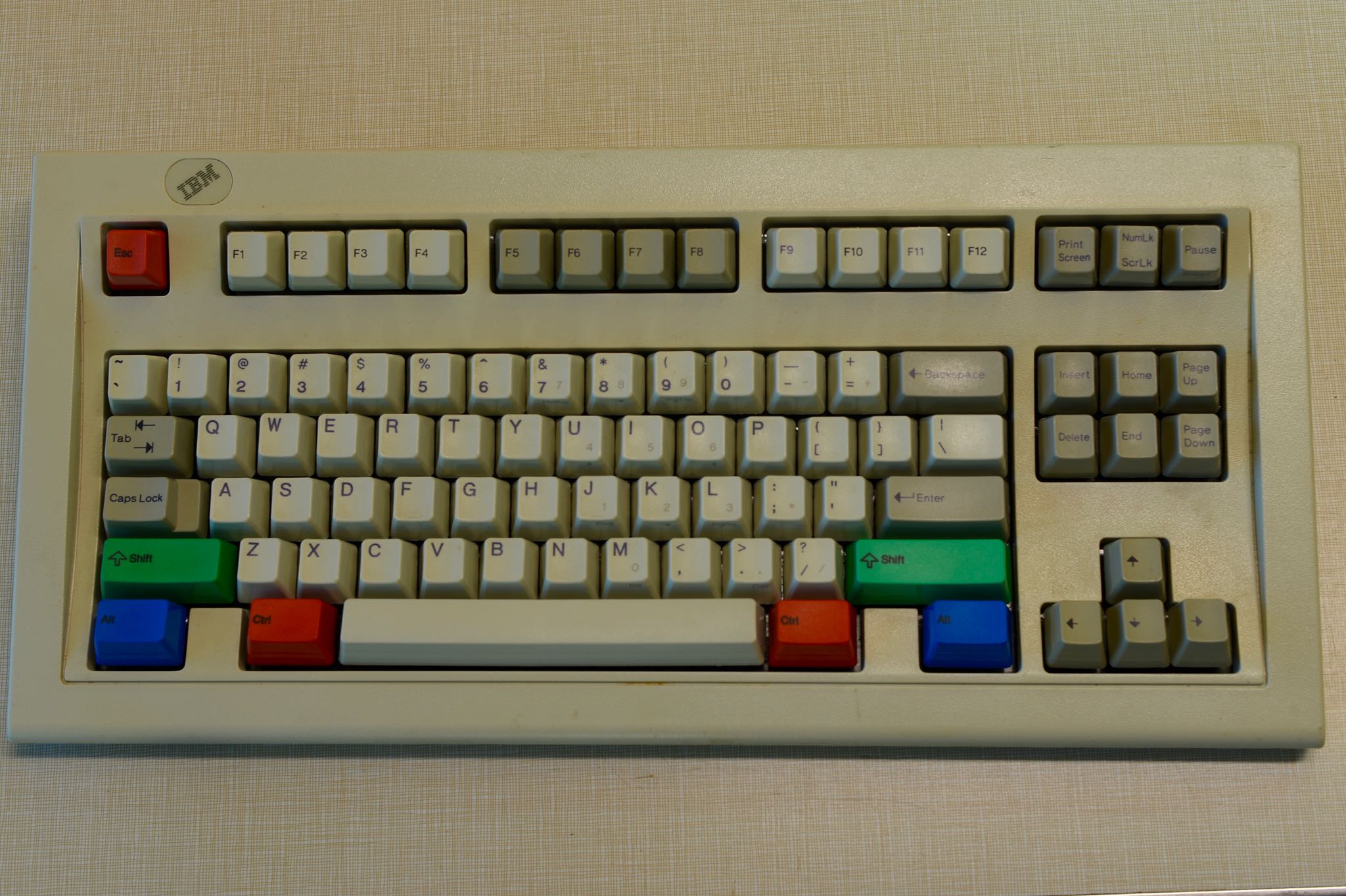

FSSK with RGB modifiers. The green right Shift didn't actuate correctly so now the board has normal modifiers.
Definitely an FSSK. idollar prototype PCB and surface mount soldered ribbon cable are present in this photo.
xwhatsit attachment. Bolt mod and previous mod notes present.

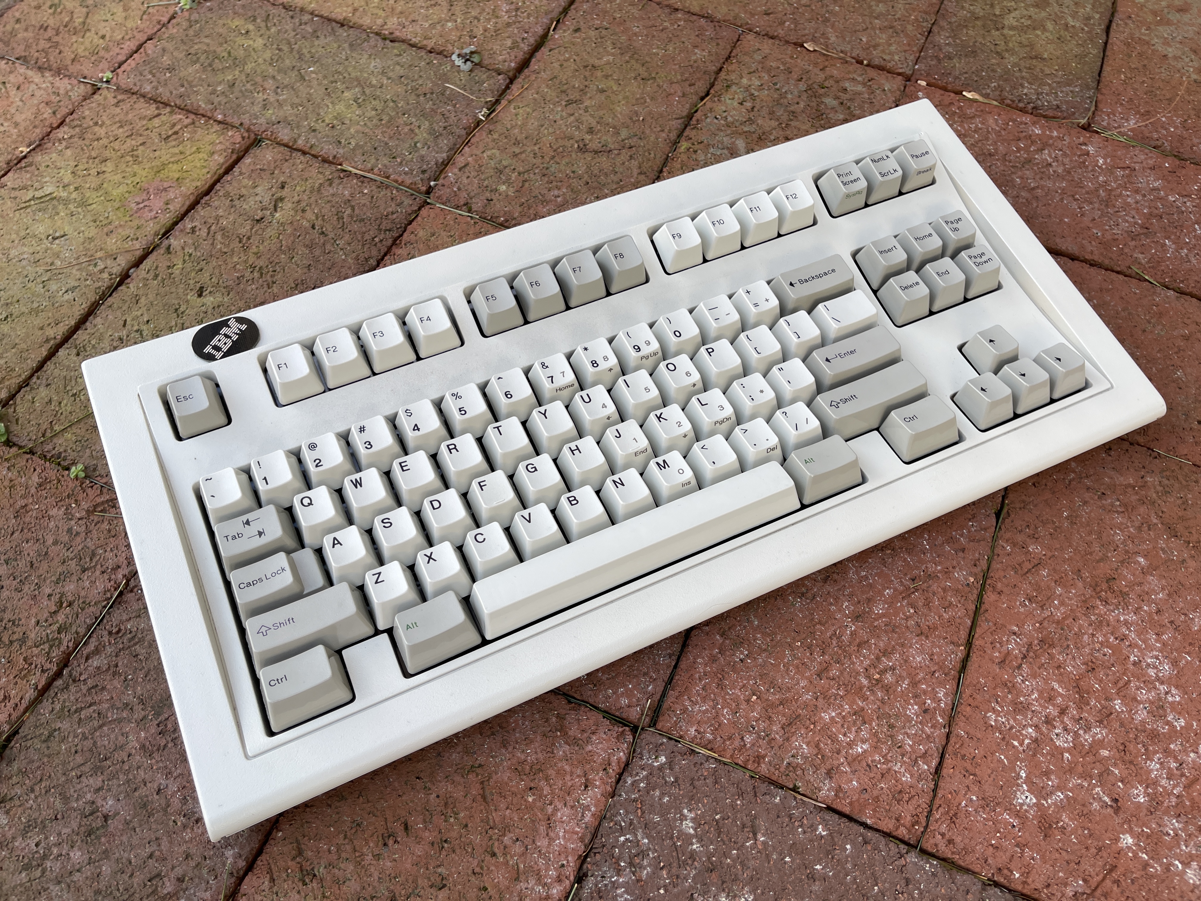

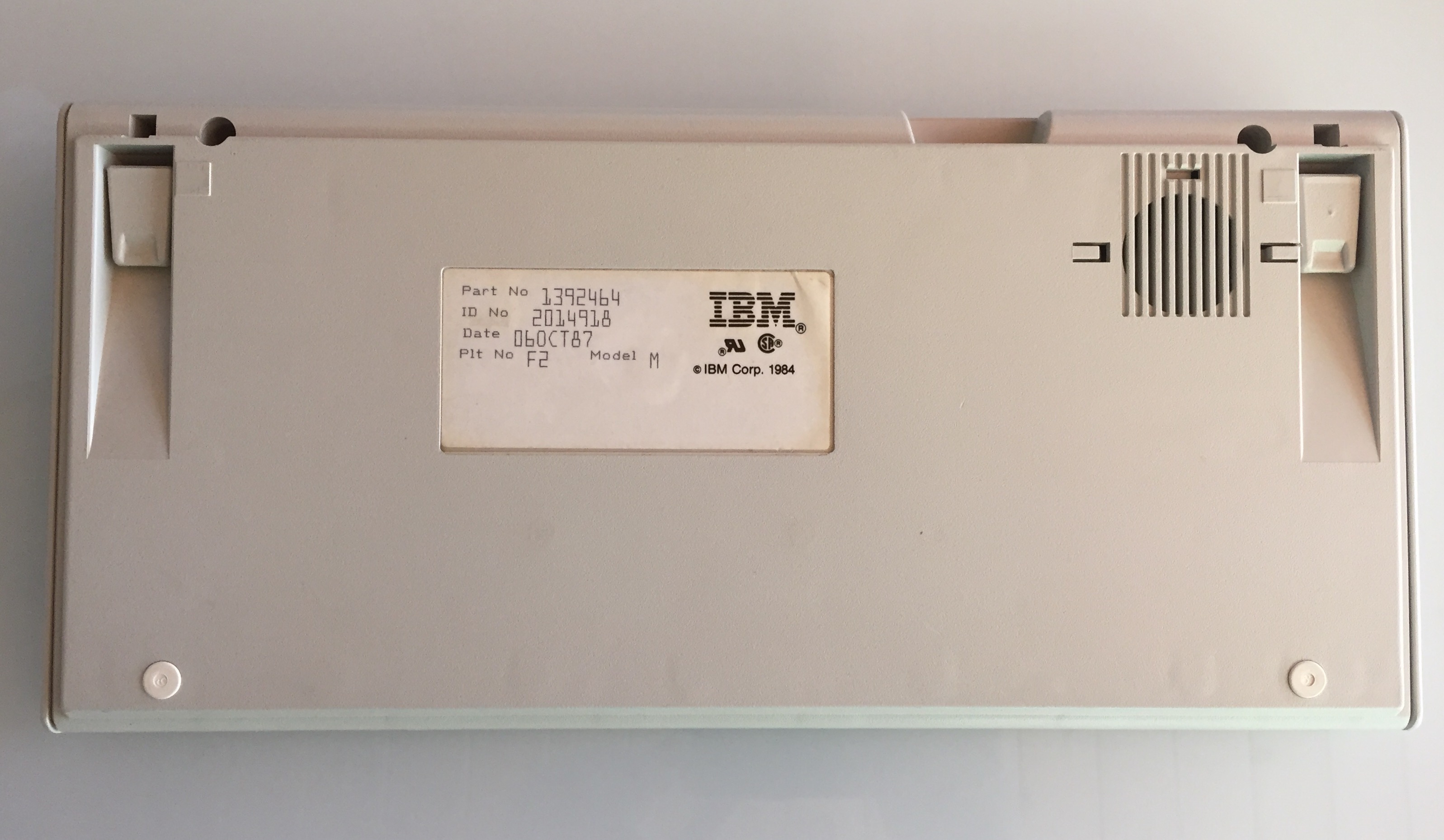

It is a franken-F of parts from various boards (Printed plates and die cut foam, Bigfoot barrels and flippers, 1397681 one-piece keycaps, Cherry adapter for enter/return, and a 1392464 (DisplayWrite) shell. Typing away on it though... Works great. I think that makes me number 5?

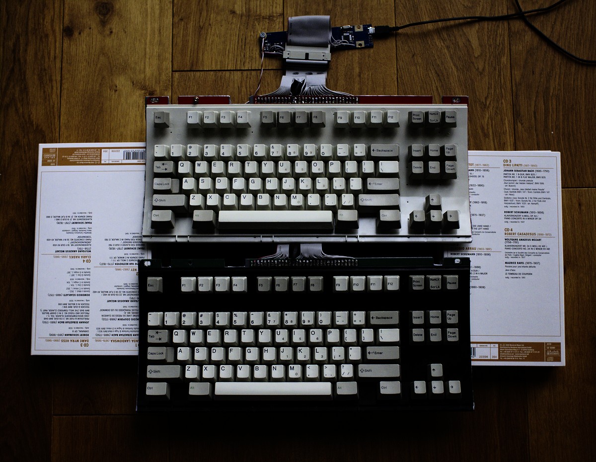

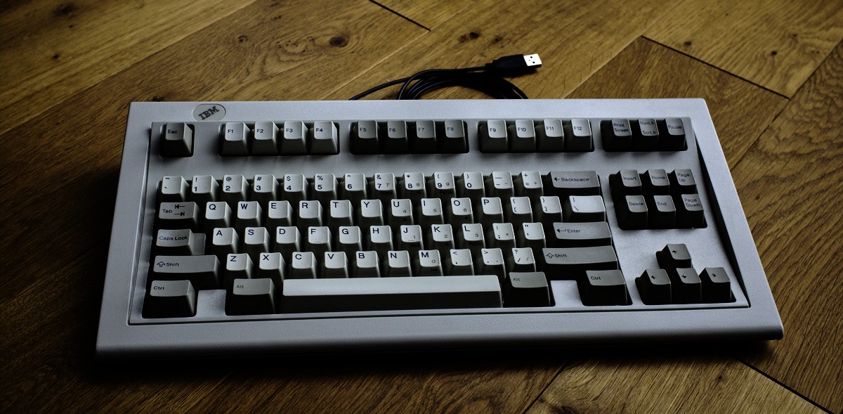

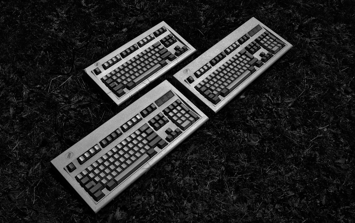

Here is the registration data for the FEXT 0001 - PCB is the #5 (randomly selected)
The PCB prototype has not any bug, which means that there will not be anymore FSSK v1.00 produced. Instead and as the FSSK is just a reduced version of the FEXT, if there is interest, we will go for the FSSK v1.00b
Bonustrack:
Halvar and I had a session at home to finalise his FEXT 0002. I had a very good time, on top of his more than nice presence, we managed to finalise the work. Lets see how does he resolves the registration of a keyboard without back label :mrgreen:
In the following you can see the FEXT 0001, the FEXT 0002 from Halvar and the FSSK 0001 together.

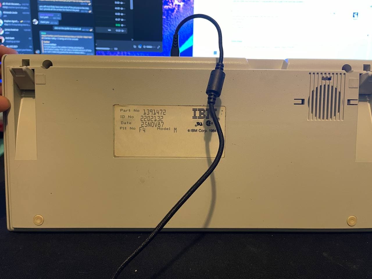

I have no clue if this thread is still up to date, but if so it appears I have FSSK #8?
Full build thread here: viewtopic.php?f=7&t=25169&p=477679
