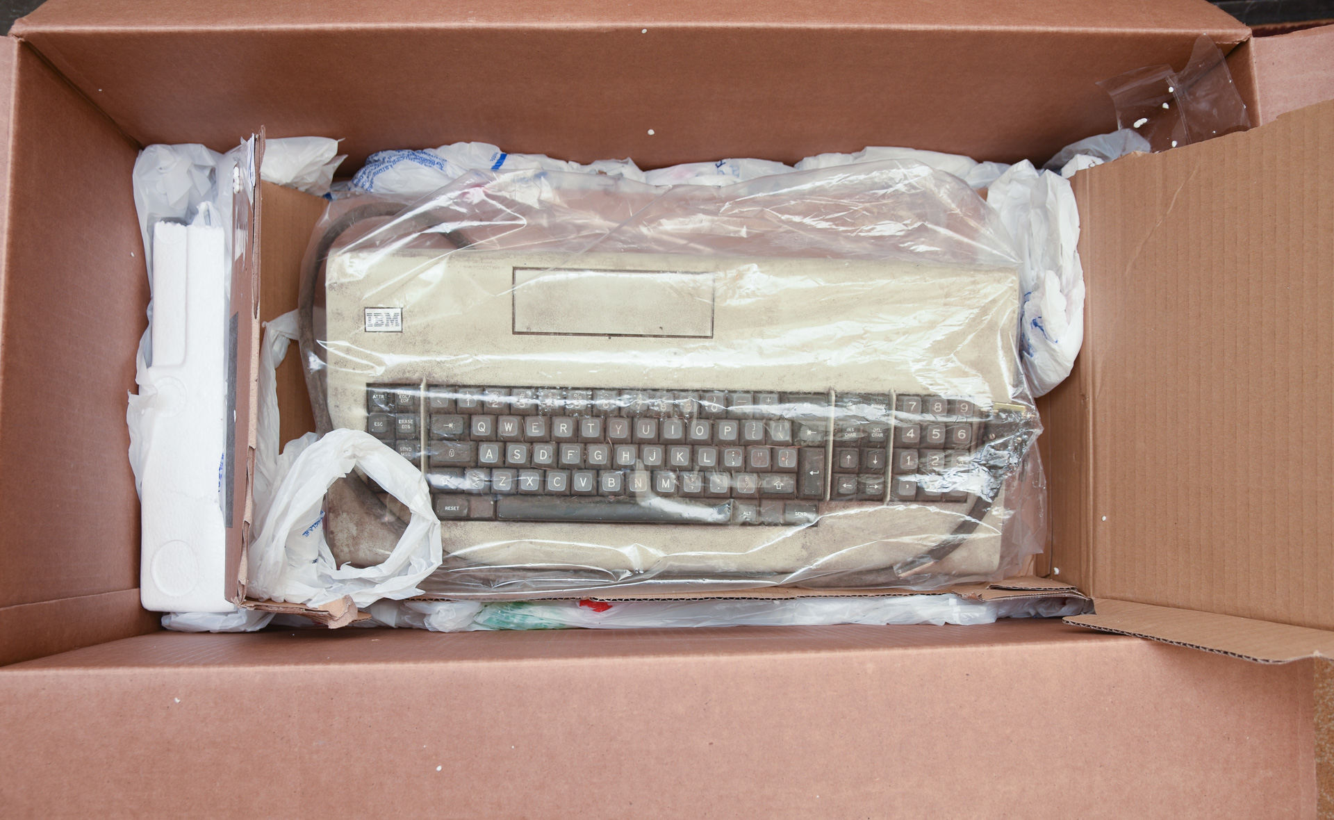

So, thanks to dzhoou, I got me a beamspring!
Advertised as a barn find, it turns out it was an accurate description!
After a couple of weeks in transit, it arrived in perfect packaging, in a huge box with styrofoam and stuff.

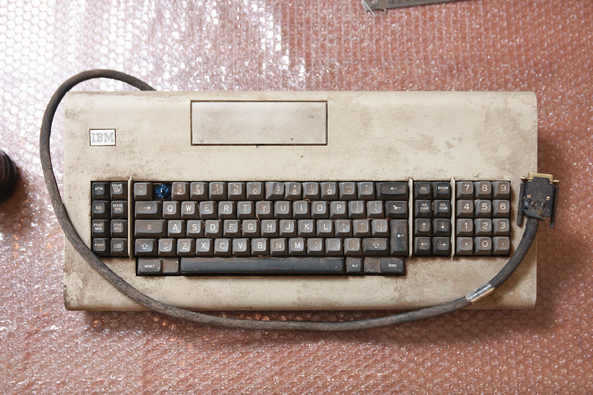

I got it out and had a look...and immediately decided to start cleaning it...It was rather nasty, so some pics are going under spoiler tags for the sake of any squirmish reader among us!

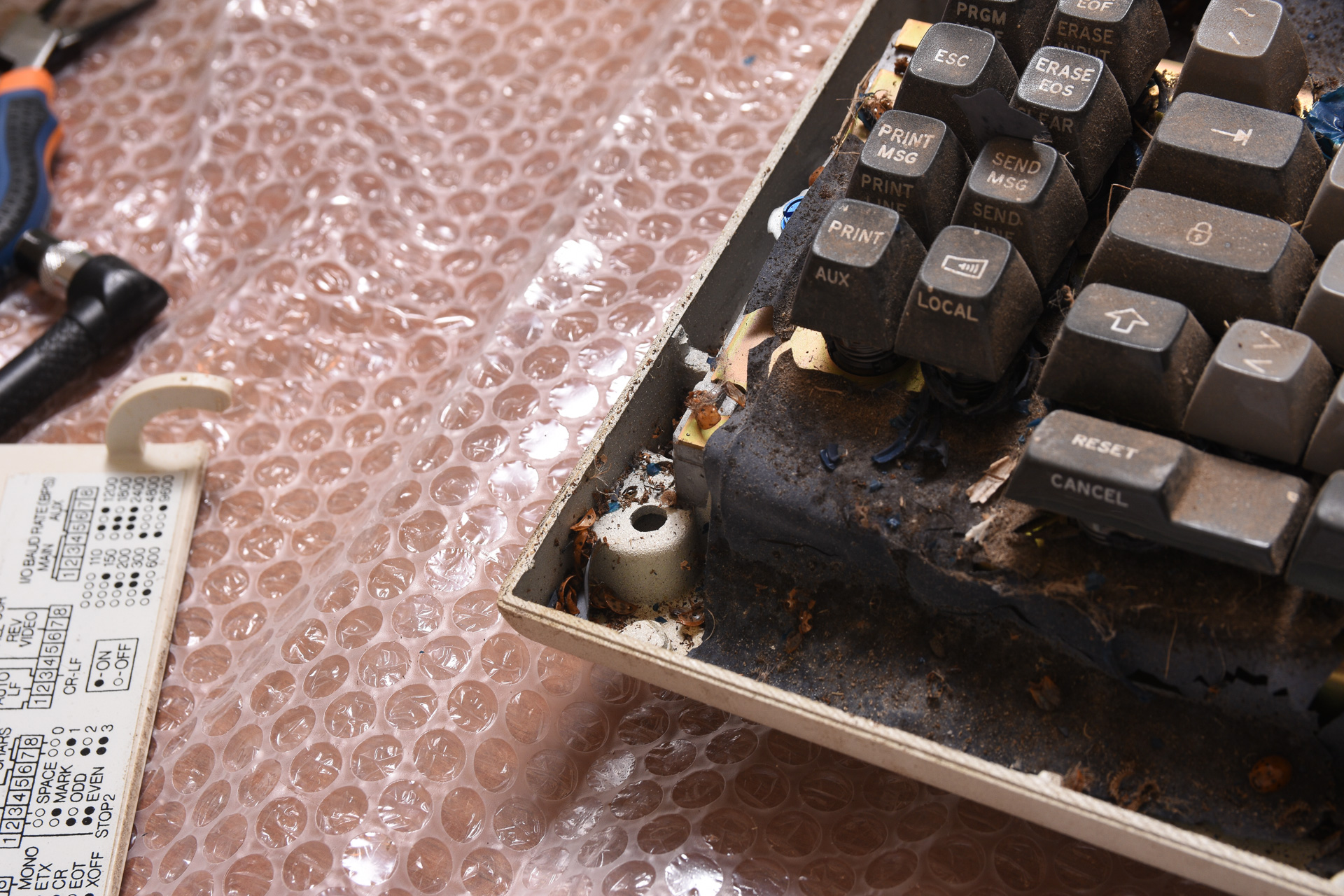

Quite a bit of dirt on there, all caps are present, although 7,8 and 9 had bent stems.

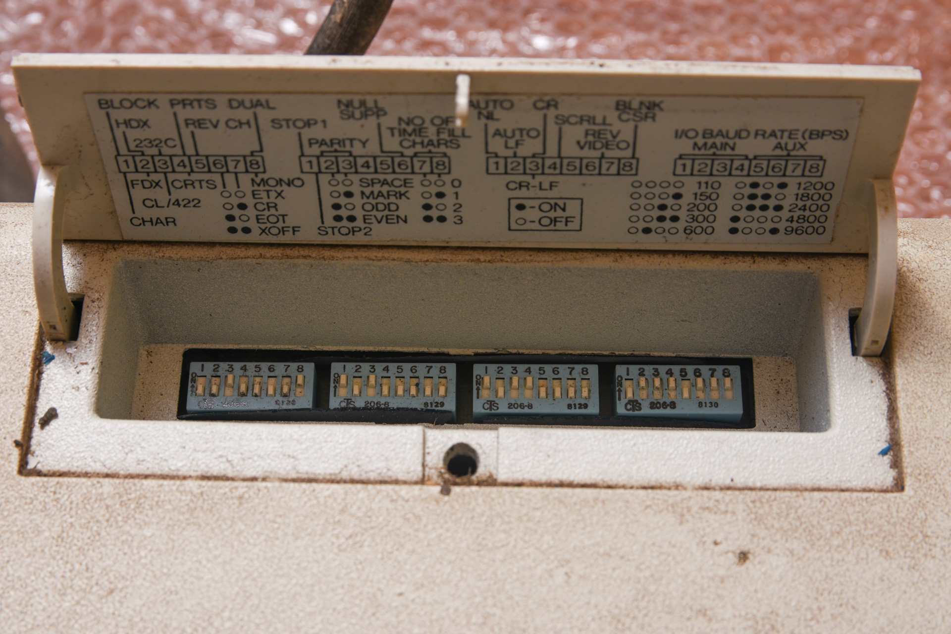

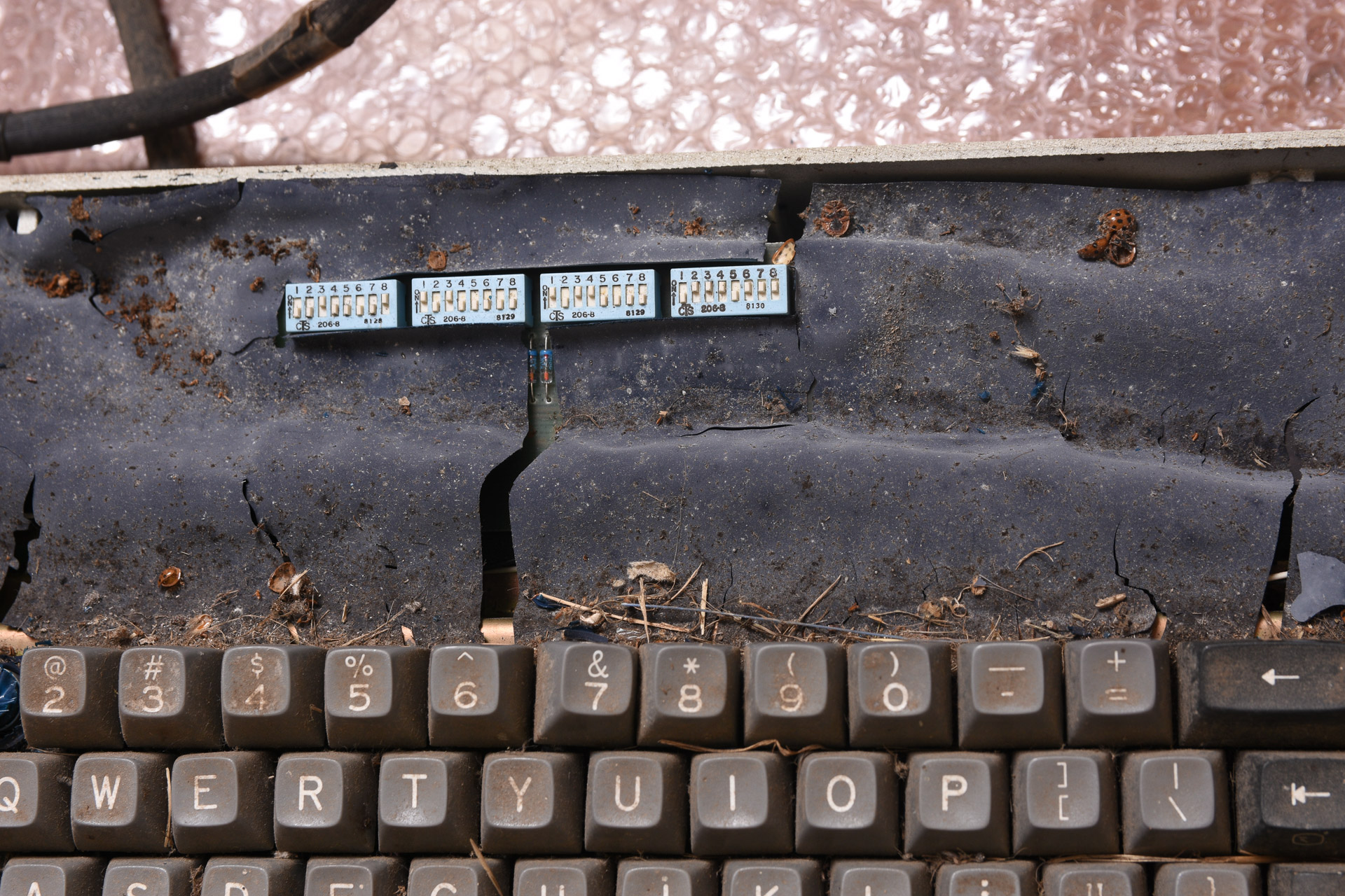

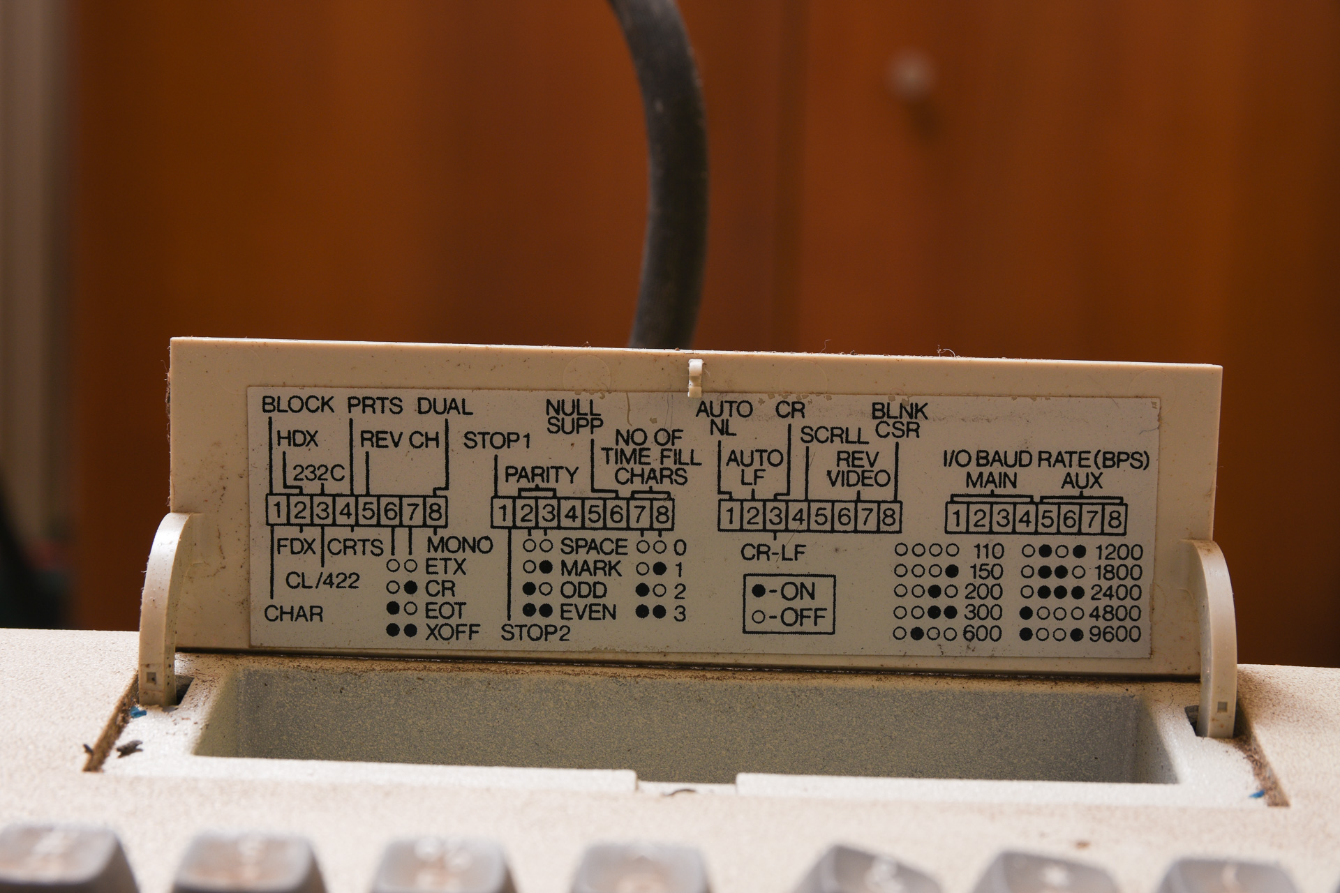

This one is for Halvar: The secret compartment!
Nothing too secret of course,just DIP switches!
And instructions

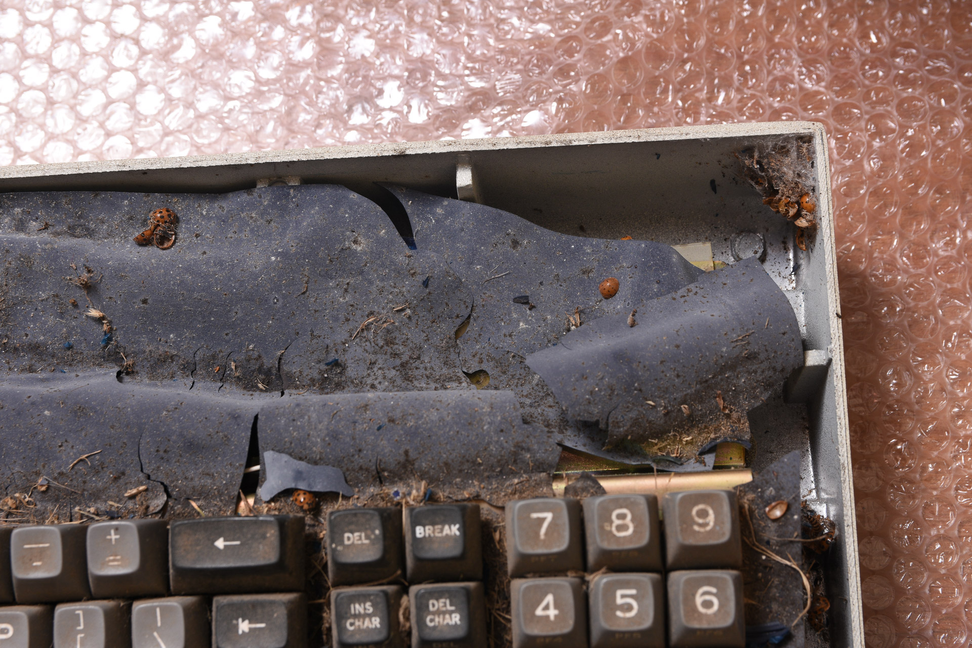

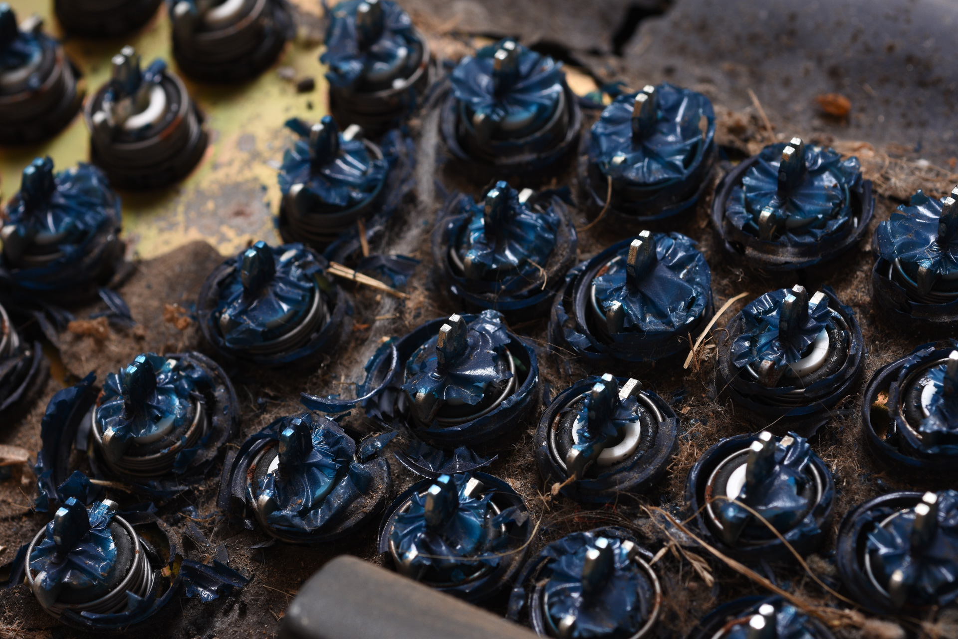

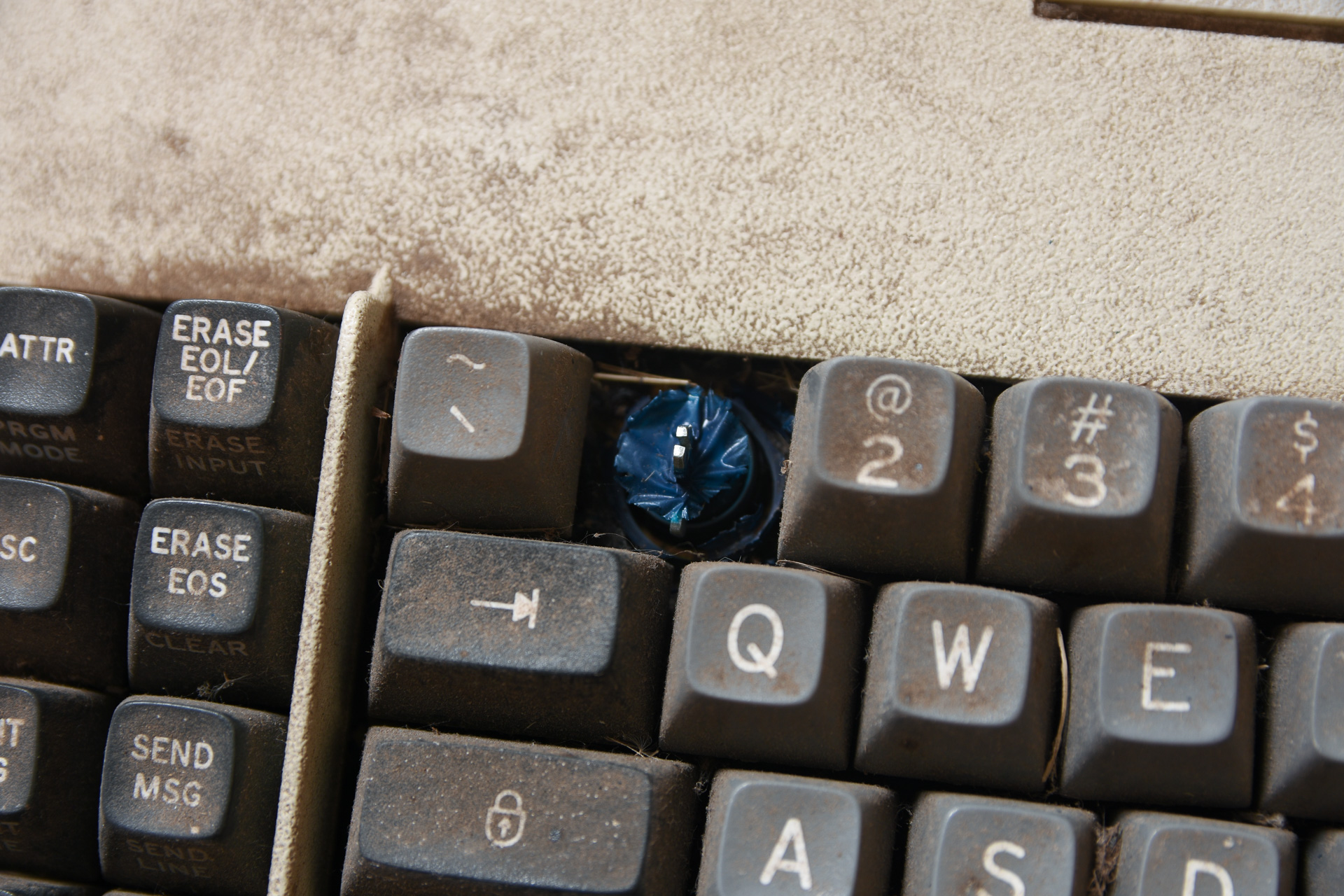

I pulled a cap, and the contamination shield has disintegrated completely.

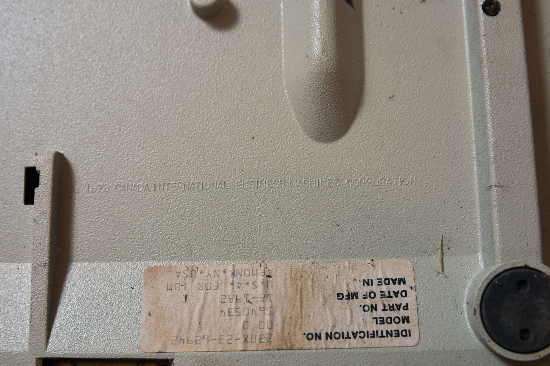

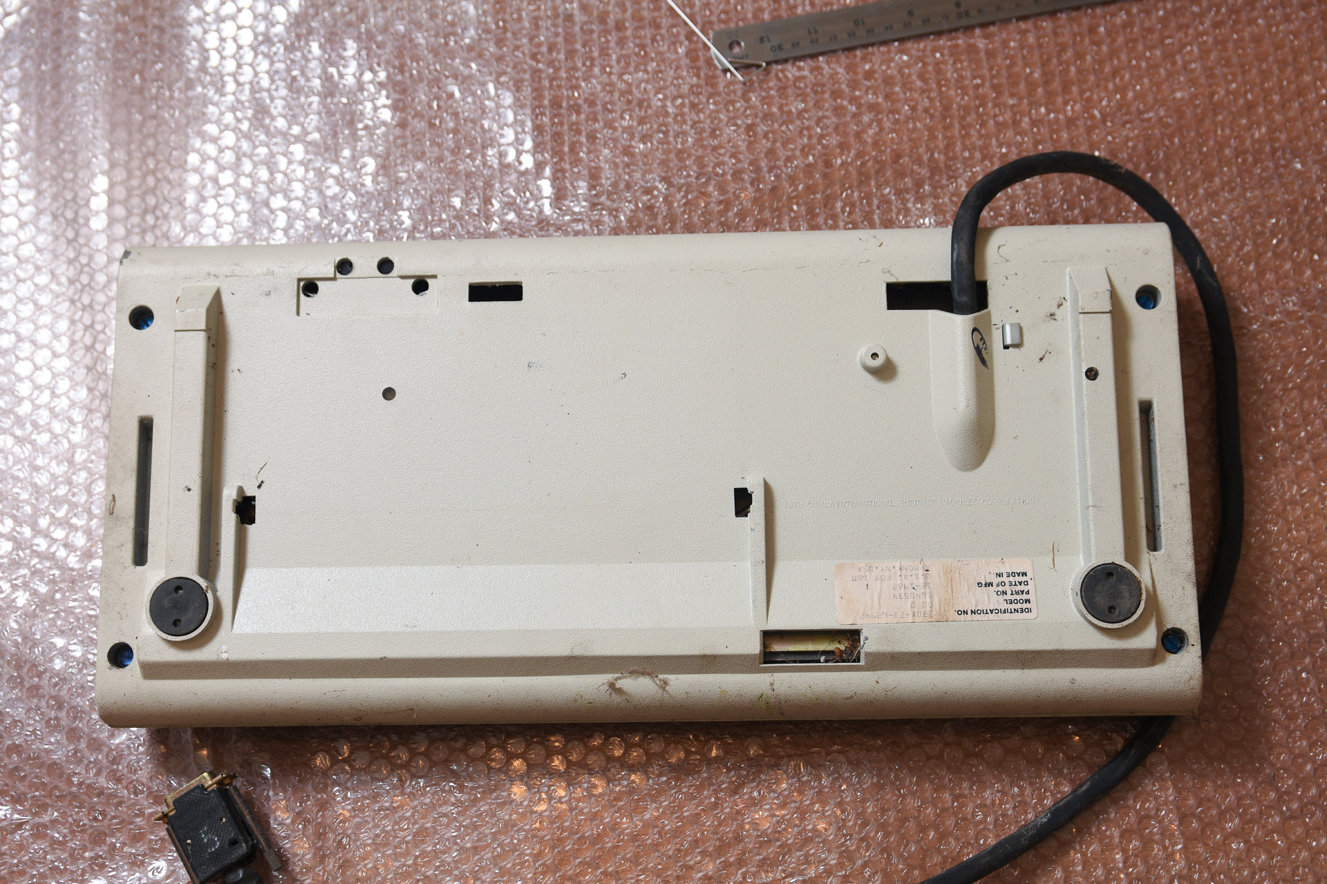

The back of the beast, unfortuntely the manual and cover are missing.

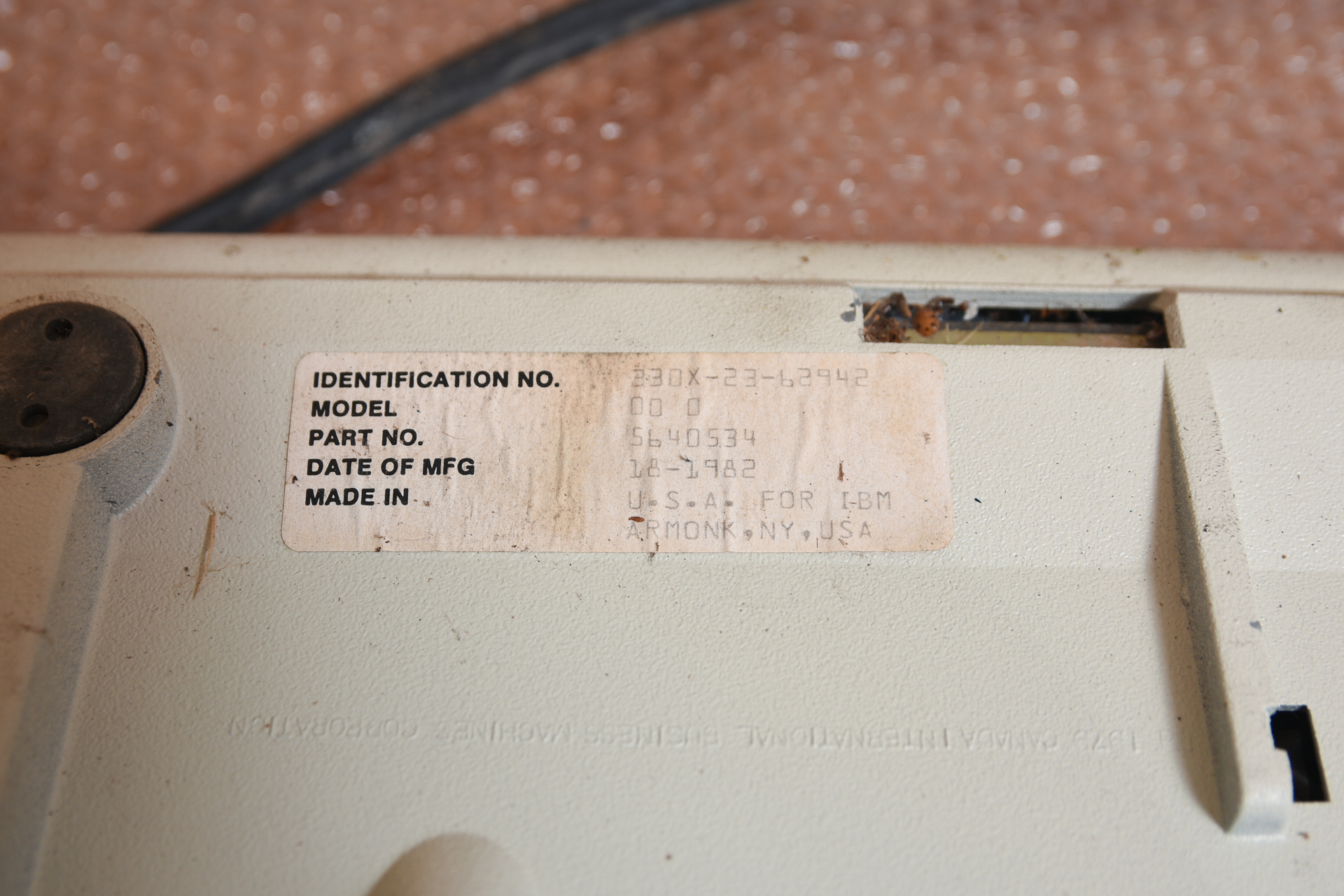

1979 CANADA INTERNATIONAL BUSINESS MACHINES CORPORATION
The label, born on the 18th week of 1982. The first keyboard I own that's older than me.

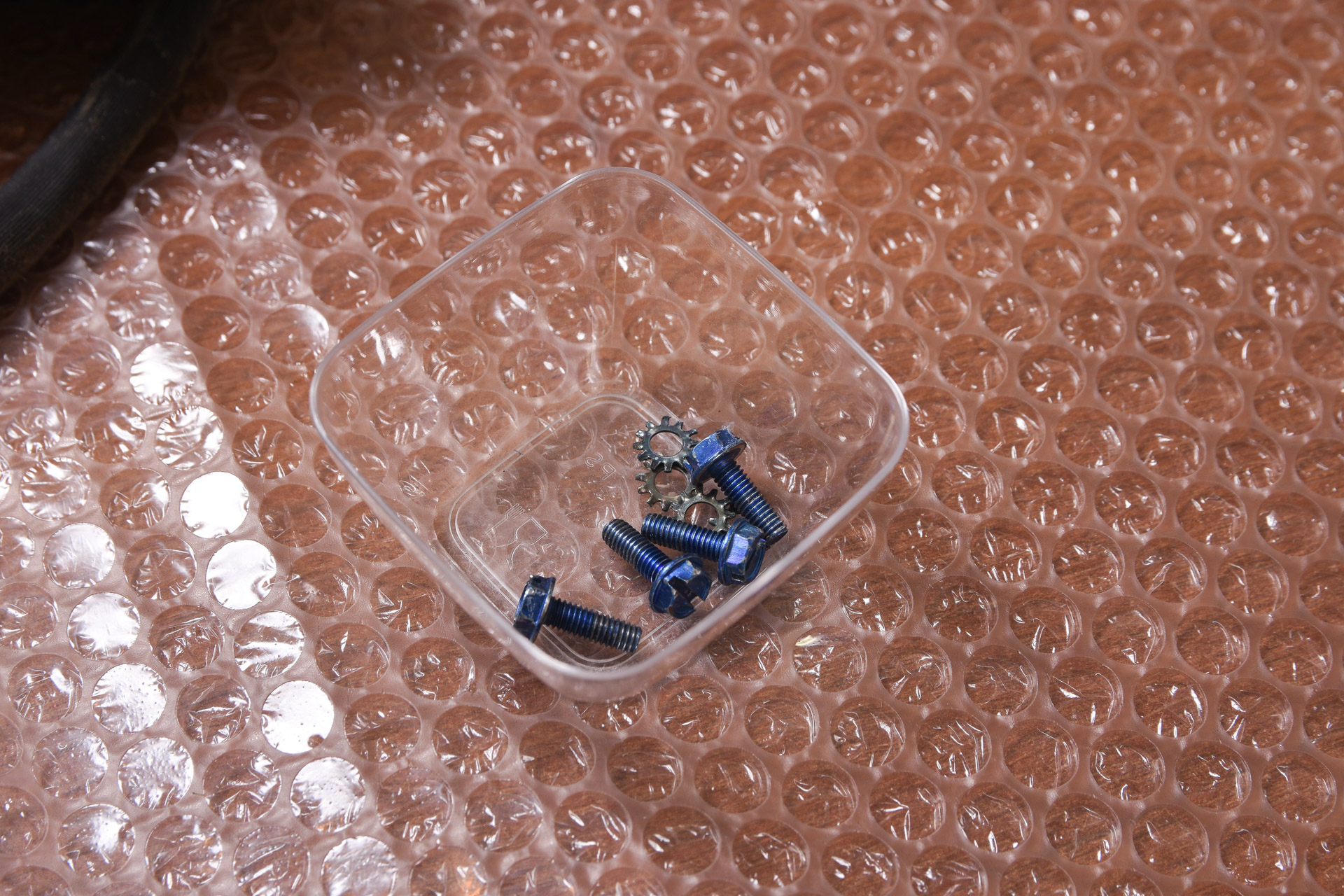

Blue screws with star lock washers!

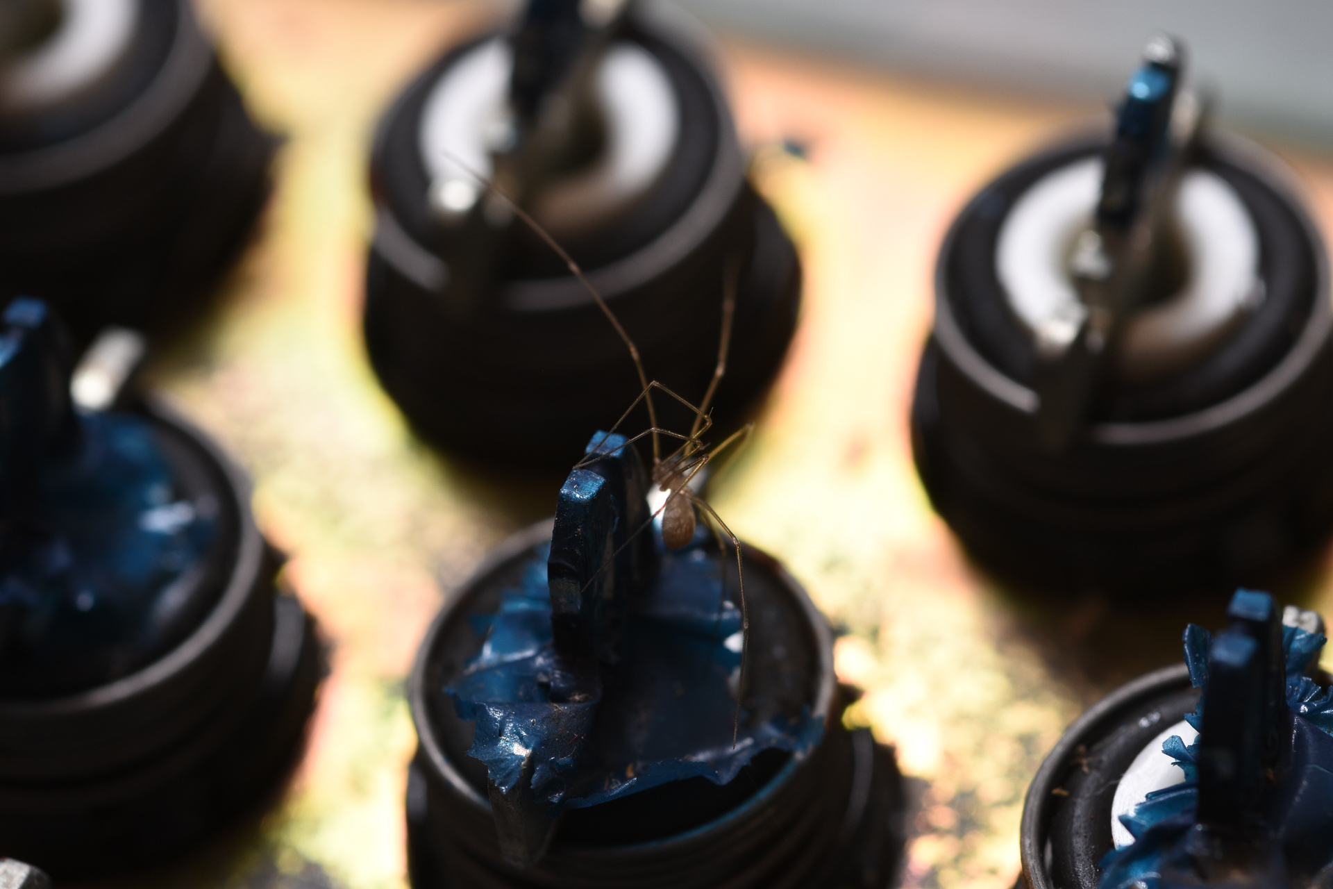

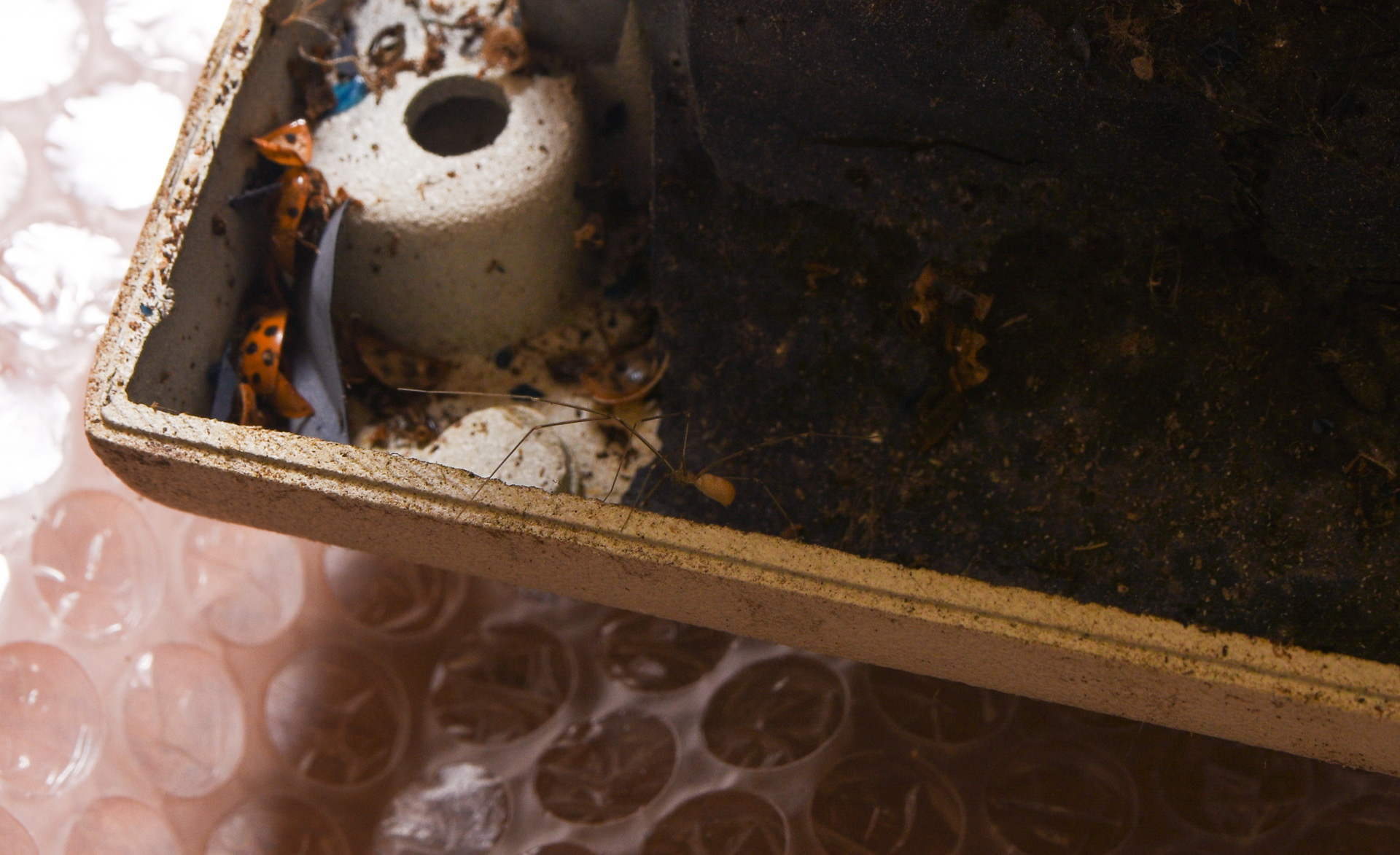

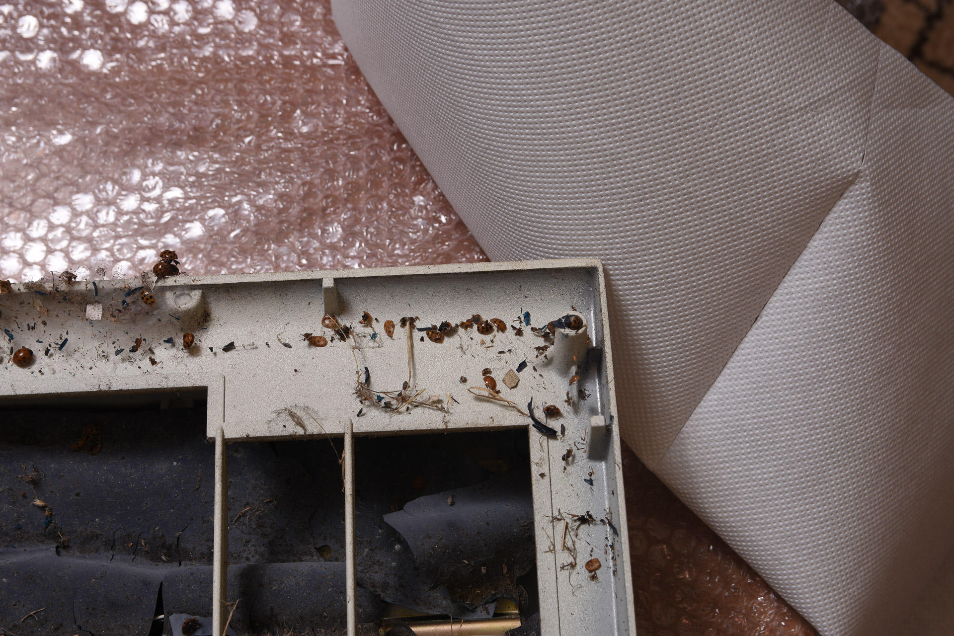

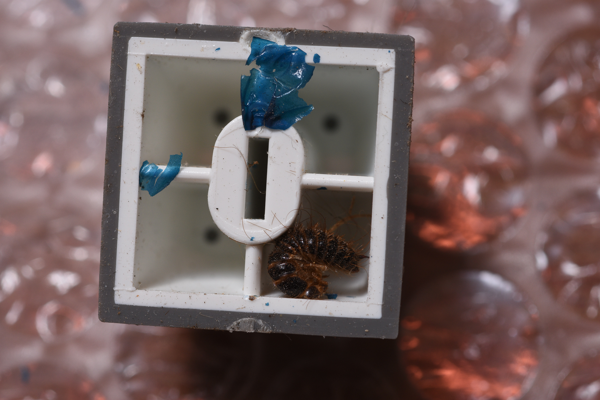

And I'm greeted by this little guy.
As soon as I snap the pic he rushes somewhere inside, only to be found again later!

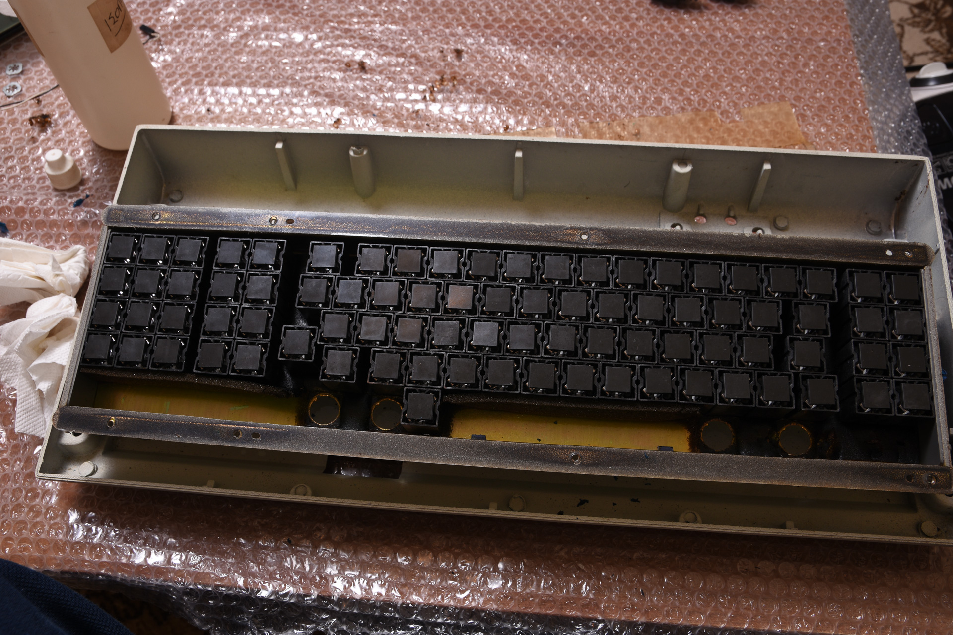

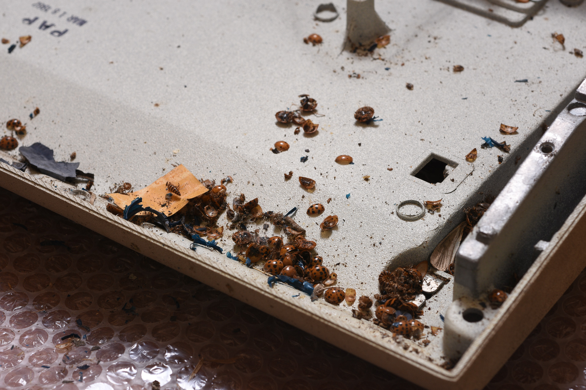

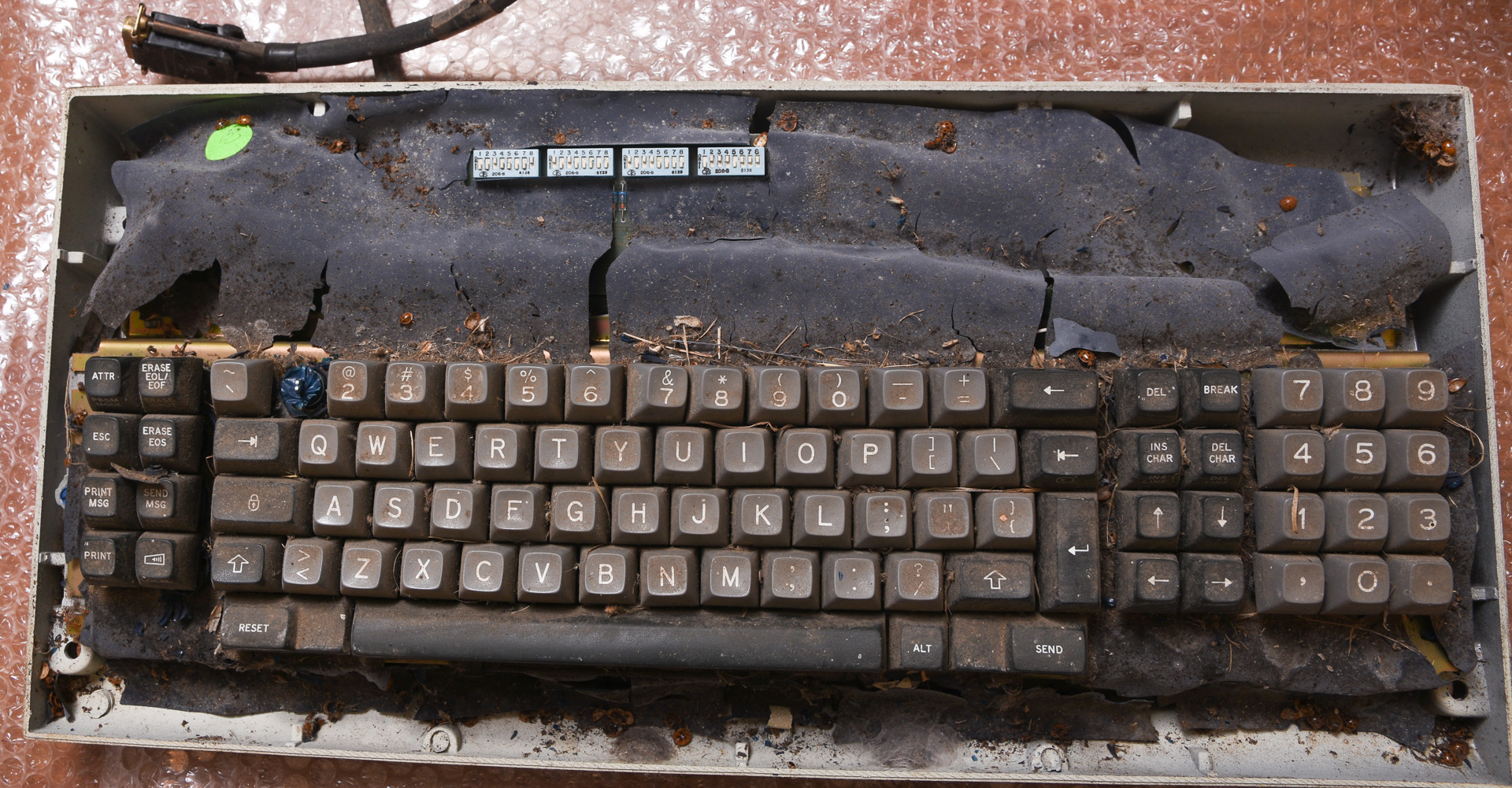

This is what I'm dealing with...
Nastiness alert:
To be continued...

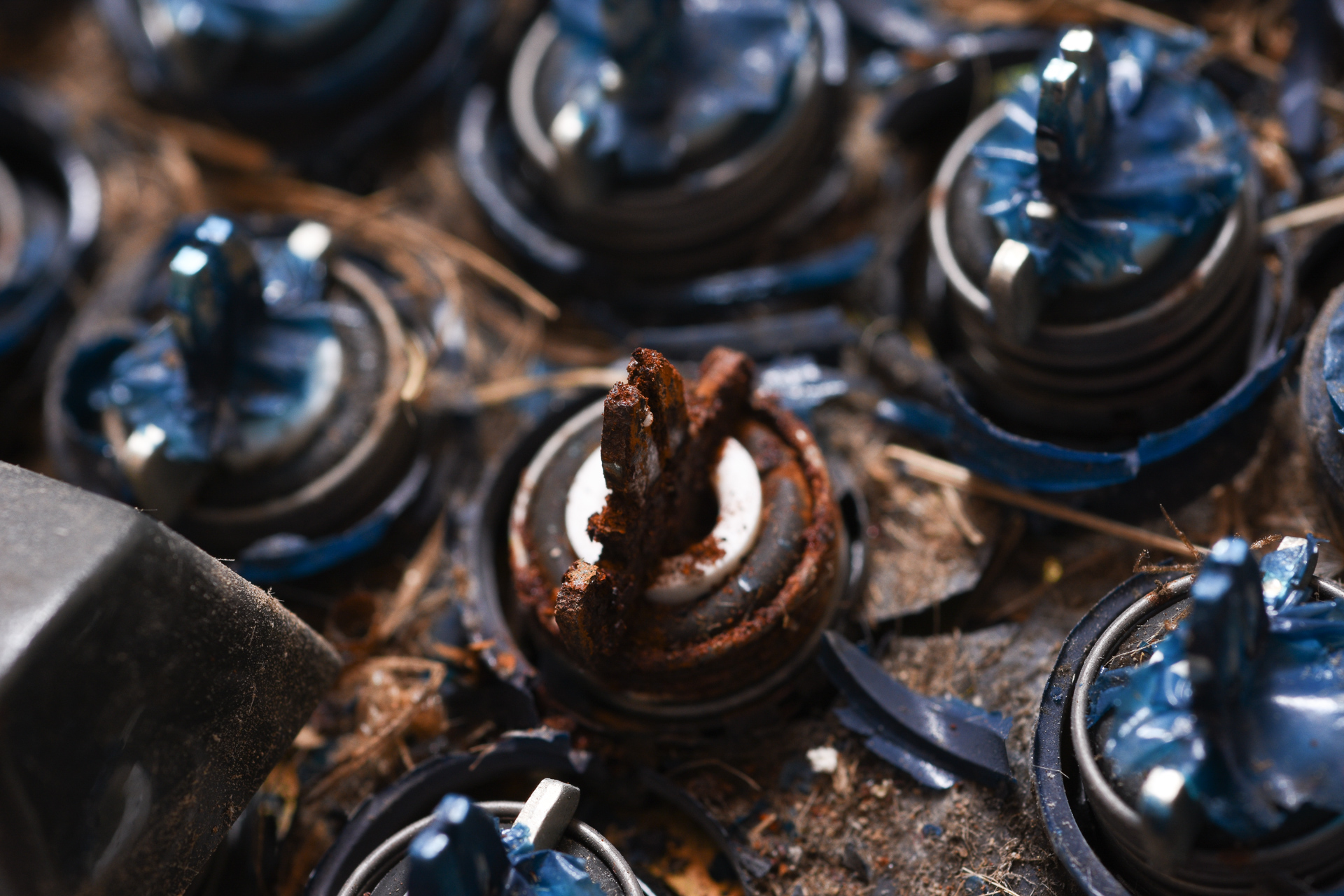

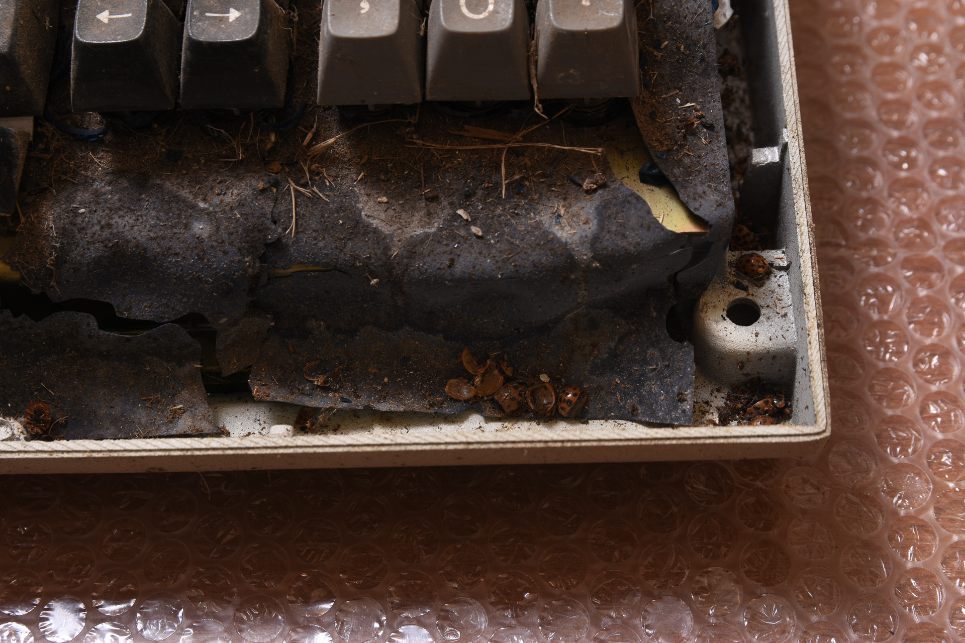

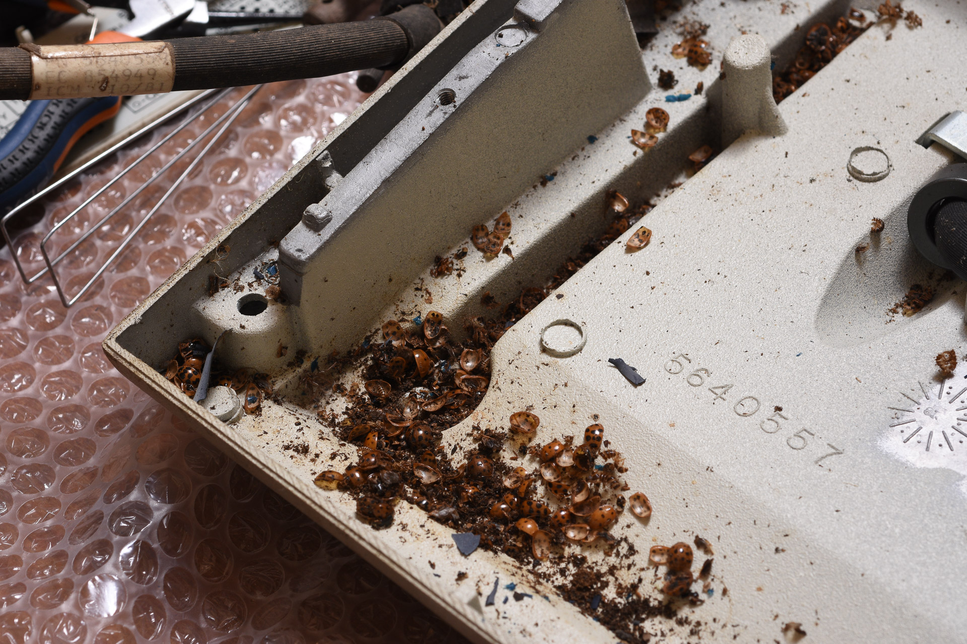

Nastiness continues:
Only one rusted switch,
So much contamination, so little shield...

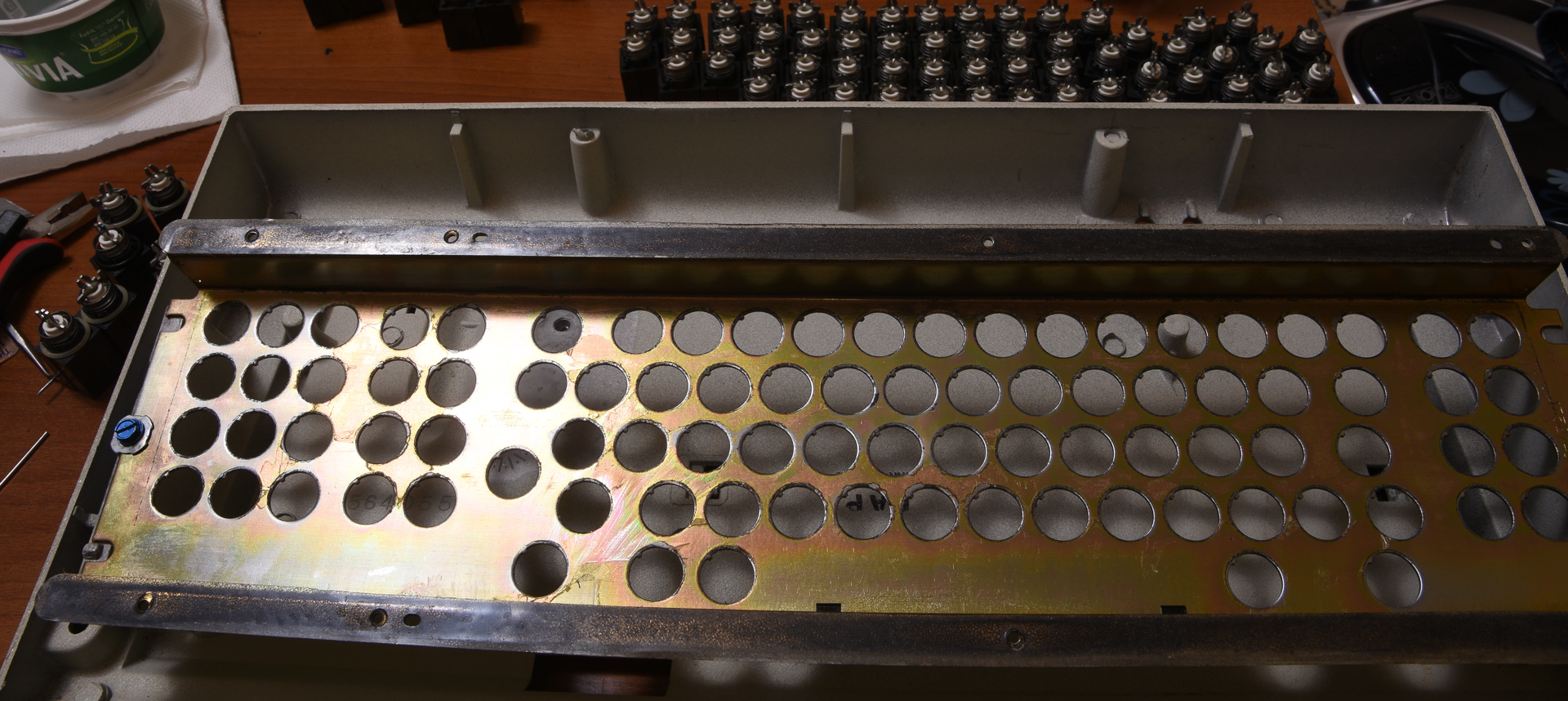

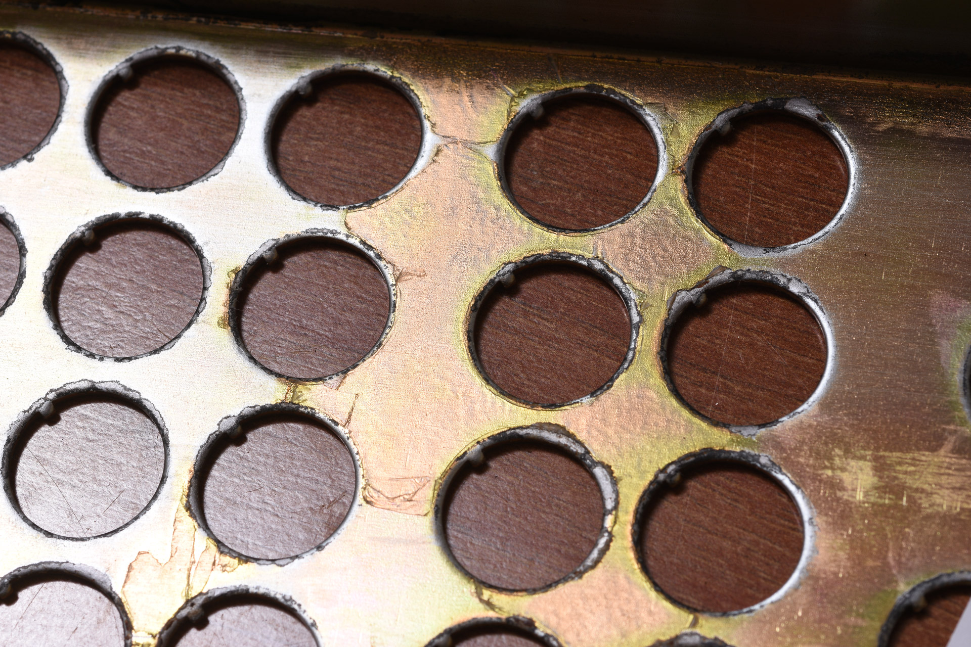

Shield pulled off, the plate has some corrosion, but nothing too bad.

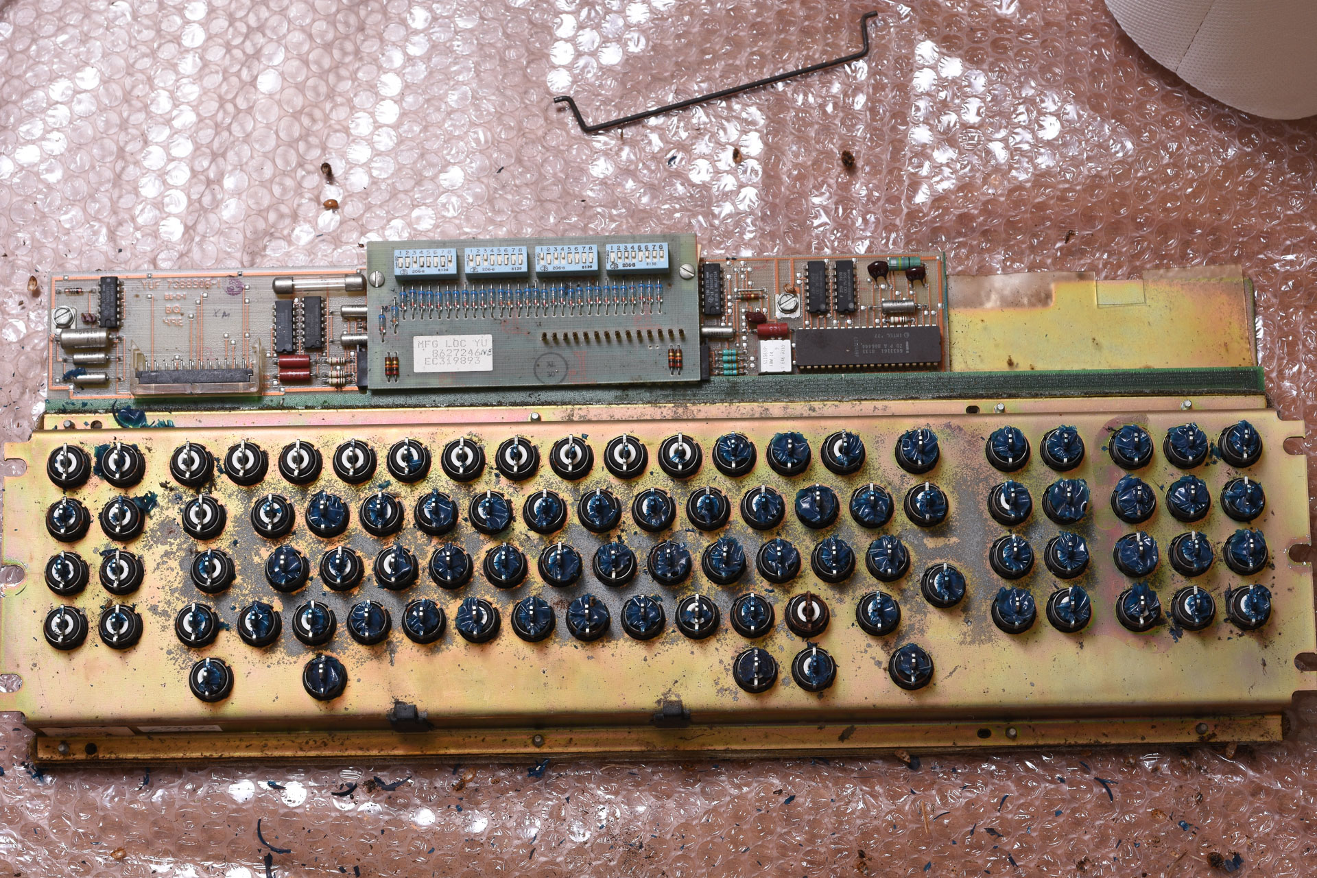

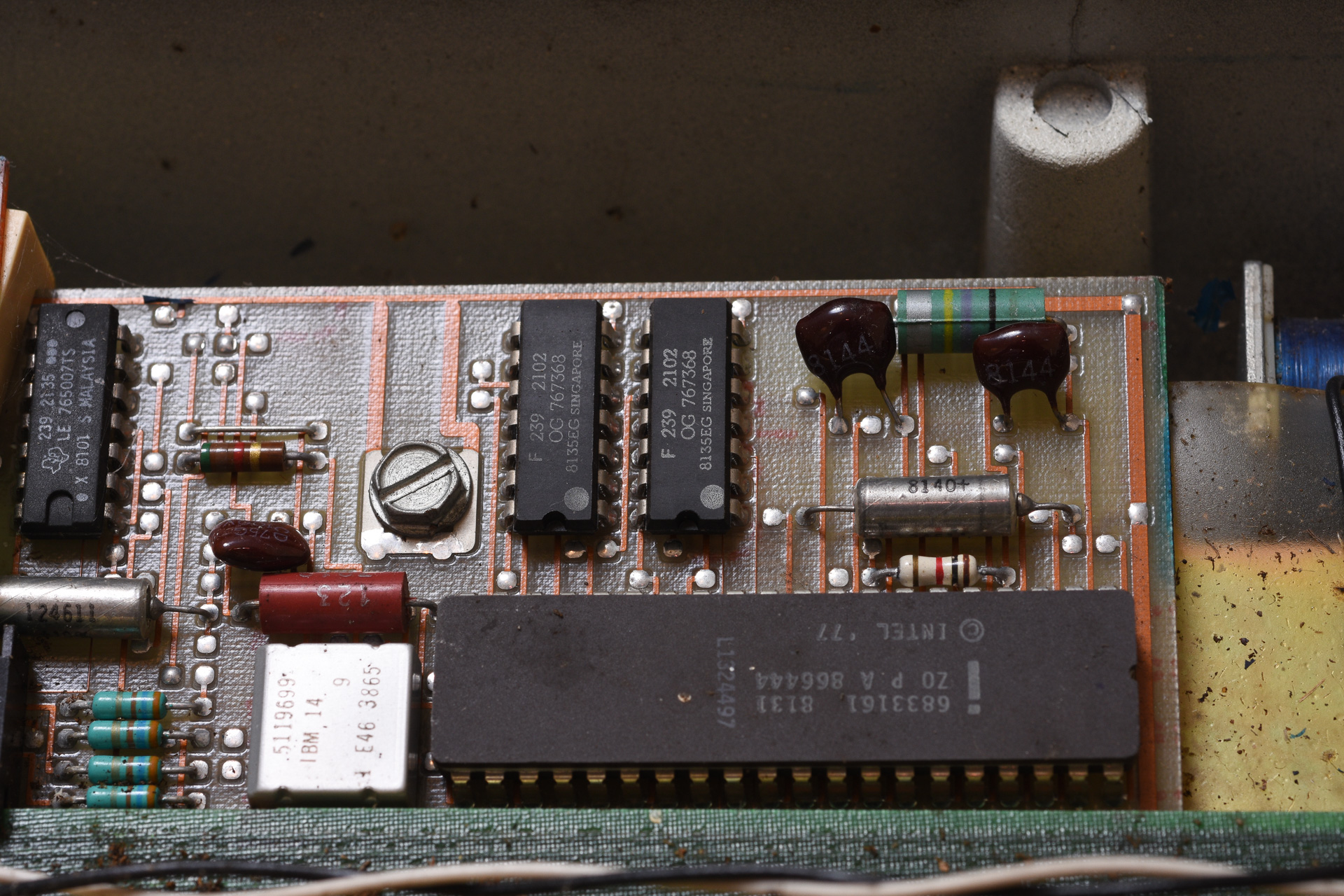

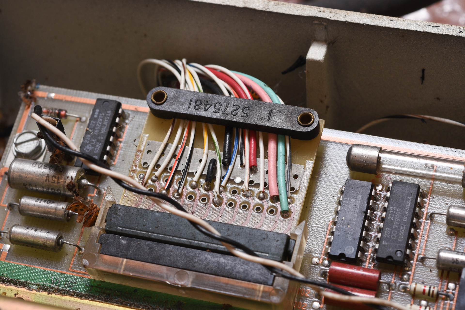

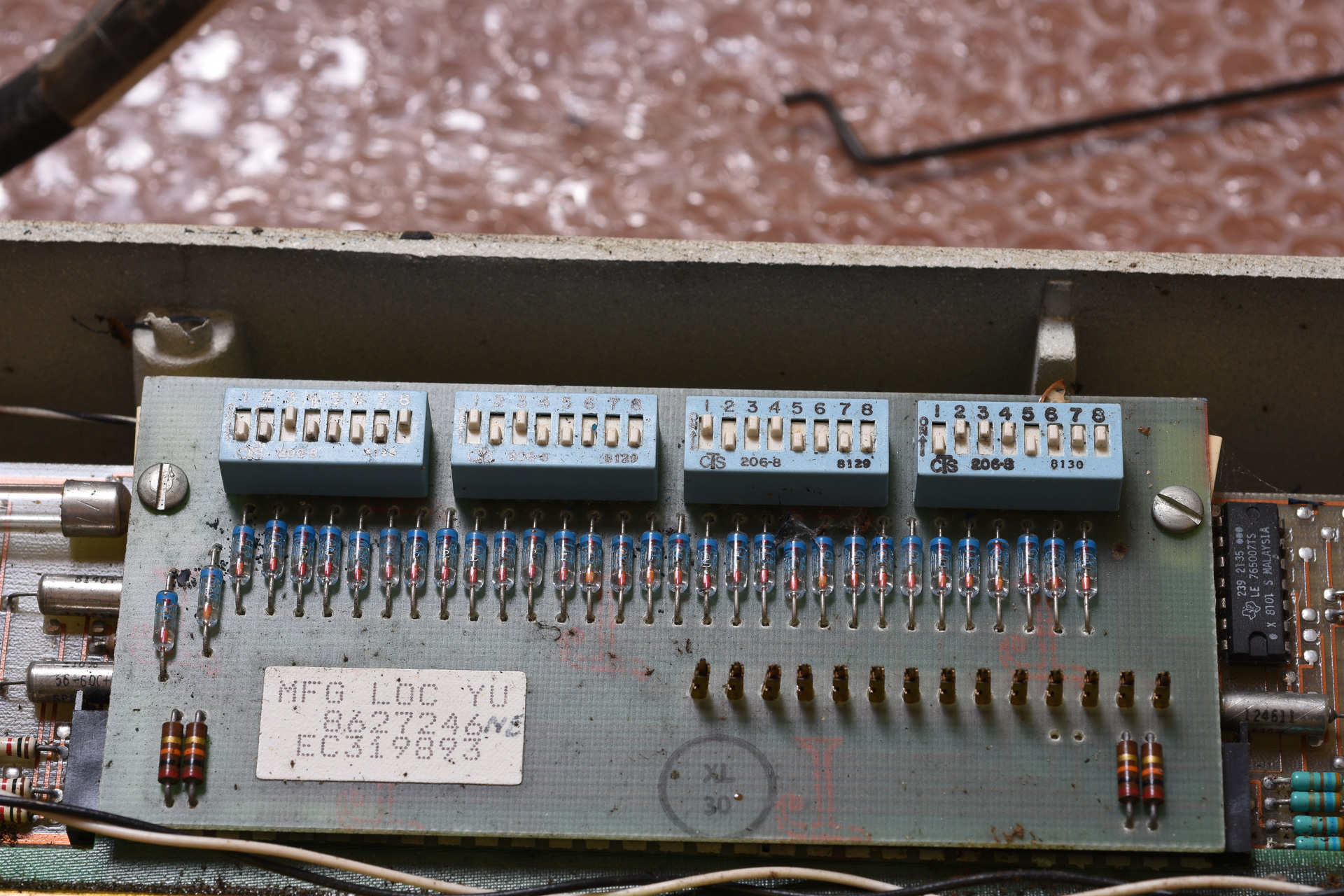

The controller board

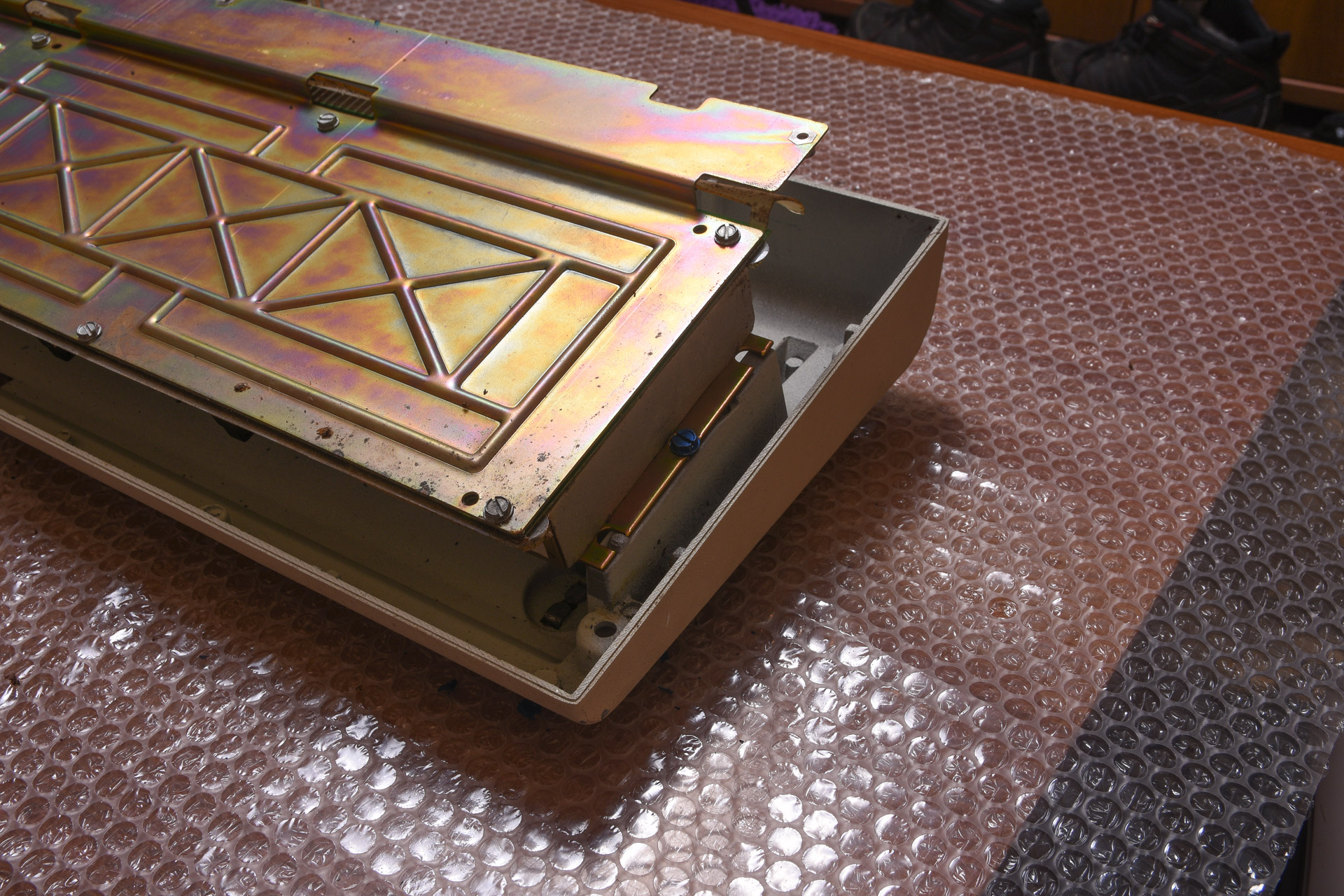

Lift the switch assembly and oh, the horror...

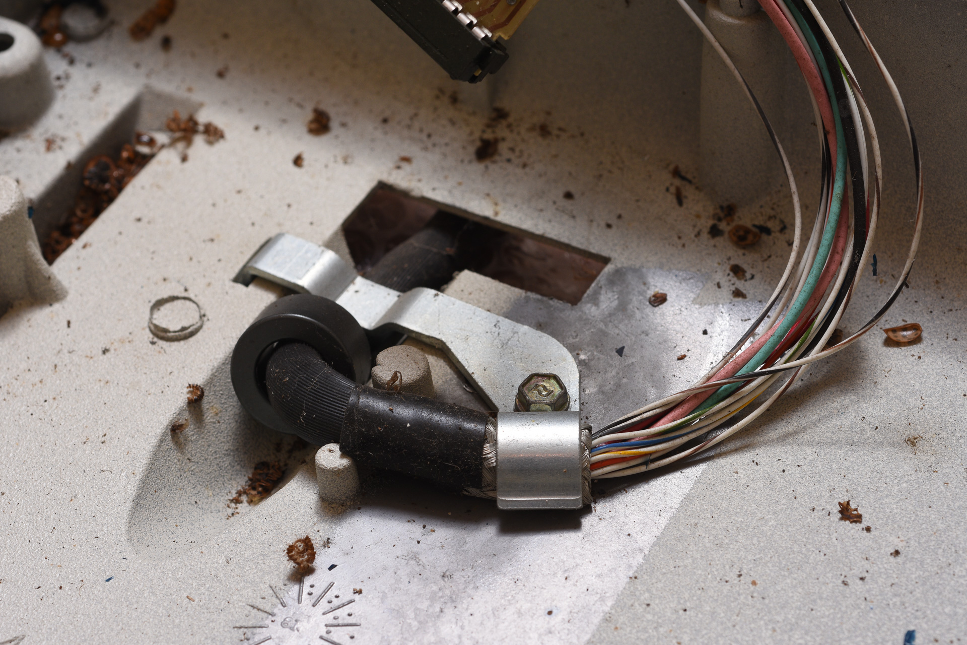

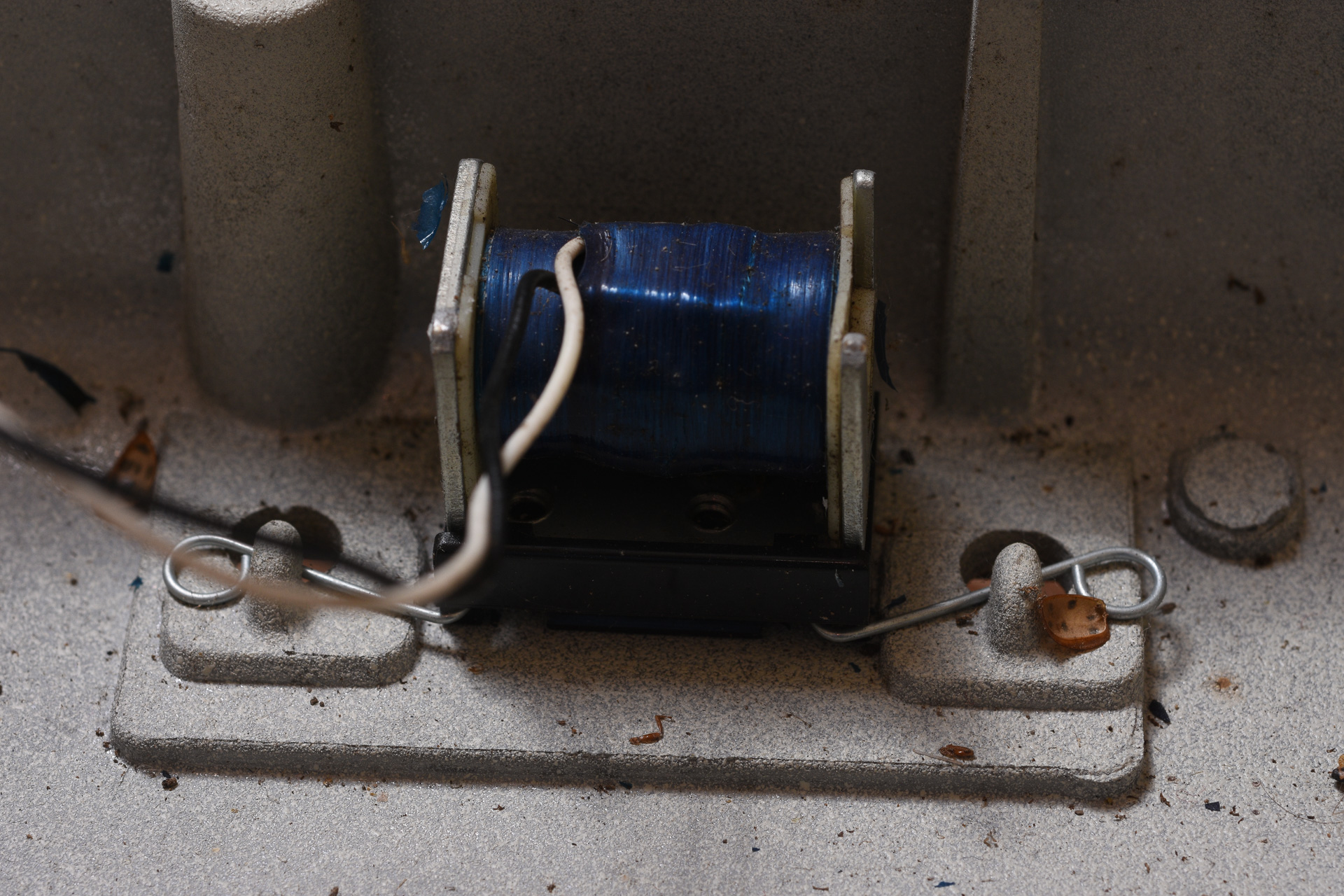

The solenoid and cable entry
Spidey again...Getting a good macro shot of a spider running for it's life is damn hard...
Switch sandwich removed and mounted upside down for safe opening

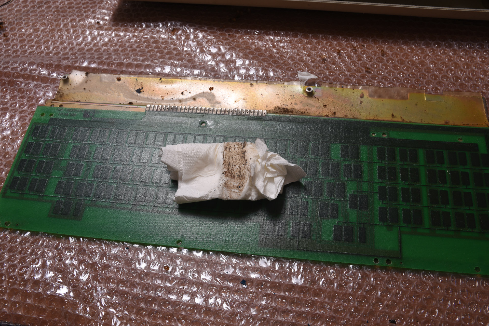

The pad card had a ton of crud on it. IPA to the rescue.

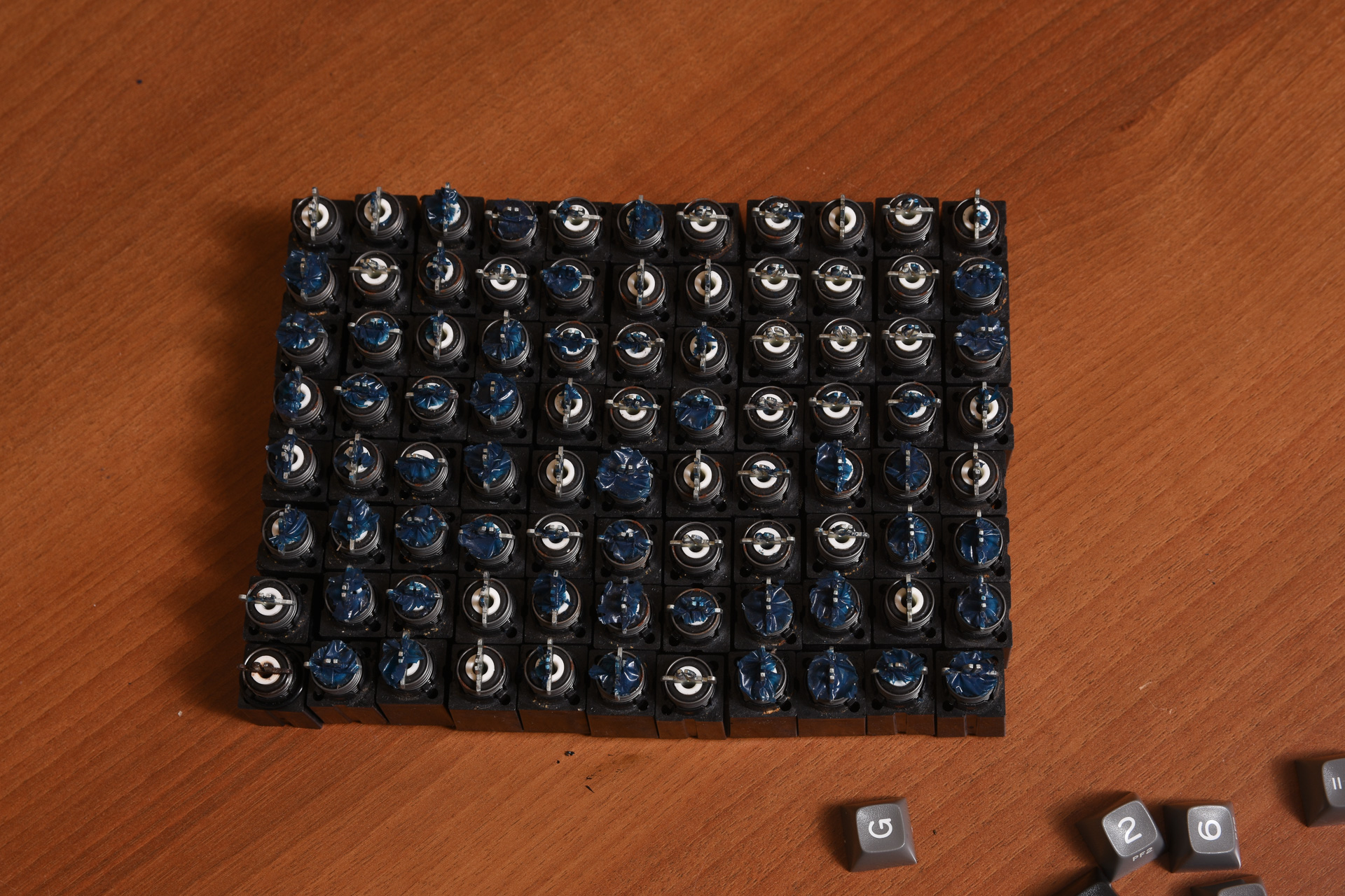

All switches removed and lined up!

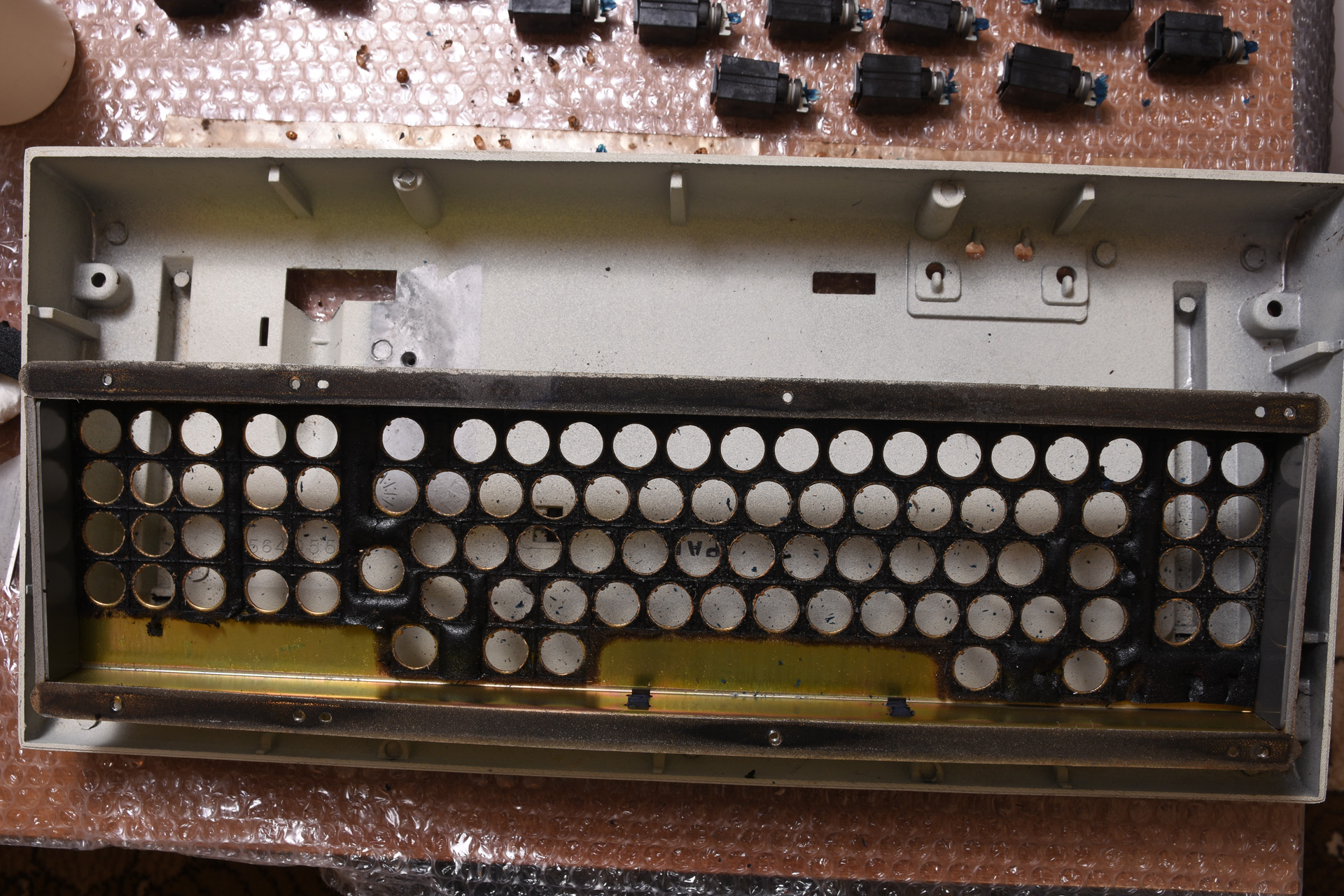

At this point everything got a bit messy, so I have no pics of the actual cleaning, but the case and the switch "cage" were washed and scrubed with a brush and hand soap.
I didn't go crazy on the case, as there is quite a bit of deep-embeded dirt, and it was already flaking in some spots.

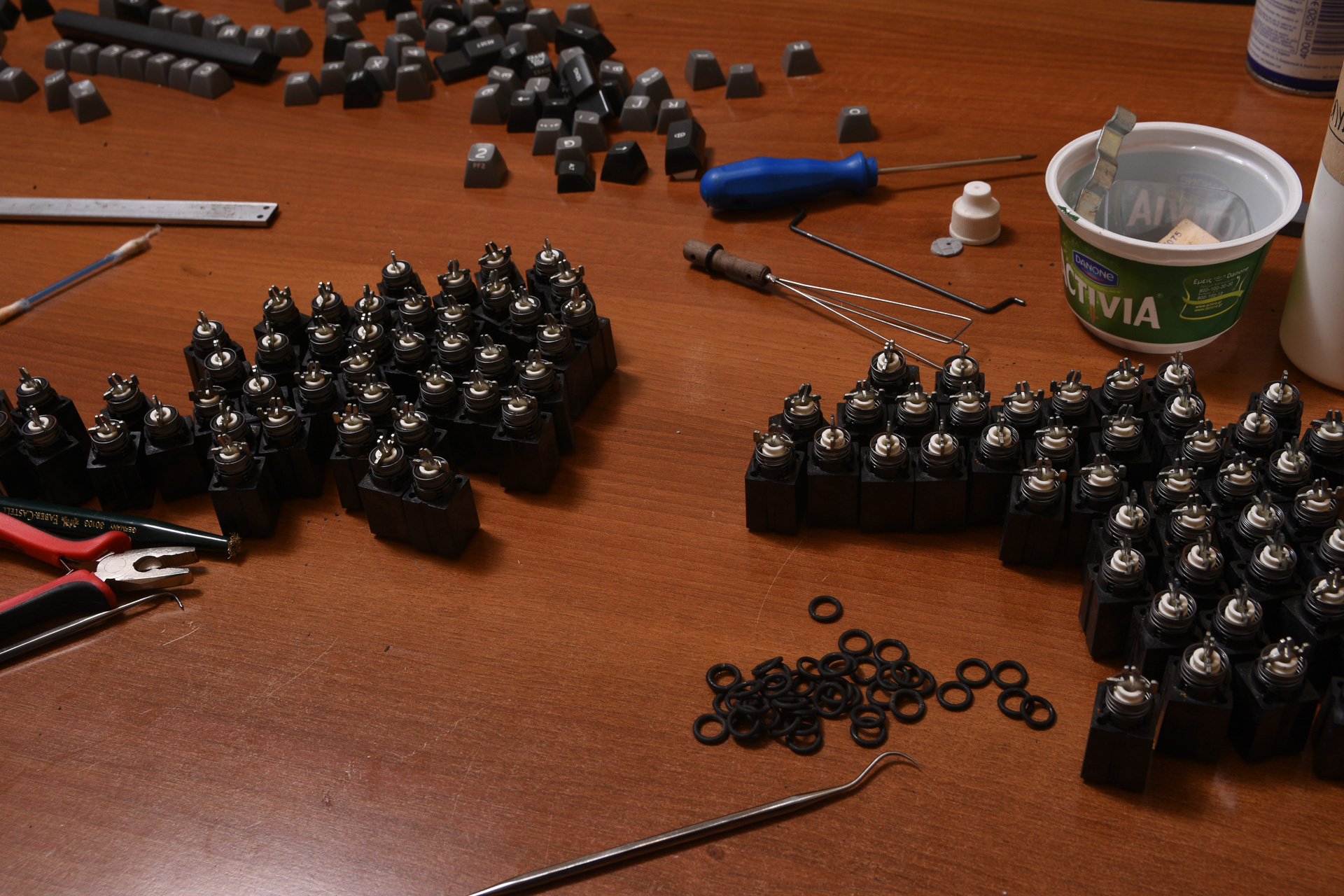

Meanwhile the caps got a good soak and cleaning with a toothbrush.

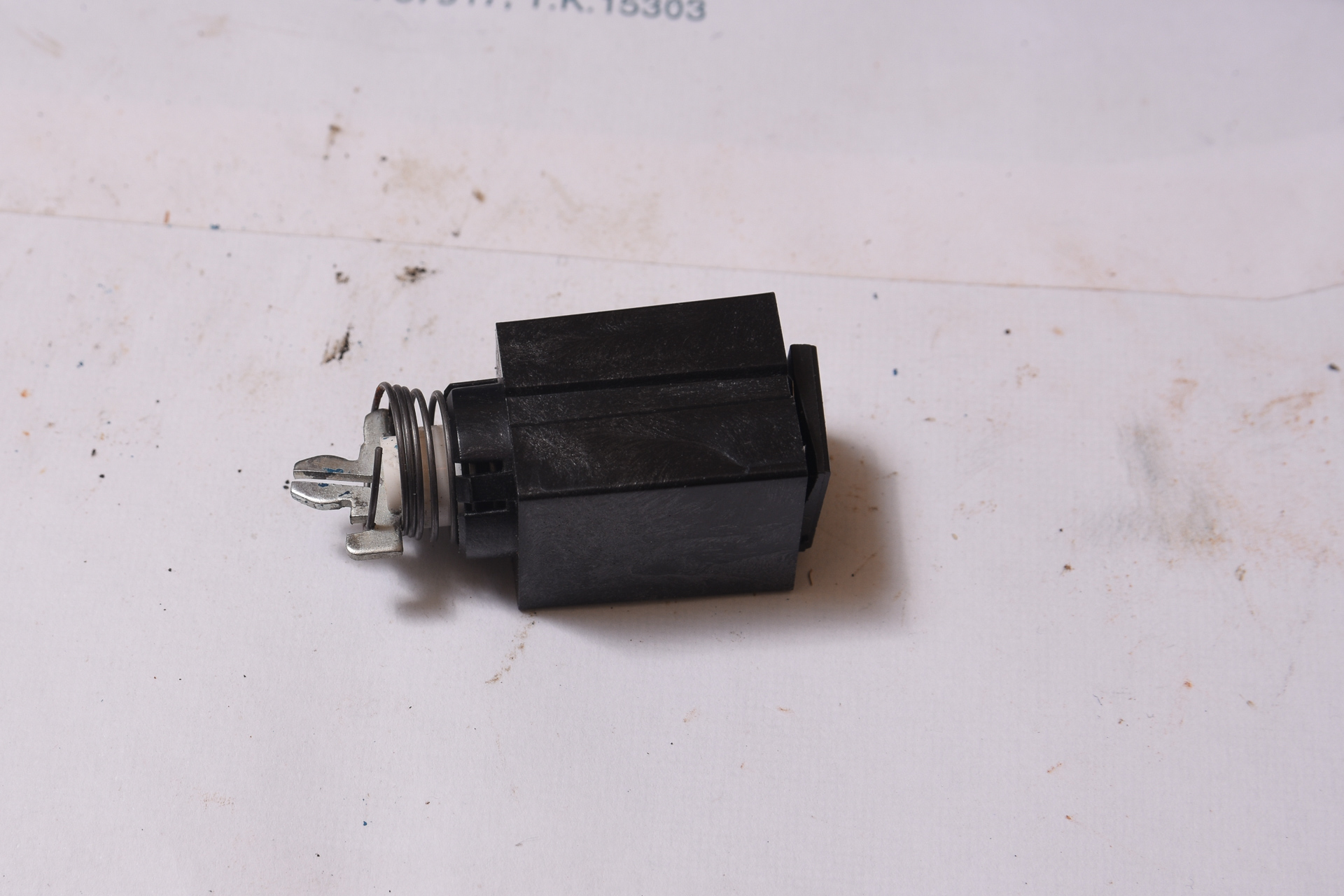

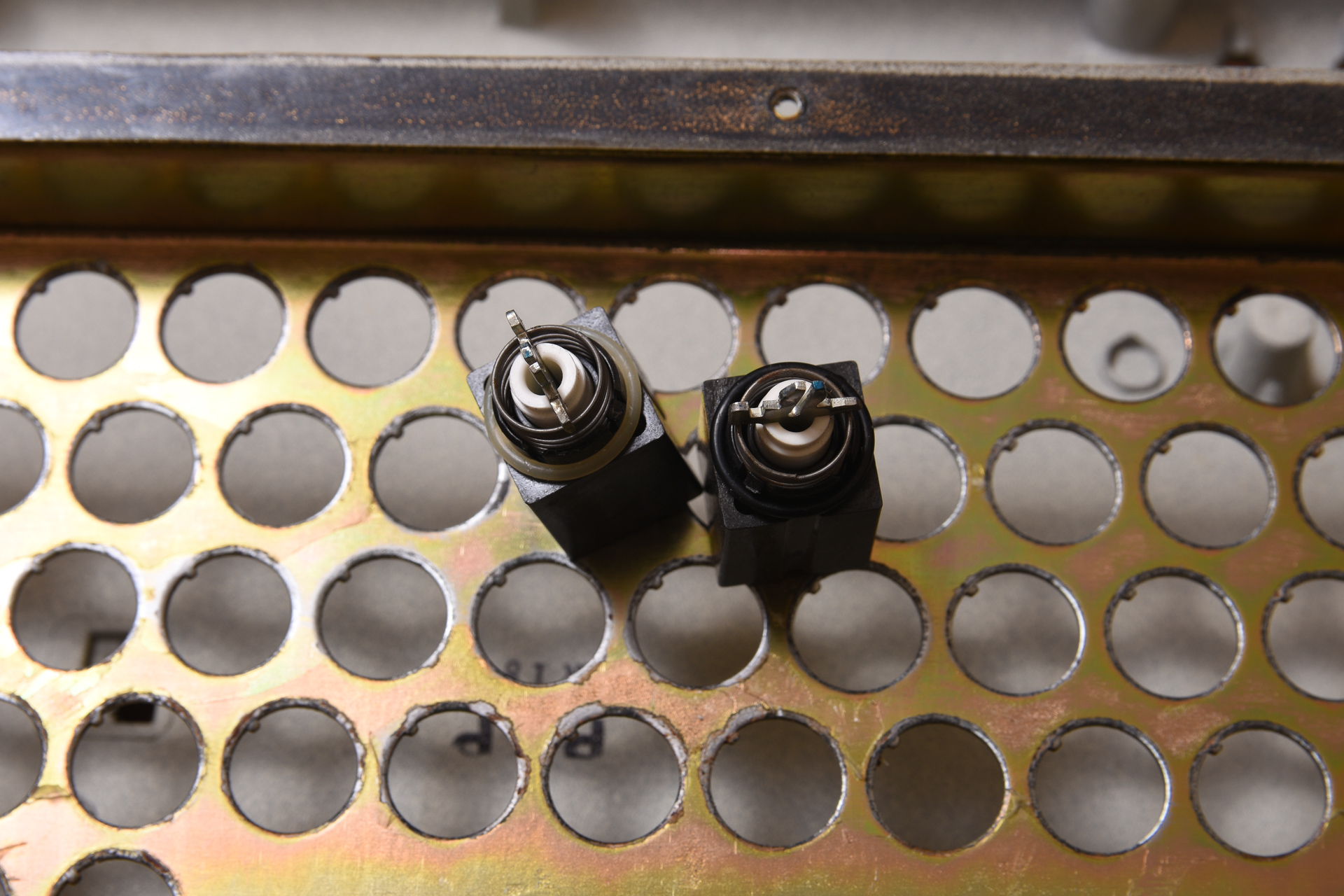

I removed the orings from the switches to clean and lubricate them.
Washed and soaked in just a bit of silicone oil.

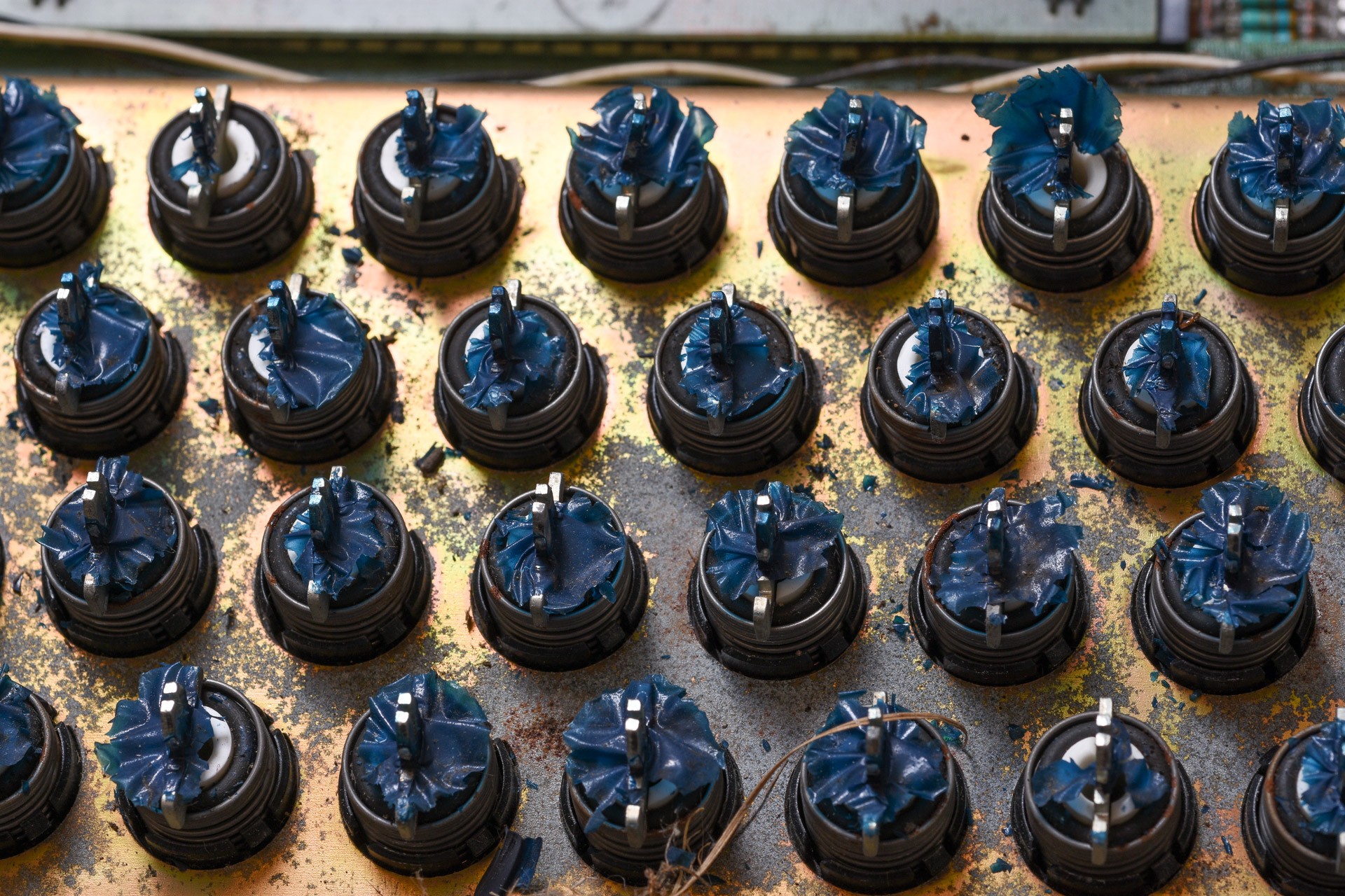

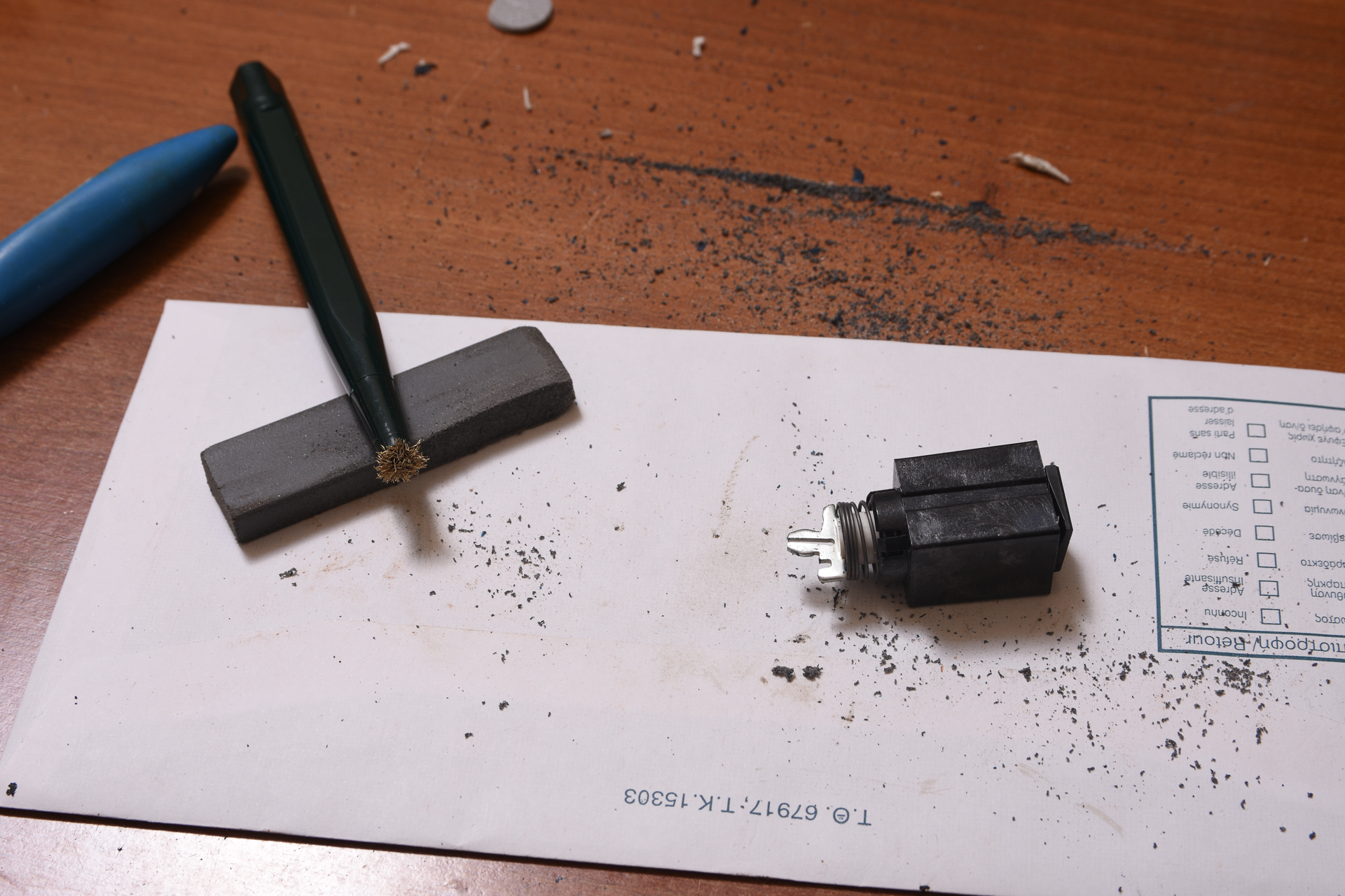

I cleaned the stems from the contamination shield remains with and eraser and a brass brush.

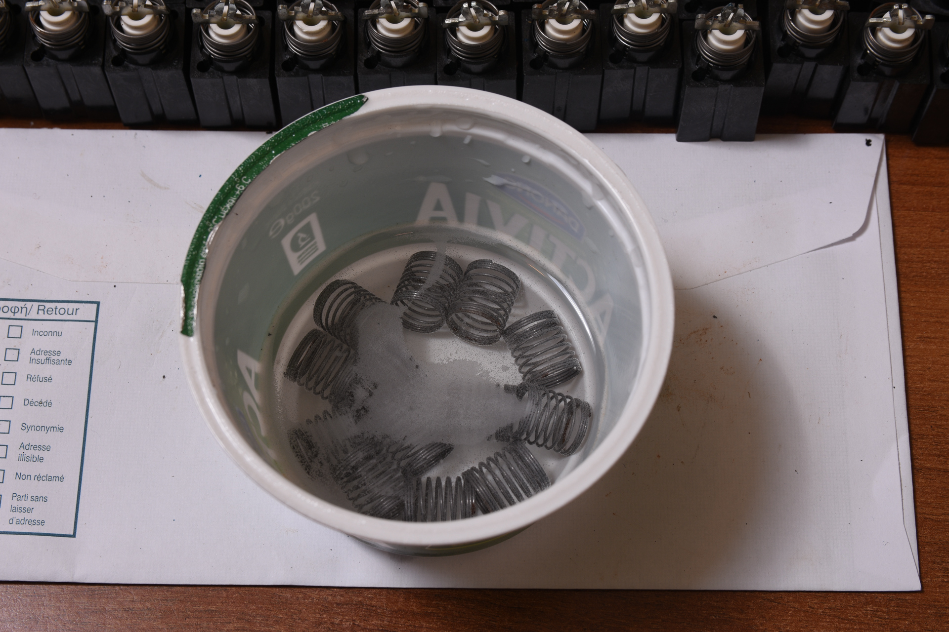

A few springs were a bit rusty, so in the rust converter they go.
You can easily remove them by "screwing" them off.

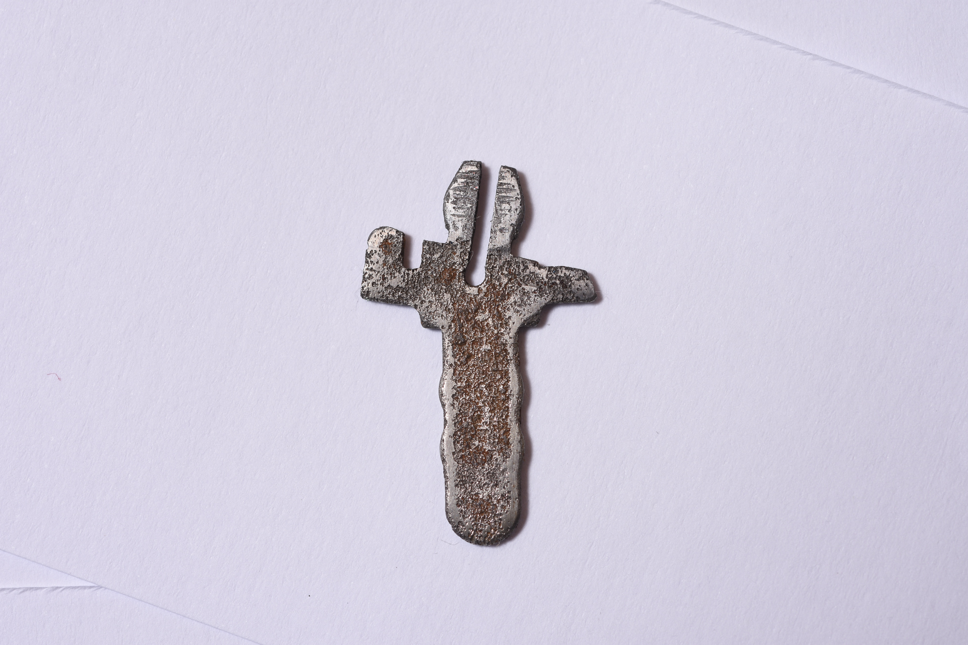

The rusty stem also got treated and it was quite pitted.
It was a bitch to remove, I tried WD40, silicone oil, pulling, cursing, everything. In the end a tiny bit of heating with a lighter made it release.
After this shot it got another tour in the cup of rust converter.
IBM's selection of foam was quite stupid. Even stupider than rivets on the M.
These are the glue backing remains of the foam layer.

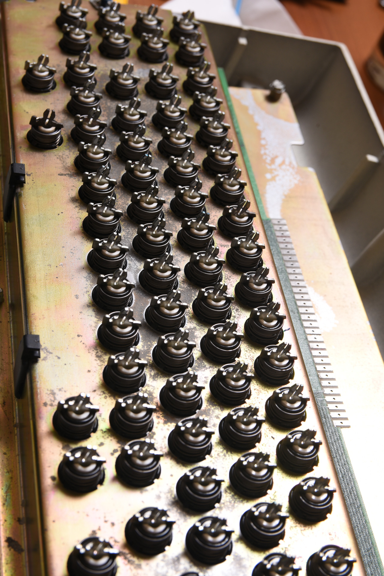

Plate remounted upsider down for switch placement.

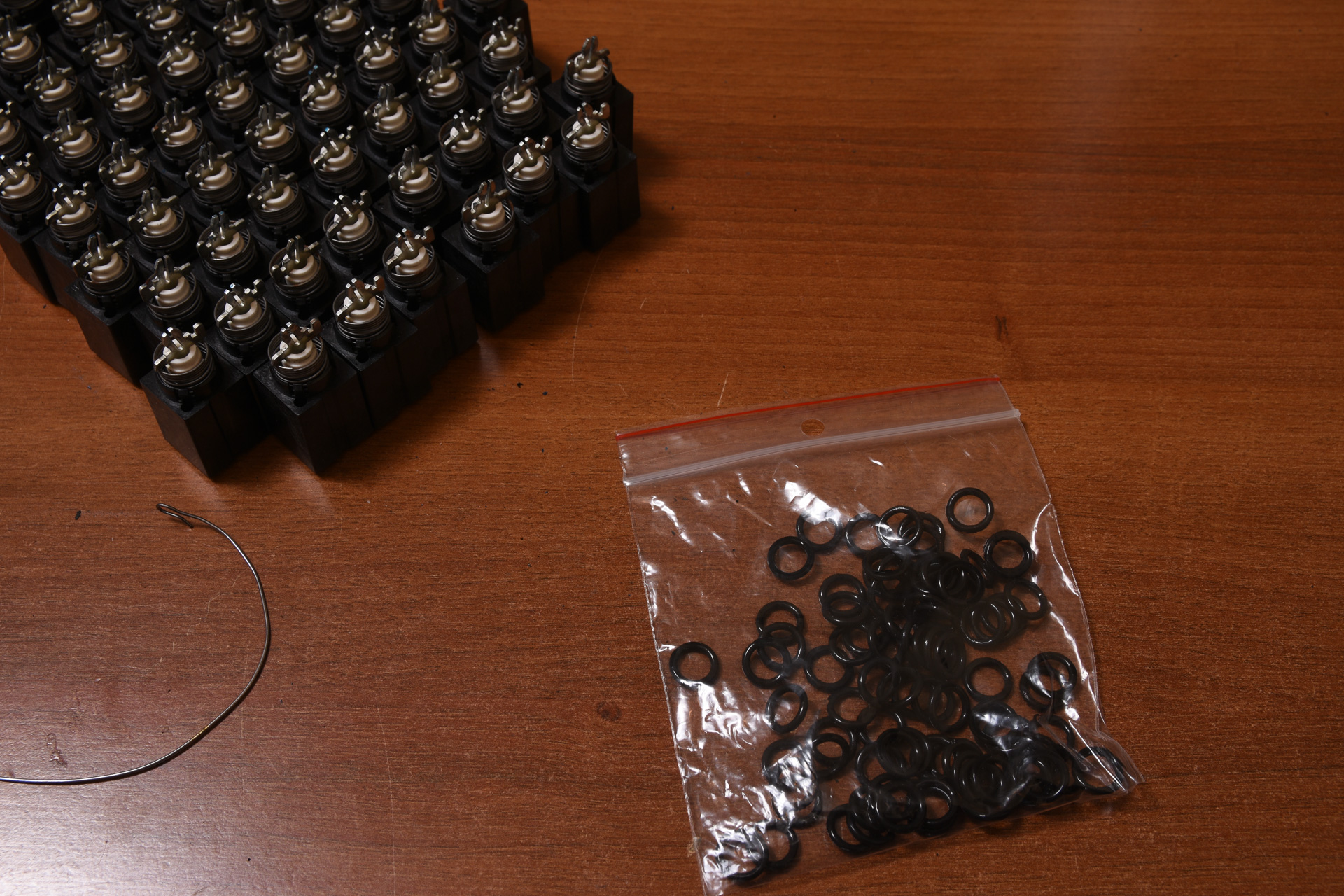

Instead of making new foam, I tried another solution. I used #15 o-rings on each switch.
I had plenty (widely used in paintball) and it was easy enough so I gave it a try. The black one is Buna-N 70A Durometer (used 84) and the clear is urethane (90A IIRC, used 4)
Switches ready for action!

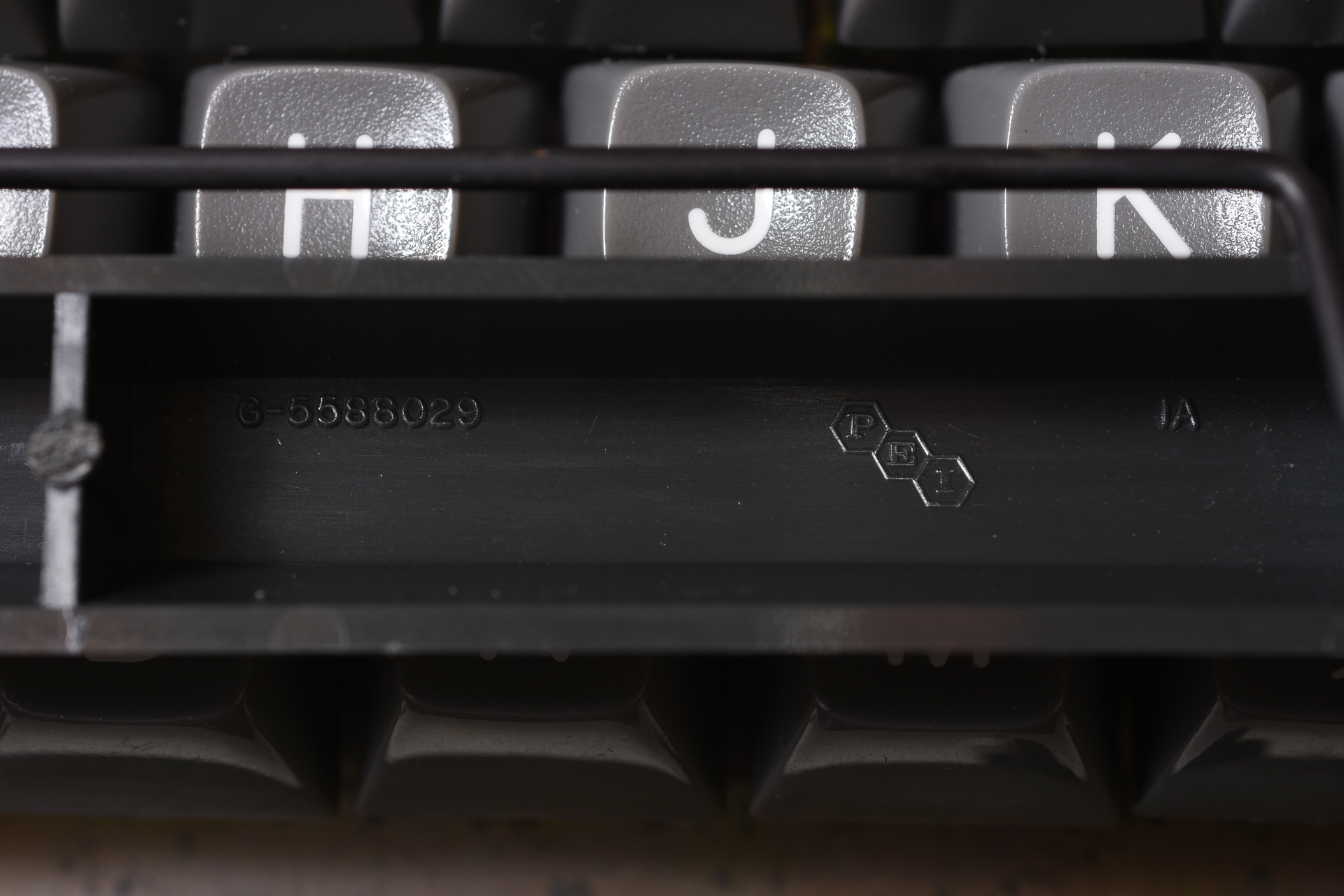

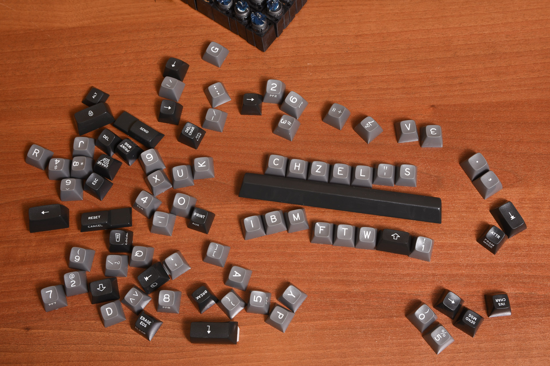

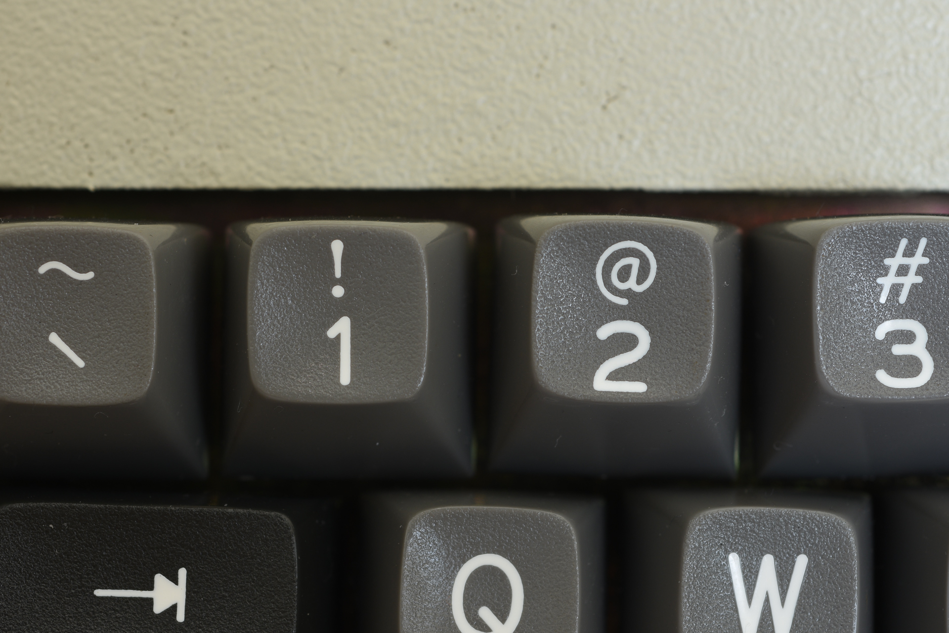

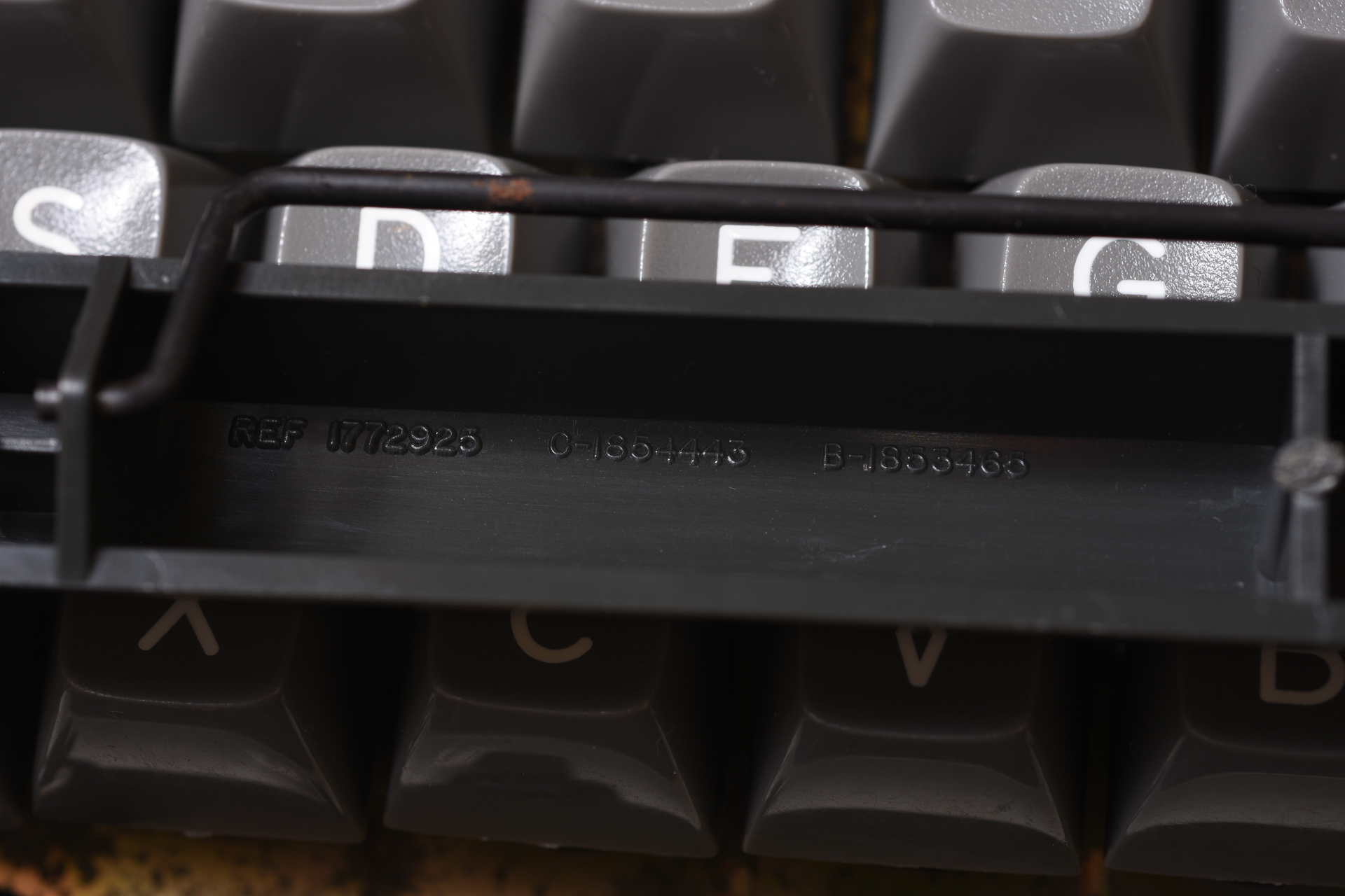

All caps mounted, and a bit of spacebar detail. A bunch of codes, and apparently it's made of PEI
Controller installed and cable secured.

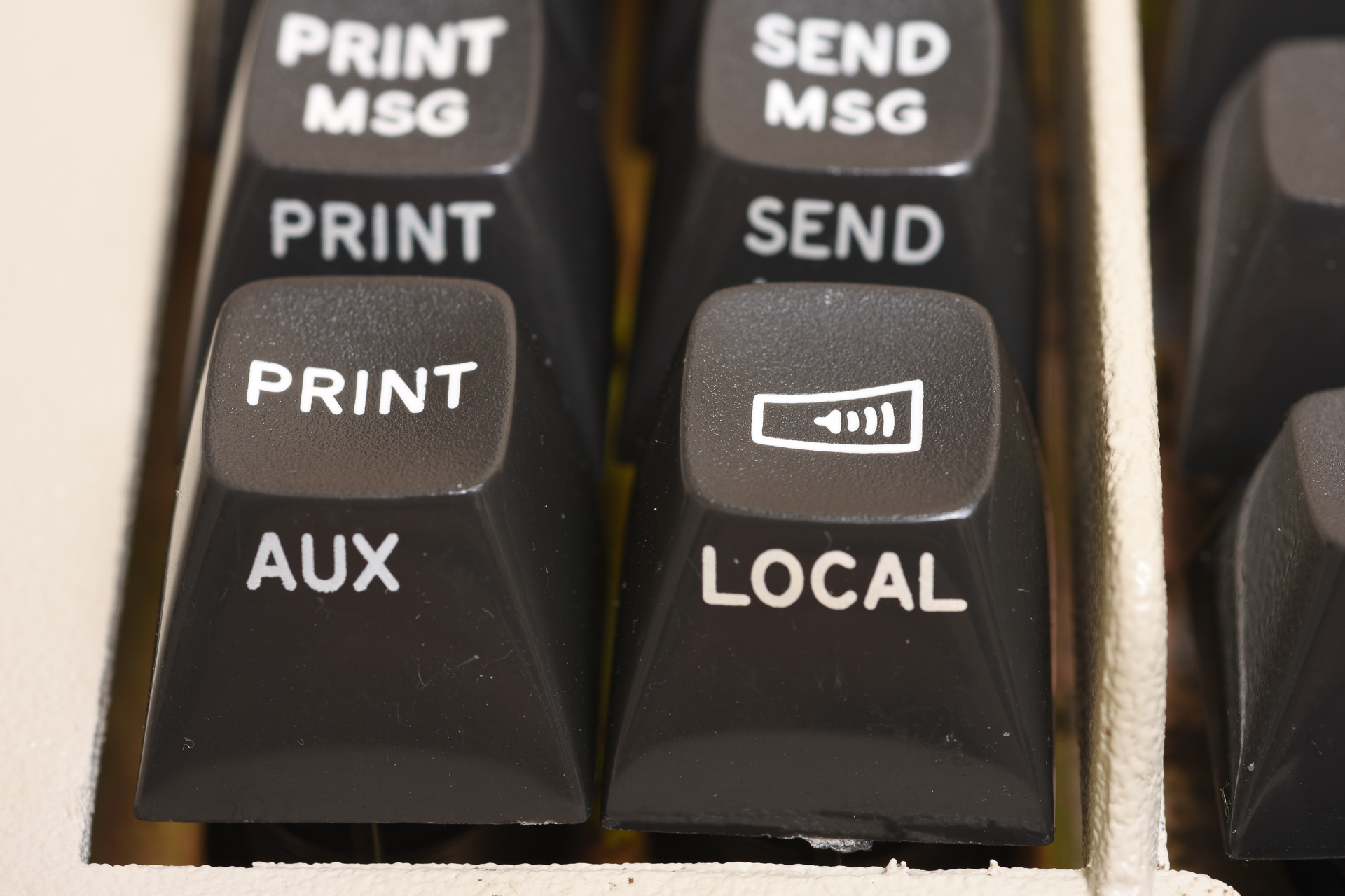

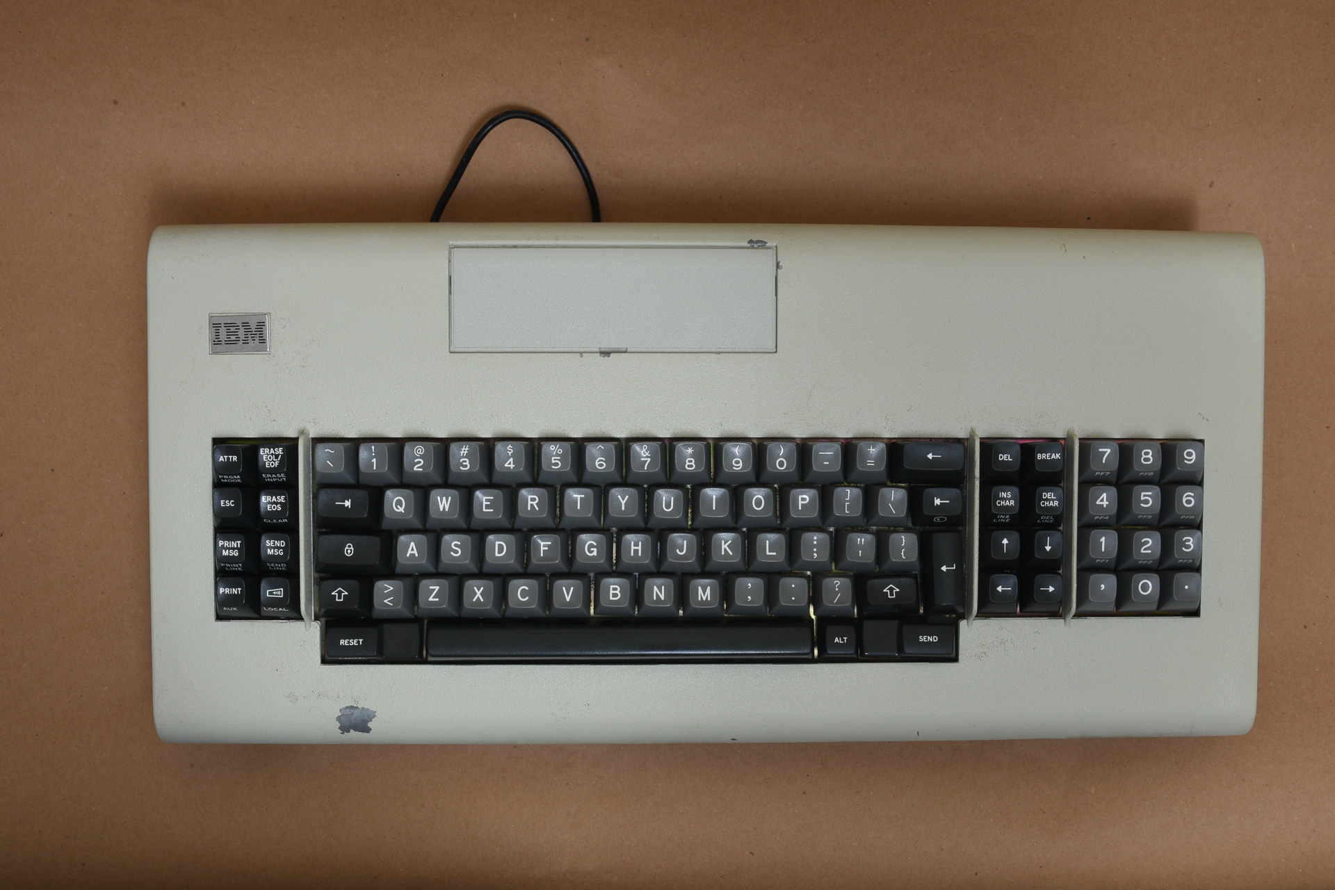

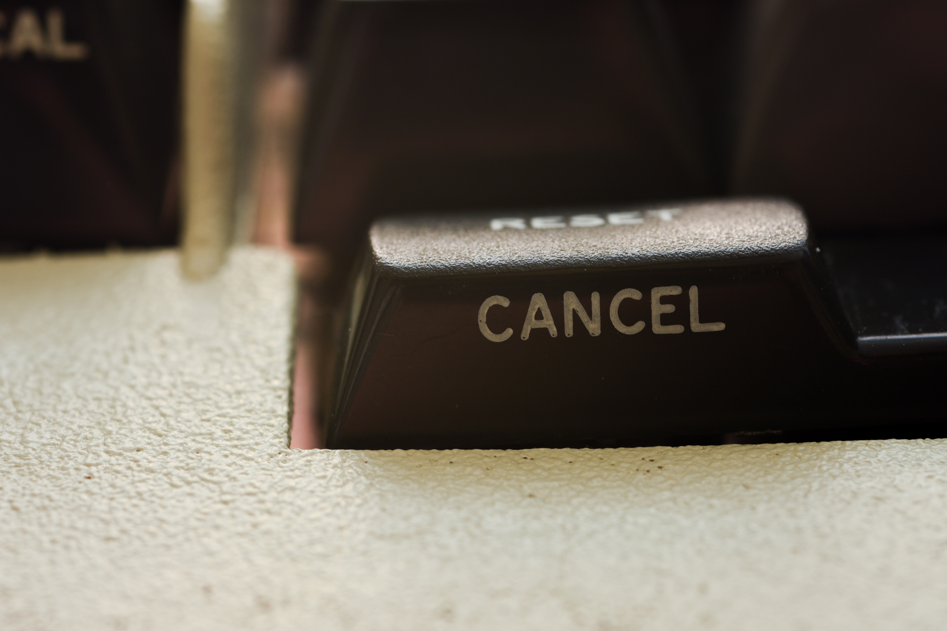

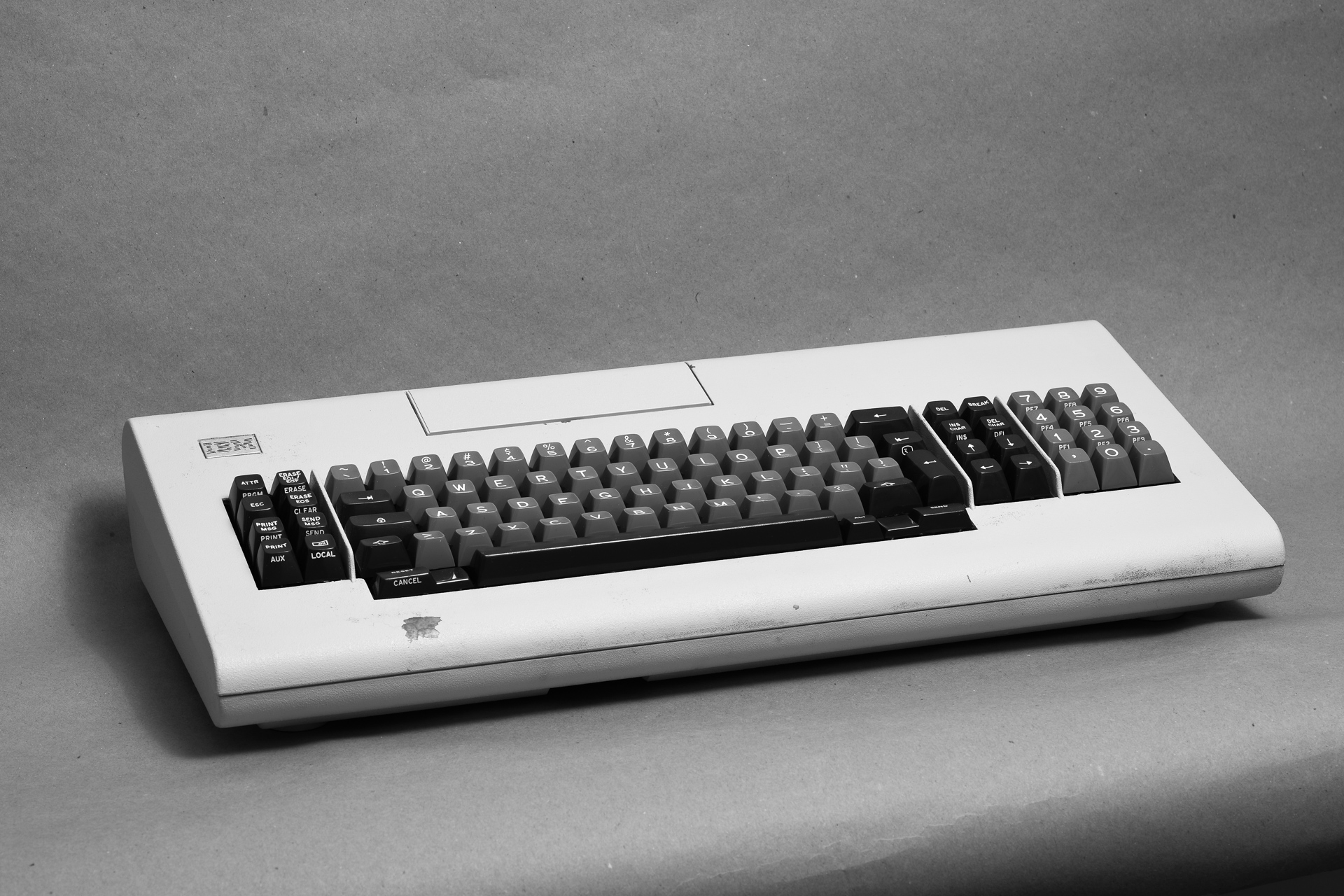

Caps are great, even the printed front legends, altough some are better than others.

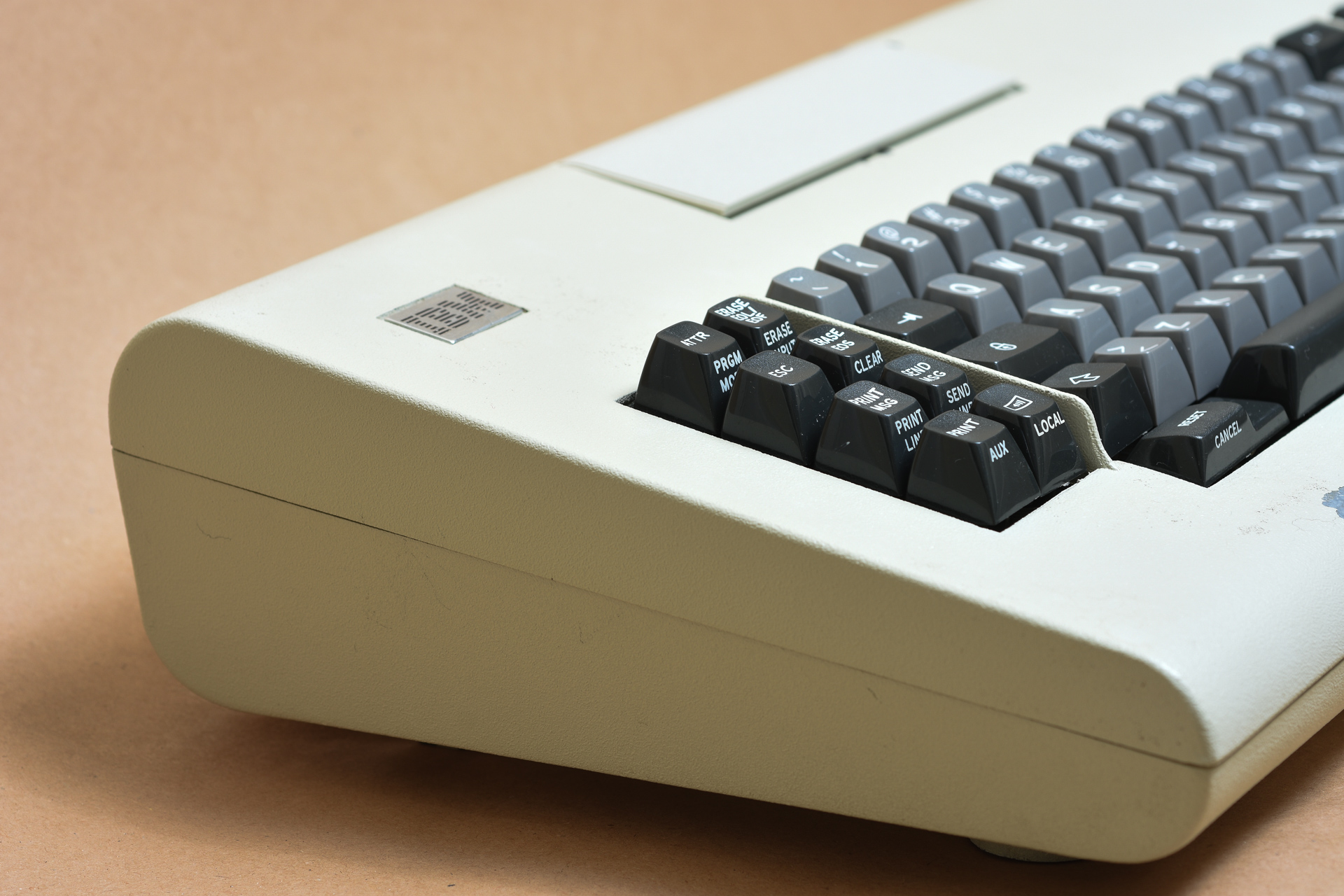

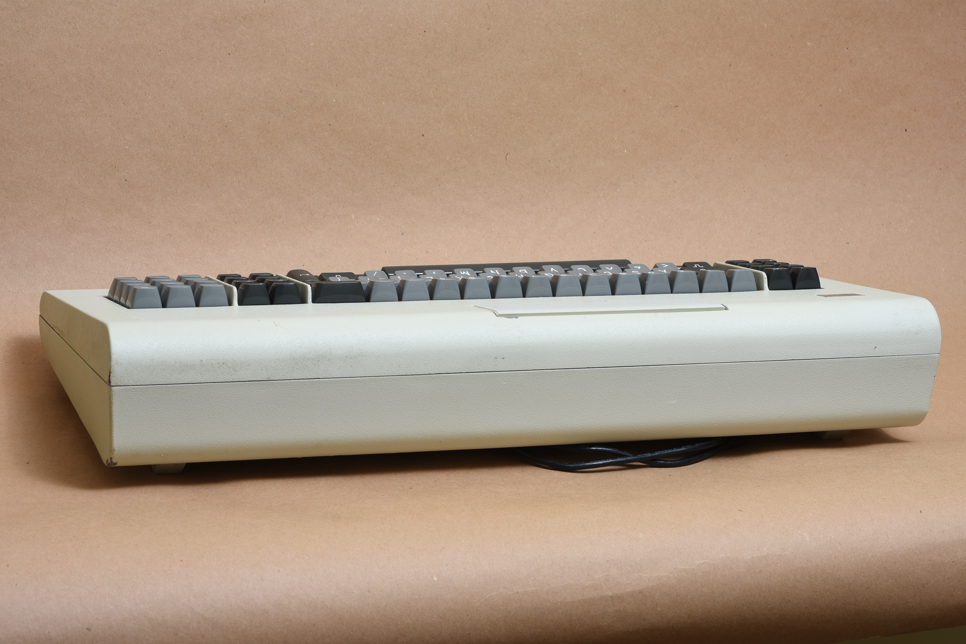

Overall a rather handsome keyboard, and so tall that it actually makes me want a shorter desk...

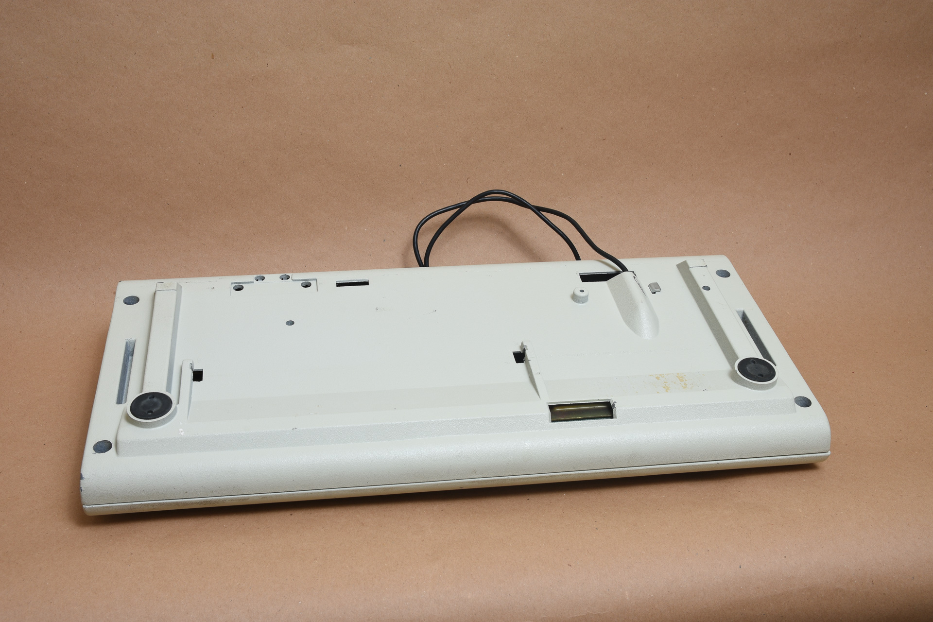

Back is bland, just a block of metal...
Bottom all cleaned up. All labels where removed and will be laminated as soon as I can get pouches.

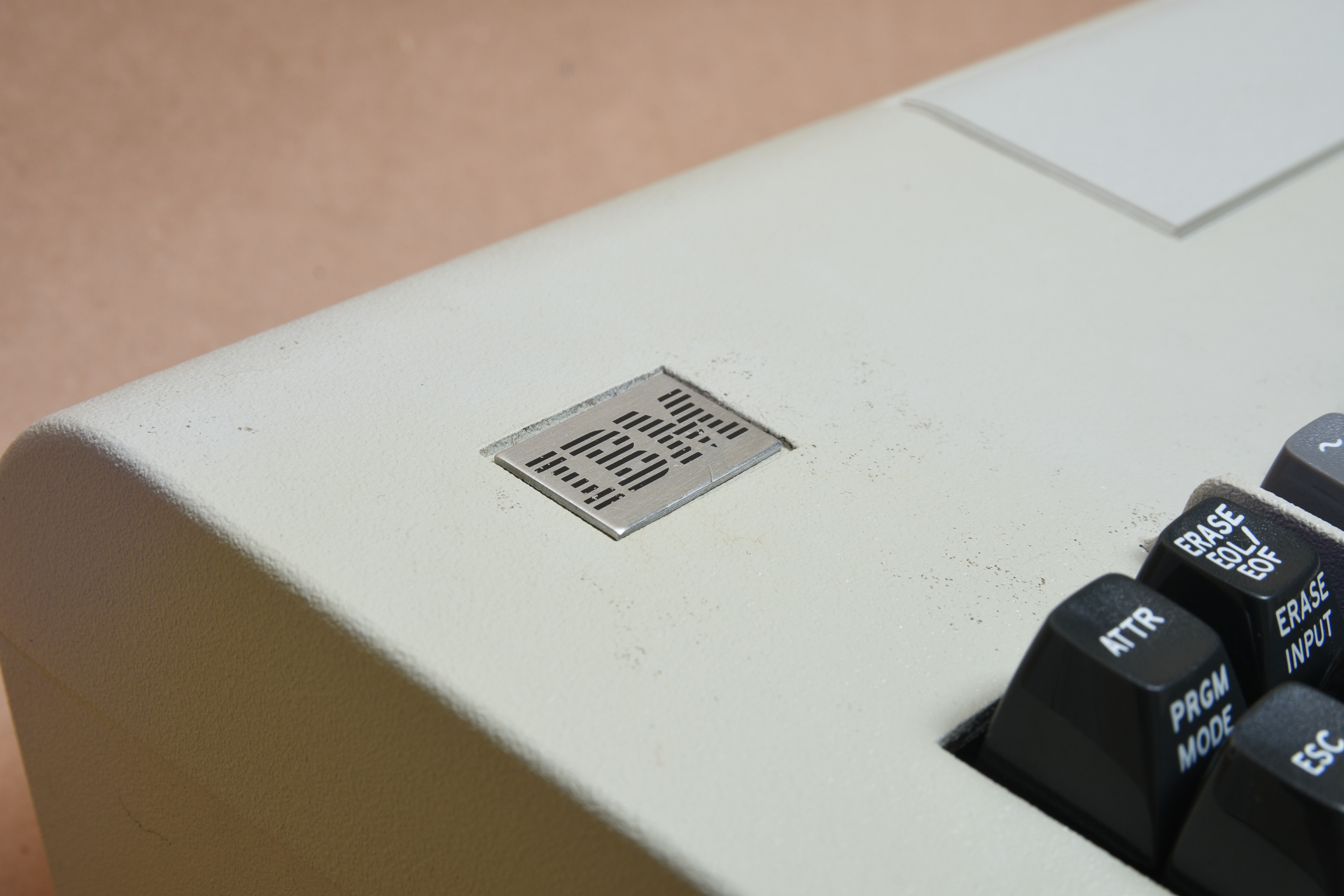

The IBM badge
Artsy fartsy black and white!
The orings work nicely, except for the middle row of switches that's somewhat loose. Perhaps softer orings would work better.
No ill effects, but the switches turn a bit in the hole, and caps end up wonky..
I'll open it up again at some point and make new foam for it.

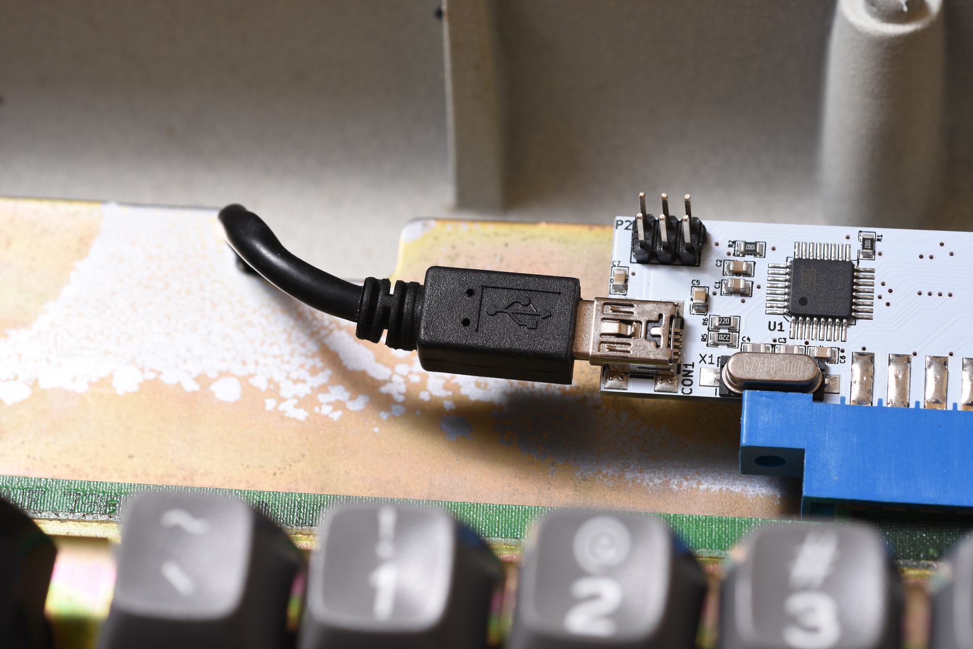

I'm tempted to put Lock LEDs in the hatch, but xwhatsit doesn't support both LEDs and solenoid, and I'm definitely using the solenoid (driver is in the mail)!
Another thought is a switch to change the configuration from solenoid to LEDs, and with a simple change from the software have one or the other.

The orings work nicely, but ideally you either want softer orings (40-50A) or thicker ones along the centreline.

There is a insect inside that keycap!!! WTF :mrgreen: :mrgreen: :mrgreen:
