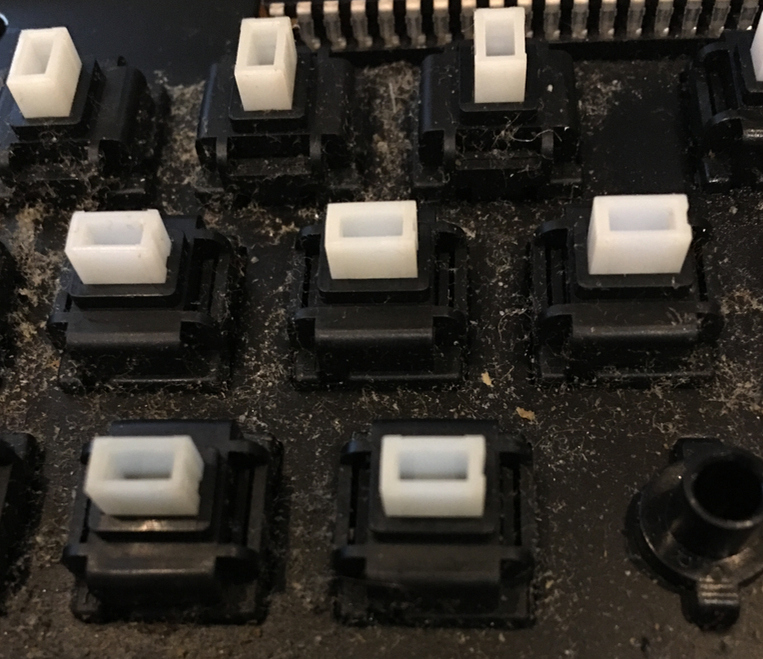

Can you all offer some advice on what PCBs might be available that would work with Monterey Blue switches. As I understand it the SKM variety like this are not compatible with native Alps connections or pinouts.

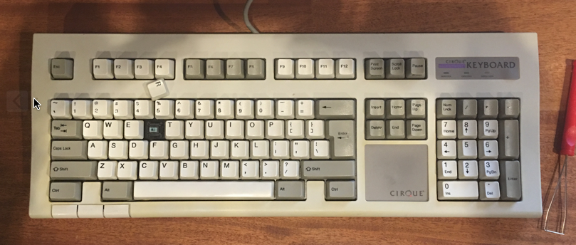

I’ve got a Chicony / Cirque board with Monterey Blues. It’s got cheap caps and even when I place some AEK caps on it, the sound is only slightly improved (although the feel is greatly improved). The thing is I don’t really like the layout of the board either. It’s got an ugly big ass Enter (some big asses are better than others), and it doesn’t really approximate my preferred layout (delete above enter, Control left of A—HHKB). So cutting the board down isn’t really a desirable option (not because of the work, but the layout I’d be left with).
I know there are a number of PCBs and plates that will accommodate Alps switches, but I have no idea what can be done with Monterey Blues… Anyone know of a solution?

I'm not sure Montereys are compatible with ANY PCBs that aren't SMK-based Oo .

I've done a bit of looking in the past. I think the only solution would be to design a PCB specifically for these switches. It hasn't been done before AFIK.

seaworthy wrote: Can you all offer some advice on what PCBs might be available that would work with Monterey Blue switches. As I understand it the SKM variety like this are not compatible with native Alps connections or pinouts.
Design your own PCB, or hand wire. You can use most Cherry MX plates with square holes.

The plate holes are the same size and dimension as Cherry MX, so you maybe plates for Cherry MX could be repurposed for SMK "Montereys"
I don't know if the switches would snap to the plate though ...

No, the plate holes for SMK and Cherry switches are 14×14 mm square. Alps don't fit in those holes.
With Cherry switches (and sometimes with Alps - if the very fragile snaps are intact), you could snap the switches to the plate and solder wires/diodes directly to the switch pins instead of using a PCB. I don't know if you could do that with SMK.
The pinout of SMK, Cherry and Alps are incompatible with one-another. Some enthusiast PCBs support both Alps and Cherry - but none supports SMK also because SMK pinout is too different.

SMK switches absolutely clip into most plates designed for Cherry MX switches. I’d recommend a ~1.2–1.3mm thick (or 18 gauge) steel plate though. 1.5mm / 16 gauge might be too fat, or at least is right on the edge of what they can clip to.
Alps switches do not work on the same square holes.

SMK switches have the nearly the same dimensions as Cherry MX but the pinout is completely different so MX PCBs won't work.

Indeed. You could hand wire, like this:
workshop-f7/the-apple-m0110-today-t1067.html
But it's a lot of work. Fiddly, too. Nothing impossible, but a different scale of project to simply assembling a PCB. I have asked for Monterey support in PCBs already, but none of the designers are interested. Maybe they have a point — no supply of new switches — but Montereys are brilliant and well deserve a community PCB. The donor boards aren't too hard to find, yet are so crap compared to their switches they're begging for customs!

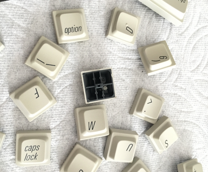

The only downside is that the double-shot keycaps they used have stems which are too fat, causing SMK switches to bind. If you can find one of the “made in Japan” orange Alps version of the same keyboard, the dyesub keycaps from those work much better with SMK switches, while the double-shot caps work fine on Alps switches.

Yeah, if you want you can desolder all the white (tactile, non-clicky) switches, and solder in your blue (clicky) switches.
Unfortunately, the keycaps have very fat mounting stems, which bulge the plastic outward and cause these SMK switches (both blue and white types) to stick sometimes.
Funny enough, the Alps-made dyesub keycaps from the “Made in Japan” version of this keyboard work fine with SMK switches, while the SMK-made doubleshot keycaps from the “Made in Taiwan” keyboard work just fine on Alps switches.
So if you can get one of each board, I recommend swapping the keycaps between the two. (There’s a very yellowed one on ebay right now http://www.ebay.com/itm/231840112434 but better ones come up every few weeks.)
(Also requires swapping either the stabilizer wires or the stabilizer keycap inserts, as they use different inserts of different heights for no particular reason.)

It’s interesting these caps have a “fat” stem as they seem looser fitting than Alps caps (so do the caps on the Chicony where my Monetary blues currently reside).
This board came with three bad switches: delete and + and - from the numpad. I haven’t pulled the switches apart yet, but they simply don’t return after being pressed. Wonder if its a bad click leaf and wonder if the location of these switches is indicative of previous binding or just something else.

seaworthy wrote: It’s interesting these caps have a “fat” stem as they seem looser fitting than Alps caps
The mount stems are a different shape, if you compare to other Alps-mount keycaps. They’re fatter but shorter, more squarish.
This board came with three bad switches: delete and + and - from the numpad. I haven’t pulled the switches apart yet, but they simply don’t return after being pressed. Wonder if its a bad click leaf.
No, the switches are fine. The problem is the keycaps. This is the sticking problem I was talking about. Try putting some random other Alps cap on those switches, and it’s likely they’ll go up and down without issue. (You might have to squeeze the sliders a bit with your fingers to return them to their original shape, if they’ve been sitting bulged out for a couple decades.)
I haven’t tried, but you might be able to use the keycaps from an M0116 on one of these boards, and vice versa, if you don’t have one of the Made in Japan IIGS boards lying around.
