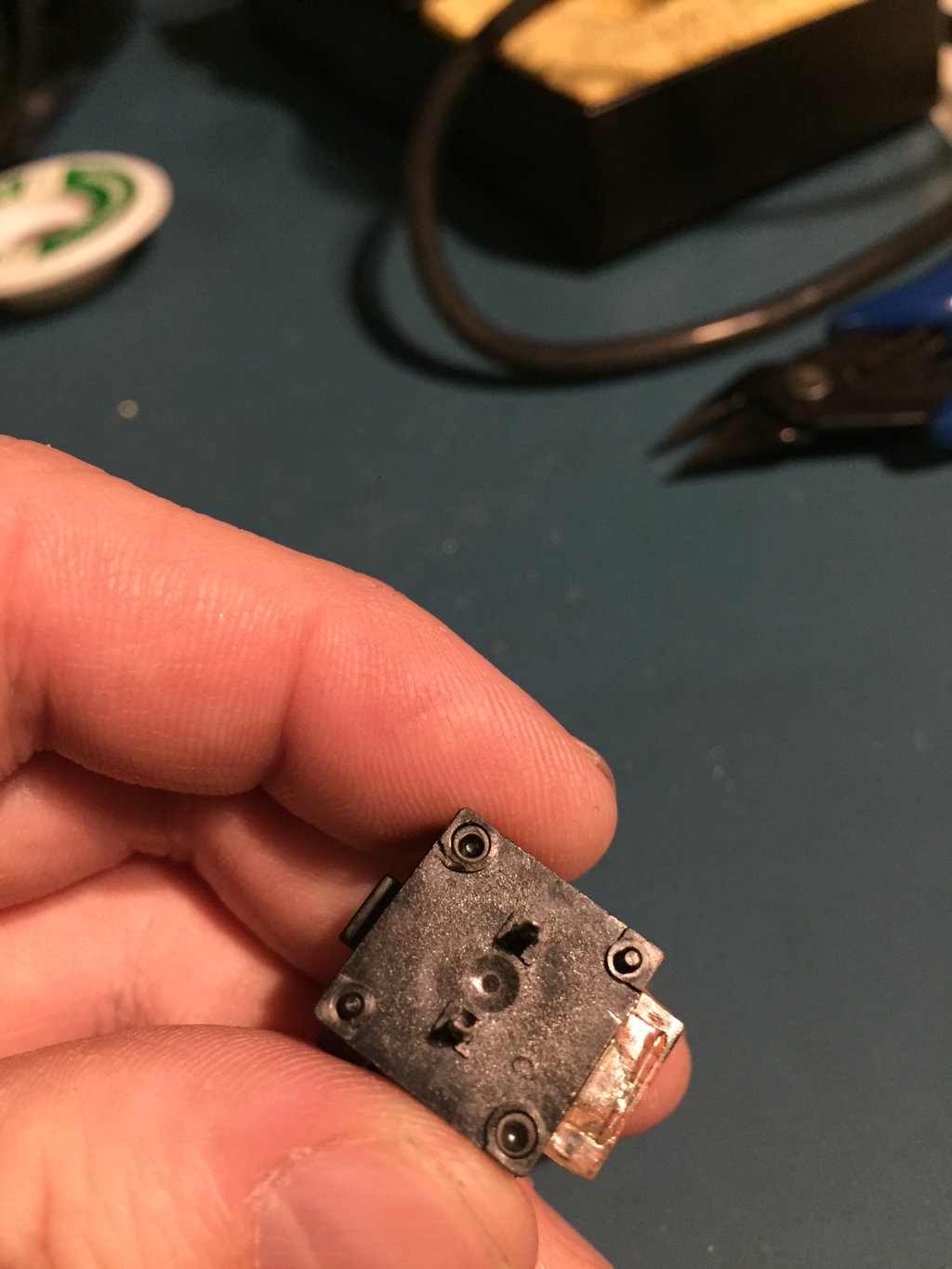

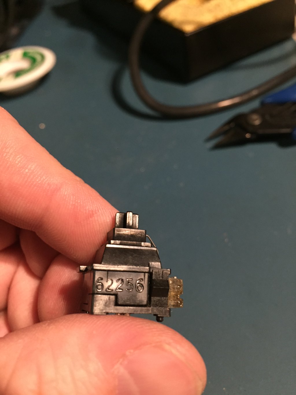

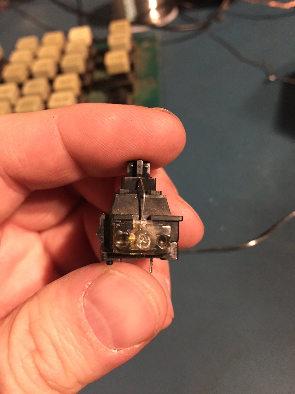

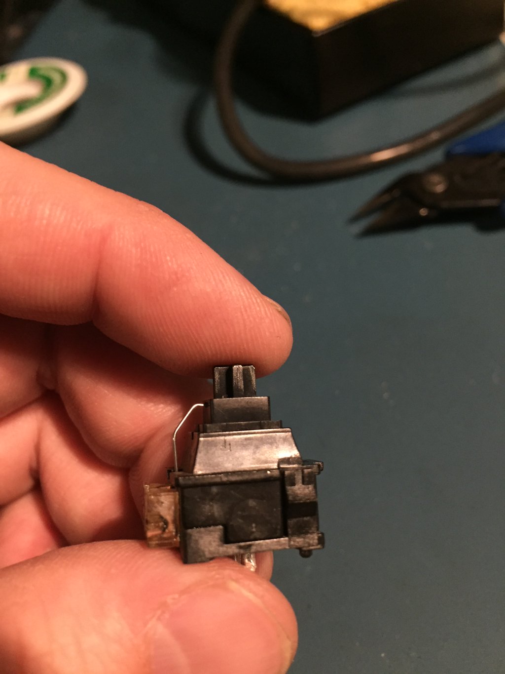

Anyone recognize this keyswitch? Or possibly someone knows of a drop-in replacement.
I'm trying to repair the keyboard on a Fluke 9010a (a 1980s CPU troubleshooter), and this locking spring on this switch isn't working correctly. The switch works fine, but it should toggle between open/closed when depressed, and this mechanism is the problem.
The part number is stamped on the side, but that's the Fluke internal p/n. I'm hoping these were bought from another supplier and assigned a part number, rather than manufactured by Fluke, since that would greatly increase my chances of finding a replacement.
ID this keyswitch

I haven't seen it before, in the wiki or elsewhere. It reminds me of certain brands of reed switch, but the spacing of the solder legs seems off. Good luck.

I wonder what the little arm at the front/rear/side is Oo . If they're easy to open, could you show the insides? Might give a clue as to who made it maybe.

The spring arm and clear plastic part on the side are the push-push locking mechanism, which is what's broken with this switch. The keyswitch works fine, but the key doesn't stay locked on when depressed. The spring is moulded into the plunger, and would be immobilized by the plastic if it was working correctly. The bond between the spring and plastic has worn and broken, leaving the spring flopping around instead of locking like it should. There are two push-push keys on this machine, and both have the same problem.
Since it looks like replacement isn't an option, I may see if I can use epoxy to get the spring immobile, then tweak the angle so it springs correctly again.

Adding, I looked to see if I could take the switch apart, but came to the same conclusion as ohaimark. The top/bottom are secured with plastic rivets, and I suspect disassembly would ruin the switch. Since I'd rather have a partly working switch than a totally broken one, I don't think I'm going to do that.

I have Datanetics switches on my Volker Craig terminal that have a metal spring arm that is for the locking key switches. Have a look at the bottom pics in this thread. The switches are not the same Datanetics switches but they have similar looking metal locking arms.
