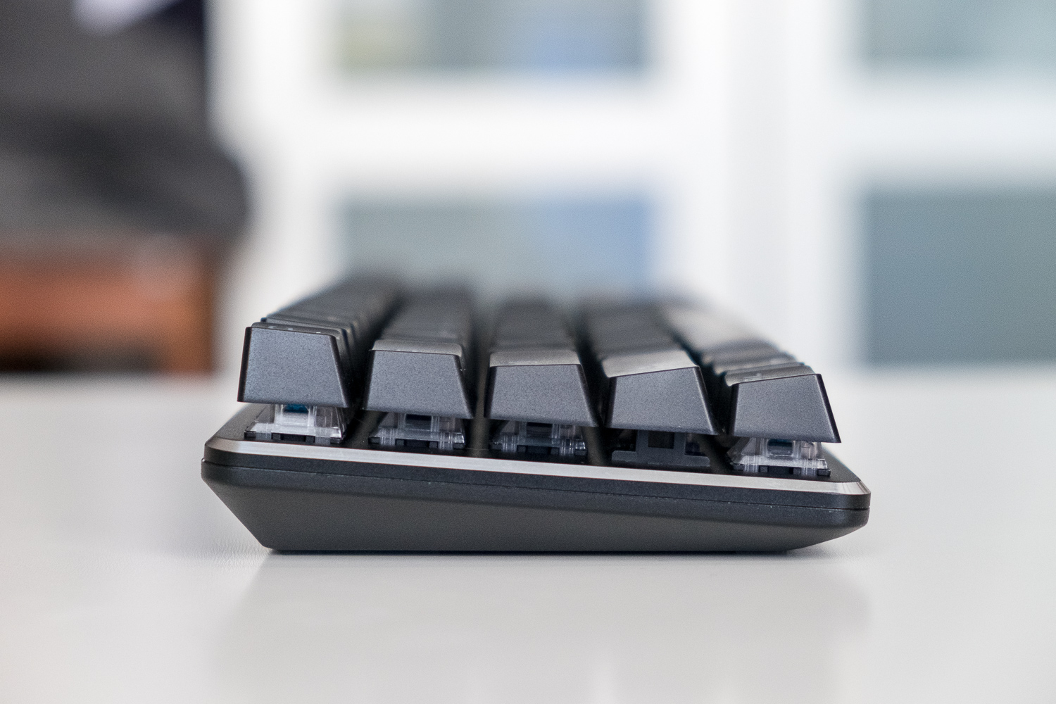

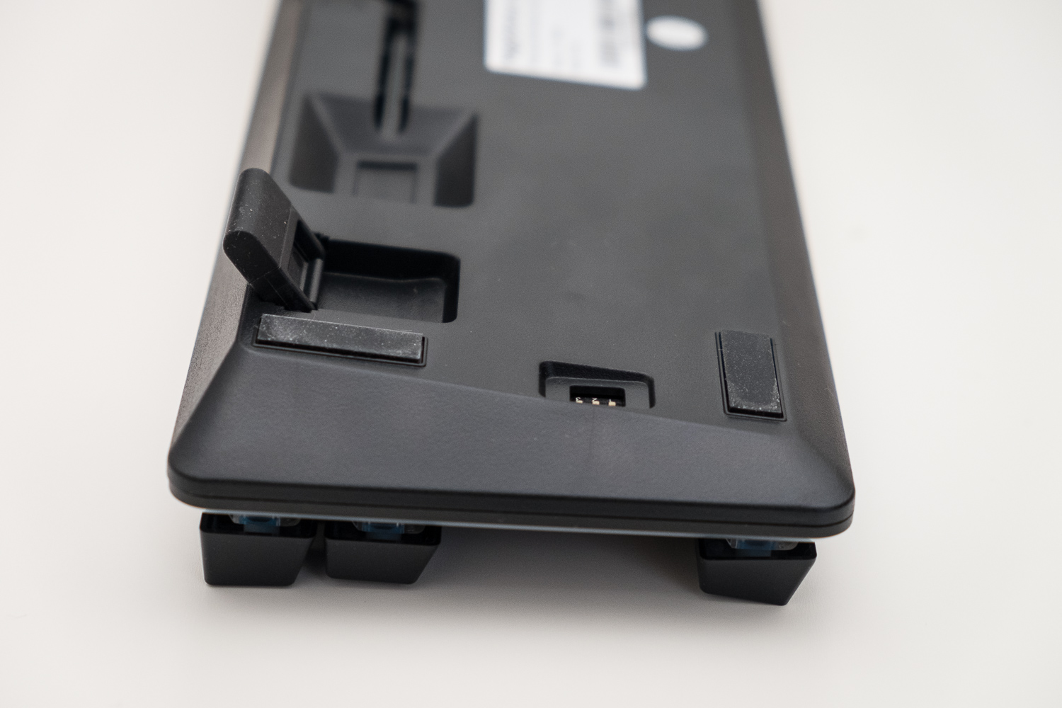

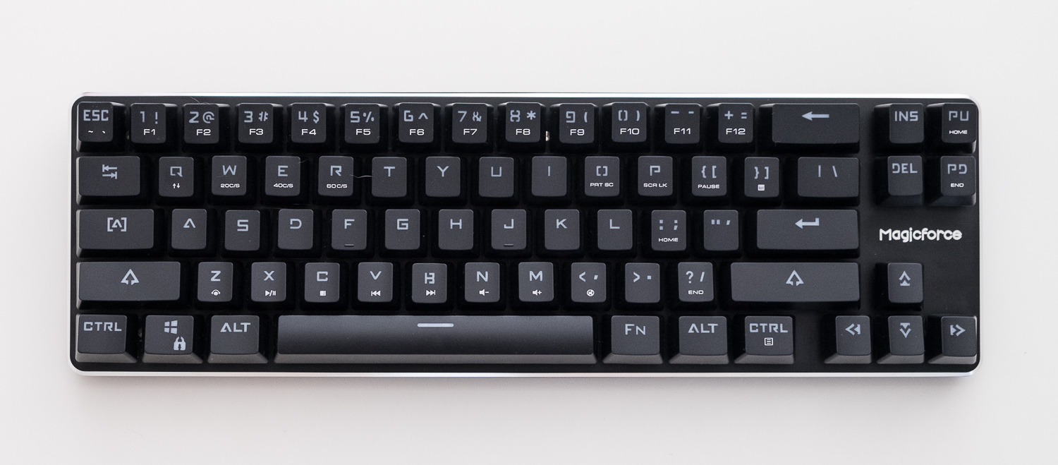

About a week ago I finally received my Magicforce 68 keyboard and I'd like to offer my take on that thing.
First of all, the keyboard is very solidly made. The plate is made of thick aluminum and the bottom of the case is plastic. The keyboard doesn't flex or creak at all.

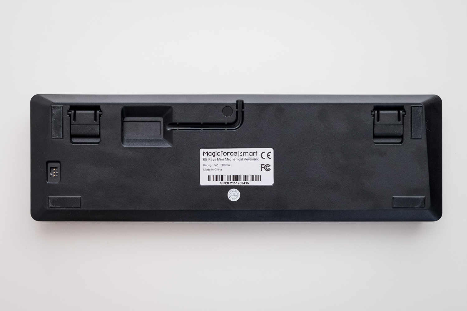

There are anti-slip rubber pads both on the bottom of the case and on the spring-loaded feet, as well as a built-in cable management / strain gauge.
I ordered it with no LEDs, but I didn't think there would be no LEDs at all, including no Caps Lock indicator.
The keyboard uses Cherry-style stabilizers.

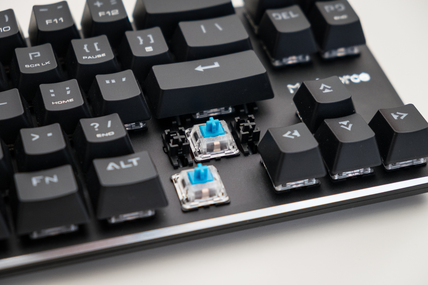

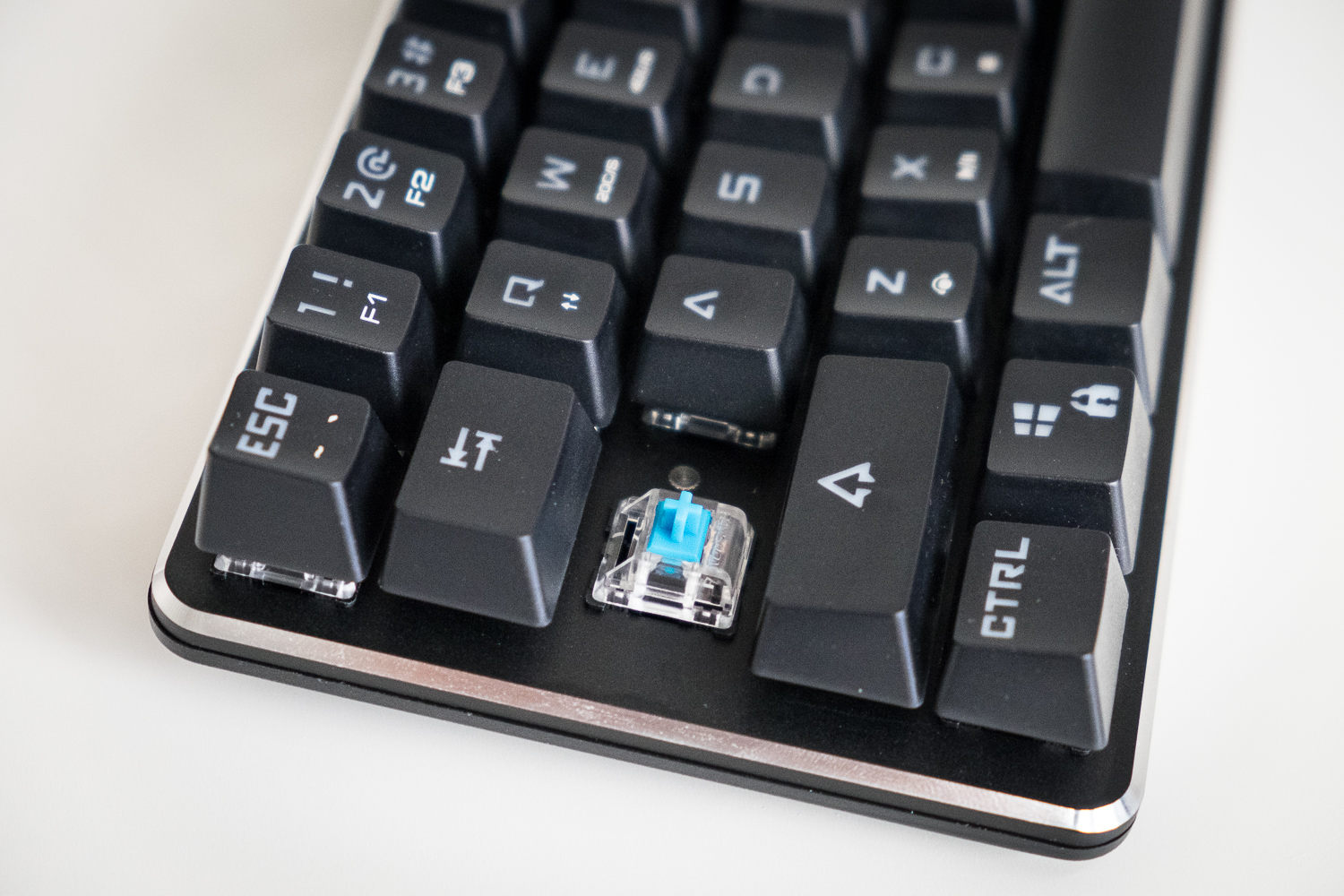

One of the reasons I ordered this keyboard was that I wanted to evaluate Gateron Blue switches. I must say I'm not too impressed with them. They're smoother and somewhat heavier than Cherry MX Blue. Their activation point is also way higher, which makes it easy to type without bottoming out. However, they have a somewhat "bouncy" feeling to them which I find unpleasant. Also it seems Gateron's QC sucks, because some (but not all) of the switches have their activation point a bit lower than others.

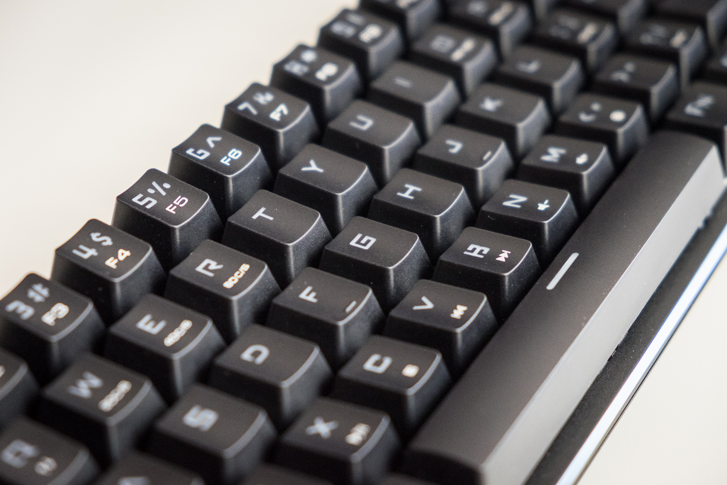

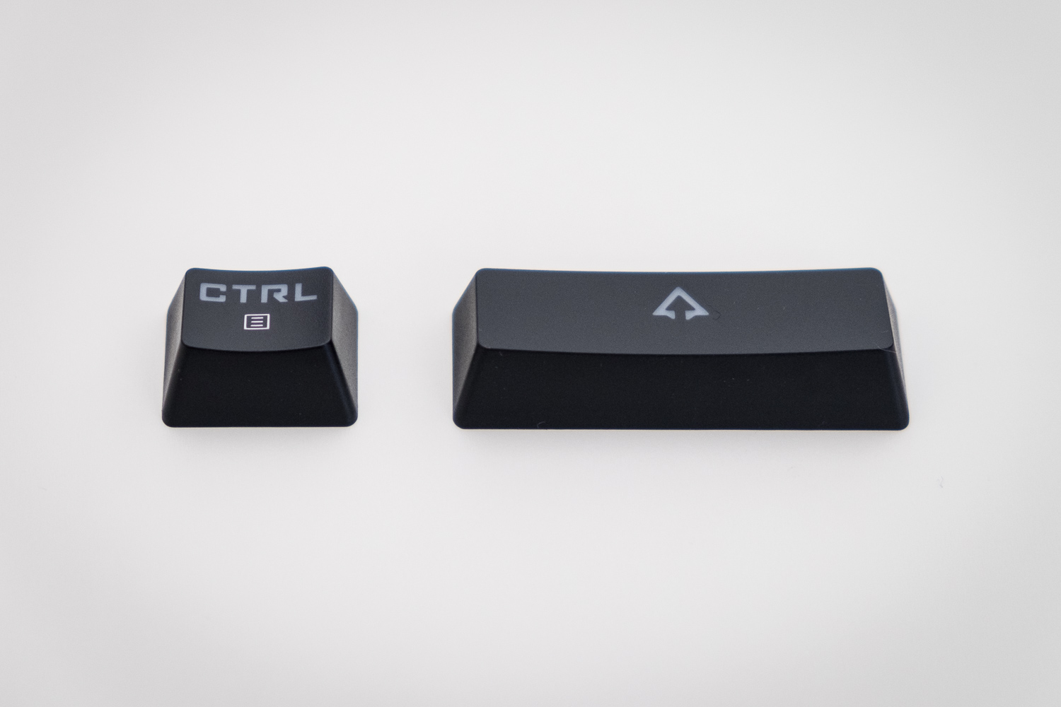

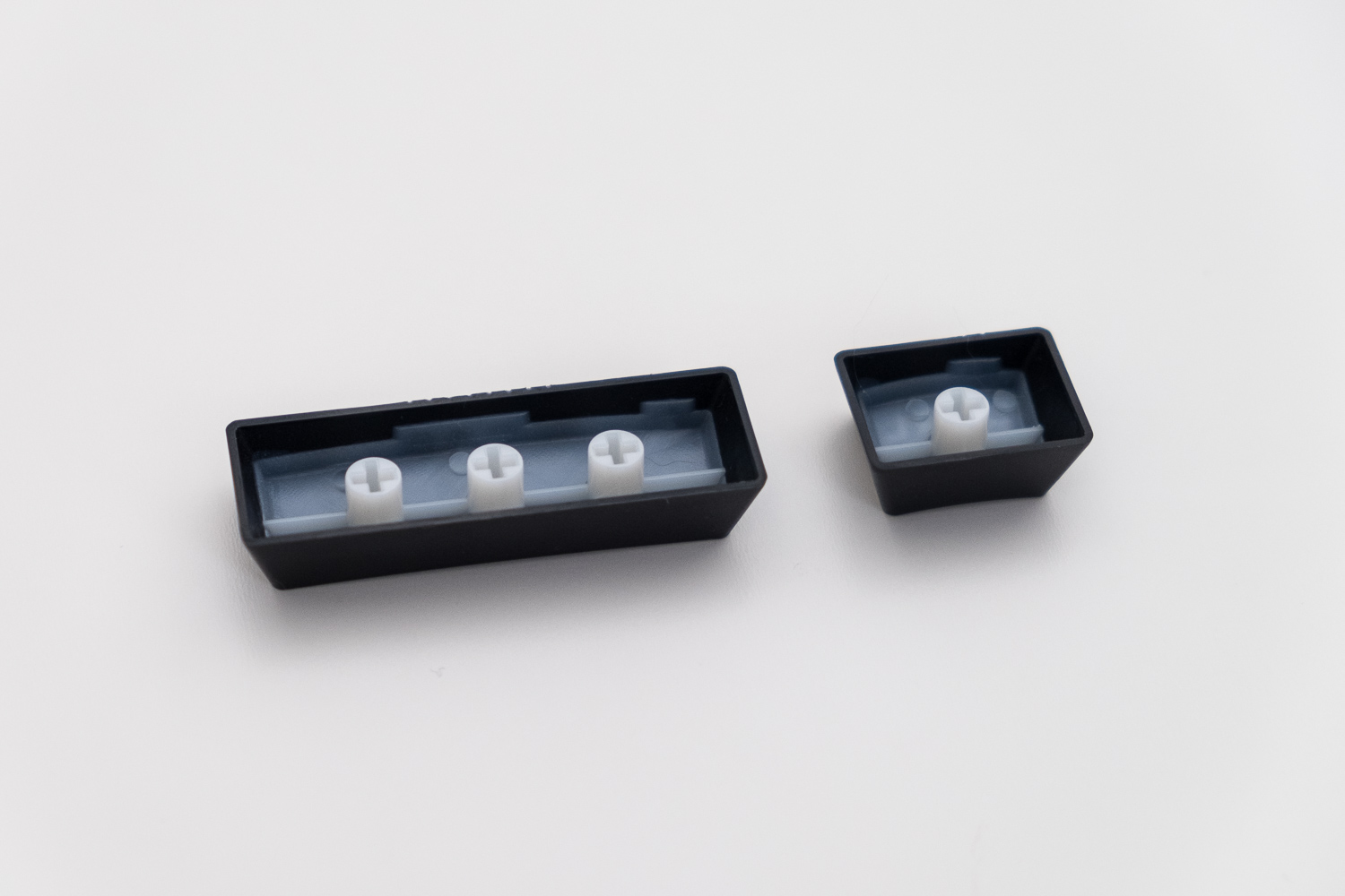

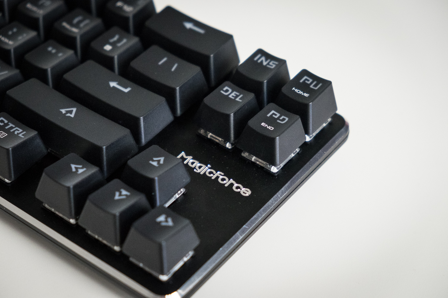

The keycaps are the biggest downside of this keyboard. They are God-awful. They are quite thin, made of translucent ABS and either coated and then lasered or doubleshot, I'm not quite sure. Either way they look ugly and they feel awful. Secondary legends are pad-printed and I already managed to wear them down somewhat — in just a week. For the sake of comparison, my Filco Majestouch Minila Air also uses ABS keycaps, but they feel 10 times better, and PBT keycaps on my Unicomp are better still.
I don't think I will keep this keyboard, because I have my Unicomp and various Alps boards for my desktop setup, and I use Minila Air on the go. Still, it was an interesting experience and I still think that this keyboard has a very good layout. In the end, it's not bad for the price, just not remarkable in any way. Oh, and I definitely expected better from Gateron, but oh well.

courtesi wrote: Maybe you got a bad batch of Gaterons; I haven't heard of these types of QC issues before. It will be interesting to see how they maintain QC going forward as their product becomes more popular.
Gateron QC is terrible. In every batch of gateron reds that I've seen, about 20% of springs are different from the rest. They have similar weight but the force profile is different - it does not matter that much on linears, but I imagine it would make more of a difference on tactile switches where it does matter a lot where exactly the actuation point is.
EDIT: Another thing I tried is to put genuine Cherry Clear stems into gaterons - about 70% worked as expected, whereas the rest didn't actuate at the point where they should have, but much higher. This is telling me that the metal leaves inside the switches do not have exactly the same shape.
EDIT2: I still do like gateron smoothness (in fact I prefer them to cherries), but they do need tuning, e.g. swapping the springs.

I wanted to dress up this keyboard a bit, but I have discovered that I don't have a full ANSI set for it! All my Cherry-compatible boards are either ISO or have that stupid big ass Enter and split backspace. So it's only partially dressed, but it feels much improved.
BTW, old Tai-Hao made ABS doubleshots are exactly the same shape and thickness as the stock keycaps.
ohaimark
Kingpin
07 Feb 2016, 00:14
Just as an FYI, the stock caps are doubleshots with pad printed sublegends. Not coat + laser.

I hate to report that one of the switches has stopped clicking today. It still activates fine, it just doesn't click anymore. Between that and out-of-the-box unevenness, I think I'm done with Gateron for the foreseeable future.
ohaimark
Kingpin
14 Feb 2016, 20:41
TL;DR -- don't buy clicky Gaterons. Stick with tactiles and linears.
14 Feb 2016, 20:42
I'll suggest as I do for all MX: avoid everything but the linears.
