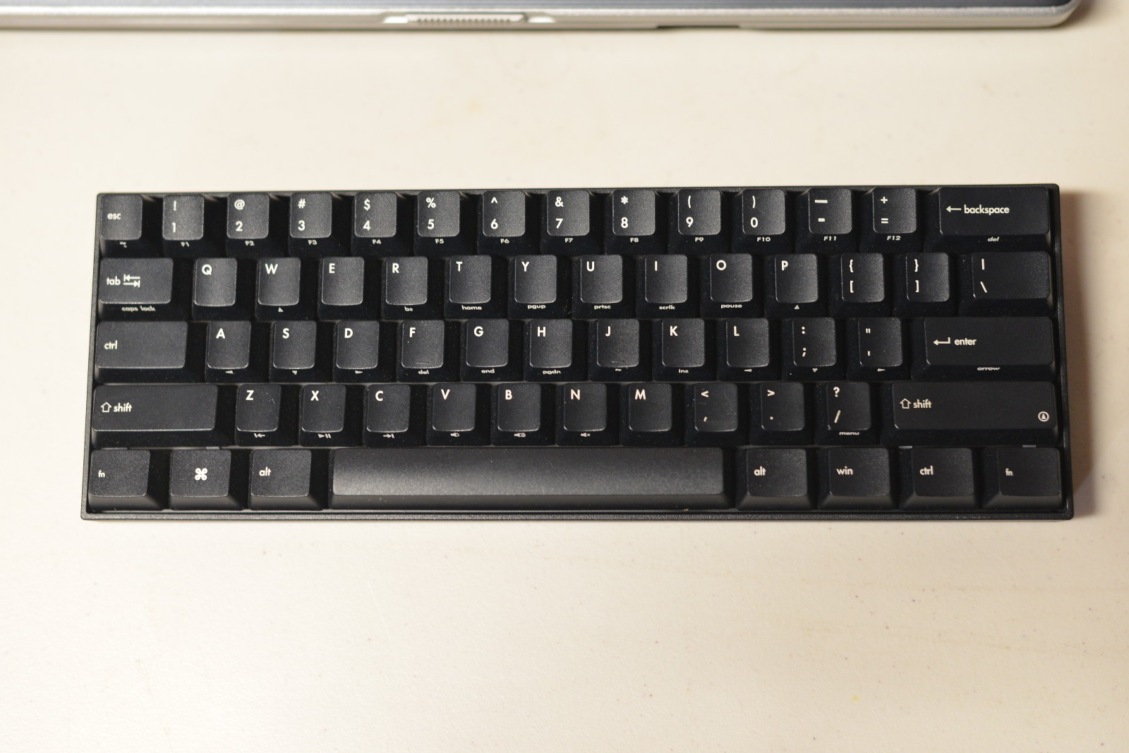

I didn't take too many photos but I've posted what I did take below. I'll take the caps off again when I have a moment to find a set of PBT Apple caps, clean them, print front stickers, and put it all together.

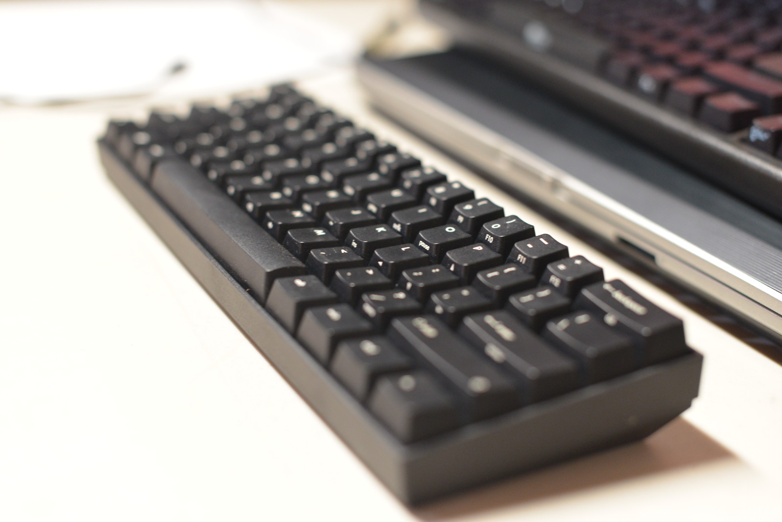

Front of board, showing very helpful front legends.

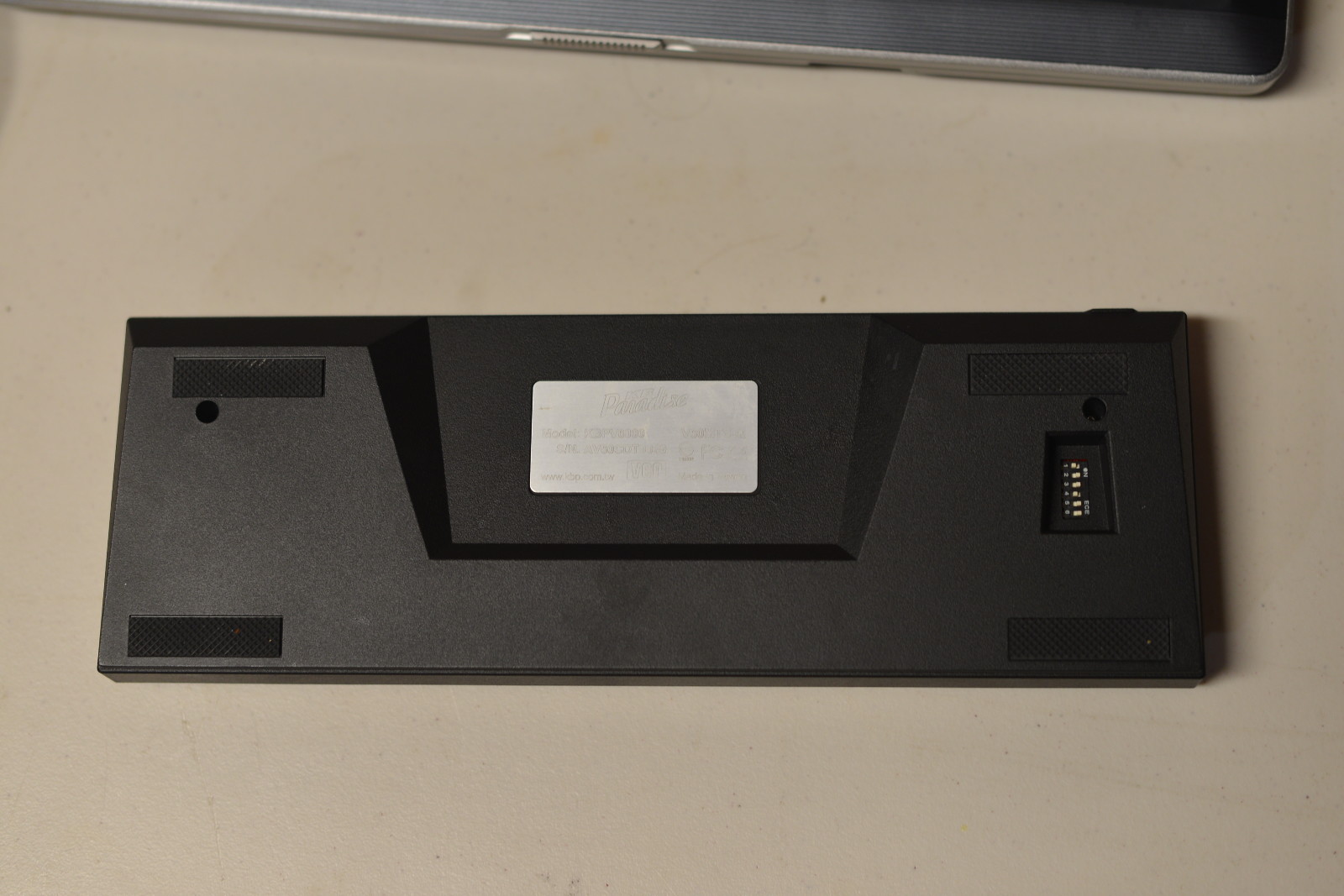

Build plate and serial number: KB Paradise V60MTS.
Artistic three-quarters view of V60, with RC930 in background.

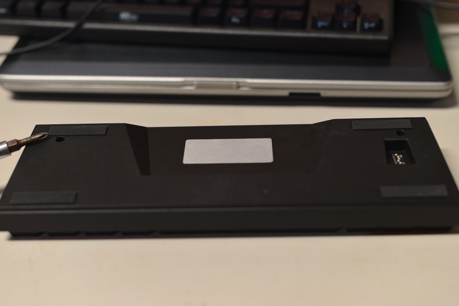

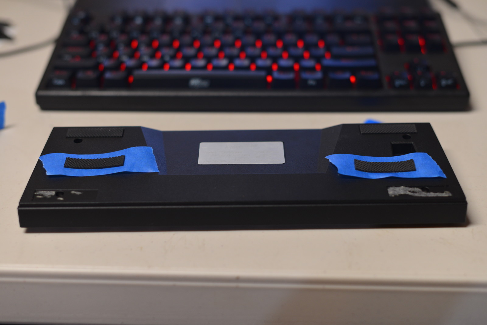

Opening the V60. These two screws come out first.
Two more screws hidden under the V60's front feet.

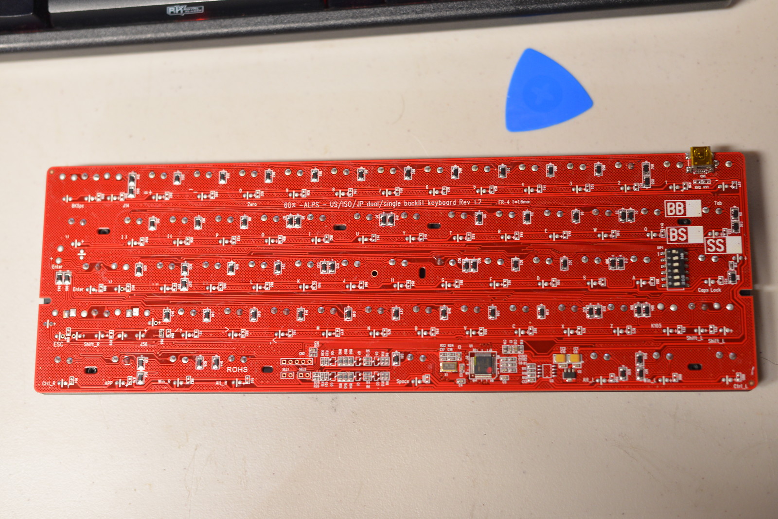

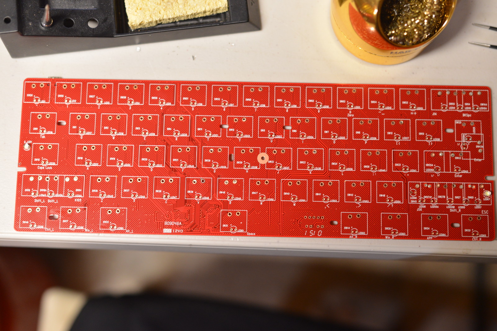

Back side of V60 PCB. Diodes and unknown controller visible.
Front side of V60 PCB. Multiple configuration options visible including possible HHKB.

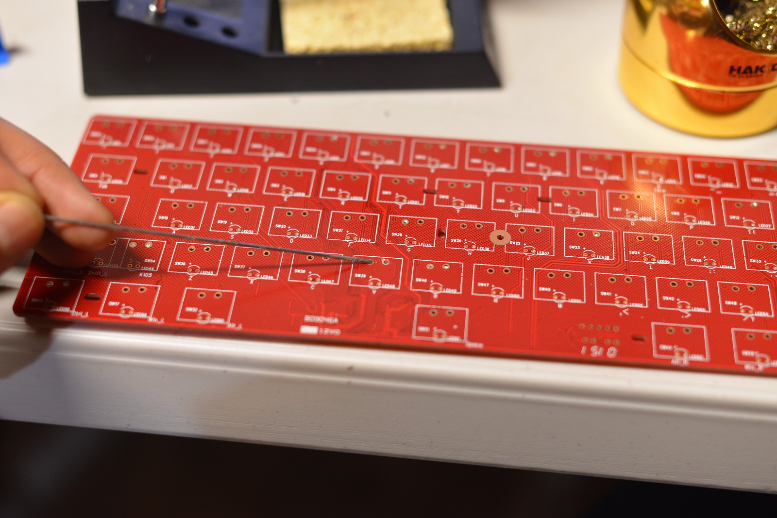

Broken solder pad on V60. I was able to fix this with a bypass wire on the back side.
