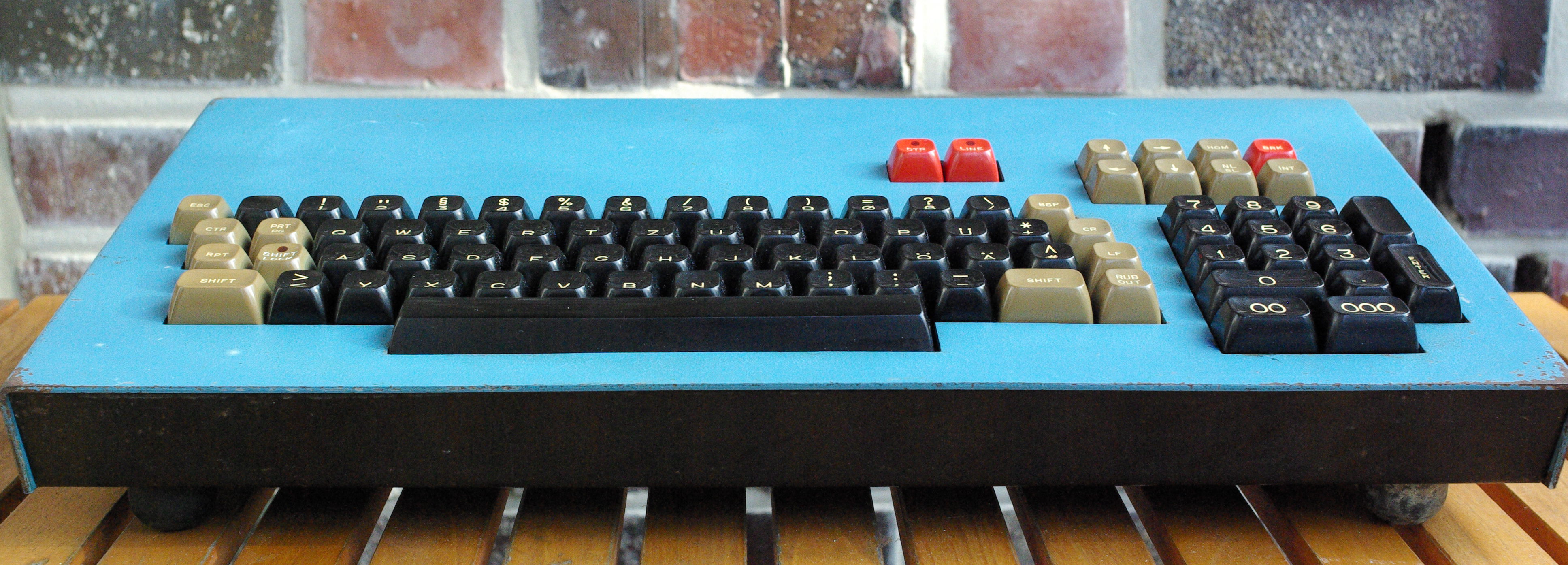

Well, that cleared up my questions on foam & foil. I had an f&f 'board about 18 years ago -- much nearer to when it was new. I didn't have anything that could work with it, nor the skills to make my own controller; I couldn't quite cut it with board design and programming at the time. The key action reminded me of the keyboard of an RM Nimbus computer I got to use for about an hour in 1989. The RM Nimbus only needed the lightest of touches to register, I think you only had to depress the keys 2 or 3mm, although they had generous travel length below that. I was fascinated, but if you accidentally clipped an adjacent key, that key would register even if you barely felt it!
seebart, that keyboard looks beautiful!
