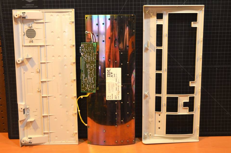

Early Model M Interior back plate
Model M Interior.jpg (481.73 KiB) Viewed 7370 times

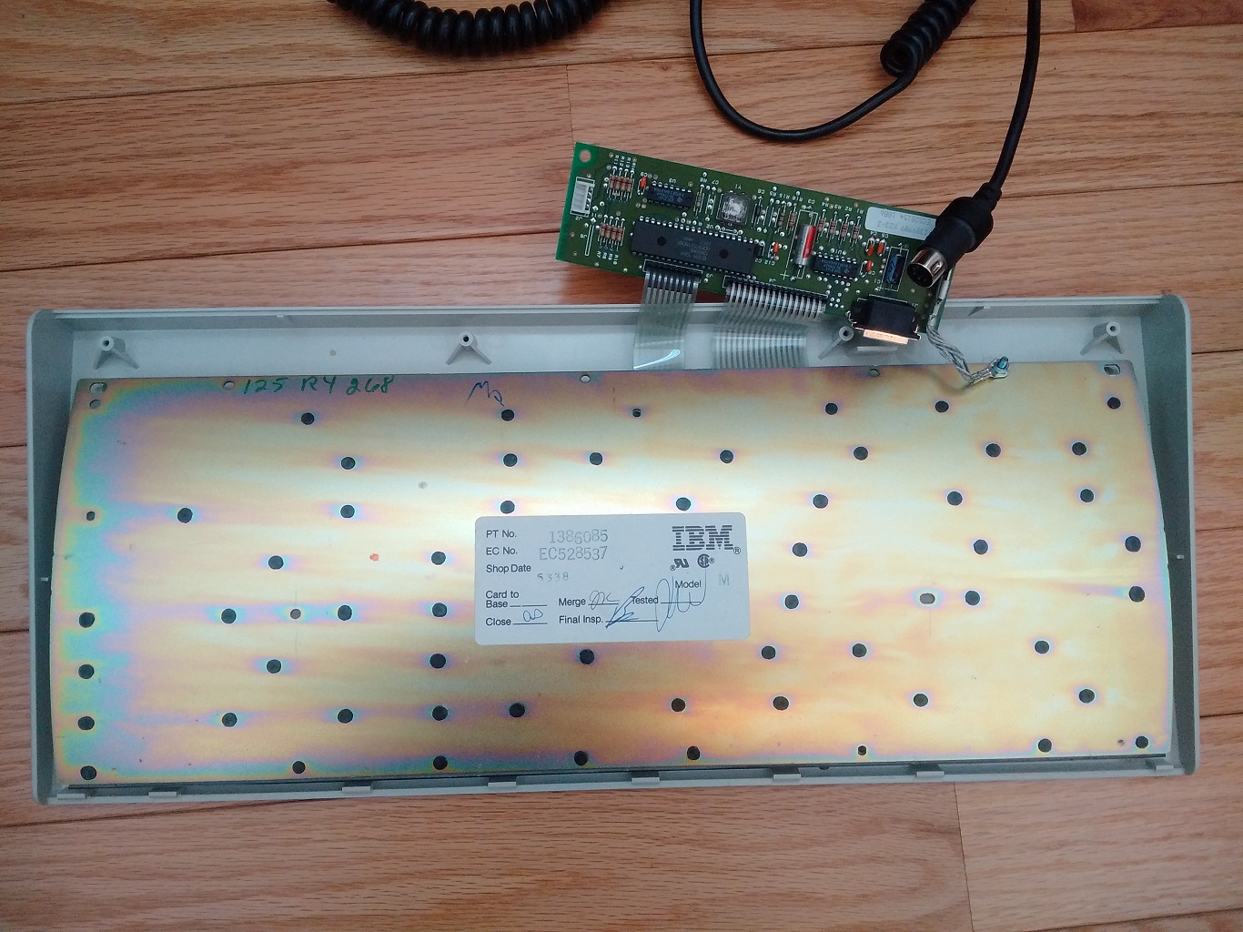

One feature of many (but not all) early model M's from late 1985 and early 1986 is the thicker, curved steel plate.
In the majority of later model M keyboards (1987 - 1999), the curved plate appears a dull steel gray without any coating.
...but in some rare examples the additional coating on the thicker steel plates results in a fine, mirror-link finish.
1390120 chrome.jpg (73.72 KiB) Viewed 7344 times
