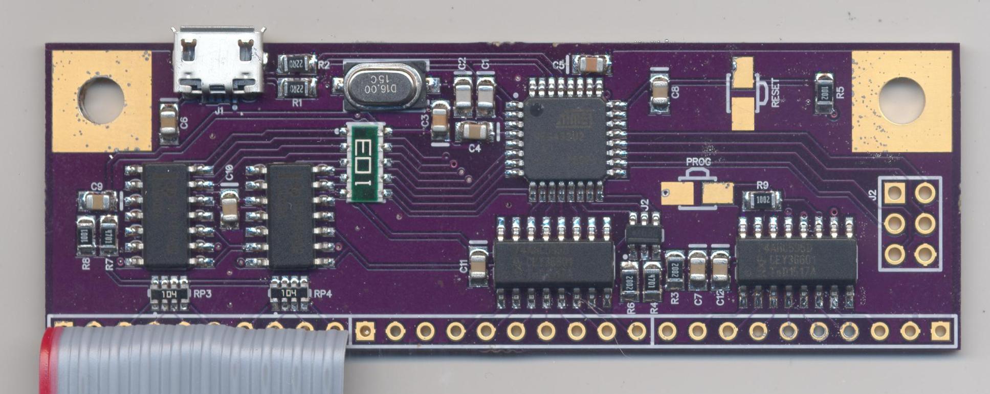

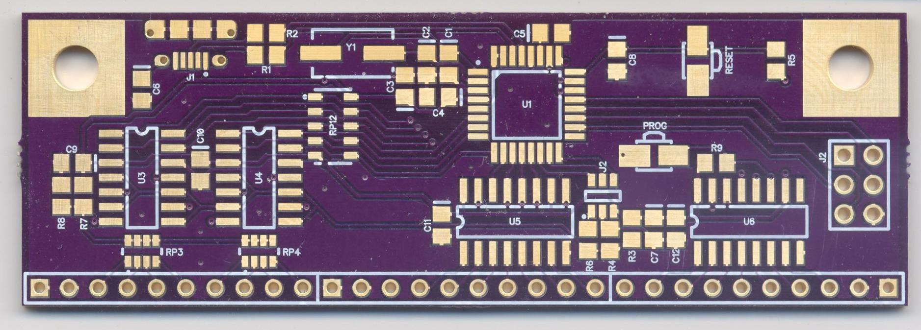

Anyway, this is what I ended up with. The problem is ... it is not working. When I connect a USB cable, it does not detect a new device, so I can't program the processor. It might just be the USB connector, but i'm not sure. Suggestions would be welcomed.

OS detects nothing when i plug it in. I was hoping that the macro picture would show a bridge somewhere or a flipped component. if there is one, i can't find it.

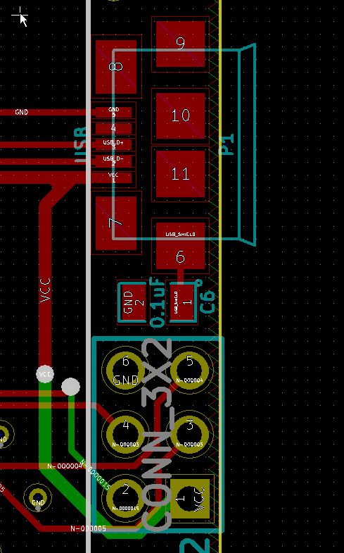

It looks like there is a via in the VCC line off the connector that goes to the ground plane on the back, but I may be mis-interpreting it.

Engicoder wrote: It looks like there is a via in the VCC line off the connector that goes to the ground plane on the back, but I may be mis-interpreting it.
Thanks for looking Engicoder.
that is a silkscreen layer (green) dot to mark pin 1. sorry, the picture is not clearer.

I also think that if you can get an AVR ISP programmer connected, the crystal and fuses should not matter. However you've made some unusual choices in routing - 2x3 connectors looking like that are usually connected to the pins that allow you to hook up an ISP there; in your case they go to some random pins. Hooking up an ISP would require you to solder wires directly to MCU pins.
Crystal - I thought that the load caps should be physically as close to the crystal pins as possible (not sure how much does that matter - I guess the issue could be the traces' capacitance). Don't know whether this could be a problem.
If the bootloader is there (which I think it is - it seems to me that almost noone in the KB world ever flashes a bootloader, including hasu and bpiphany who do 32u2 MCUs), then I think it will run regardless of the HWBE fuse/HWB pin status, because the rest of the flash is blank. However you might want to pull HWB low just to be on the safe side.

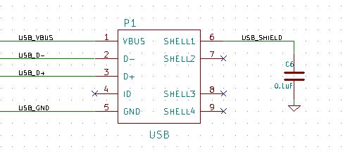

My C6 is the same as what Xwhatsit's C6. Clips of his schematic and design below.

If you look from the back edge of the USB connector - do the pins look like they are all in contact with the board? I've been staring at your layout and the populated PCB pics for a while now - I don't see anything wrong with it. I can't see what is under the USB connector though.
I am curious if your combining RP1 and RP2 will be OK from a capacitive scanning POV - but that wouldn't be affecting the USB to controller side of the circuit.

Just a note for when you order a revised version of this board: it's generally a bad idea to put vias inside of or directly adjacent to pads. Since they're plated-through holes, they'll get filled with solder, making you use more than you need to.

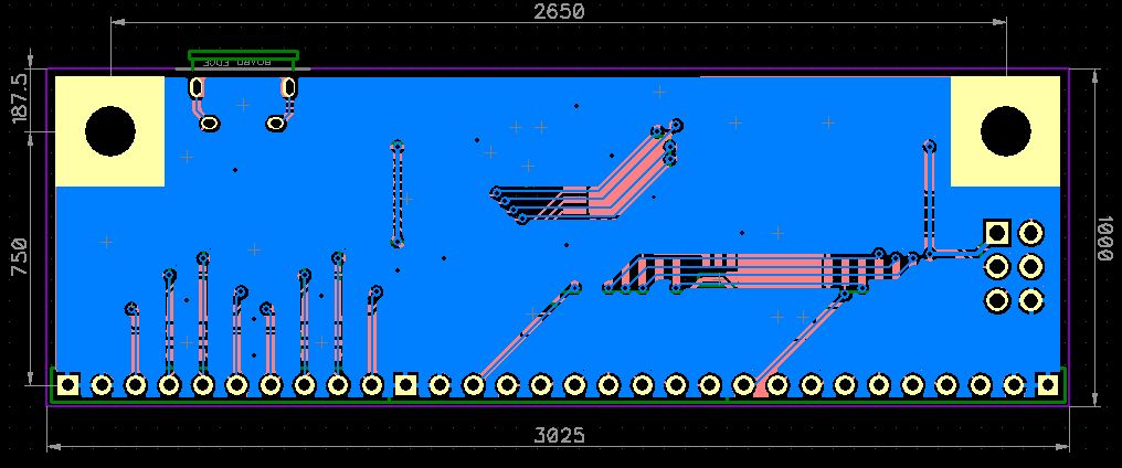

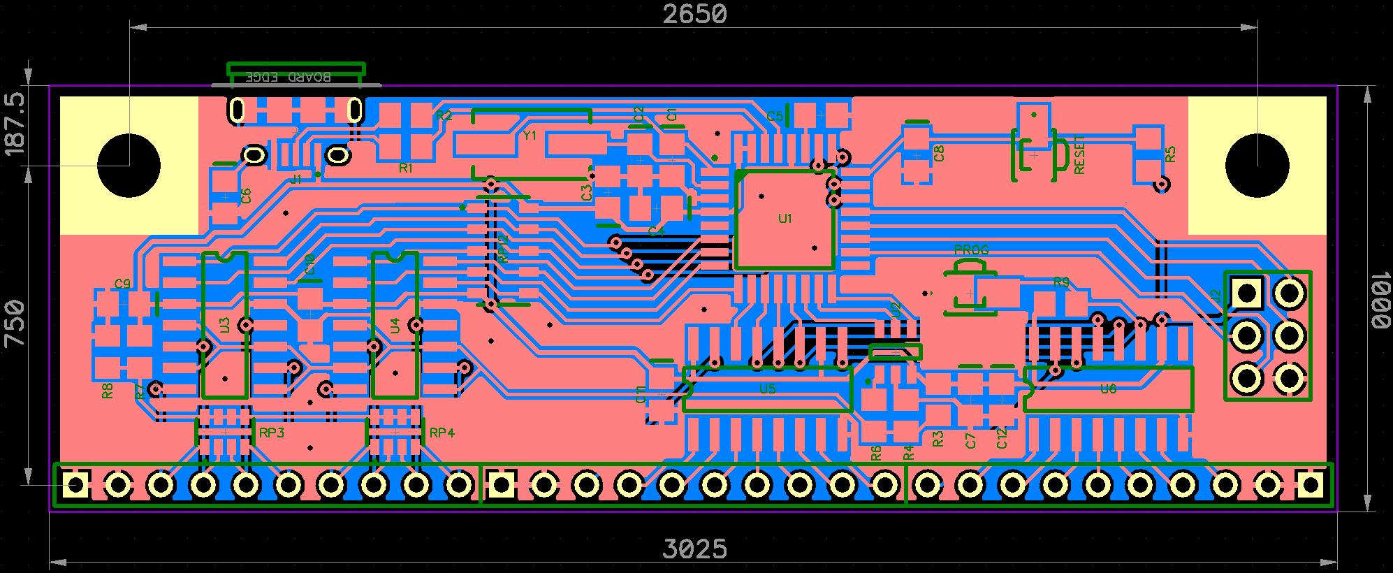

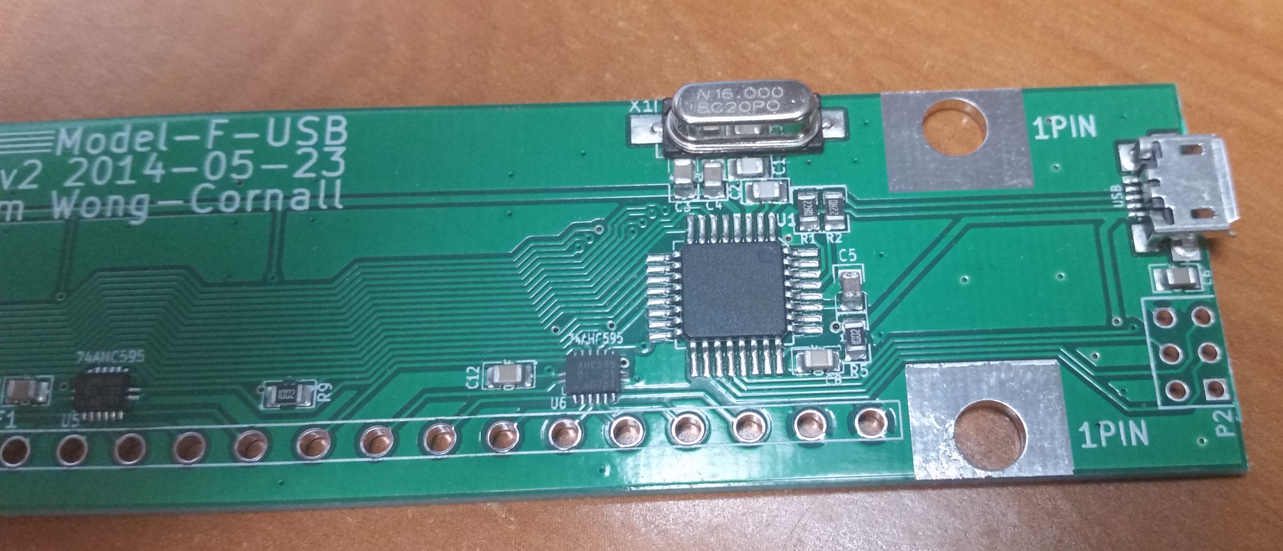

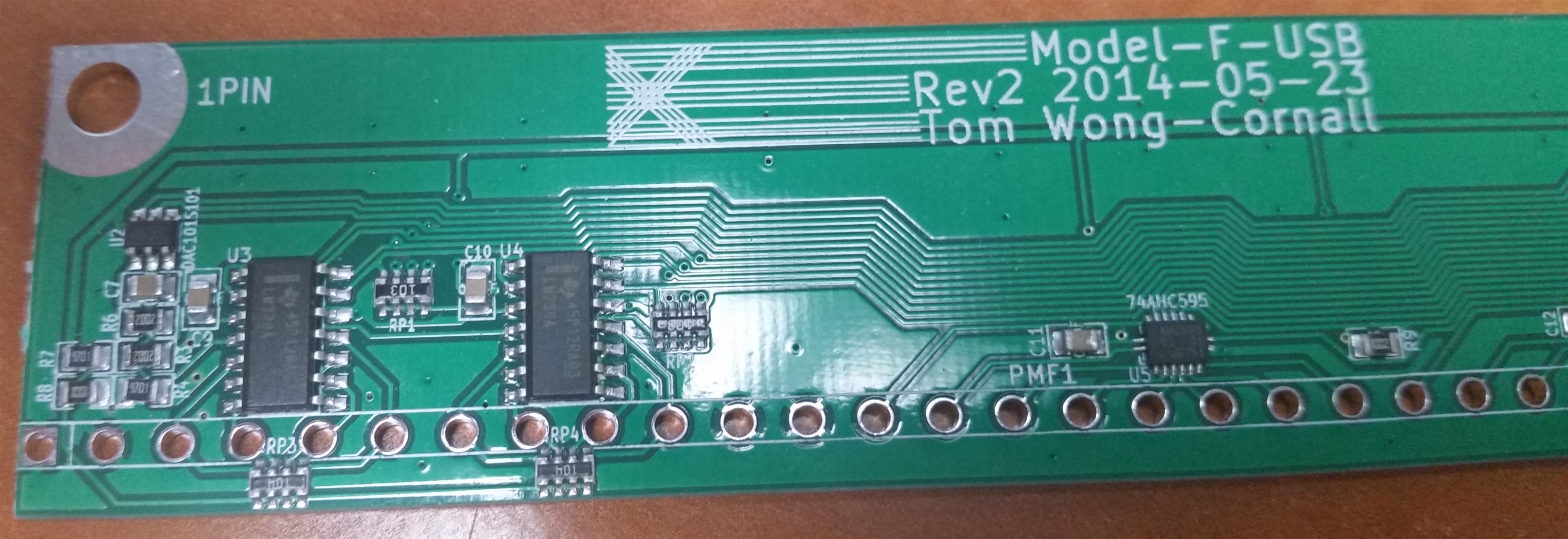

Here's a high res version of the original size xwhatsit controller for a visual comparison, split into two photos:
