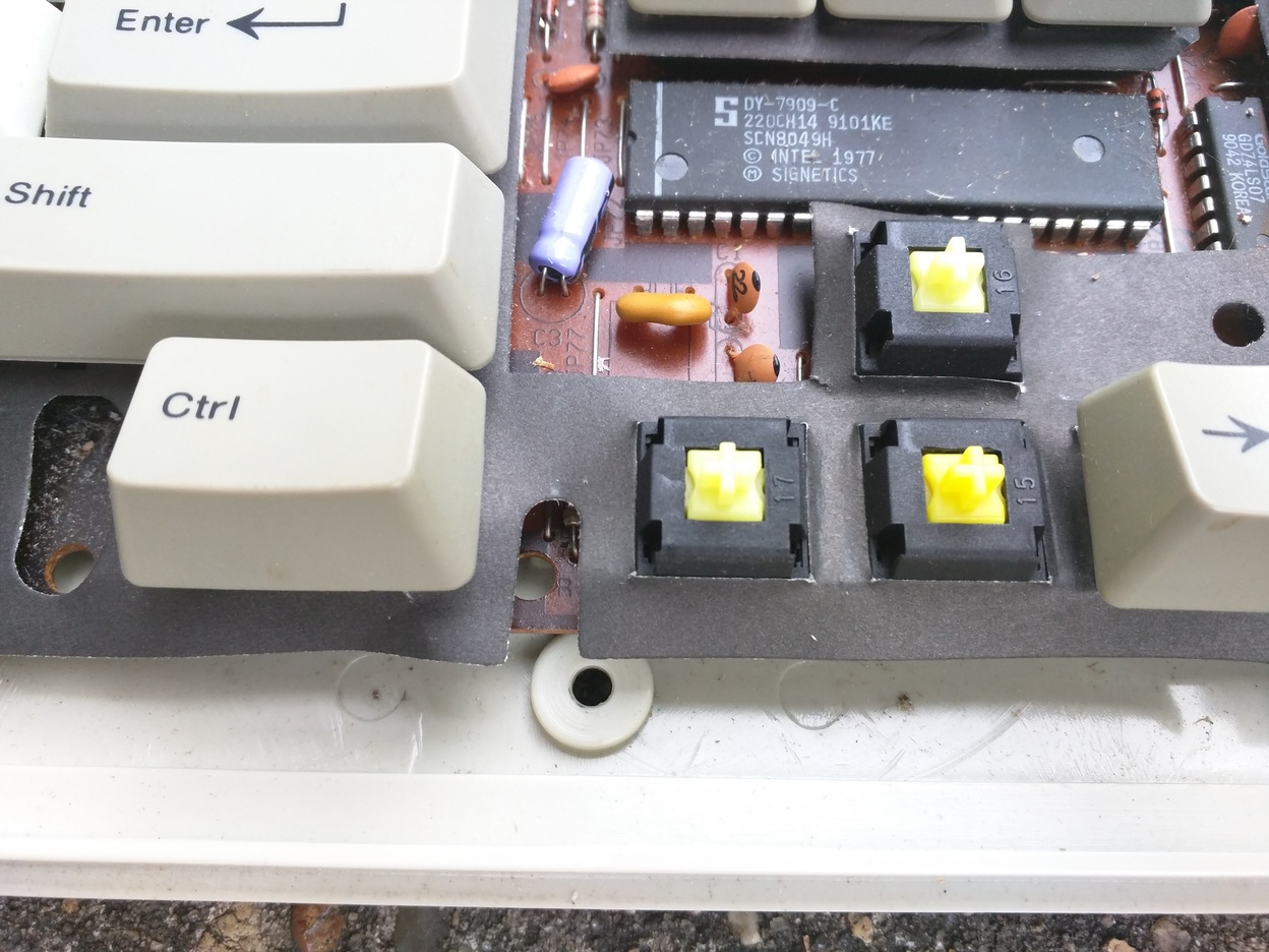

A friend gave me a UNITEK K-256 keyboard the other day. I'd never seen yellow Cherry switches, so I did some Googling and found this: https://klikkyklik.wordpress.com/2015/0 ... revisited/
It seems that it uses "Taiwan jet axis" switches. They're PCB mounted. They feel OK and sound OK. They're linear and seem to have reduced key travel distance compared to Cherry switches.
The keyboard itself feels incredibly cheap is extremely light.
I don't think this keyboard is anything special, so I'm most likely going to use it teach myself how to properly desolder switches.
I may even build something with the switches if they'll mount on a MX PCB and plate.

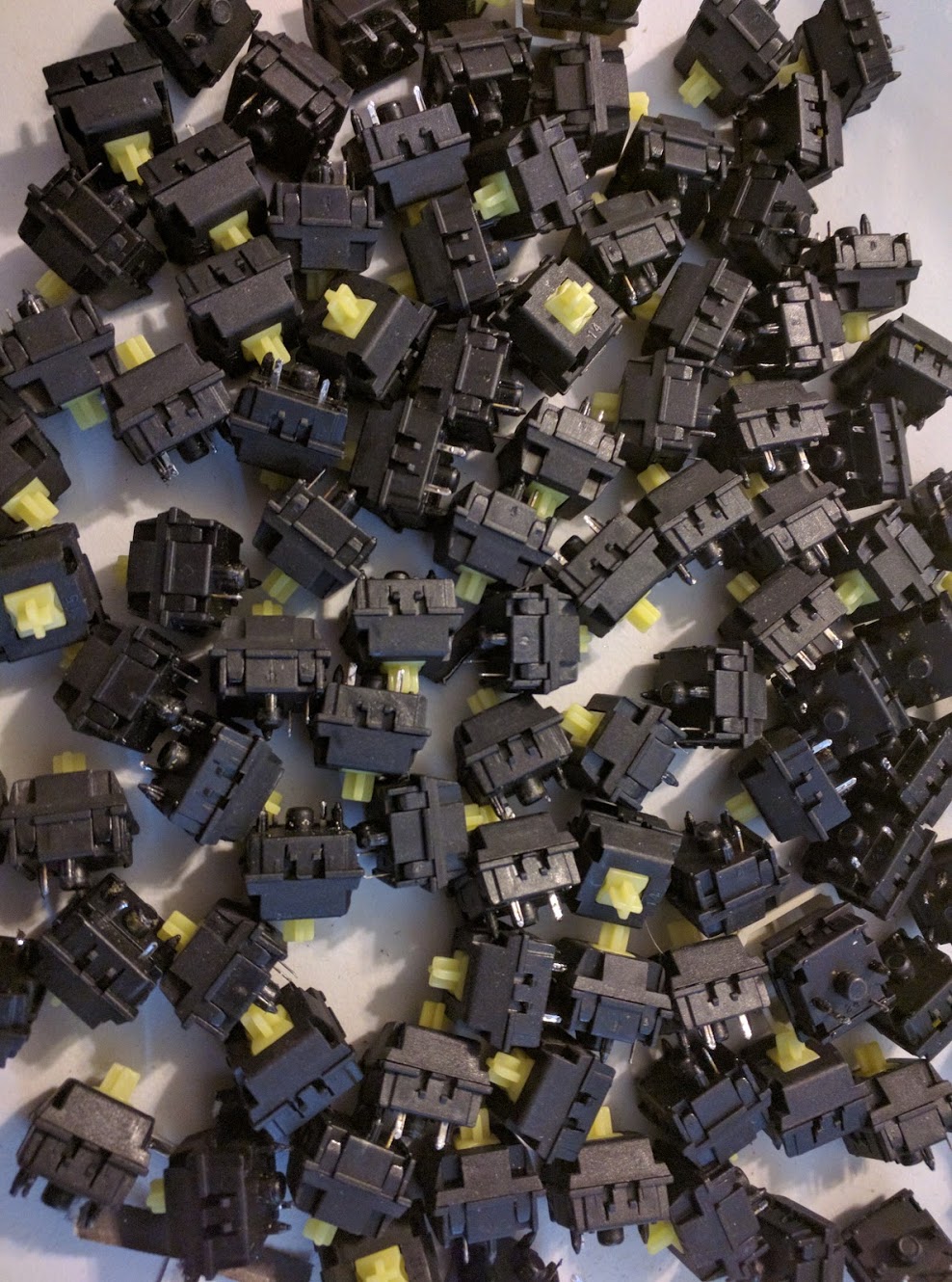

I successfully desoldered all of the switches. Now I do the same with my QFR with MX blues and put these on in a few days.

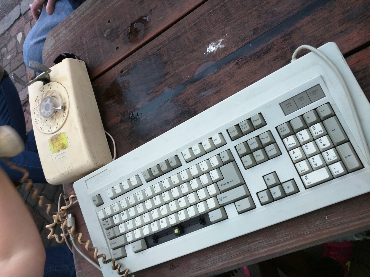

I put the Taiwan Jet Axis switches in my QFR today. Here's some photos: http://imgur.com/a/WUDyW
I purposely left the top row (except for ESC) and caps lock with MX blues, but put the Tawain Jet Axis switches everywhere else. I wound up having to put MX blue switches back for the stabilized keys because the TJA switches aren't compatible with Costar stabilizers due to the shape of the top switch housing. I pulled a MX black switch off of a switch tester for the space bar and I've ordered others for the rest of the stabilized keys.
I've been wanting a keyboard with linear switches for a while now and had been thinking of buying something with MX black switches, but I'm quite happy with how these TJA switches both feel and sound.
The UNITEK keyboard that these switches were in originally was one of the cheapest feeling and lightest keyboards I've ever used. The switches were PCB mounted and the PCB was extremely thin and flexible. The switches are so much nicer plate mounted in my QFR.
