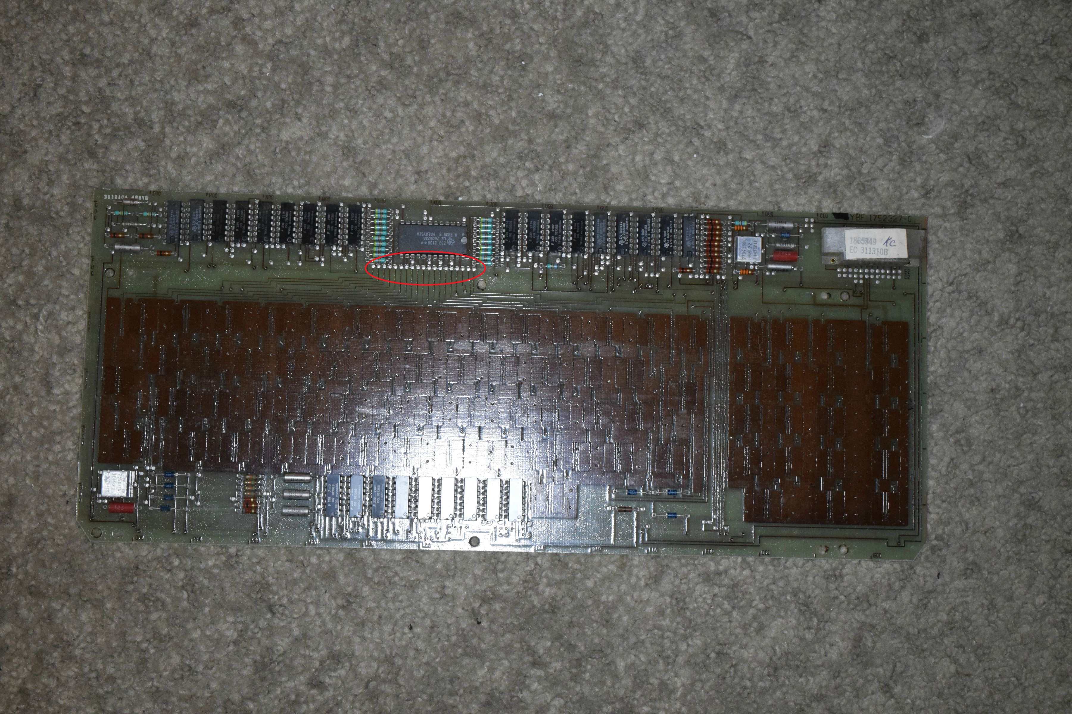

Hey guys, I picked up an old IBM 5120 terminal for free off of craigslist a while back. Unfortunately the terminal was nonfunctional but I was able to salvage the keyboard out of it! Free beamspring yay! :D
Quite the monster! :shock:
Only problem is it doesn't use the same controller setup as other beamsprings and as such is unable to use an Xwhatsit controller in its current state.
I had a couple ideas as to how to get this thing working with a modern computer. First would be to create my own converter that would utilize the existing controller. I was able to find the pinout for the connector in the IBM service manual. This is pretty far over my head however and sounds like it would be a lot of work. Here's a link to the service manual: ftp://ftp.informatik.uni-stuttgart.de/p ... 0192-0.pdf Pertinent info on pages 2-72 through 2-76.
My other idea was to simply create a new PCB that would be compatible with Xwhatsit's controller. This seems like the easiest way to go to me but I've never designed a PCB before. It seems pretty straight forward for conventional contact switches but the capacitive magic that makes these tick is beyond me.
I would really appreciate any insight as to how I might go about making a converter or designing a new PCB so I can actually put this beauty to use!
Also, all it seems to need besides USB compatibility and maybe a fancy custom case is new foam. The stuff that's in there has turned all sticky and the keys all wobble around. I would assume the foam that most use for Model Fs from McMaster Carr would work but I'm not sure. Any suggestions on what type of foam would be best would be awesome!
Thanks!

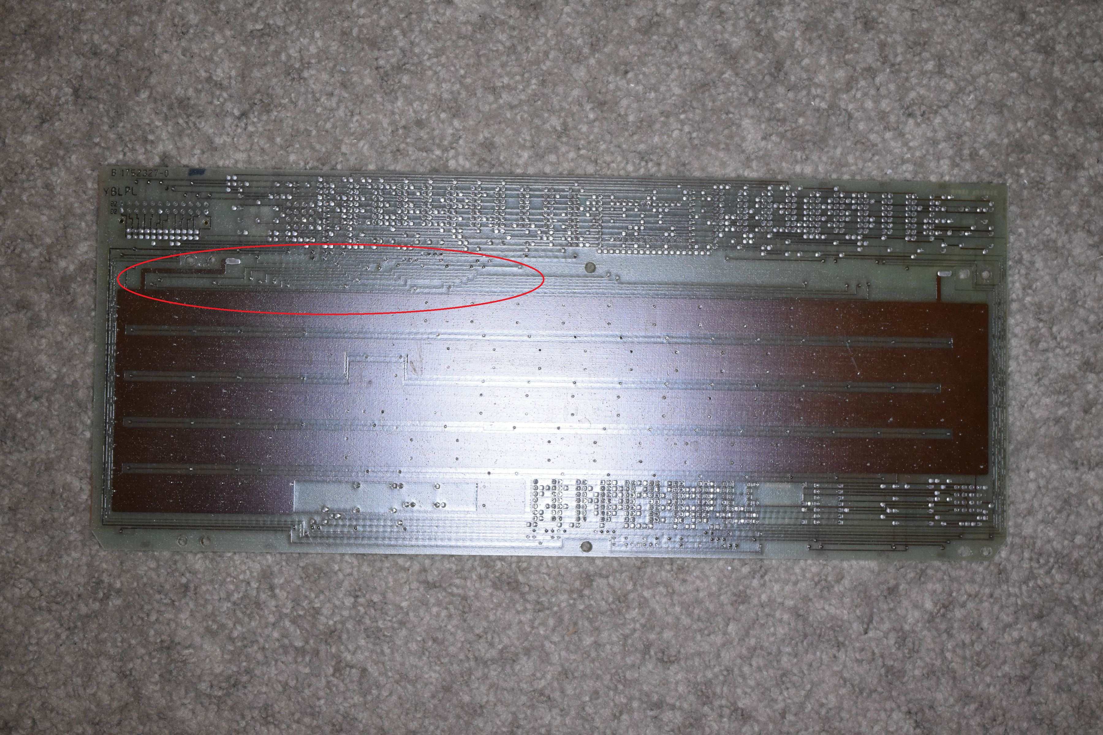

From the photo it looks as if you could tap into the lines you need and install an xwhatsit. You would need to get busy with the multimeter .
koalapear
10 May 2016, 20:20
andrewjoy wrote: From the photo it looks as if you could tap into the lines you need and install an xwhatsit. You would need to get busy with the multimeter .
I thought that might be a possibility as well. The way things are routed and the chips at the bottom of the board made it seem like this matrix might be set up differently though. Here's a link to the full album of the PCB: http://imgur.com/a/0glsD
