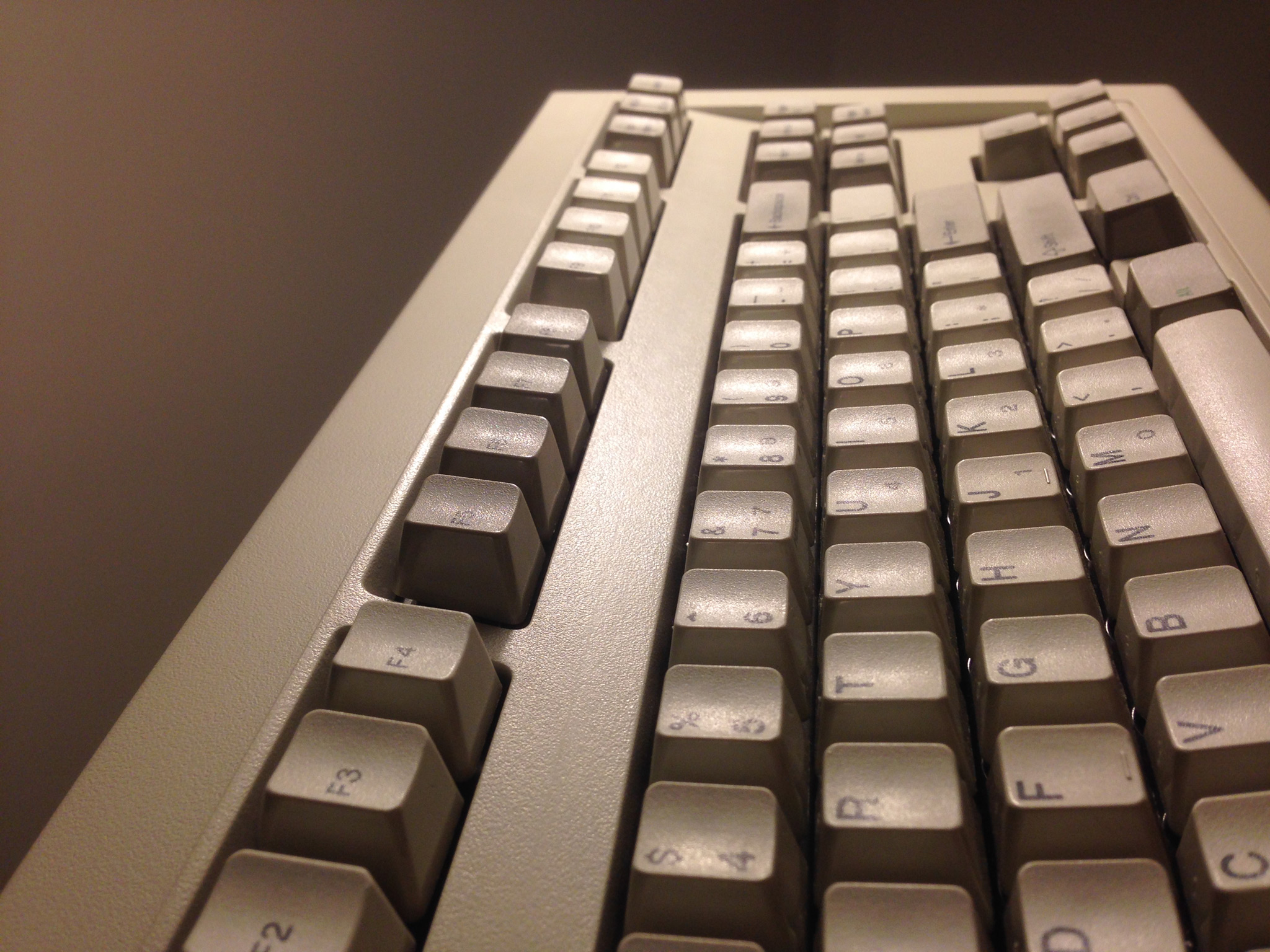

There is a slight horizontal scratch between the number row and F-key row on a Model M SSK that I just got. I am having a very difficult time capturing it on my camera, but it's much more noticeable in person. How would I go about buffing and polishing this a bit to smooth it out so it's not as noticeable? I'm pretty anal about this, so I want the best finish possible.

Haha! Yeah I can see myself doing that. I think whatever I do will have to take time as I don't want to remove the existing texture. I don't expect to fully get rid of the line, but just blend it in better. The texture is mostly fine since it's not a deep scratch, it's mainly how the light reflects from it that is a bit unsightly. I was thinking of using an eraser to buff it out a bit and then polish it back up lightly somehow.

I haven't tried that particular product but I have cleaned the area with a bit of alcohol. Basically, there is a long line across the board where there's about a 1-2 mm width with a flattened part the texture's ridges, so light reflects more evenly from it than the rest of the surrounding texture. I think, short of sandblasting, I am going to have to just deepen the valleys within the texture itself with a miniature carving tool, because buffing will only flatten the texture more. I did a bit of buffing with an eraser to blend it, but it's going to be a months long process, I think, to fully restore it. I'll need to come up with some tools that can carve that small, and some sort of magnifying glass to wear. If I can get some good macro shots, then I'll show what I mean, or I will make some illustrations.

I ended up just trying the Barkeeper's Magic. I think it worked well enough. You can still see the line, but it's blended in a lot better. Thanks a lot for the advice!
