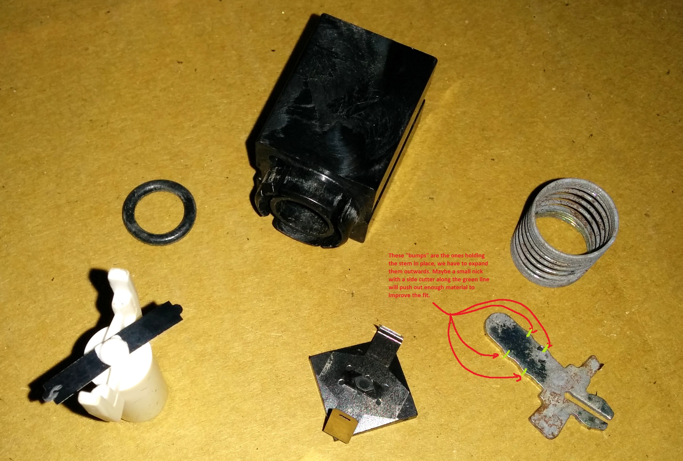

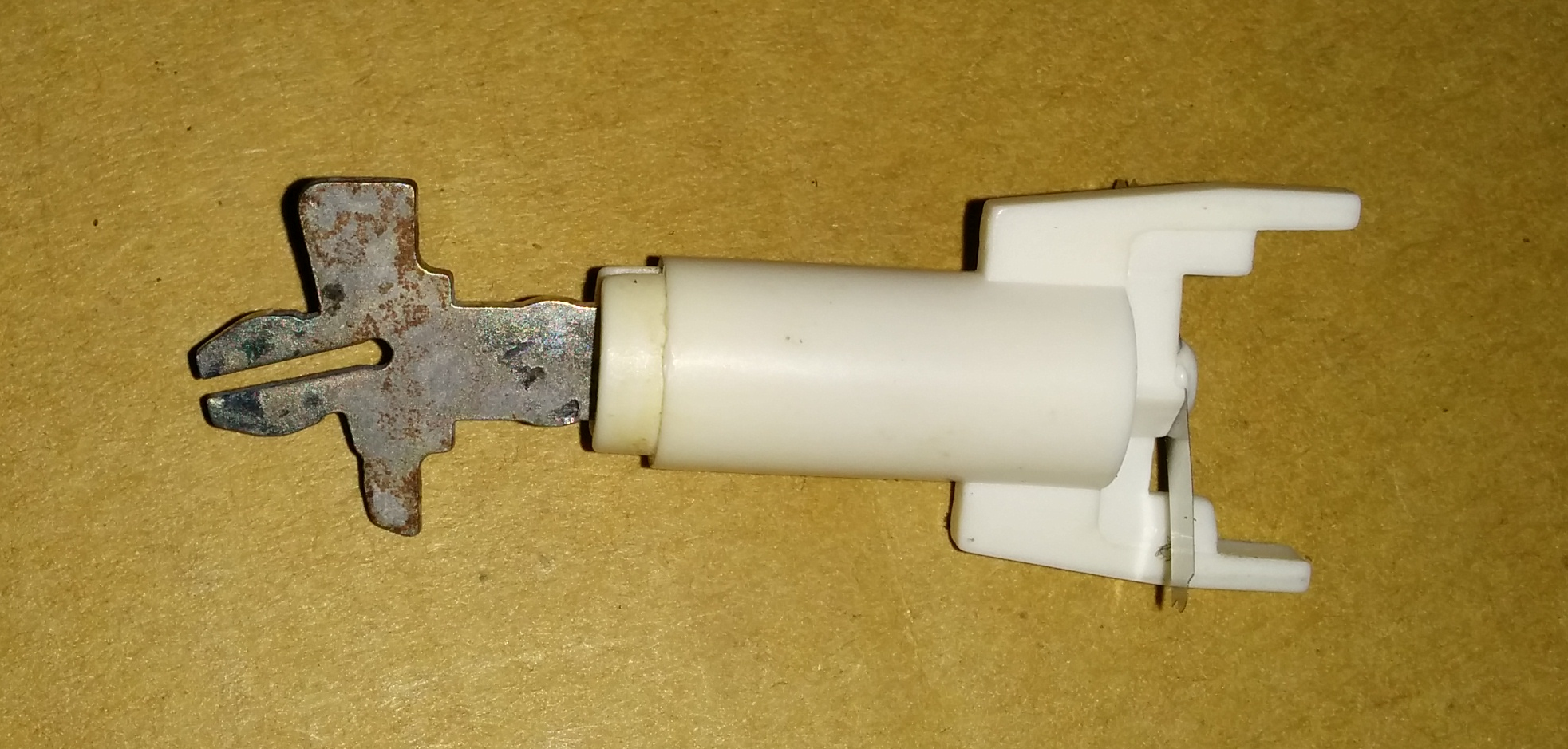

I can only tell you what I have recently experienced while pulling caps on my 5251, this may not have anything to do with your situation! As you know the metal key stem sits inside the plastic stem shaft that also holds the fly plate at the bottom. Now on my 5251 the goves on the metal key stem were worn down so that the key stem does not mount firmly in the plastic stem. These keycaps can also have more wobble on the cap for the same reason. I am currently going through my options to fix this, I will have to improvise. Thanks to chzel and lot_lizard I know what the problem is. I have also noticed that when the PCB is not screwed to the plate evenly problems with contacts can result.
