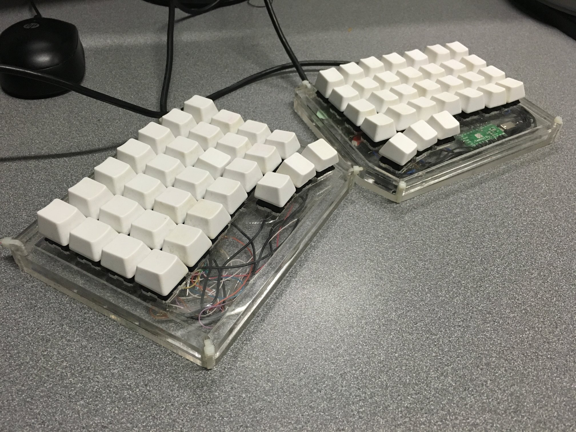

Hey guys, I made a few split ergo keyboards for myself too. I made my first one using a teensy and brown switches. Everything is hand soldered. I designed the templates for the switch placements. It's ortho linear like most ergo keyboards, but I didn't have the extra inner column. The F and J keys are on the second column from the inside. Here's an image of my first keyboard.
I used that keyboard for something like 6 months. And then one day I saw that massdrop had gateron keys, and I thought I should get some clicky blue switches and make a keyboard out of them. I found a low volume pcb manufacturer in China, tried my hand on designing pcbs. That went pretty well too. I used this baby for a little under a year.
One day I was on the way to the toilet of this mall and saw there was a computer shop in the most unlikely of places, and on display is a matias keyboard. I shouldn't have tried using it because since then I've been dreaming about making a split ergo keyboard out of it too.

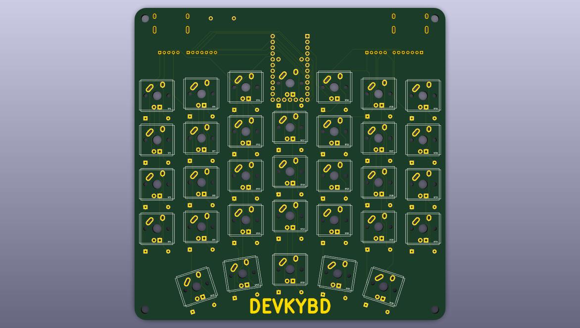

When I designed the first pcb for my black keyboard, I was still thinking of using wires to connect to my teensy, not realising I could solder my teensy to the board directly. I'm doing that on my new keyboard.
The keyboard design uses a 5 by 7 grid, which means I needed to have 12 wires to connect one half of my keyboard to the other half where the teensy is stored. To accomplish this, I used an hdmi chord, stripped it, and connected the inner wires to each half of my keyboard. This is more tedious than it sounds (it takes alllll day!!!!). With the new keyboard, I'm using hdmi smd connectors to connect each half of the keyboard to each other.
I also want to use less table real estate, and a chance to tent them using height adjustable stands.
The hdmi connectors would be surface mounted on the backside. The pinholes under the hdmi connectors are there as a backup just in case the connectors don't workout as I expected.
To keep costs as low as possible, the pcb's design let's it be used as either the left or the right side or with matias/alps or cherry switches without flipping or rotating anything.

Looks similar to my old build Image.

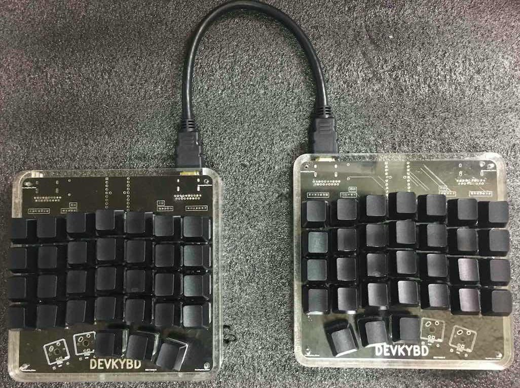

I was able to finish the project about a year ago.
To be honest, I nearly gave up on this project. The hdmi smds were a pain. It didn't help that it was my first time working with surface mounts as a whole. I discovered something very important. "Surface mount" meant the pins had to touch the surface, hence the name. Apparently, the legs of my hdmi ports were just a little taller than the thickness of my pcb. This discovery came only after the 5 broken hdmi ports and pcb boards. On that sixth attempt, I noticed a sliver of light from beneath the port, less than 0.1 thick. The height of the legs of the hdmi meant it was propped up a little bit.
I used a nailcutter to cut the legs shorter, and everything worked. It took a while for me to write this update because I was afraid I might get banned because of excessive use of profanity. I'm calm now, it's been a while.
That was not the end of my worries though. The pins from each side of the hdmi cable don't have a direct mapping with each other. Some of them twist. There are online references, but either I read them wrong or the reference itself was wrong. I soon discovered a lot the pins I had that connected to the other side wasn't working. I used the first 9 pins according to diagrams online. So to anyone who wants to attempt to use hdmi to put together the two halves of a keyboard, you've been warned!
I had to order new PCBs. This time I left a gap between the pins that connect to my teensy and the pins that connect to the hdmi. I would then solder wires between them. That worked, but what a hack!

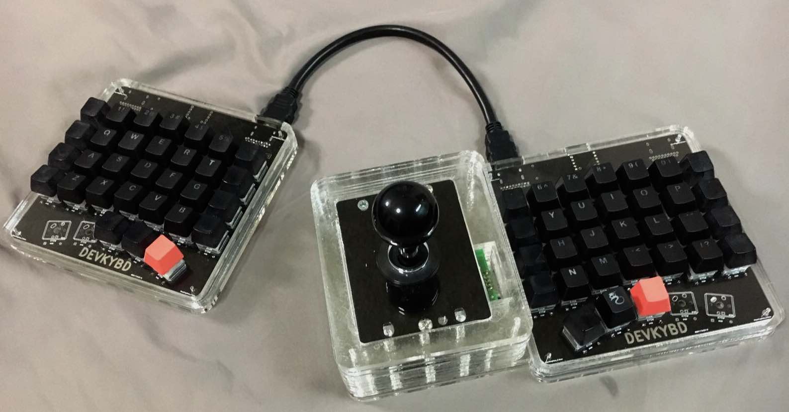

Worth noting, a friend on mine requested to have a hori hayabusa joystick next to they keyboard, so he can play games with it. So I built one for him too.
