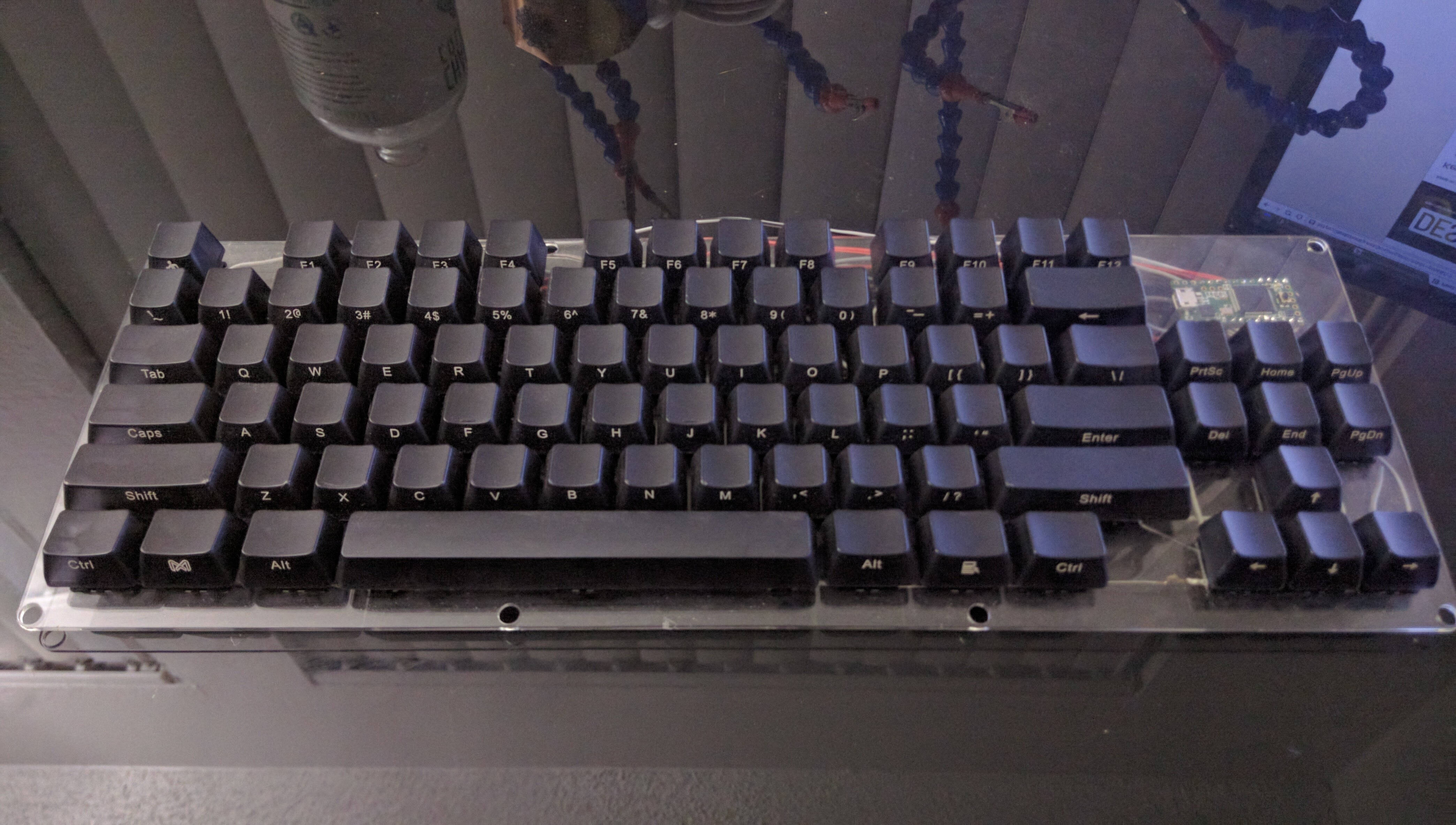

Hey everyone,
I'm new here to the forum and I've come here to ask for help regarding a homemade keyboard project I'm trying to complete.
I decided to hand wire my keyboard just because I wanted to get the soldering experience and I picked the Teensy 3.1 since it had enough pins to support the rows and columns I had planned for my keyboard and it was a pretty good price.
I have the keyboard and the teensy all wired up but I'm not sure how to proceed in terms of firmware. I already have Arduino and Teensyduino installed on my computer.
Can you guys suggest some good (easy) firmware options and give me a small tutorial on how to get it working on my setup?

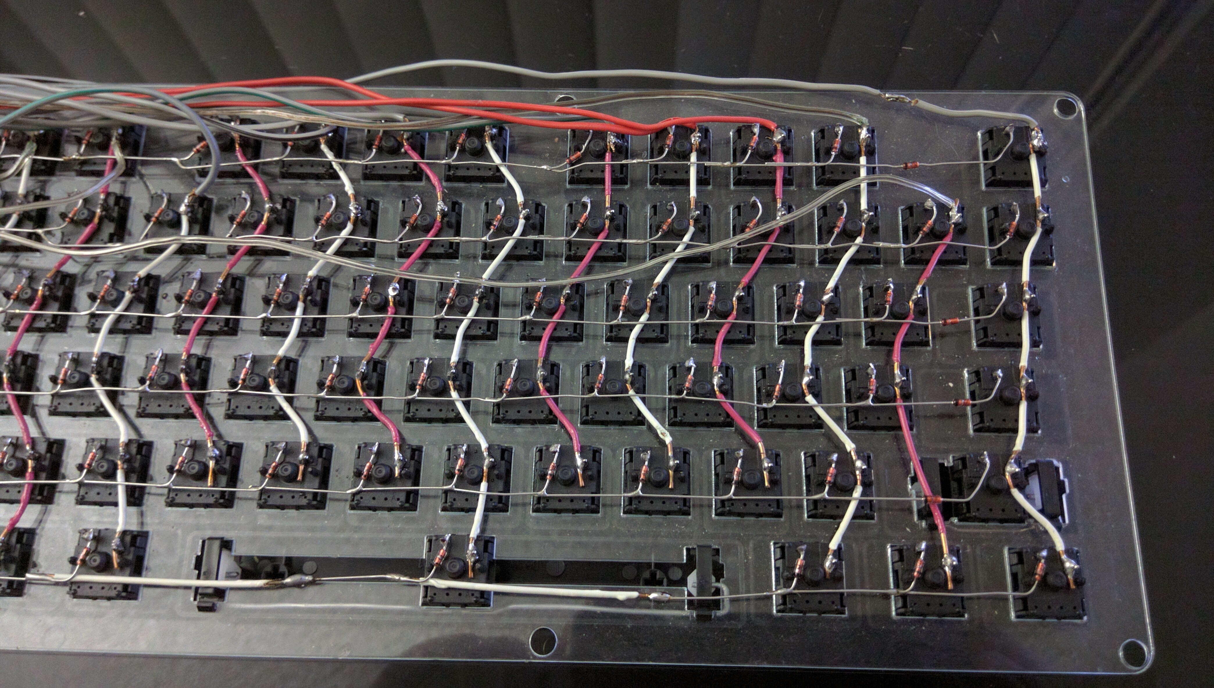

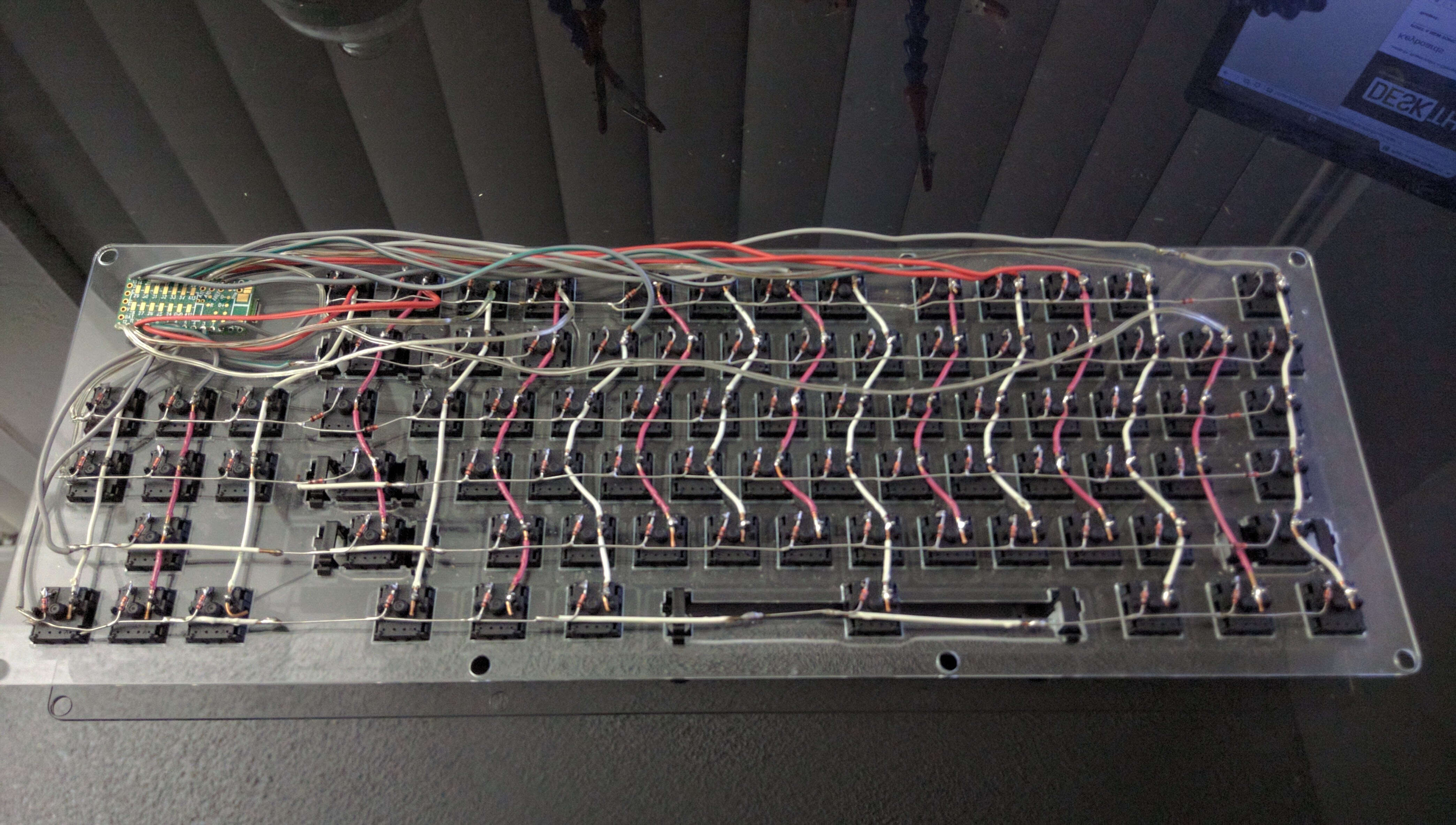

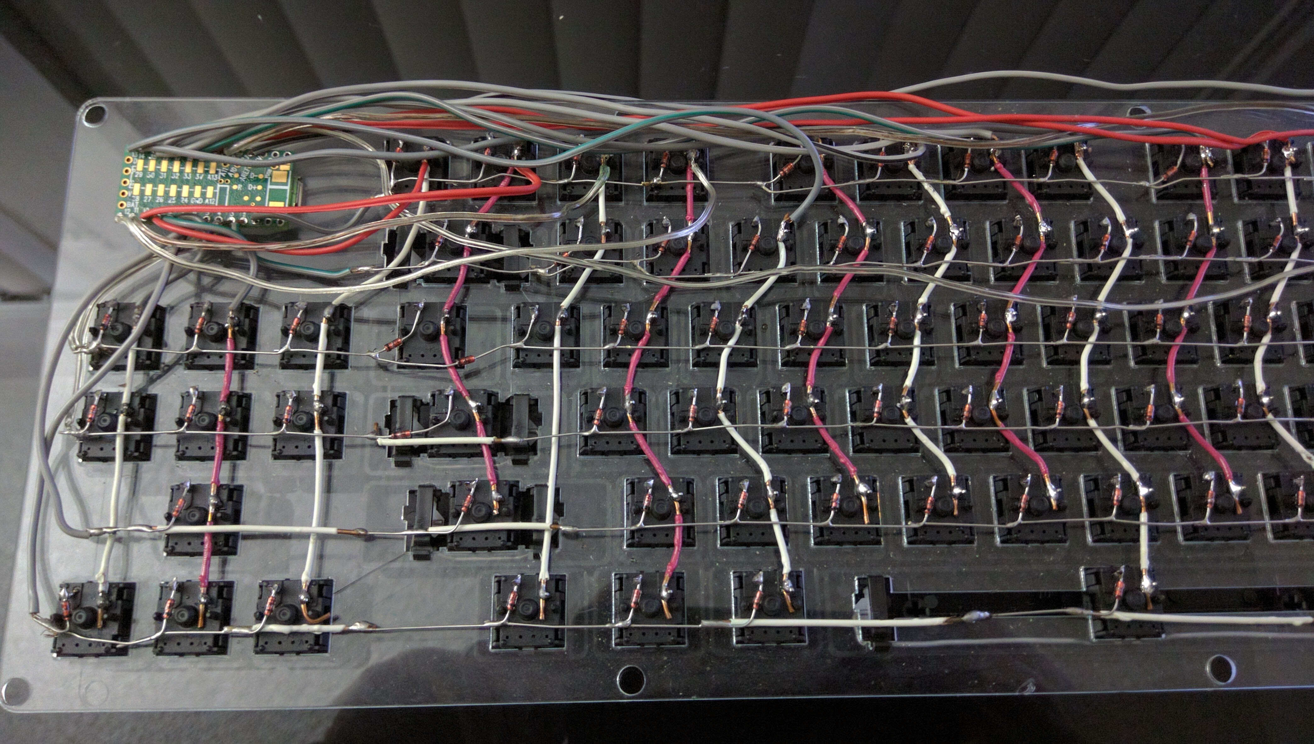

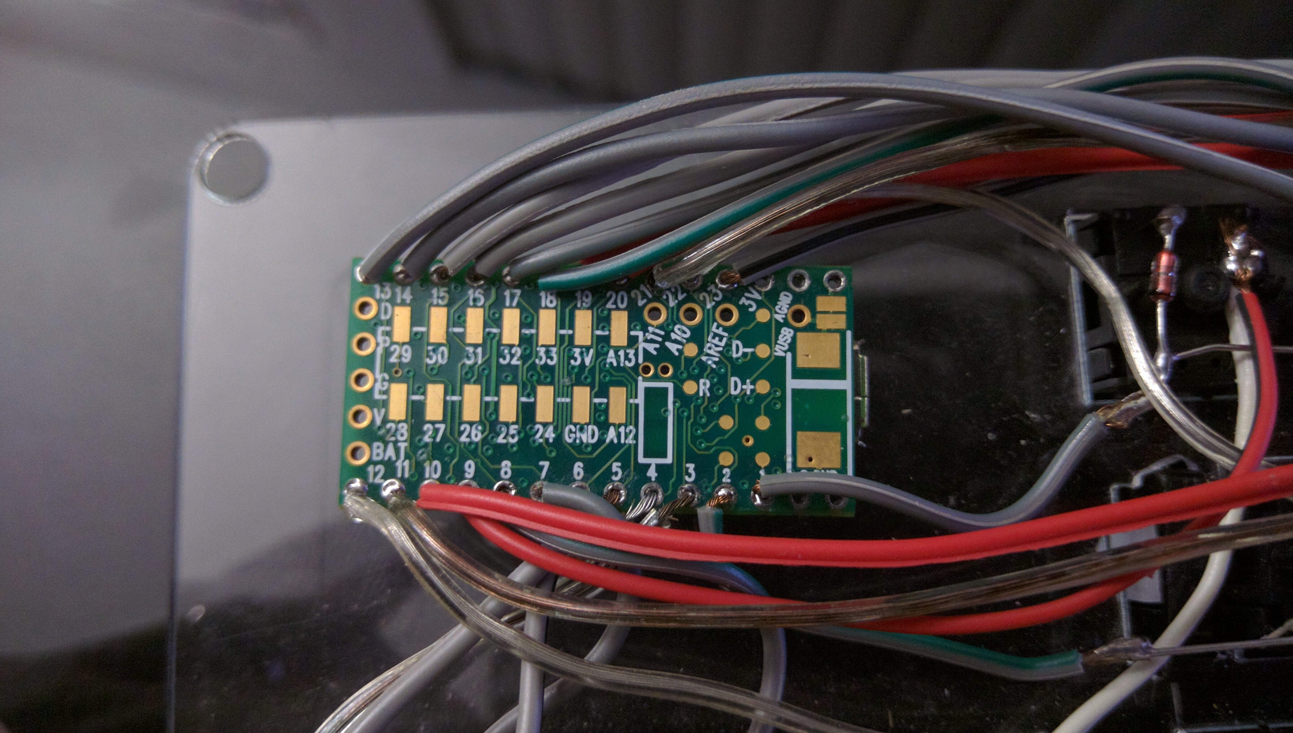

Also does my wiring look good?
I greatly appreciate any advice anyone could give me.
I've included some pics of my current work:

I tried using the Arduino Keypad library with no success, it's printing a bunch of crap to serial in my example I have. I'm also thinking that my wiring may be messed up somewhere.
Does anyone know of a way to test my matrix with a multimeter other than continuity testing each dot in the matrix?
