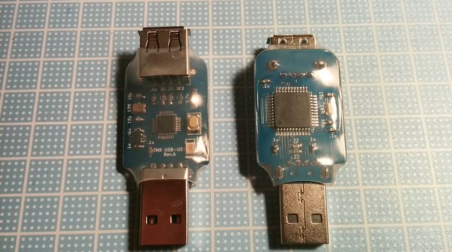

As many here already know, Hasu has developed converters to enable various classic keyboards to be used with USB. These include Apple ADB, Apple M0110, IBM 4704, Next, Sun, IBM XT, and others.
More recently, he has made a USB to USB converter that is programmable, so that virtually any USB keyboard can be programmed to any layout. It includes up to 7 layers and up to 32 Fn keys. I have found this converter so extraordinary and helpful that I decided to post my impressions of it.
Hasu USB-USB Converter; image from Hasu. https://geekhack.org/index.php?topic=72052.0
Once you program the converter to your liking, you can plug any USB keyboard into it to get the layout you have programmed into the converter. Moreover, if you decide to change your layout, you can reprogram the converter. You do this by flashing the firmware, so you could save collections of hex files with various layouts. This would save you the bother of re-entering the key assignments.
Hasu provides instructions for building the converter yourself from a Circuit@Home USB Host Shield and Arduino Leonardo chip, or, for a mere $55, you can buy a fully assembled converter directly from Hasu.
